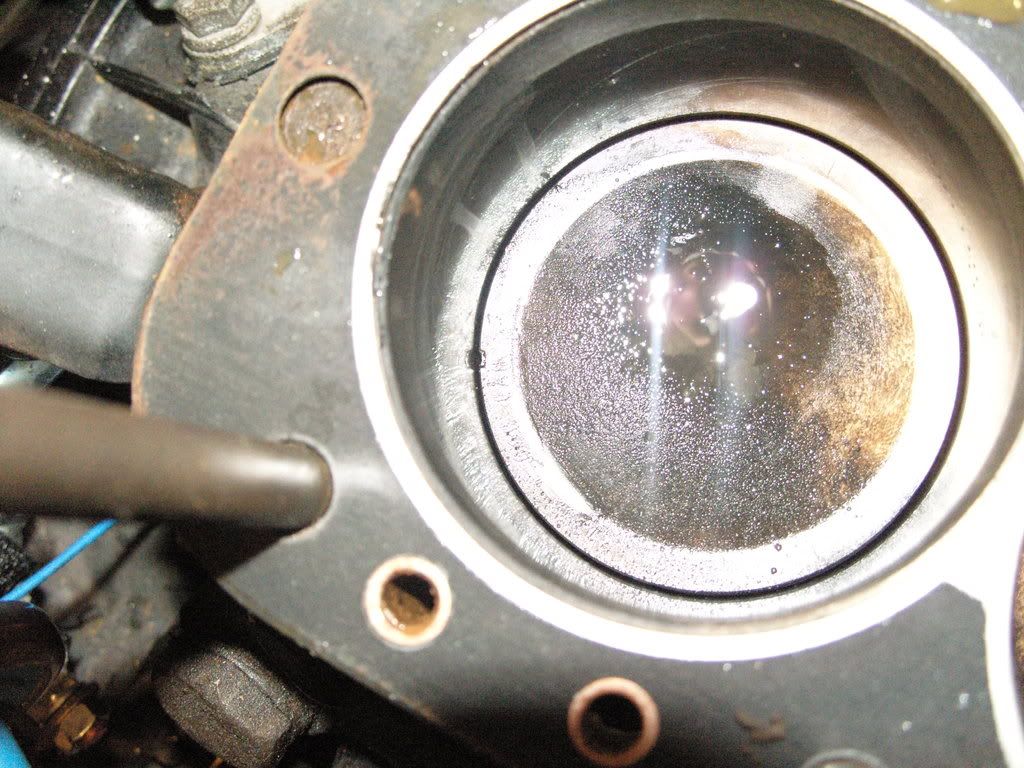

took my mini to get tuned the other day, only to find it was down on compression on cylinder 4 by 30%
engine has only covered 150 miles since being bored to 1330, new pistons and rings ect...

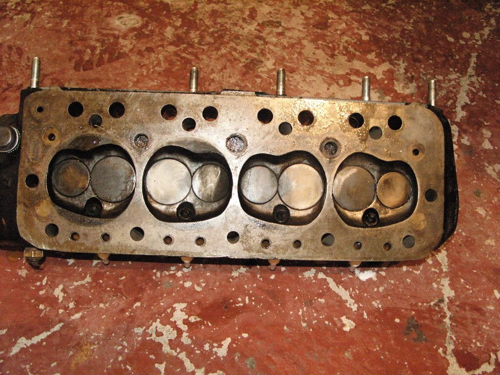

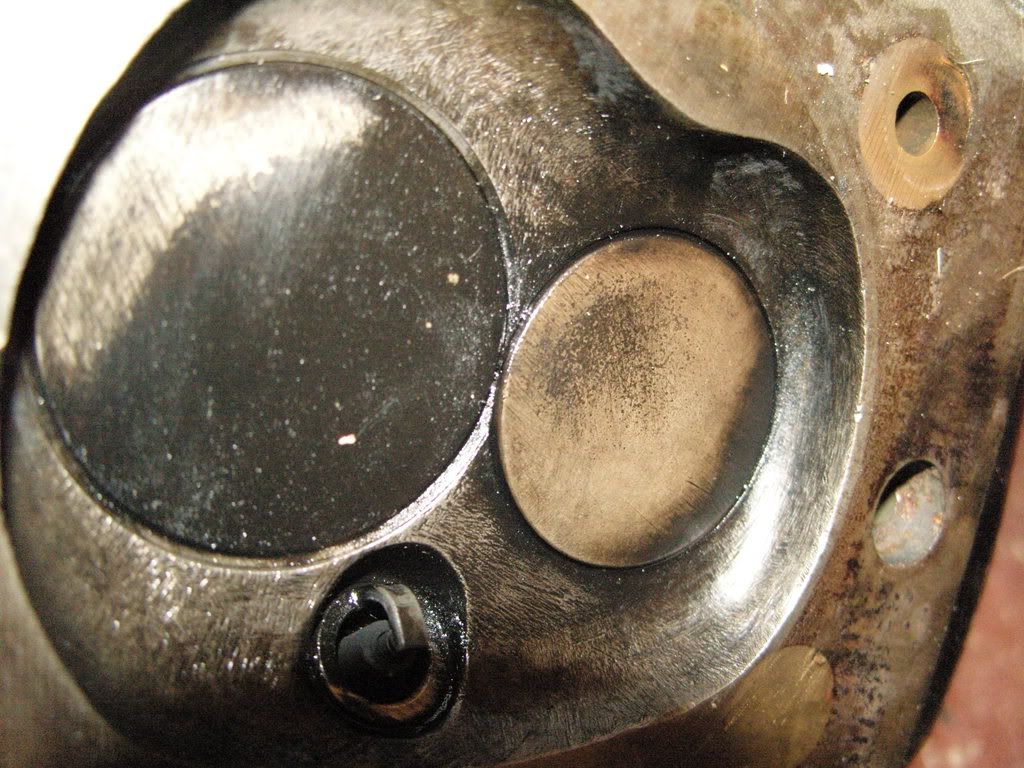

took the head off tonight to find a gap/hole between the valves on number 4. poured brake fluid into the ports and it leaked through between the valves.
also, on the same cylinder, i found this nick in the piston... could this be related ?
my question is, can the gap between the valves be repaired, or is it scrap ? i have no problems chucking a few hundred monies at it if it will work again, but if its probably not going to work i will just buy an equivelant spec head.

yes you can get them repaired, if theres enough material there......
have you had the valves out and seen if its cracked through?
what you can get is ardox overcheck......spray it on the area and wipe it off if there are hairline cracks it will stain them....needs to be very clean first though....
the brake fluid may have just seeped through a poorly seated valve....in which case lapping the valve back in will sort that out!

valves are still in. theres a definite hole there, although its not clear on the pic :D
taking it to get looked at tomorrow, see if thees anything can be done.

That is cracked. It can be repaired, but looking at the size of those valves it will go again. If there is parts of the casting missing from that area and breaking the valve seal, then it could be an issue, but if its all there and just cracked, it will be fine. The BR Group A Rally head i have is cracked across the valve seats, i had the valves re cut and now there is no noticeble difference in compression readings.
Im hazarding a guess that there are no hardened seats fitted? judging by the size of the valves
If you are intending to do road mileage on a head it would be more suitable to run 37/29mm valves with hardened seats at the very most. Thus reducing the likelyhood of this happening
