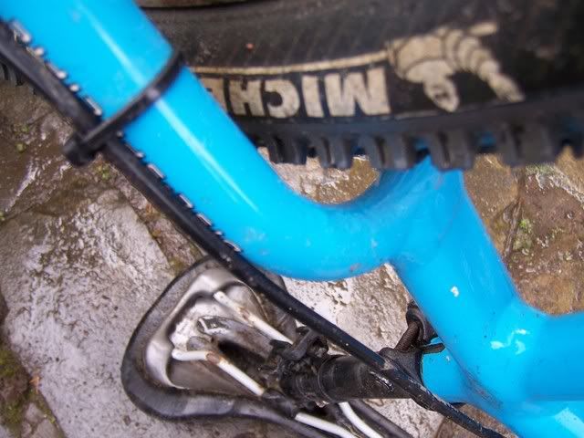

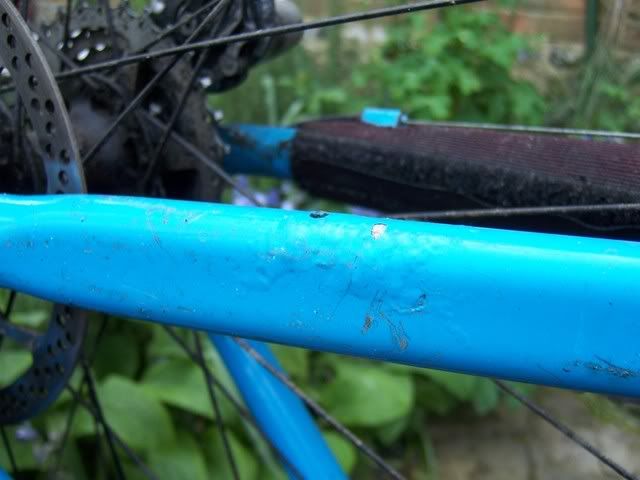

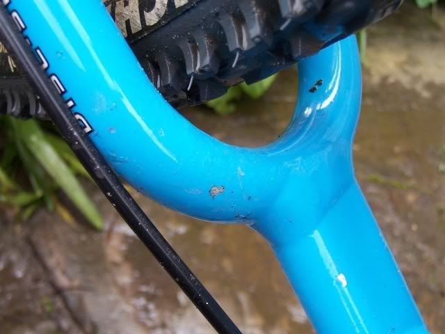

Please may I pick your brains about my bike? I've just been cleaning it after a ride & noticed some mini-style bubbling. ;) I didn't think aluminium frames rotted? :dontgetit:
It's a Cannondale, 7 years old, it's covered about 30,000 miles & been well looked after, but it looks like it's oxidising beneath the paint:
Rear of the frame, chainstay near the drainage hole:
and the rear forky-bit, just above the wheel (or below in this pic because the bike's upside down...)
It's not brilliantly clear, but it is bubbling.... :withstupid:
I've seen alu frames shear under the forces of a 15 stone gear grinder, but it is normally near the welds, but I've never seen this happen before.
Will my frame fail me? Is it time to get a new one? Whasshappenin' to my lovey-lovely bikie? ;)

Anyway, that oxidisation is caused by water/salt/mud etc getting onto the bare aluminium through damage to the paint. It is usually more prevalent on the back end, because it gets the most abuse - the chain slapping on the chainstays, stones, grit etc being flung up by the back wheel.
Depending on how bad it is you may get away with rubbing it down to good metal, then repainting and relacquering it. However, you say the frame is 7 years old and its covered a decent mileage - it might be time to consider looking at building your components onto a new frame. They're not designed to last forever, and the forces at work during normal riding (even with someone as petite as you Juju!) are pretty considerable, so the inevitable fatigue takes place over time. That is why most manufacturers only guarantee Alu frames for 5 years or less.
Thats my opinion though, other people may say differently :withstupid: Hope that helps a bit.

It looks like a 7 year old bike should do. My old Orange had some 'bubbling' on it after 2 years of intense riding. I got out the orbital sander and got all the paint off, took the rusty bits out, (luckily it hadn't gone all the way through) but just incase i got out the rotary tool bit cut around the rust and welded a new aluminium plate to it, then i sanded that off, then painted it over. Looks as good as new!

Yep think you've covered that in a nut shell Tom, although the first pic of the cahinstay does look abit severe!
Think it would be good to sand the frame back to metal then build the layers up as Tom said.

I was speaking to a friend of mine who studied aluminum corrosion as part of a uni course, said if you rub away all the corrosion and repaint it, it'll come back worse than if you rub it down leaving a little of the corrosion, then paint over it again. Makes no sense to me, but hey!

This could be something to do with the fact that bare aluminium protects itself from corrosion by forming a thin layer of oxide over itself.

Sorry, no I haven't had it happen to me, but I do know that the tubes are pretty thick, so that sort of corrosion isn't wortth worrying about in terms of your bike snapping.

Cheers Tom. I have a couple of mates in the business so I will get a 'second opinion' before we pronounce her dead. I might we worrying aboot nowt. She may well go on for another 30,000.......it might just be down to the niggling at the back of my mind that the next ride could lead to a stint in hospital & a new bike. :wub:
And no, the alu tubing is no way near 3cm thick, 3mm mebbe....... :wub:

I took my bike to see Uncle-Dan-the-Bicycle-Repair-Man in Dorking, and he said "Oooh, Dear. Best contact Cannondale." :)
I've emailed them the piccies & described what has happened.
Now I'm hoping Cannondale will honour their lifetime guarantee policy. One can but try..... :wub:
