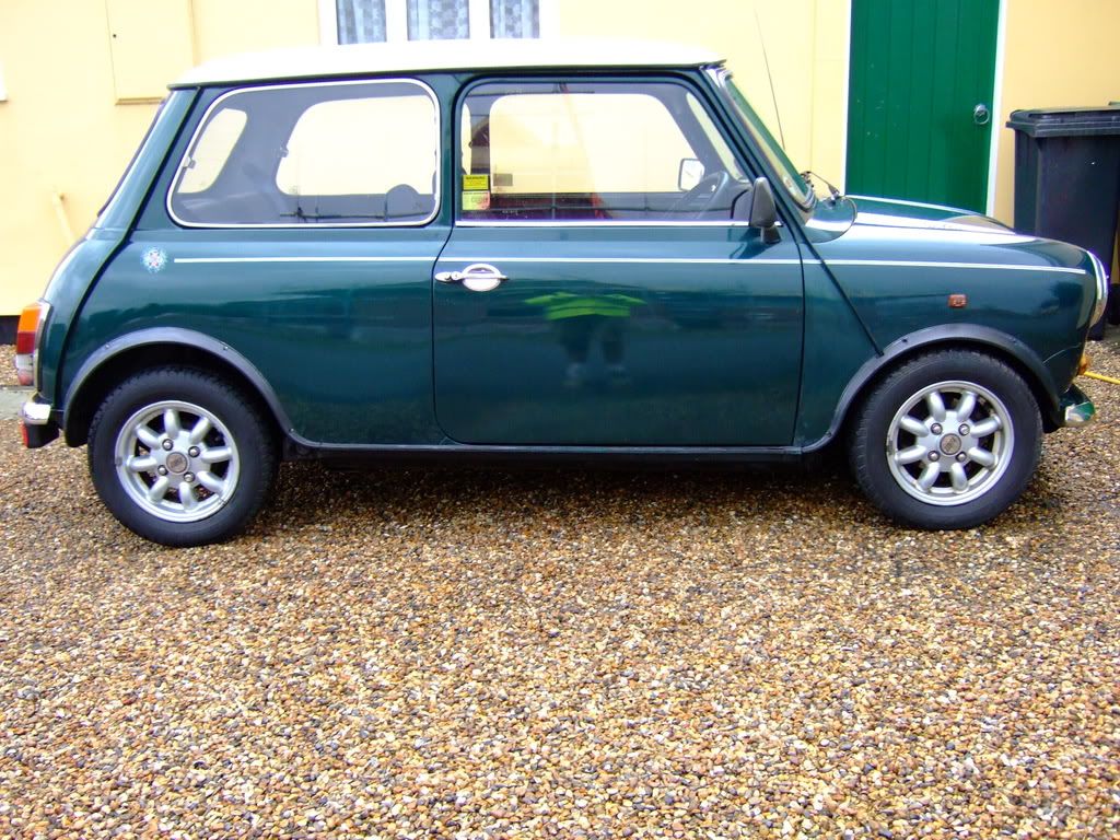

simple thing would be to post a picture up of the side view of your car, then we'll be able to say whether it's abnormal or not...

Posted 07 May 2008 - 10:24 AM
i have got a picture but i dont no how to put it on here so could you please help??
thanks
#12 BRcooper91
BRcooper91
  • 145 posts
Posted 07 May 2008 - 10:31 AM
http://<a href="http://s278.photobuc...t=DSCF2275.jpg" target="_blank"><img src="http://i278.photobuc...1/DSCF2275.jpg" border="0" alt="my 1991 mini cooper"></a>[/img]
there you go hope it works
#13 BRcooper91
BRcooper91
  • 145 posts
Posted 07 May 2008 - 10:32 AM
http://i278.photobuc...91/DSCF2275.jpg
dont no if they will work im new to this thanks

I would say the front has sagged slightly over time but not too badly. New front cones and knuckle joints may be a worthwhile investment to get it back how it should be - hilos would only mask the wear and tear it shows.
Obviously if you want to lower it then hilos are the answer - along with shocks designed fro lowered cars if you go more than 1" down. However it would still be sensible to refurbish the front end components even if fitting hilos.

ok thanks big help is there any sort i should be looking for or are they relatively the same quality please so just the front knuckle joints and front cones?
no i dont partically want to lower it i just didnt know why the front was sitting lower than the back
