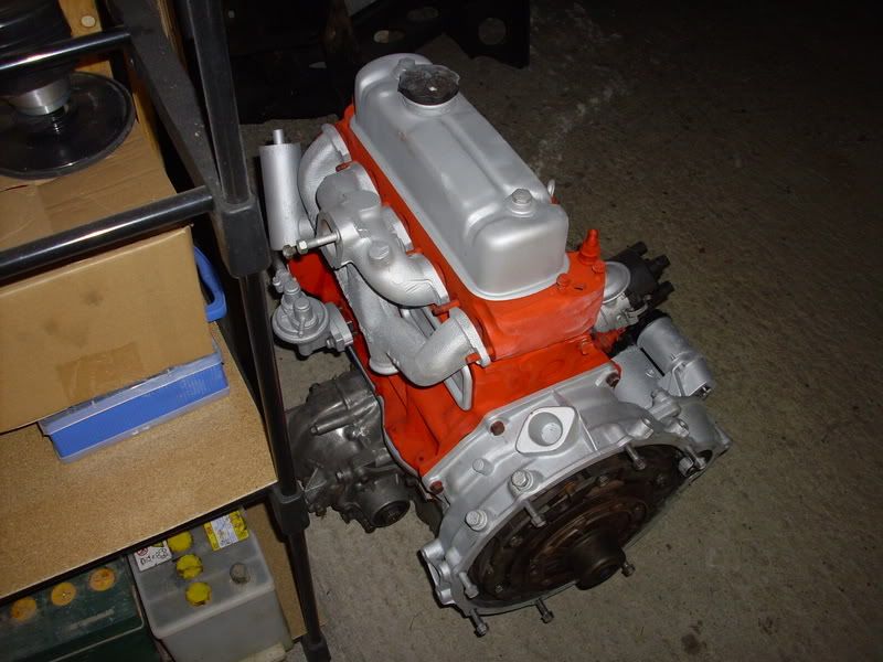

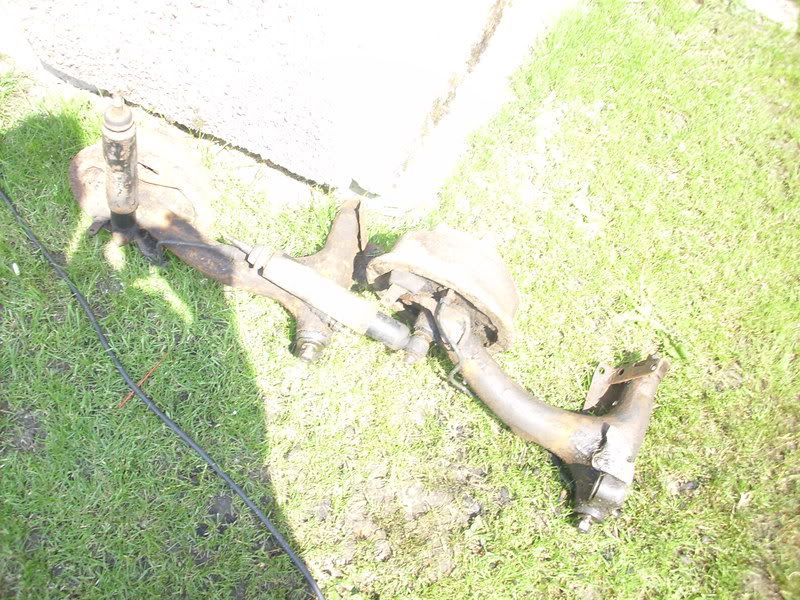

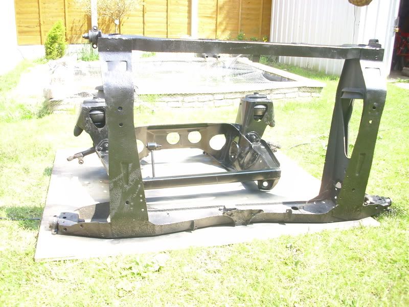

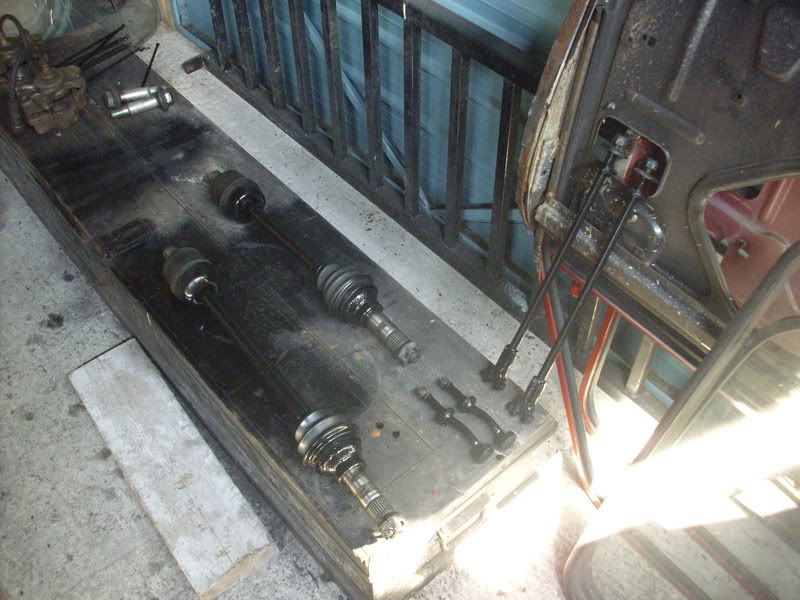

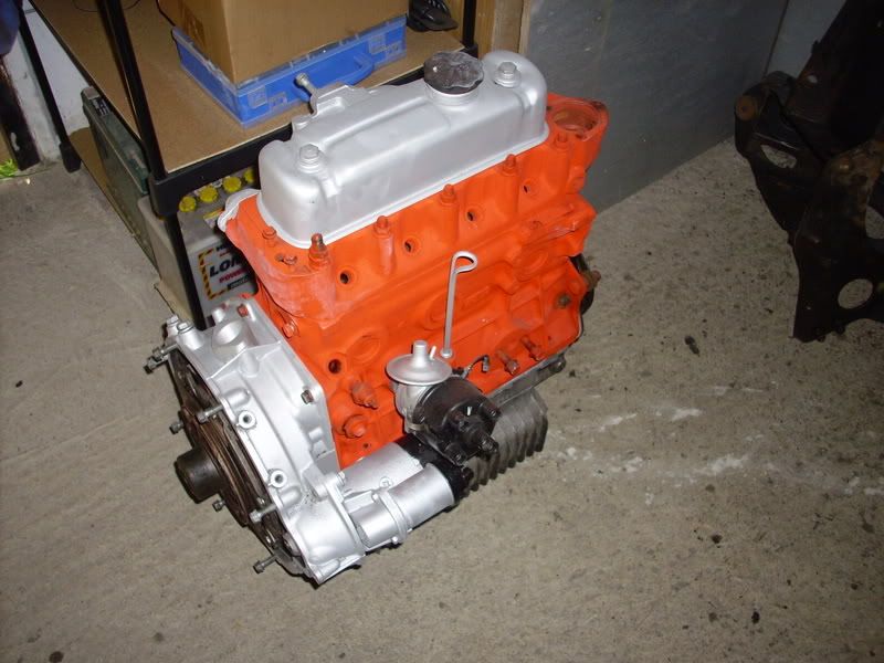

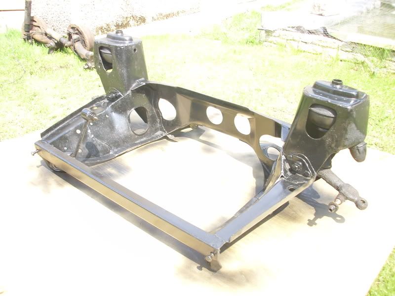

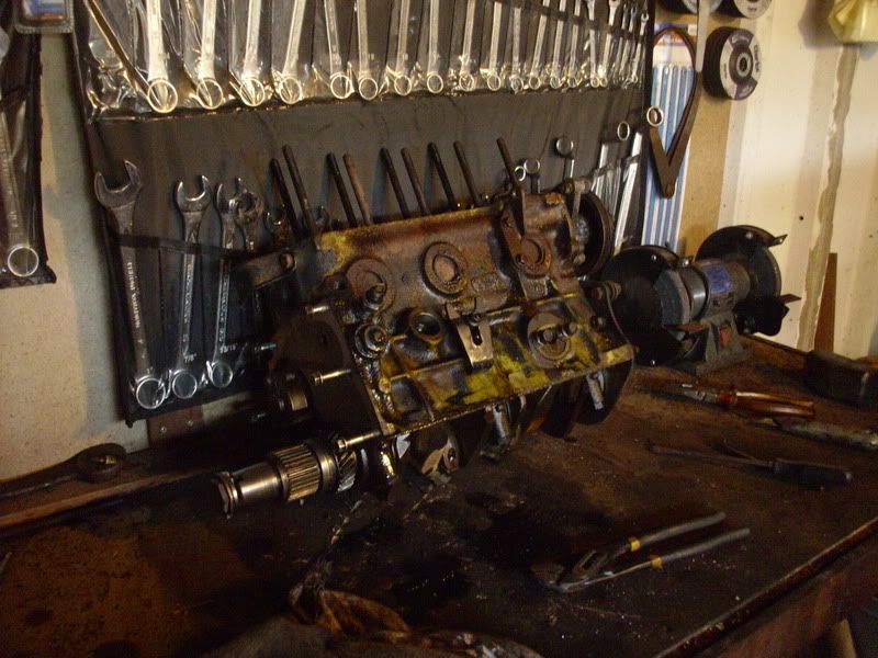

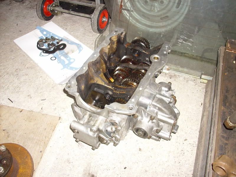

the gearbox has now been striped down and rebuilt all new gaskets ect the block is next the cyclinda head is holding everything up now need a unleaded one the subframes and some other bits have been painted and most of the bits in the engine and been cleaned
some picys:
Danny

Posted 25 May 2008 - 07:19 AM
have you marked and remembered which slots the pushrods came from?
From looking at the engine code... Your engine is a 998 that should have flat top pistons with circlip wrist pin retention ;D
Edited by Retro_10s, 25 May 2008 - 07:19 AM.

Posted 25 May 2008 - 10:40 AM
dont no i didnt do ma dad did al find out what will happen if i didnt?
#37 Retro_10s
Retro_10s
    Moderator
  • 10,186 posts
  • Location: Worcs
Posted 25 May 2008 - 01:17 PM
Well it's not the end of the world but each Pushrod will wear to it's own rocker head and follower,.. so it's nice if you can keep them together as a matched 3-some, it's general practice to do it that way when building/disemboweling engines,....

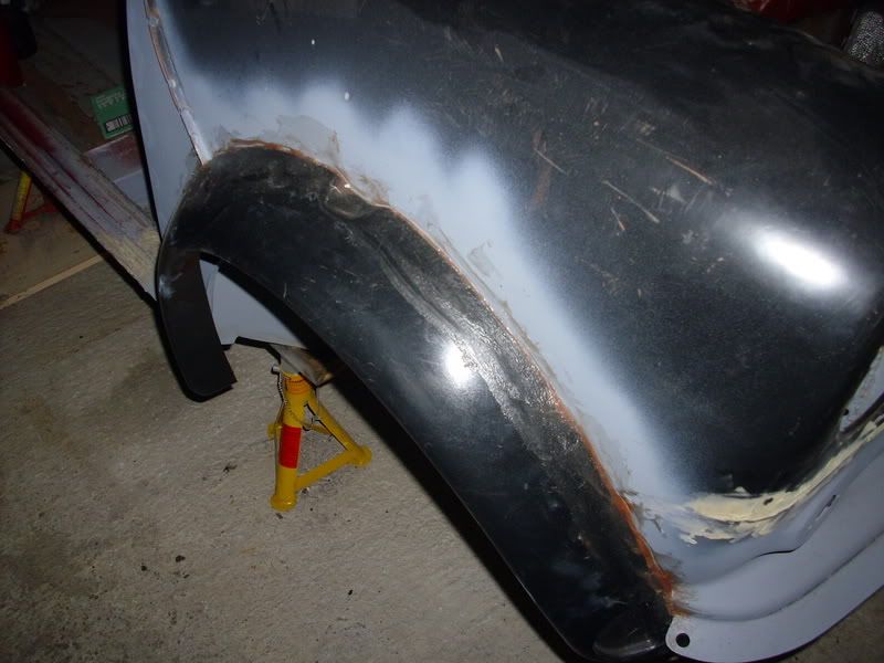

you made a nice job of the arches! are they the rubbery ones or the fibreglass ones?

rubber they gotta come back off and their not proberly not yet to get primer behind them yet

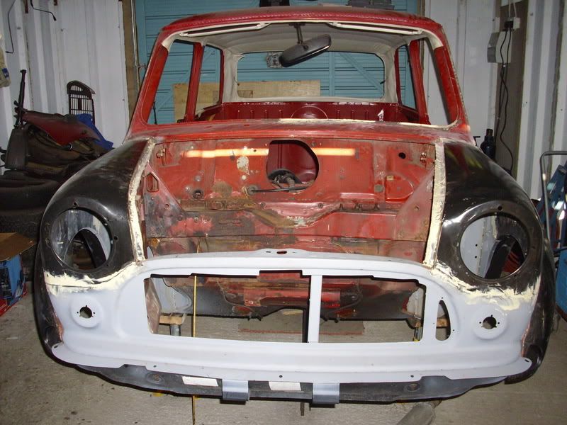

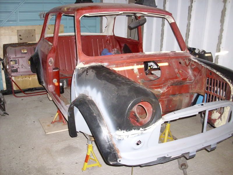

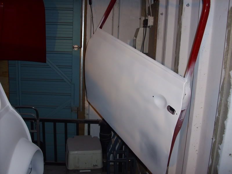

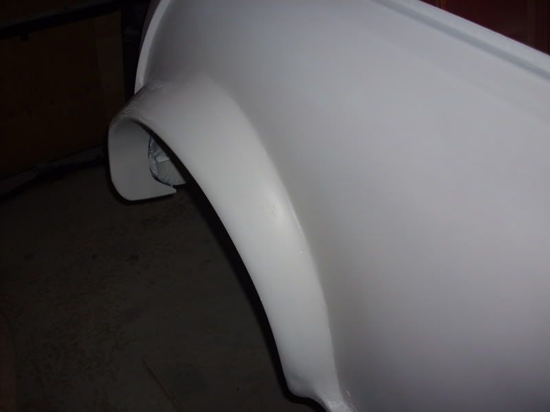

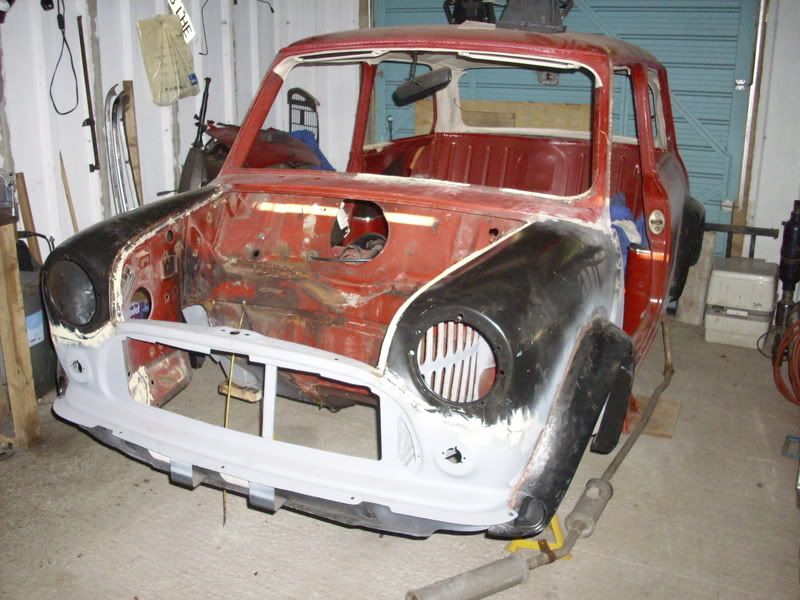

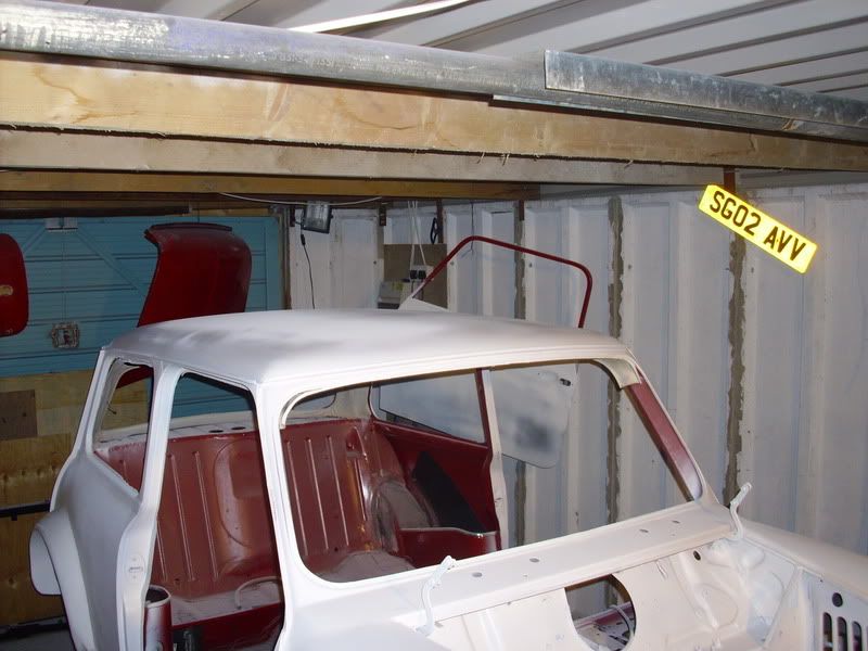

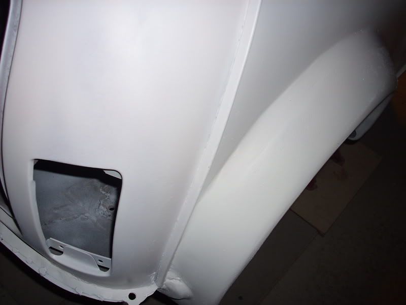

hi got a update

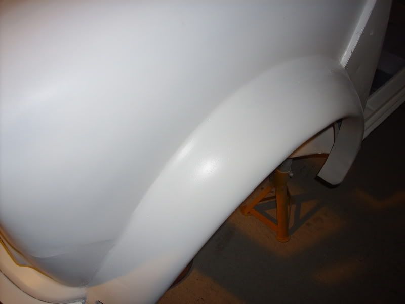

the archs have been fibreglassed on to the body now still gotta put filler over that yet
the engine is almost finish got the last set of gaskets yesterday and everything is painted
i bought a air sander yesterday too nearly ready for paintin the body
and i have ordered some more parts from moss

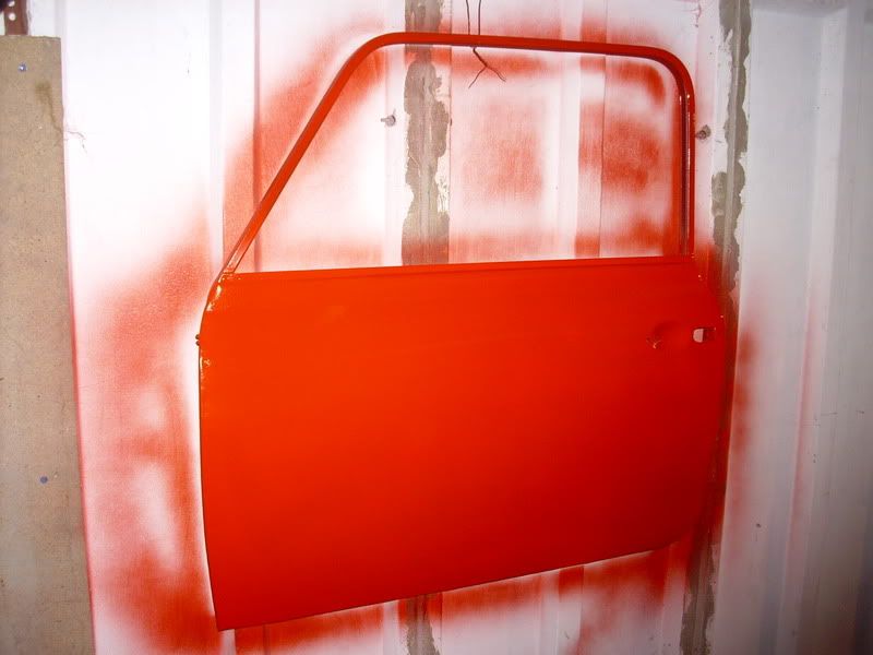

left and right door skins
bypass hose
some bushes
thermostat
2 bump stops
and a seal rubber ring on the top arm
goin to pick them up next sat
here are some pics:
thats all for now
thanks
Danny

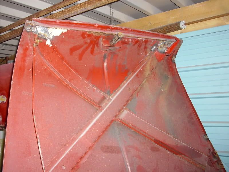

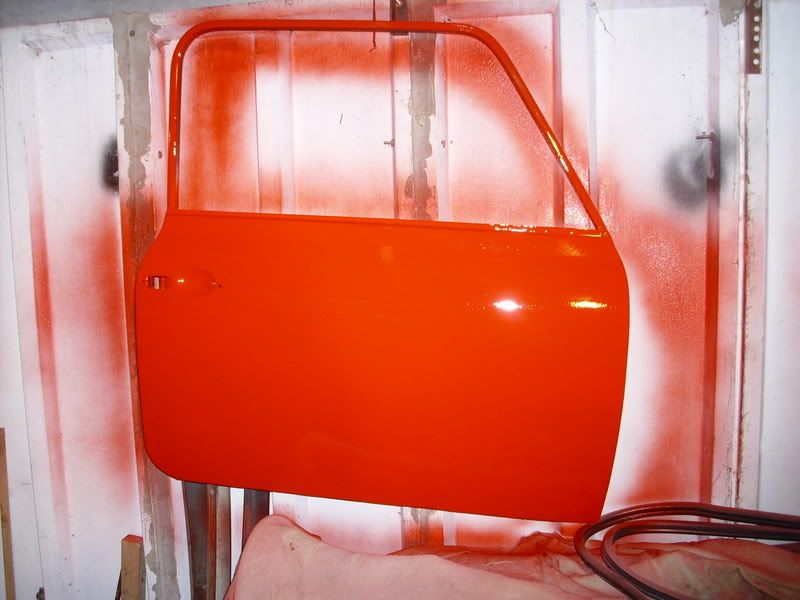

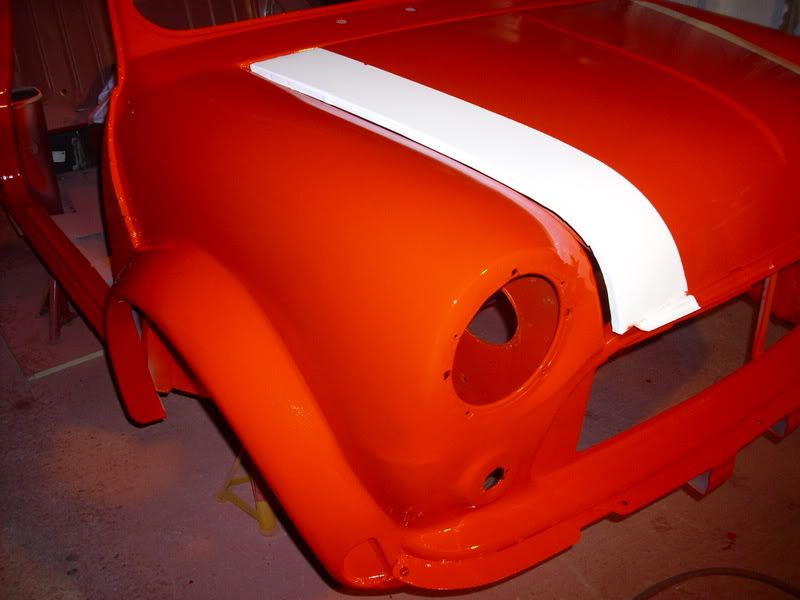

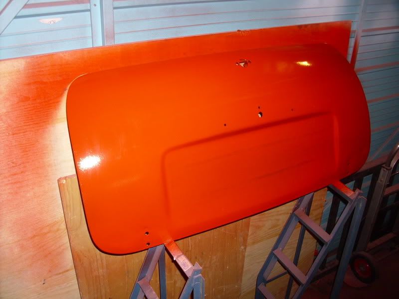

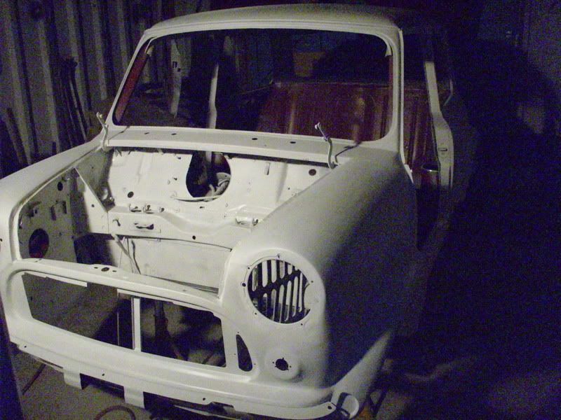

hi all get another update
what has been done
1. bonnet has been rapaired it started to crack at the sides and their was alot of filler to hold the catch in
2. the engine is finished just got get a new clutch disc
3. the car has been primed

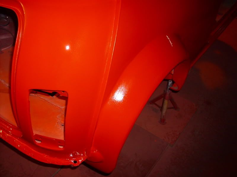

4. the car has been paint needs a few touch ups
5. door skins are on
i ran out of primer on the doors and i didnt paint the inside of the car to save money i am just gunna get a spray can for the bits u will be able to see
Danny
