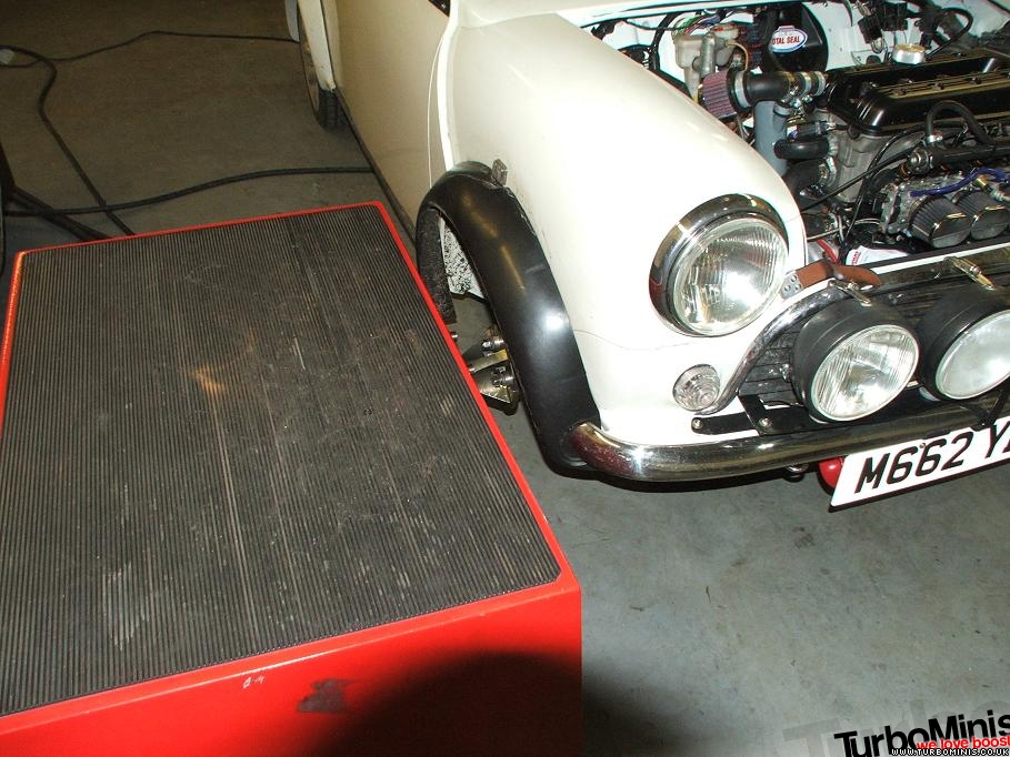

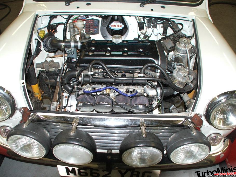

Dyno session was yesterday and it was not without issues, nothing major, but mapping the ignition was aborted. there is a little more power (3bhp I would hope to take me to my lower target) to be gained in that area alone, or at least thats what my mapper tels me.
Also remember that the inlet cam is the lower lift shorter duration item, so I think the final results so far are on the money.
I think i'll bung the RS inlect cam in it before the dyno shoot out :xmas:
107 bhp at 7300rpm and 81 lbft at 6400rpm.
It drives amazingly well, thats the bit that really matters and, if anything, I am at the same level as i was with the 1400, which is all i really wanted. I would have found it hard to accept if it was anything less than the 1400
