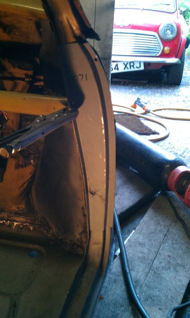

next on my list is the A post repair
pic doesn't show it very well but the edge the A panel welds to is very thin and pin holed, so a repair panel has been bought
tomorrow I'll be welding some box section into the door frame to help avoid anything moving then i can go about cutting out the old metal
