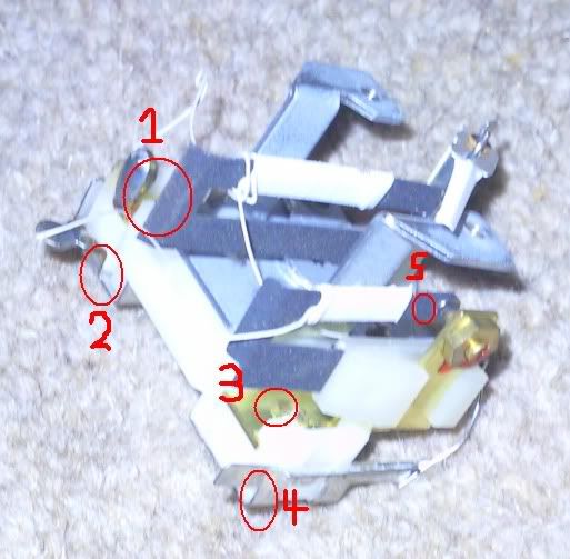

got some pictures now
thats my fuel gauge needle set up

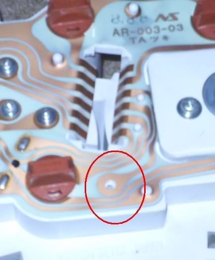

also found part of the printed circuit that makes no sense to me

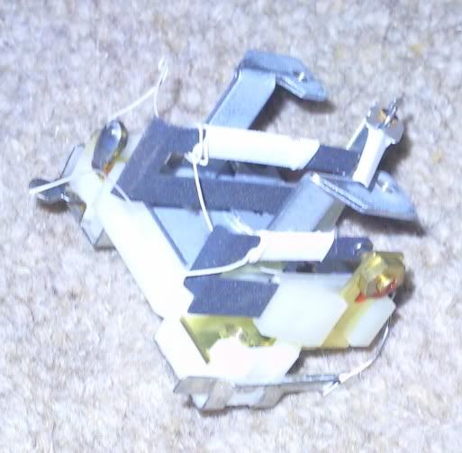

#9 stormintrooper

Sorry Stormin but your gauge is essentially exactly the same as the one posted in the thread Doug linked (sorry I didn't reply Doug, I've been away for new years). I think the apparent difference comes from the fact that later clusters have both the minor gauges mounted to one frame where yours have them as seperate units. The second bi-metal spring on that unit is the voltage regulator, it has adjustable points. If you were to apply 12v to this gauge you would see the spring vibrating. The points are adjusted until the mean voltage produced is 10. The PCB has unused tracks, remember that when this gauge cluster was first designed by Smiths it wasn't used exclusively in the Mini and even in the Mini it wasn't only used in the UK. Other territories have laws requiring extra warning lamps and electronics.

ah right ok...well in that case i need to figure a way of applying a constant 12V.......any sugestions? and also what is done to adjust them if the voltage is too high/low?
is it to do with the little brass nut?

#12 stormintrooper
stormintrooper
  • 2,072 posts
Posted 04 January 2010 - 12:05 AM
and ok yh just looked at the other picture and now i recognise it from another angle/upside down too :)

Surely you can come up with a source of 12V, I assume you have a car bettery there somewhere since you have a car! :) Actually you should be using 14 volts but a freshly charged battery will be good enough. Make a test rig (including a fuse) to connect 12v to the voltage stabiliser input and earth the gauge output (yes the needle will move). Then check the voltage at the junction between the stabiliser and gauge heater elements. It needs to be close to 10v. As you suggest, the adjustment is by using the locknut and the screw of the points. Check the points are dressed flat though, they work just the same as ignition points do and pitting will cause them to operate early. Be subtle, it doesn't take much adjustment and you don't want to ruin them. The varnish is just to lock the nut in place, you should find it will crack away easily enough and it can be replaced with nail varnish once you are finished. If you want to replace it with something solid state, cutting out that whole heater element and replacing it with an appropriate Zener or other chip will be quite simple. You will just need to add an earth.

is number 2 the stabiliser input? and does it matter whether i use points 3 or 4 as a ground as both points are joined by wire as far as i could tell?
and is number 5 where i should test the voltage?

Posted 04 January 2010 - 12:49 AM
From the photo, and only having one angle, I find it hard to tell. Can you take a photo with a clearer angle on the layout of the wires? You will need to earth the stabiliser and the gauge heater. I would say that 2 is probably the stabiliser heater input. The voltage should be checked at the input to the gauge heater. As I said though it's hard to tell without more of a clear idea of the layout.
