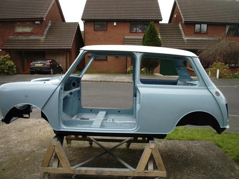

The shell arrived 3 weeks later after sorting out shipping.
New shell!!! Was a bit skint after that so the project slowed down.
The plans were for a retro mini with modern features.

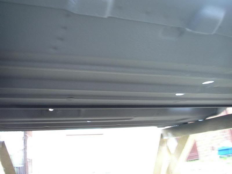

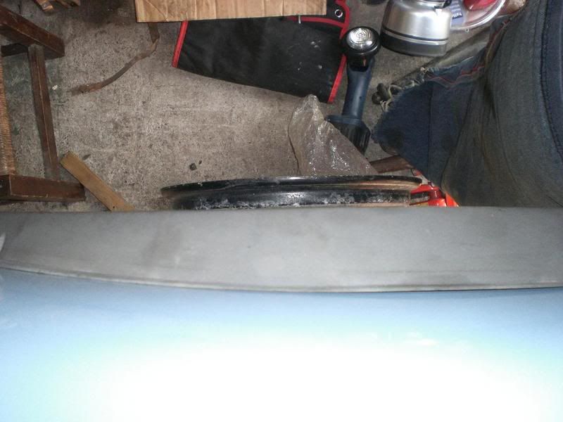

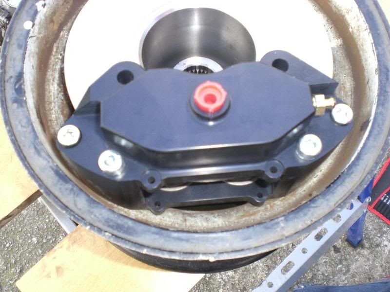

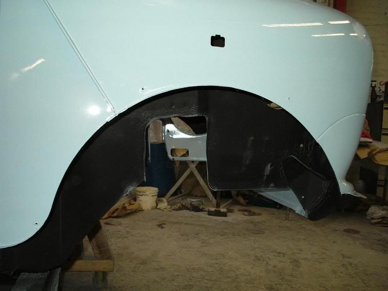

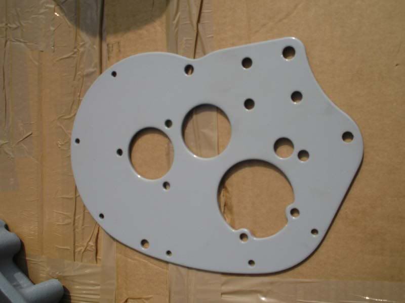

I had done all the seam sealing by now, no point in showing the pictures, they are boring. Got my new brakes but they didnt fit and stripped the engine from the box for the new engine i was building.
Here is my gearbox ;) MMM oily.
Rear arch fitted.
Front arch fitted.

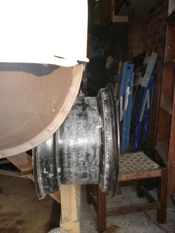

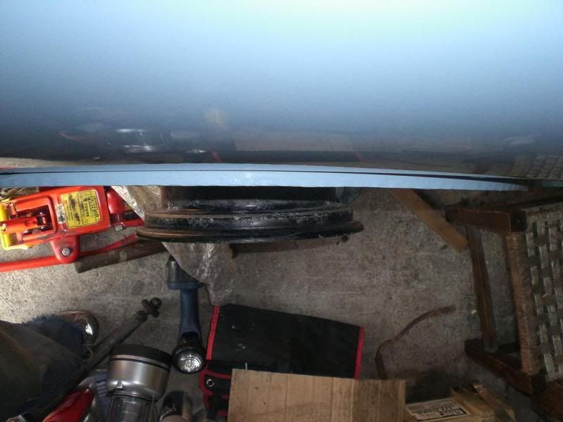

Just a slight clearance problem....
Touching.

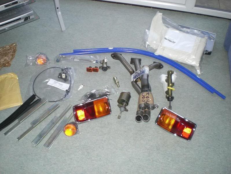

My special order arrived as well as the shell getting booked in for the paint job.
MMMM lightweight
MMMMMMMM ;)

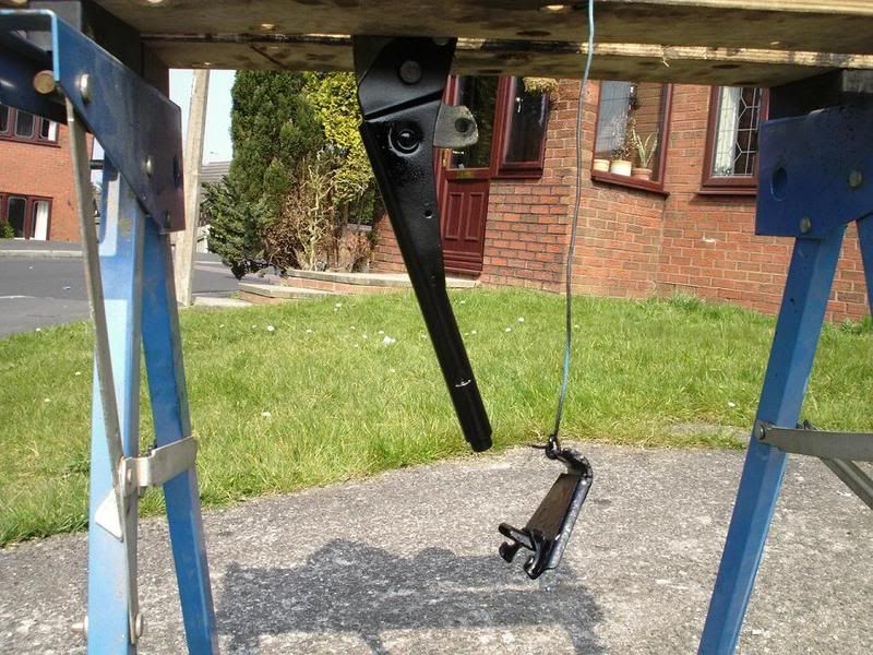

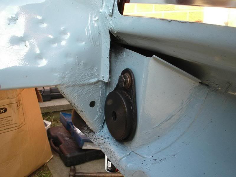

Also started working on the suspension components, cleaning them up and painting them.
Rear Subframe Mounts
Before
After

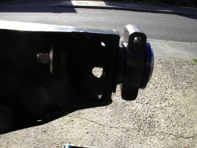

Radius Arms
Before
After
Rear Hub
Before
After

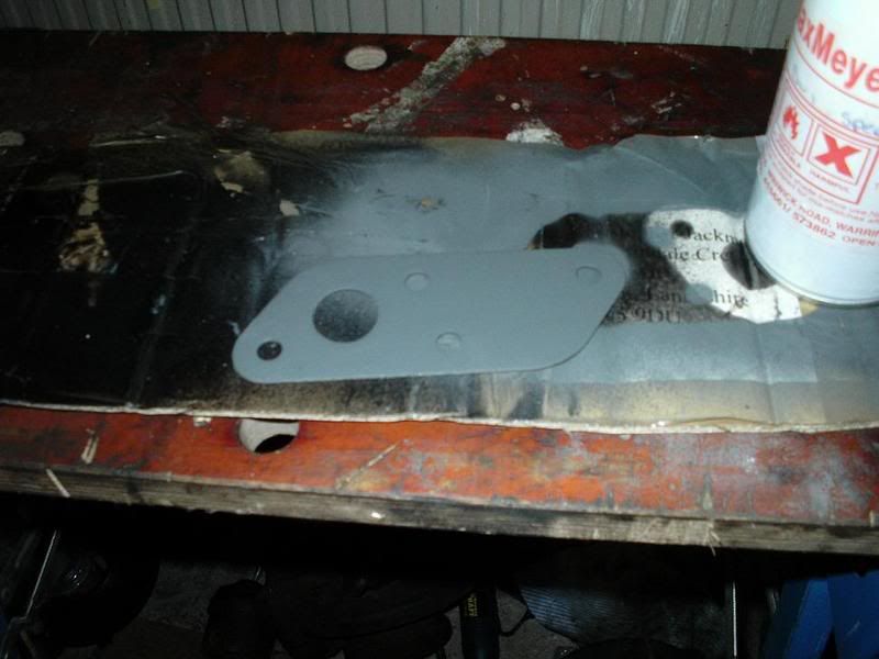

More cleaning and painting.
Got it to this.
Finaly this.
Cleaned these up.
Nice and clean.
Sprayed.

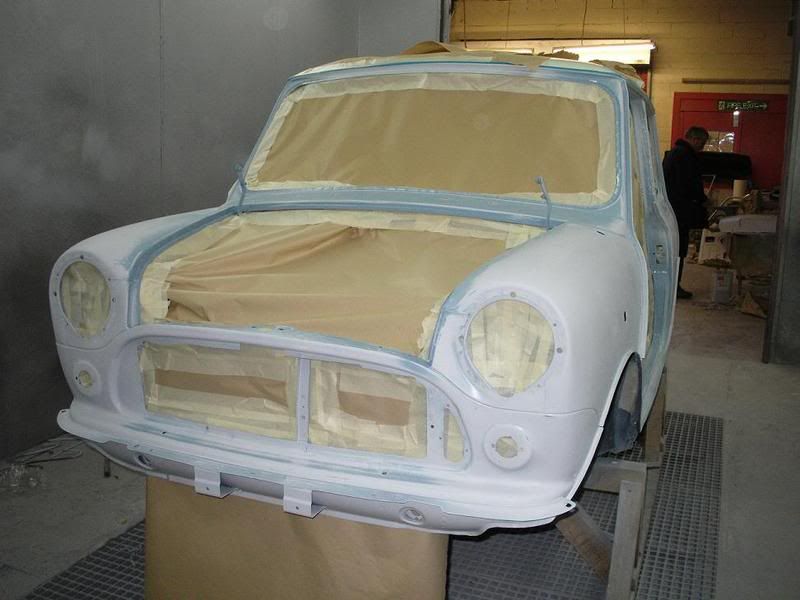

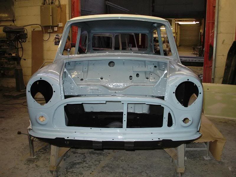

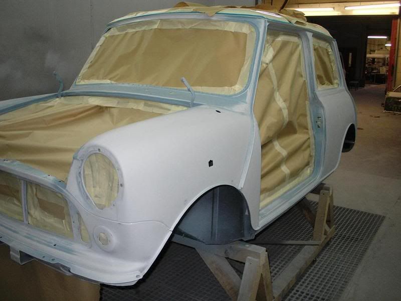

Then went to the spray shop to check on the progress with the spray job.
They had rubbed it down to get it smooth and also fixed a few dents and marks it in, including the big one on the roof.

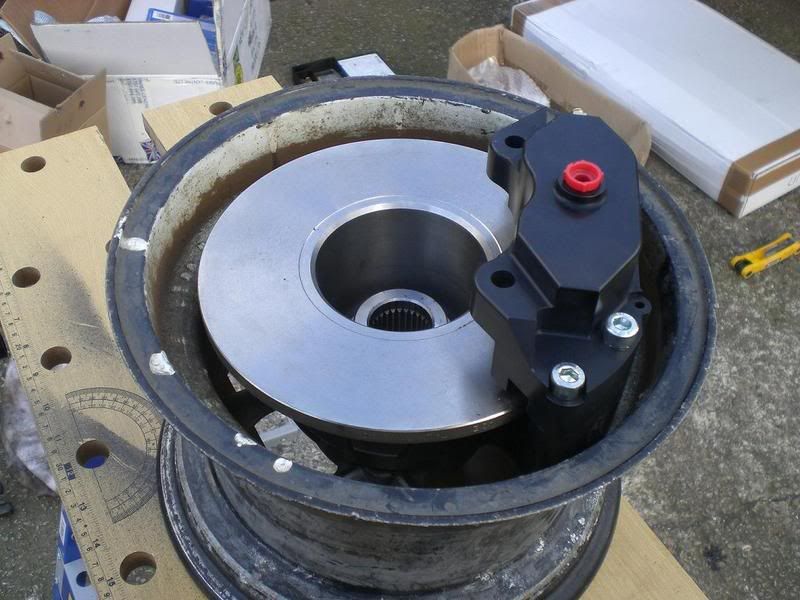

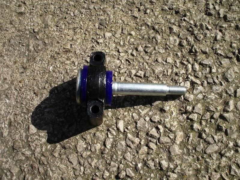

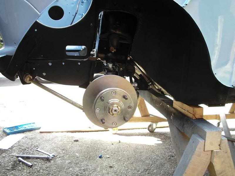

I finished off the spraying and began on the front hubs, one went together fine, the other well one of the bearing will not go in at all so its in the freezer, my dad said thats the best way so my mum allowed it ;) He gave me a hand tonight so i can learn how to do the hubs.
The parts
One bearing liner in.
Built up
Built up front
#7 Jackman
Jackman

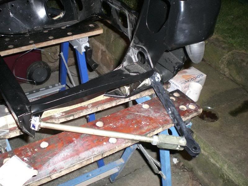

  • 4,053 posts
Posted 05 February 2008 - 10:18 AM

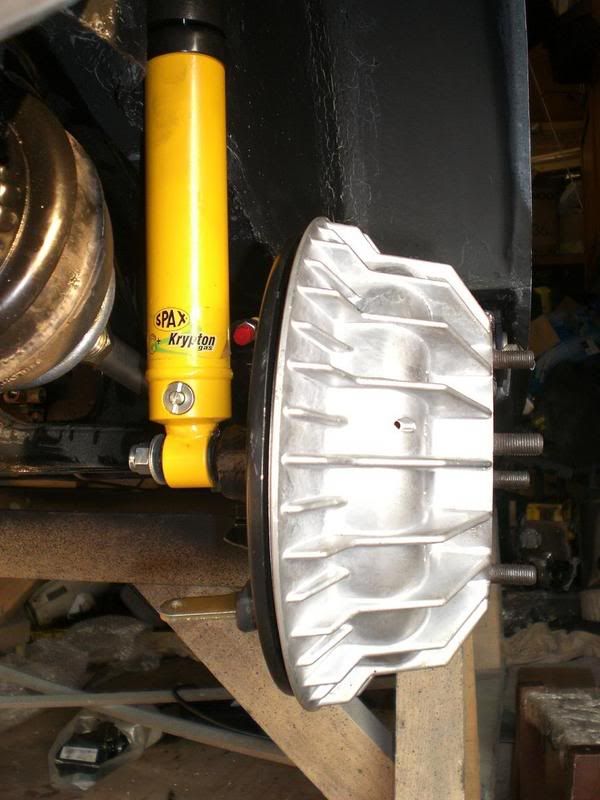

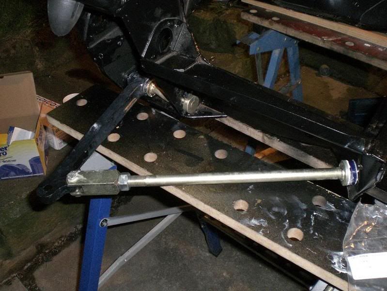

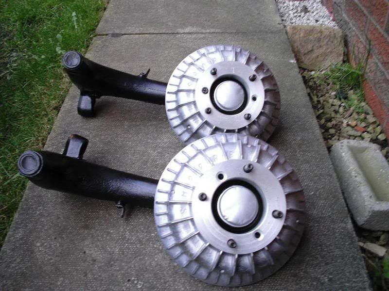

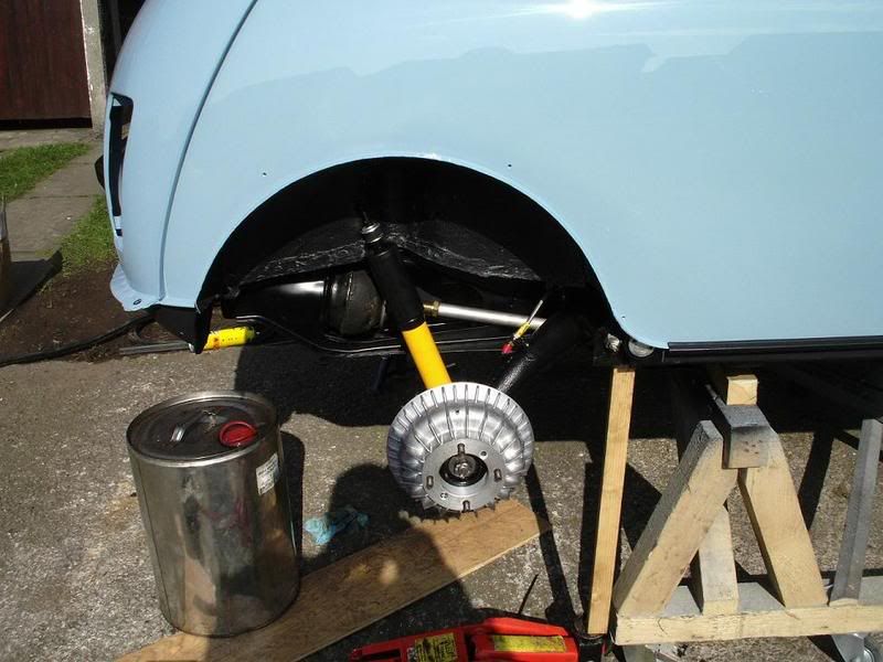

Built the other front hub so thats done and started on the radius arms.
The last disk :D
Parts to go on the radius arms.
They are on :angel:

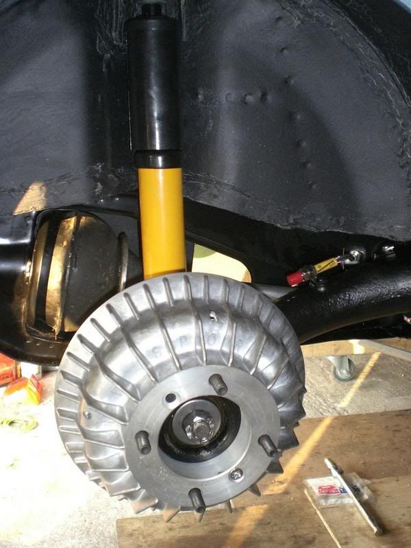

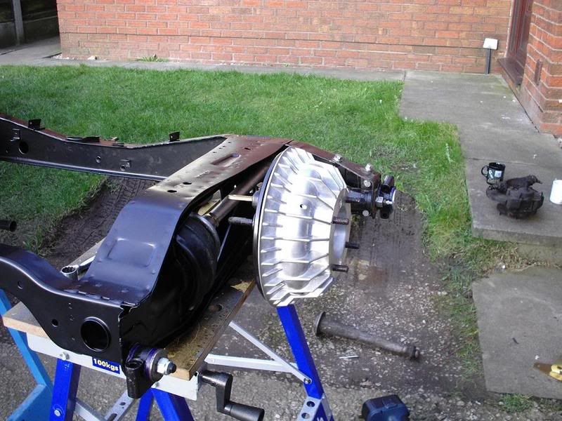

Rear hub built.
Drum on ;)

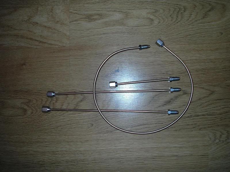

These also arrived today :cry: Rear subframe brake lines.

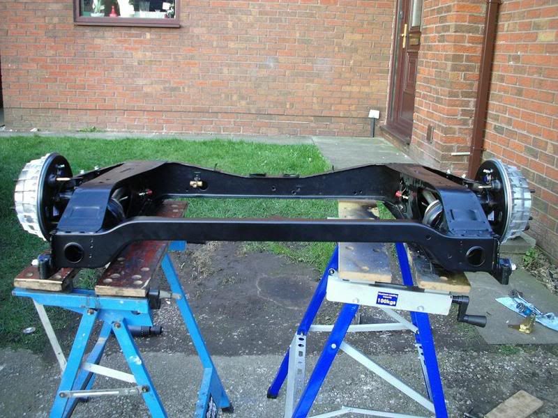

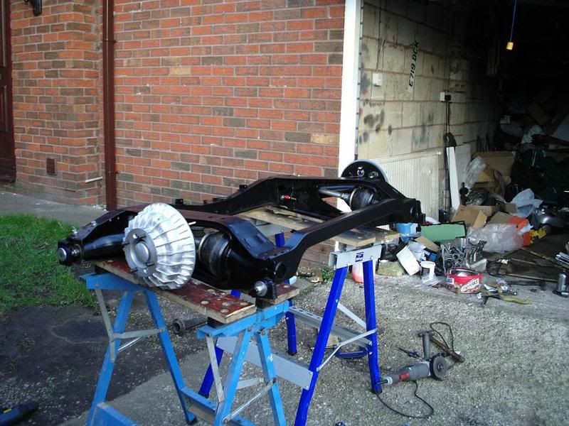

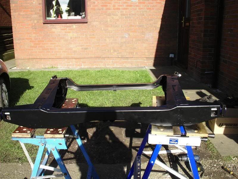

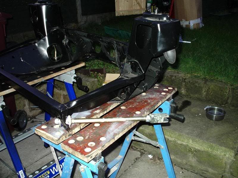

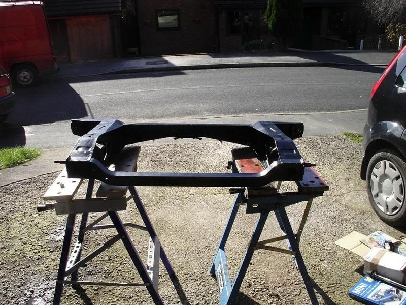

Started work on the rear subframe.
Emptied Moss of the nuts and bolts.

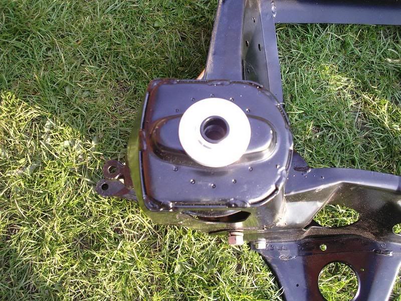

The powdercoated subframe.
Subframe mount built
Put on subframe
Front one done
All Four
Hi-Lows and new cones.
One radius arm on.
Both Radius arms on.
OOO pretty.

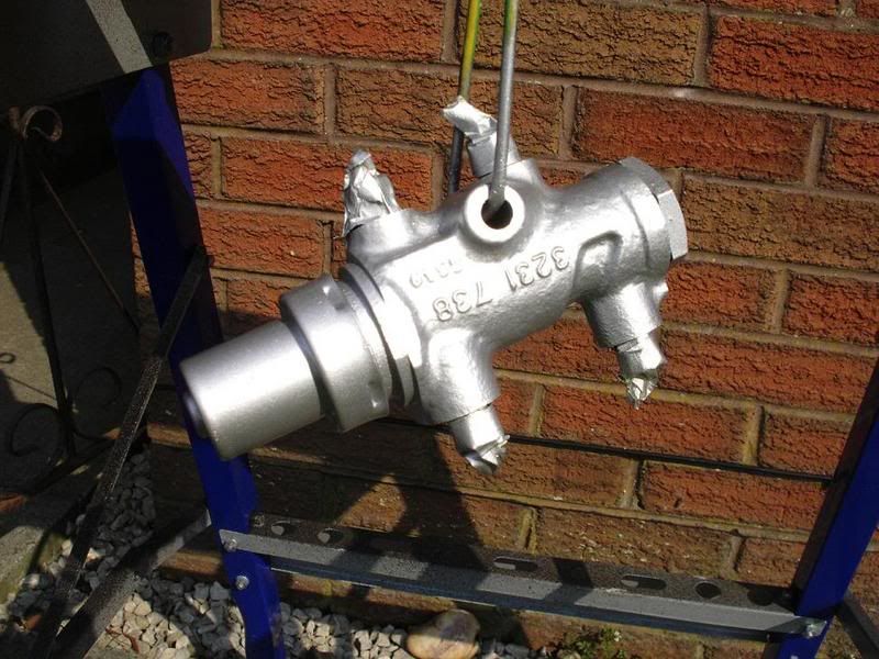

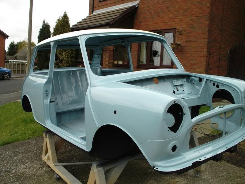

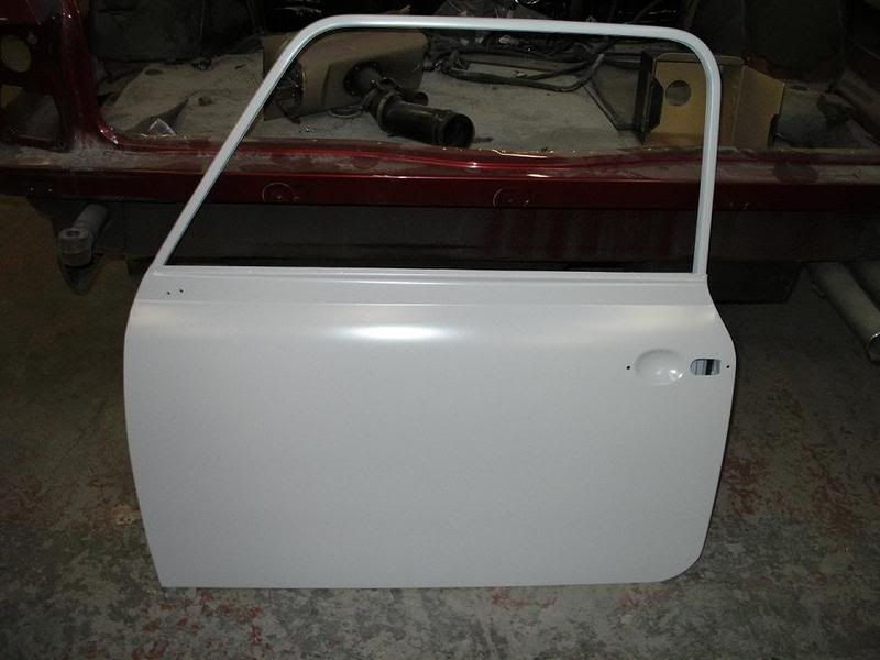

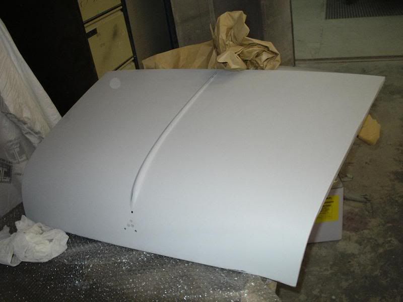

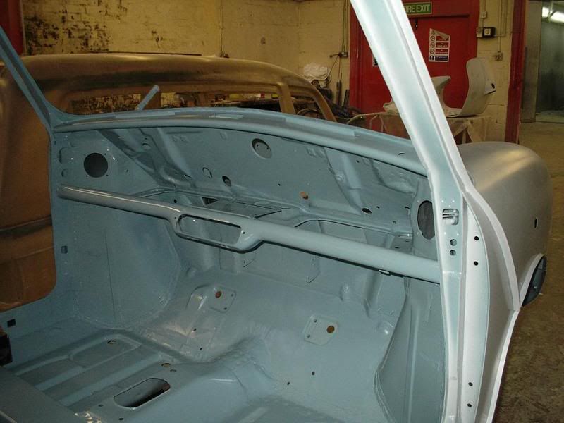

Another update on the shell, it was primed.

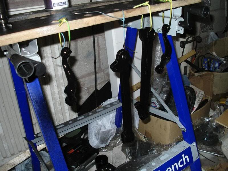

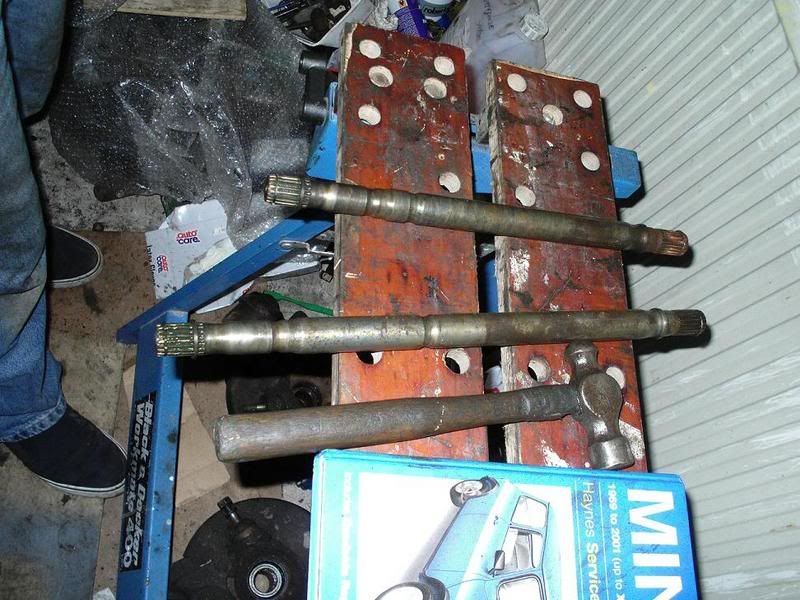

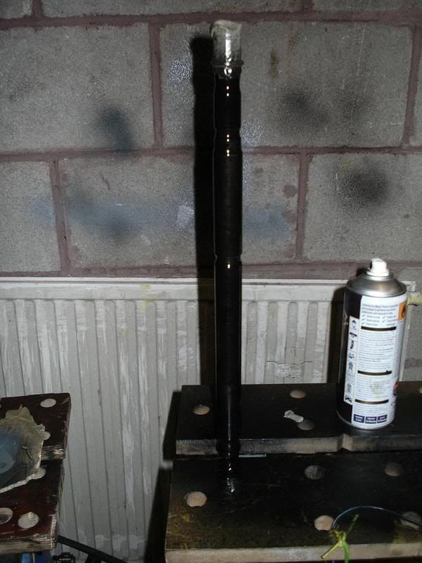

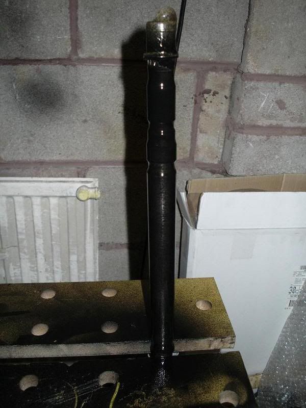

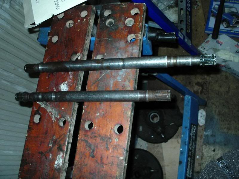

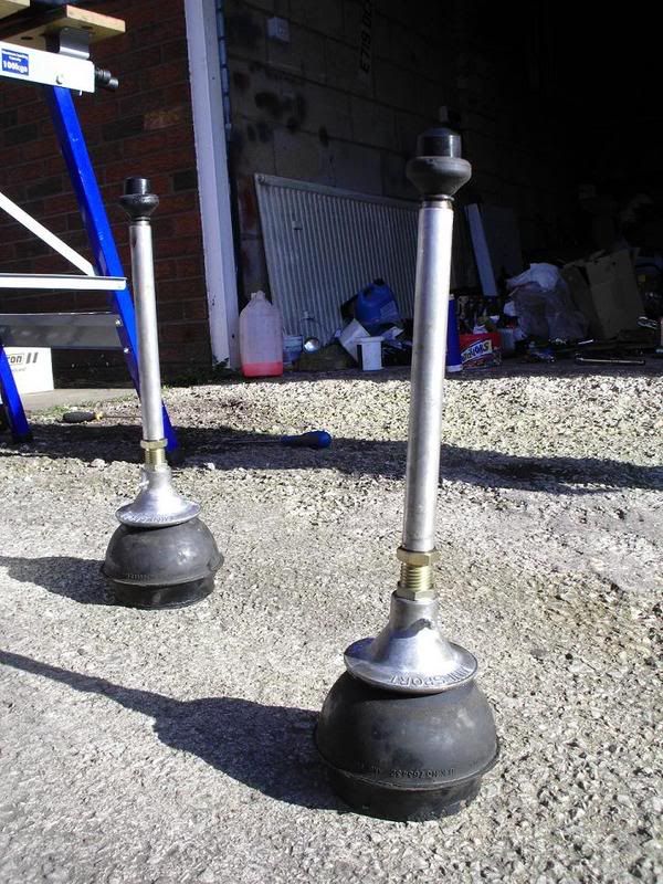

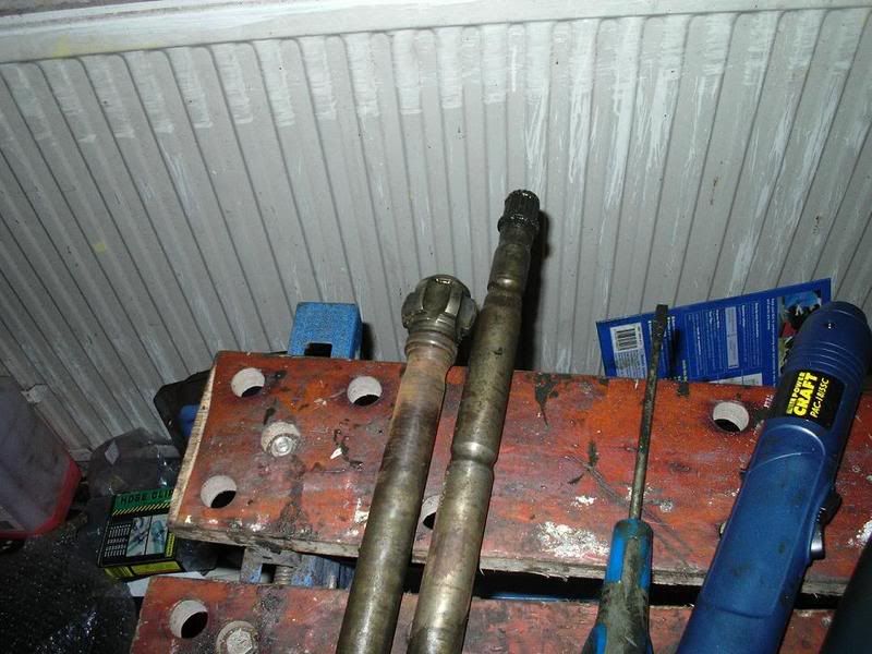

Striped the driveshafts ready for paint.
Done more sprayng today, here are the cleaned up driveshafts.
One Painted
Other Painted

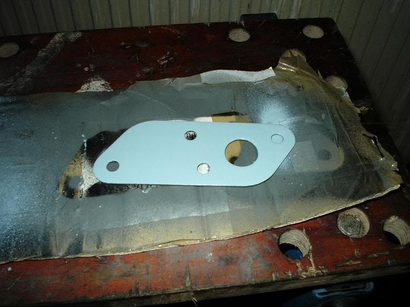

Some more suspension compoents painted.
Here is another part, forgot its name.
Primed
First coat

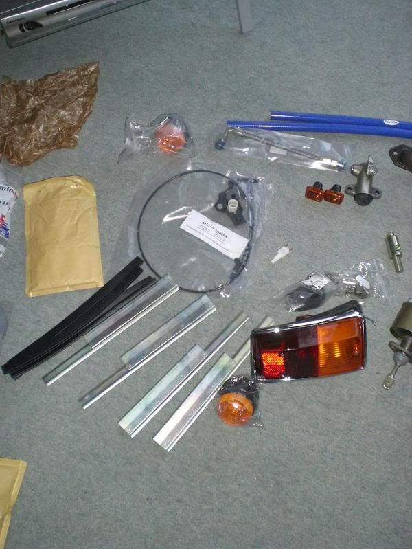

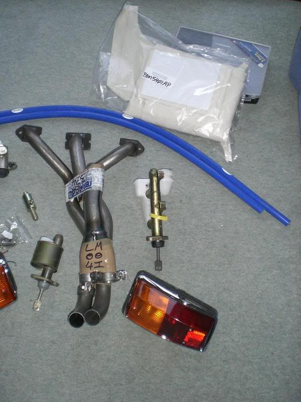

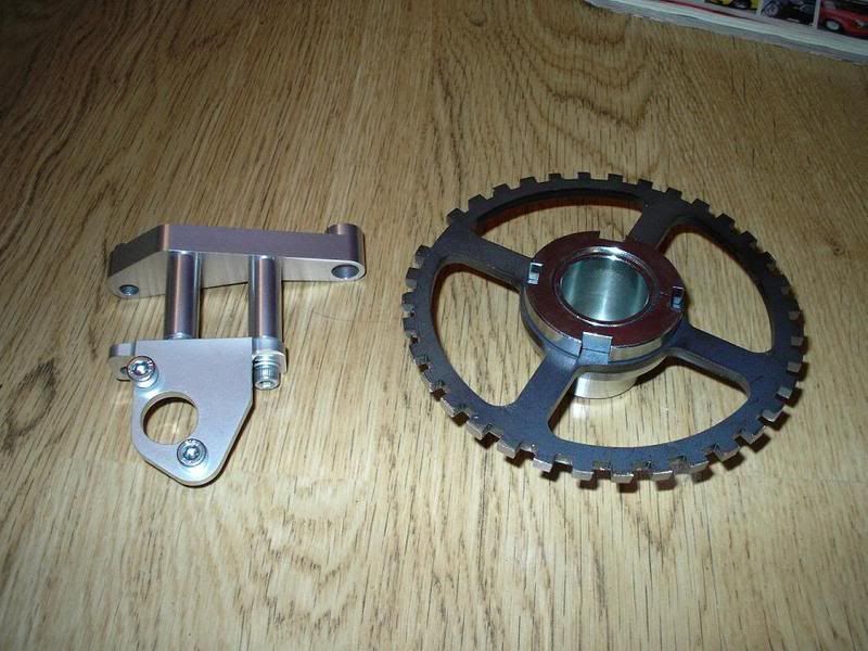

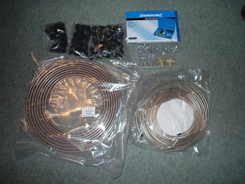

My brake and fuel lines arrived as well as other goodies.
And my new trigger wheel ;) Bling.

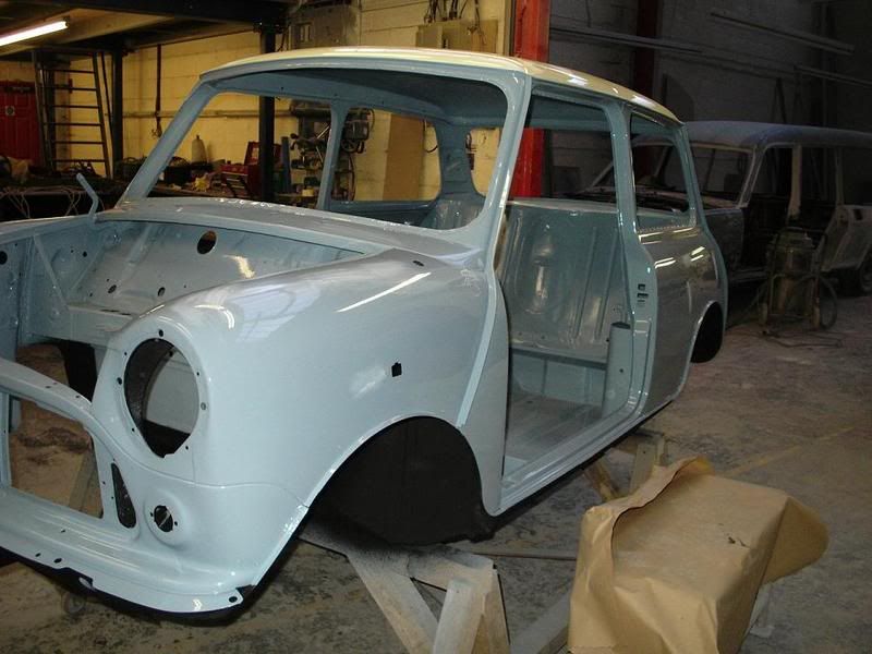

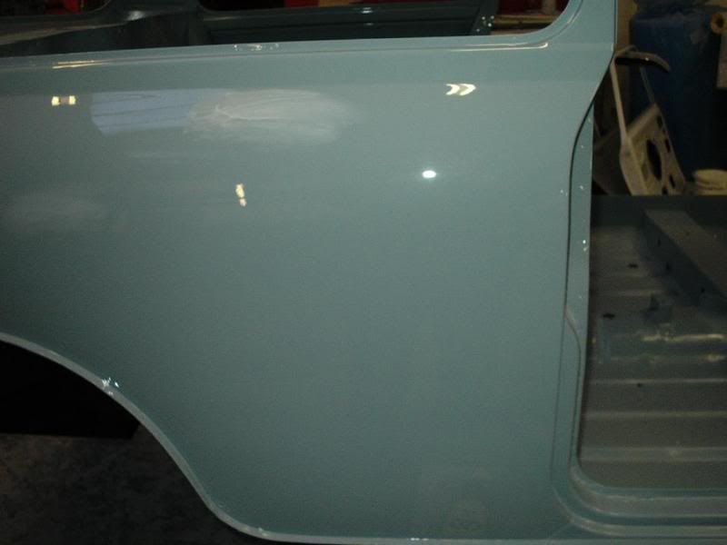

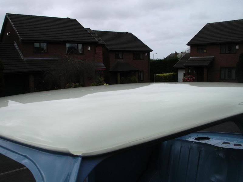

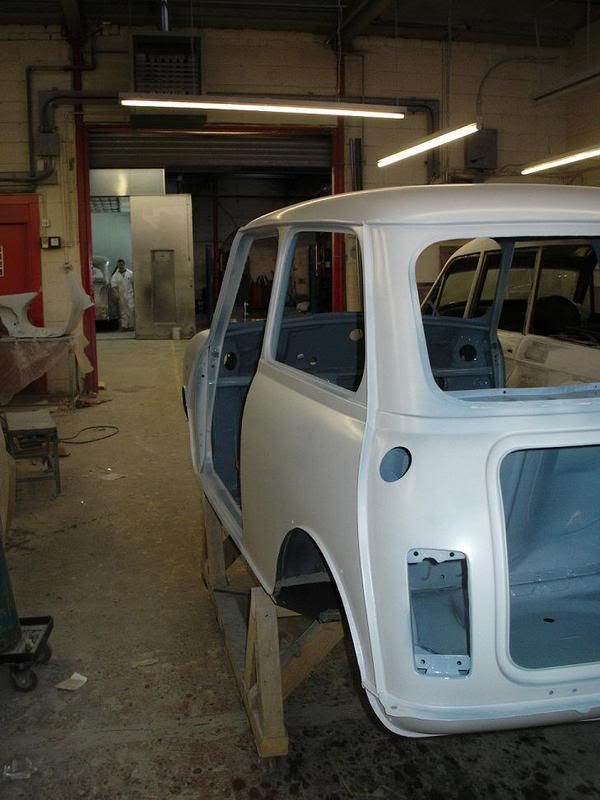

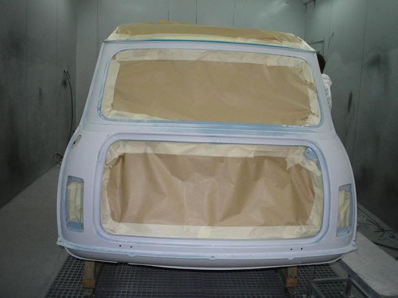

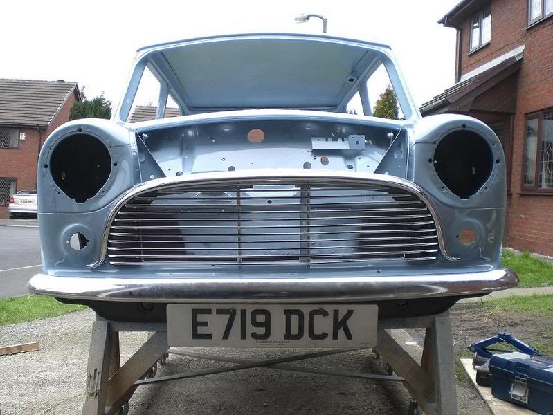

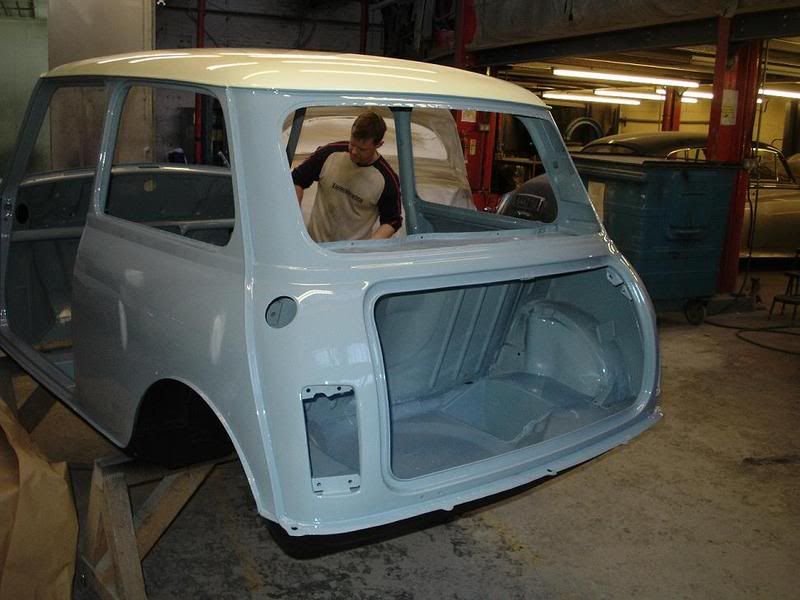

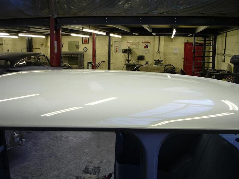

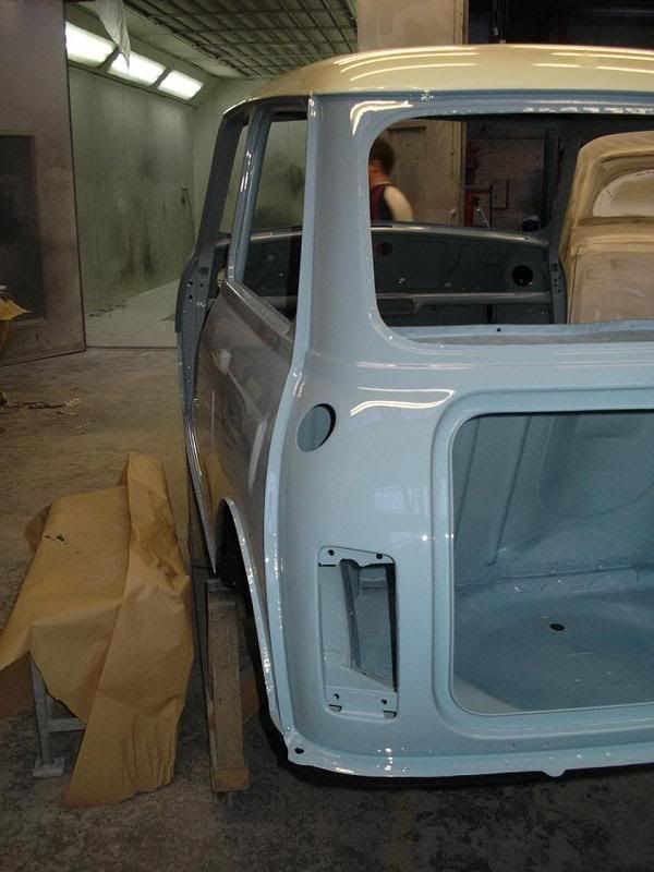

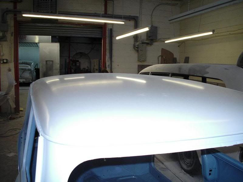

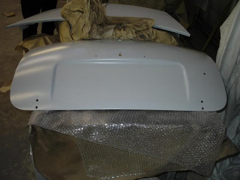

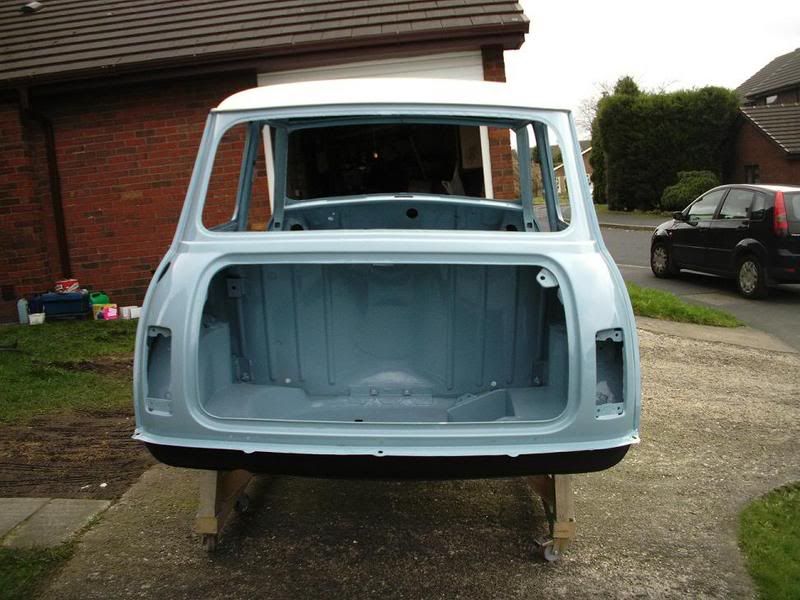

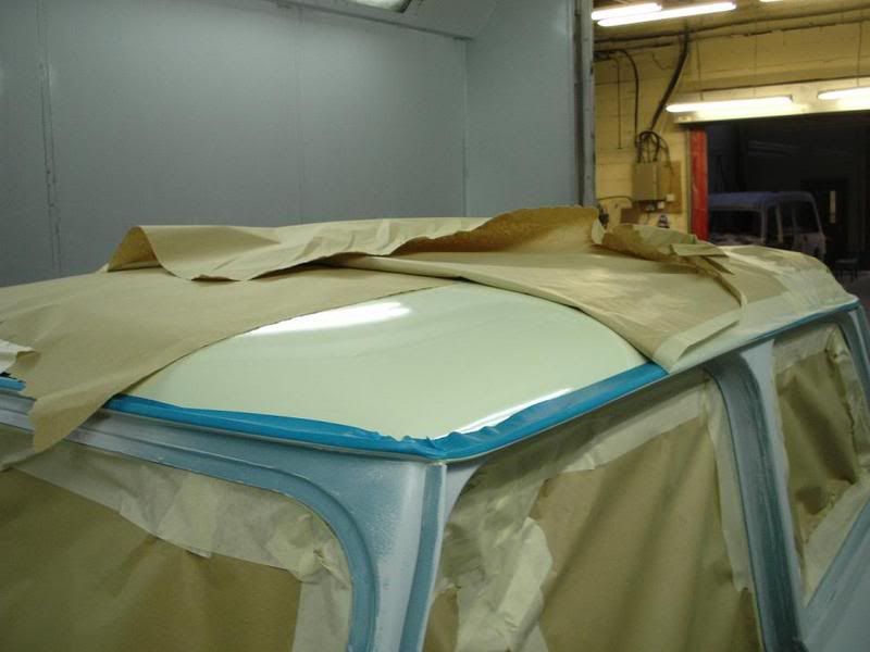

Some more pics from the paint shop, they were preping for the body colour.

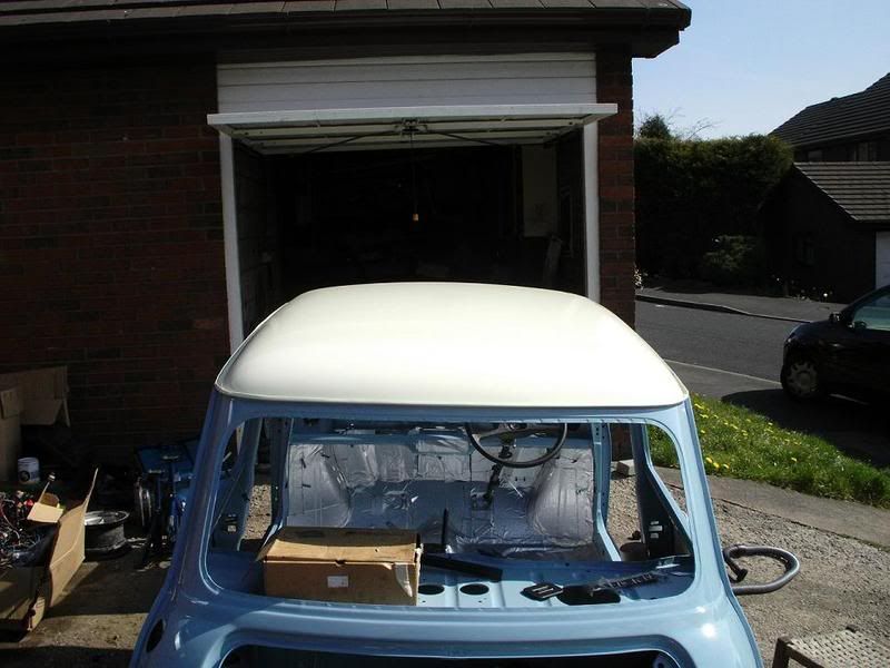

The roof had been painted and lacured (dont think ive spelt that right) but not been polished yet.
Here are some pics before the polishing starts.

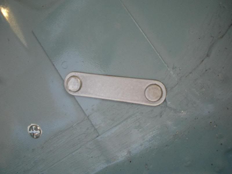

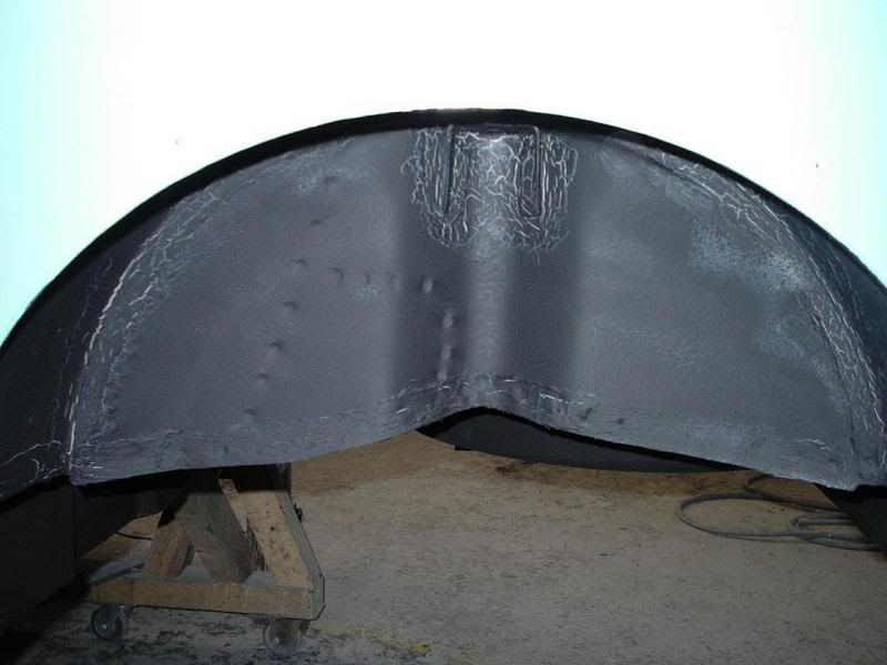

You may notice the crazing on the stonechip, this is due to the seam sealer, the painters have no idea why it has happened as acording the paint it shouldnt react.

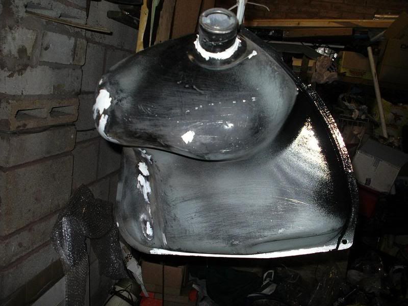

Started to prep the fuel tank too.

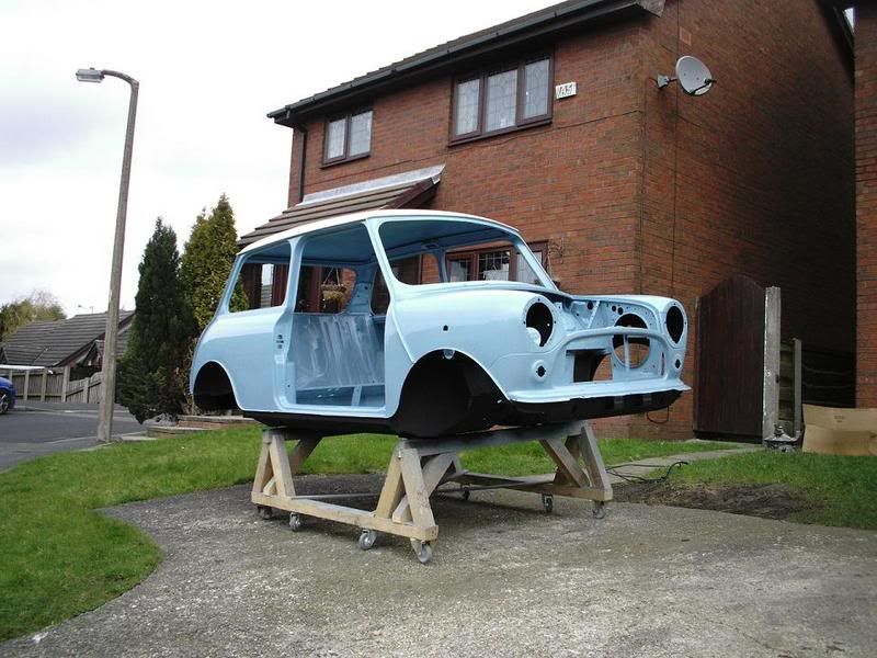

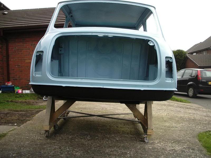

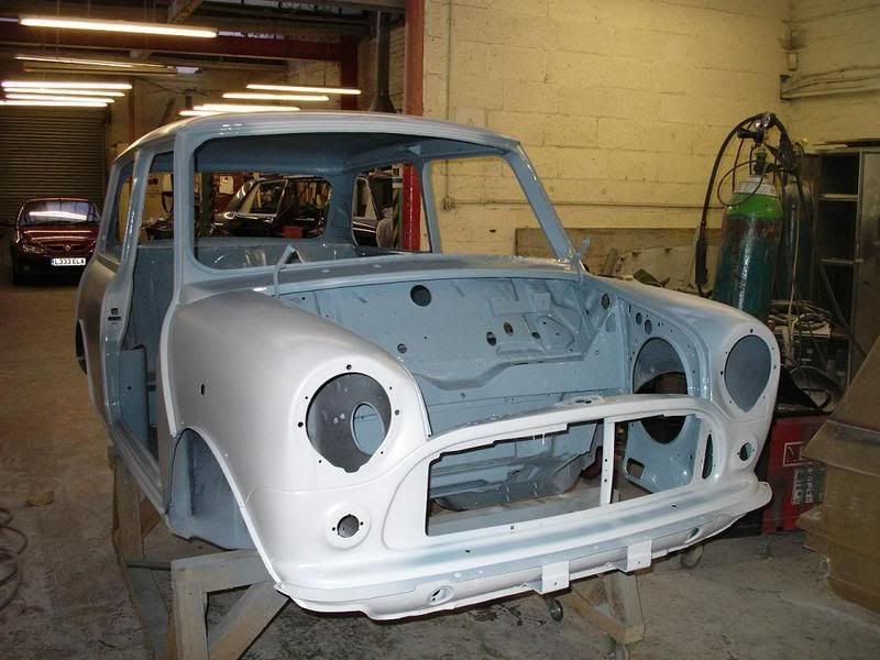

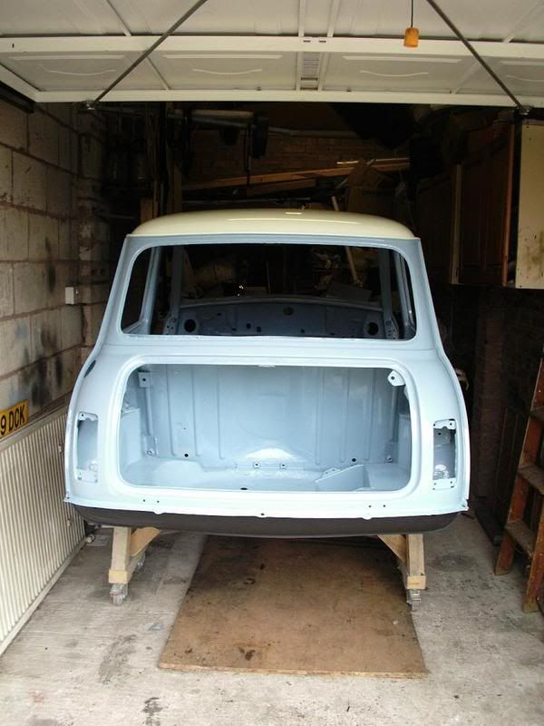

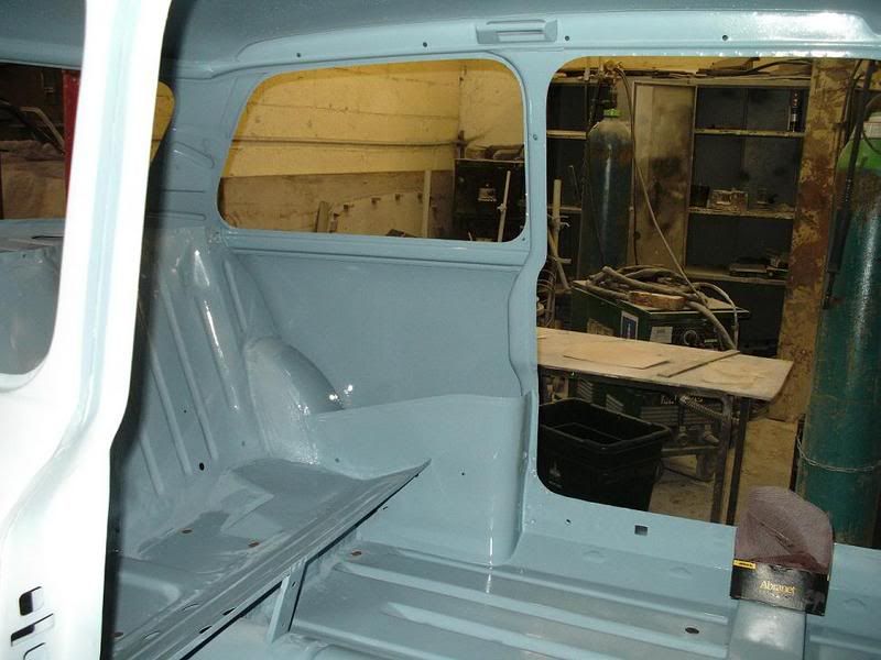

Shell was now done, the rest has not been painted and one of the door is full of stonechip, put it this way the painter has gone ballistic at the guy as he has also painted the front and rear valance black, over the blue!
#10 Jackman
Jackman
  • 4,053 posts
Posted 05 February 2008 - 10:23 AM

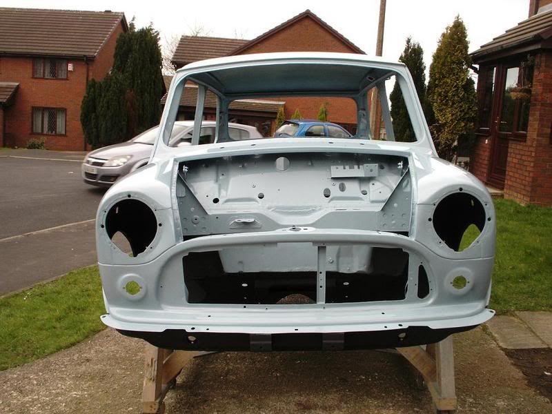

Well it came back ;) :D
Picture time.
Had to see what it looks like :angel:
Back where it belongs.
My doors and everything are being looked after till i need them so thats cool :cry:

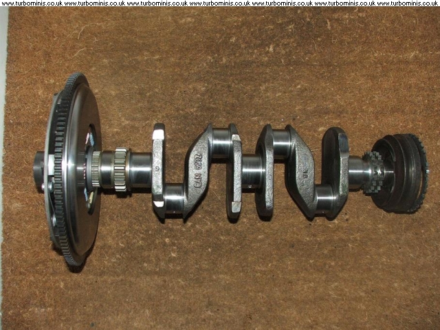

Balanced Crank assembily.

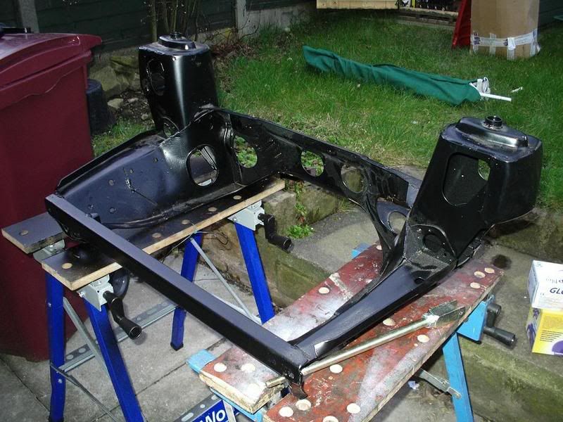

Front subframe

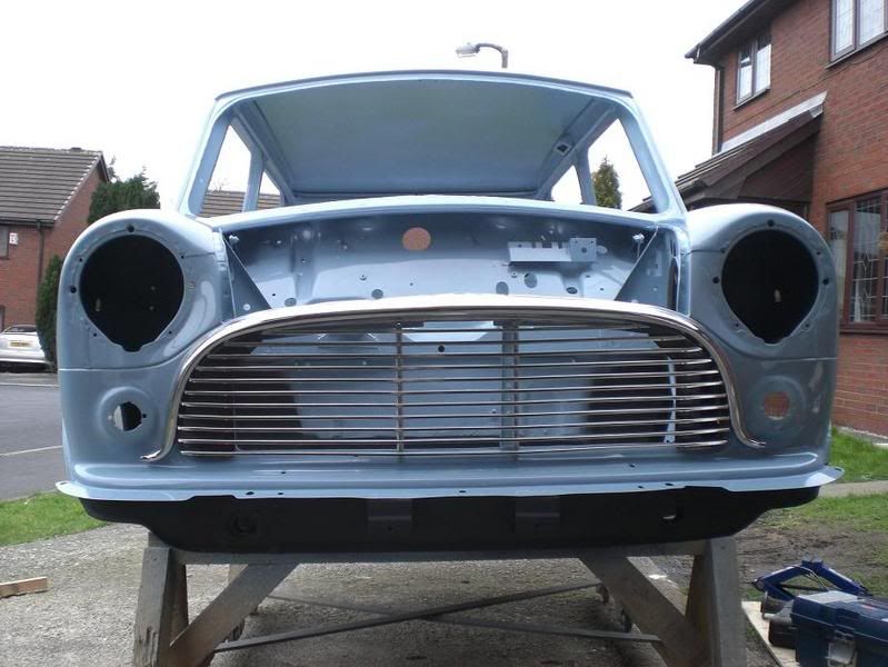

Some more pictures.

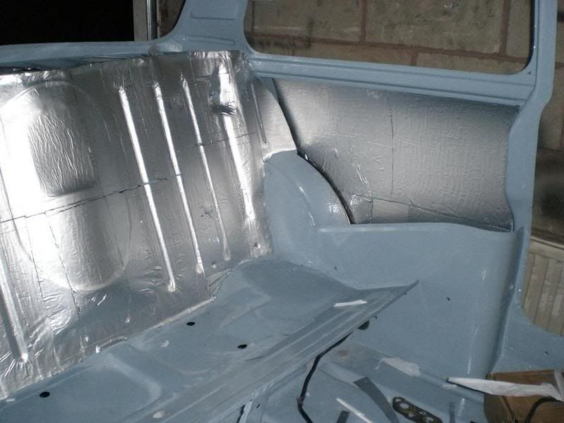

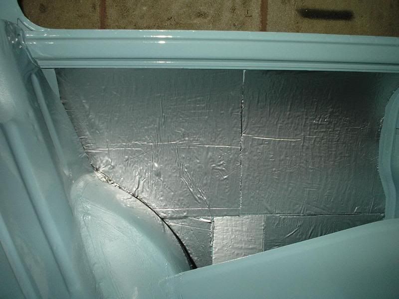

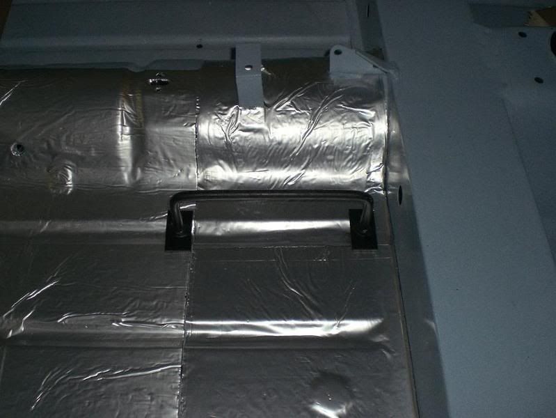

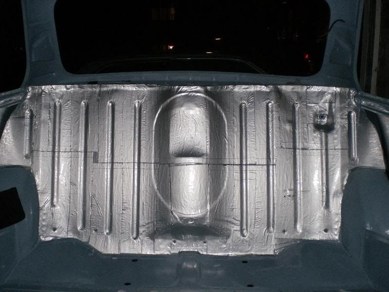

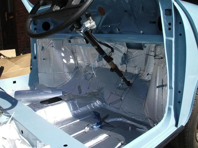

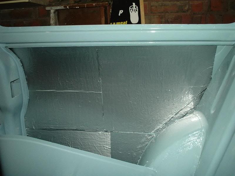

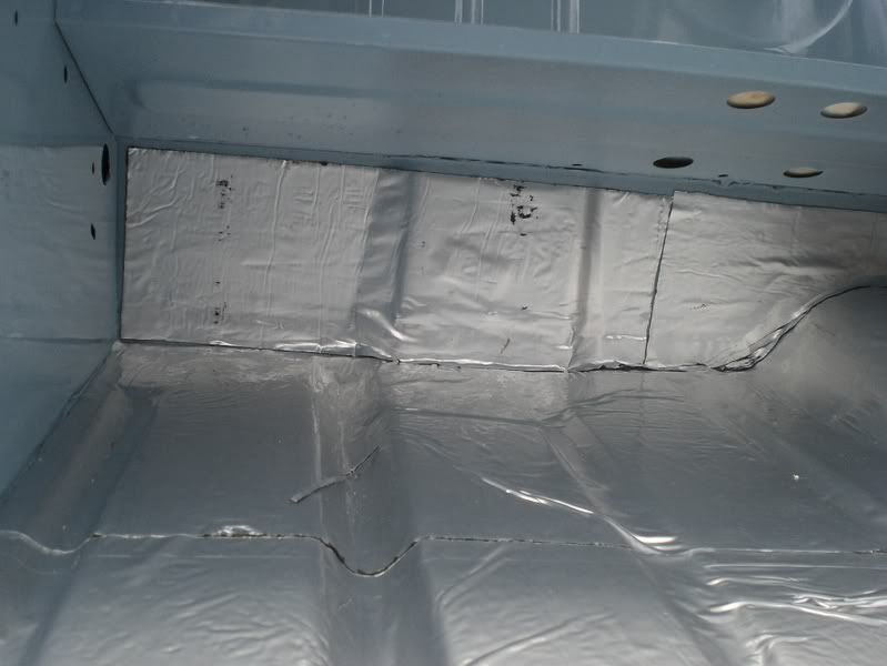

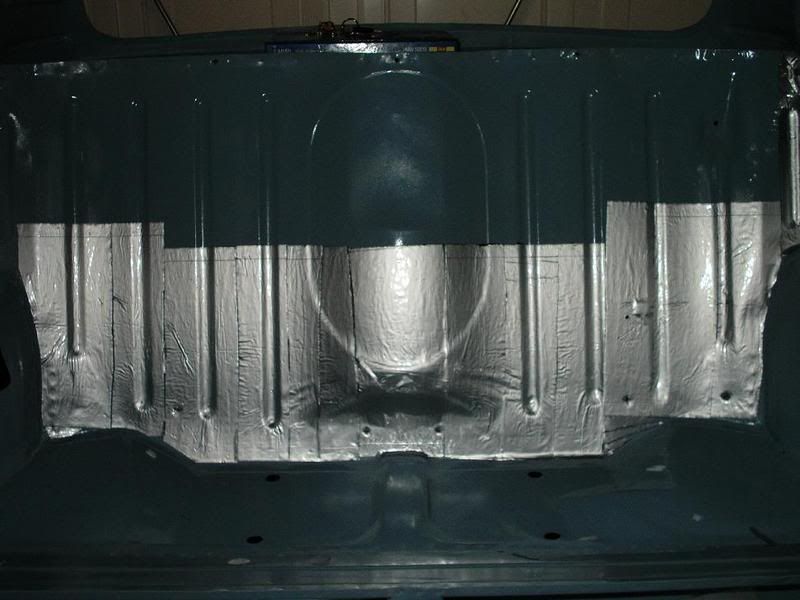

Soundproofing has started.
Wiring has begun too.
Looks good.
Had to see what it looked like.

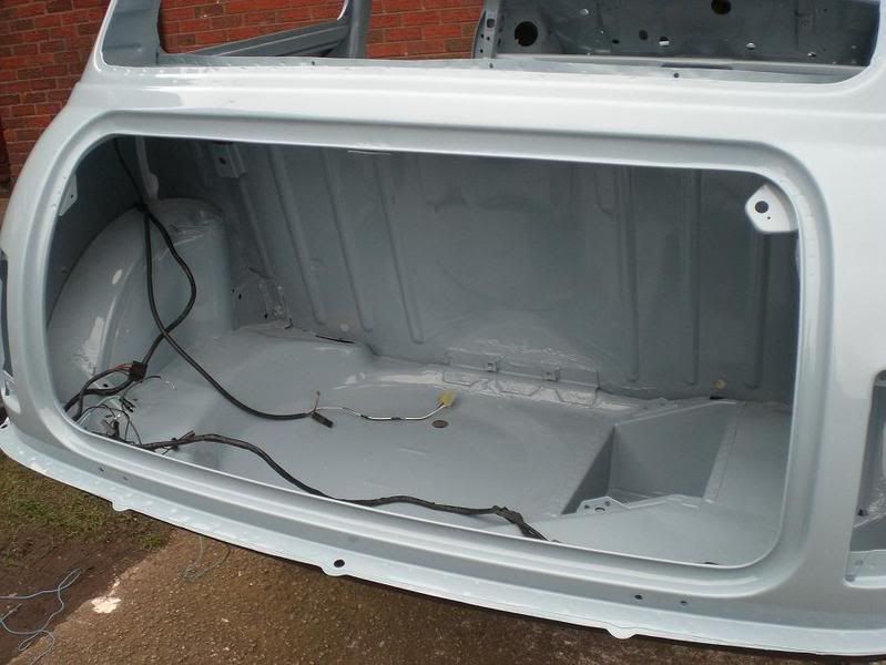

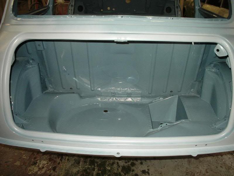

Rear Pannels done.

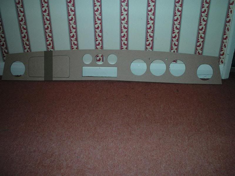

Also my dash came ;)
HE HE HE HE, PARTS!

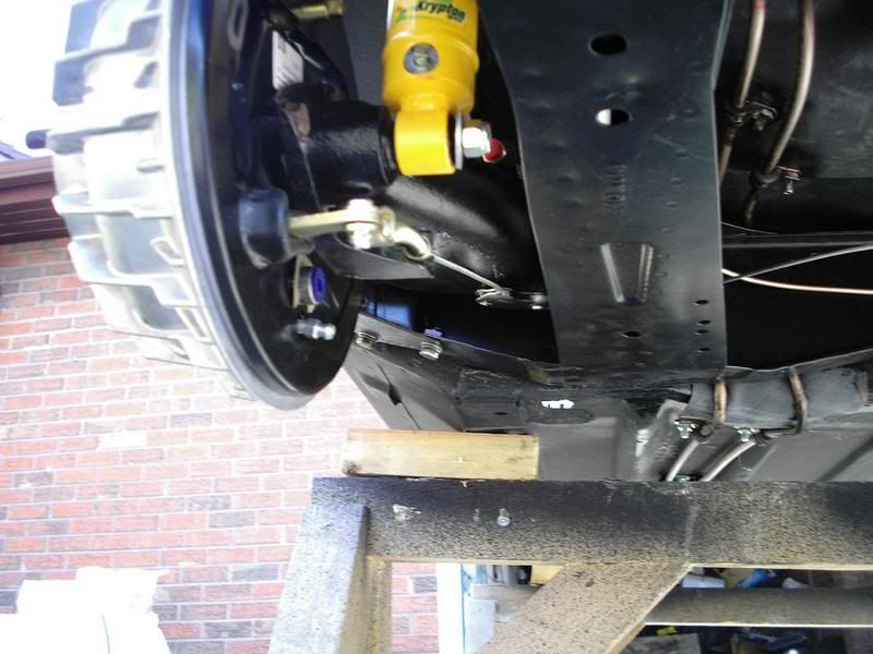

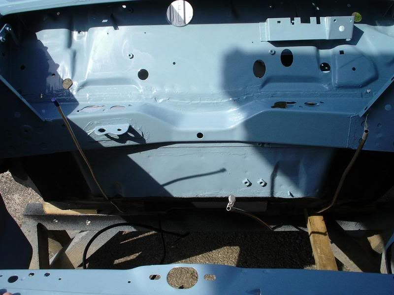

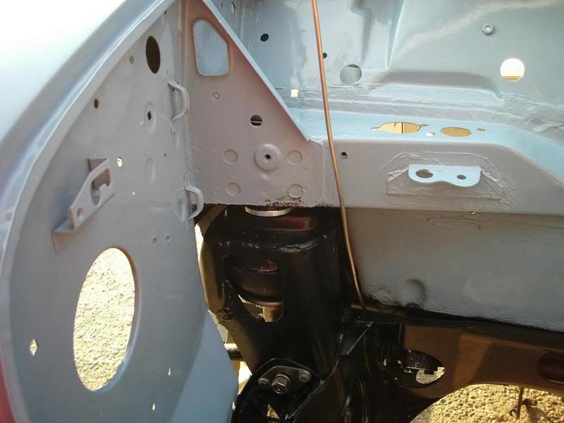

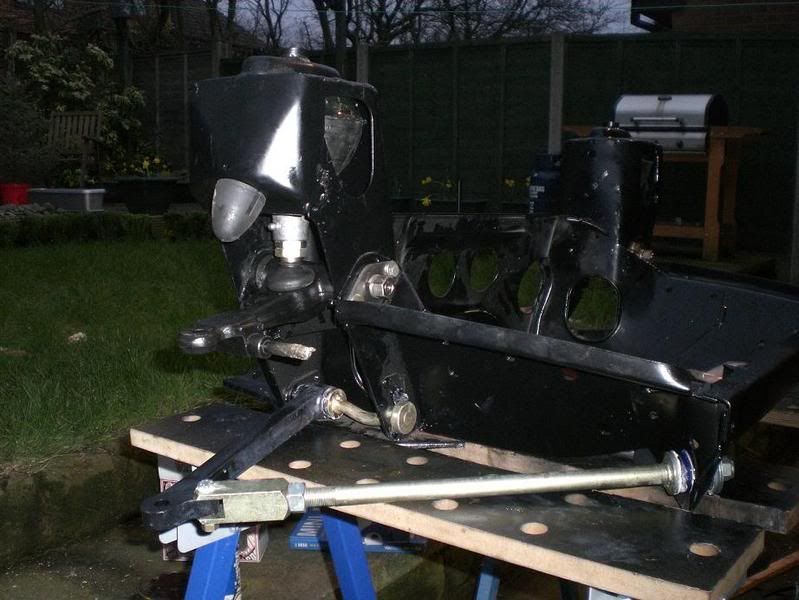

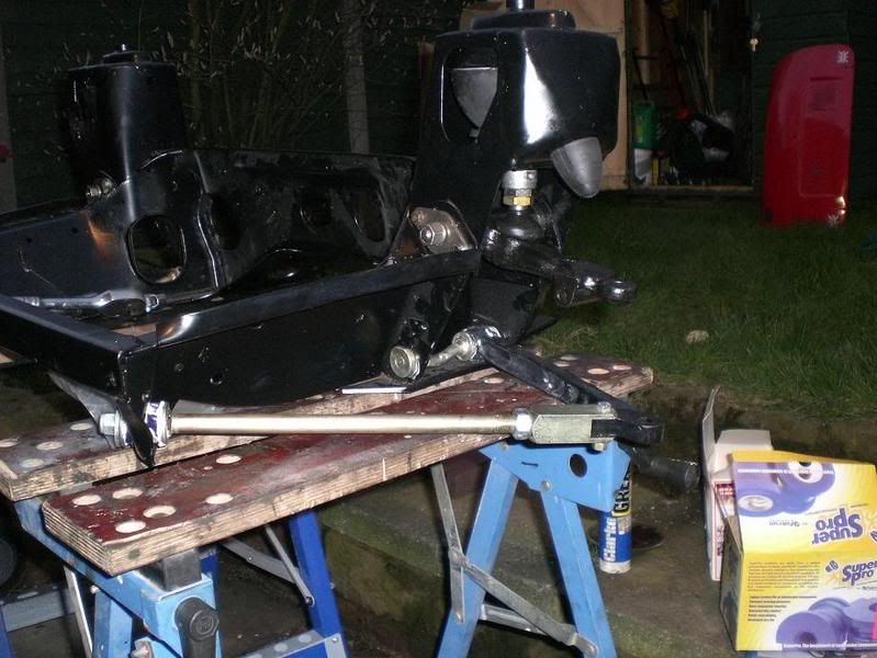

Done more work,the front subframe is ready to be attached to the mini now, its alot heavier built up.

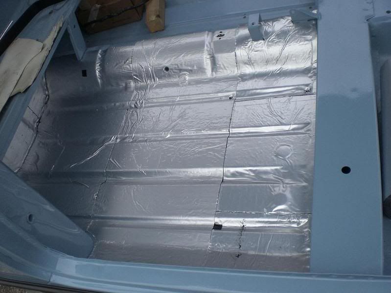

Also finished the rear seats sound deadening ;)

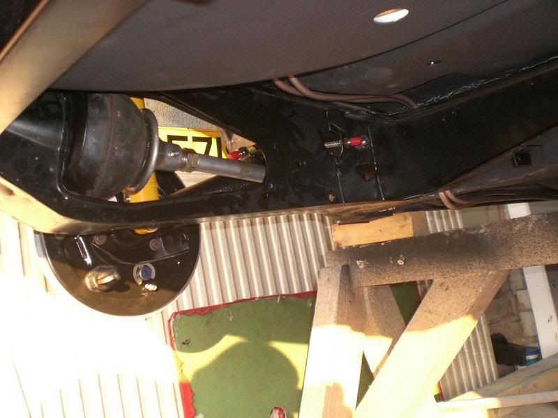

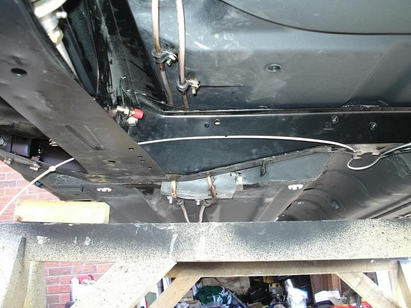

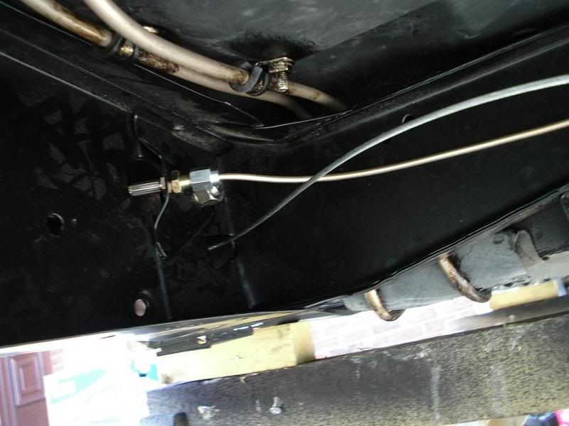

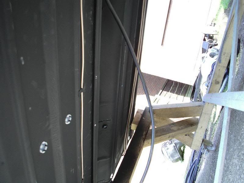

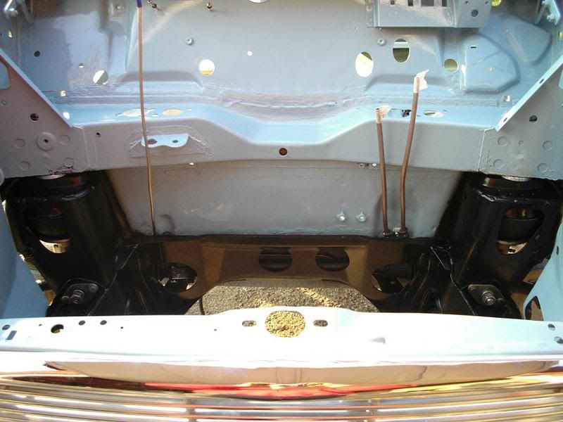

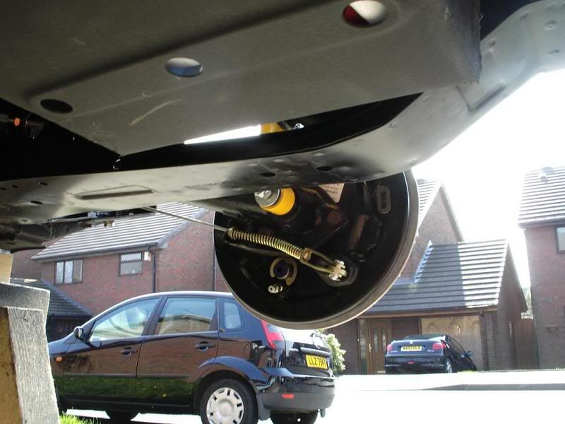

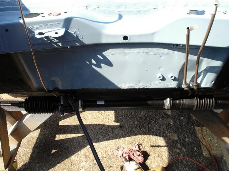

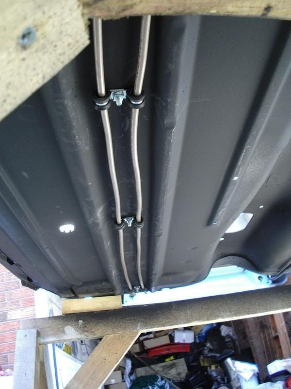

Well today went well... fuel and brake lines on and the rear subframe almost on, ran out of time to get it fully on so i put it back in the garage and then supported the problem parts.
All Lines run :D
Thats how the rear subby look at the moment, next thing to do is to get it fully supported and get the front subframe on.
Went out again tonight, the subrame is on proper now :angel: Chuffed
Decided to see what the 10x6 will look like on it.
No arches are out of the question

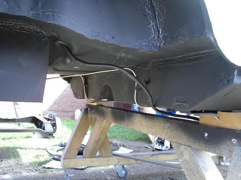

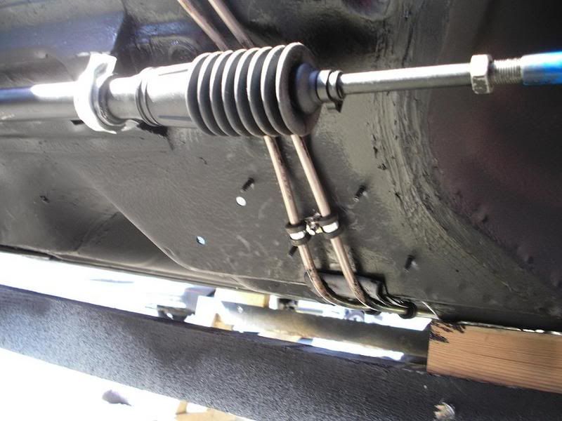

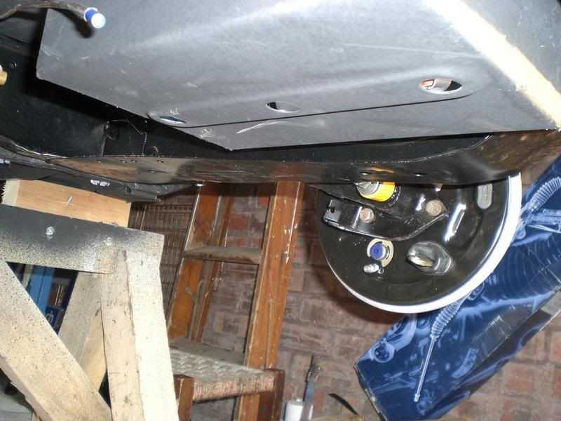

Rite quick update, the rear subframe is almost complete, just the lines to the brake cylinders are left to do and the main run needs attaching, handbrake cable is attached now. Put the fuel lines on proper so they are now secure and run away from metal components so no rattles, put some rubber near the body where the pipes bend around to make sure they dont rub or rattle against the bodywork.
Handbrake Painted and part of handbrake system.
Painted brake limiter
Front Pipes Before
After
Rest of the run
Rear Subby

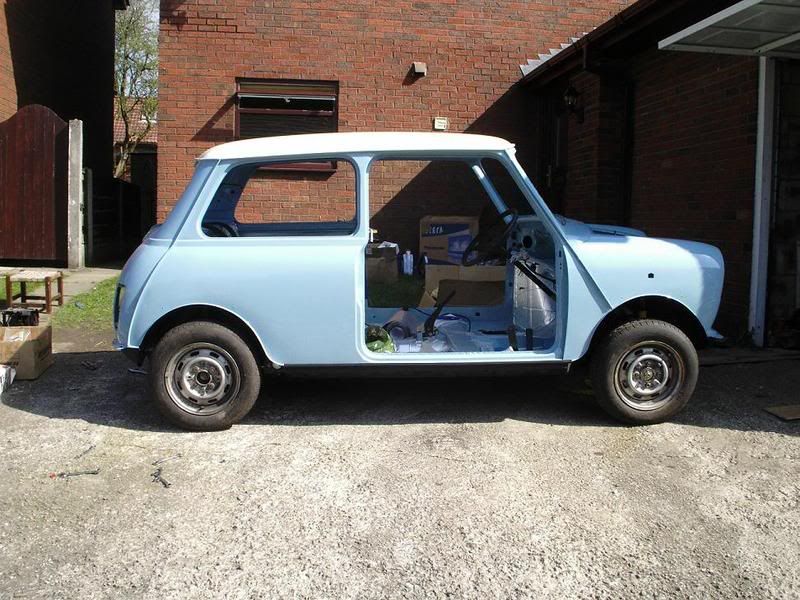

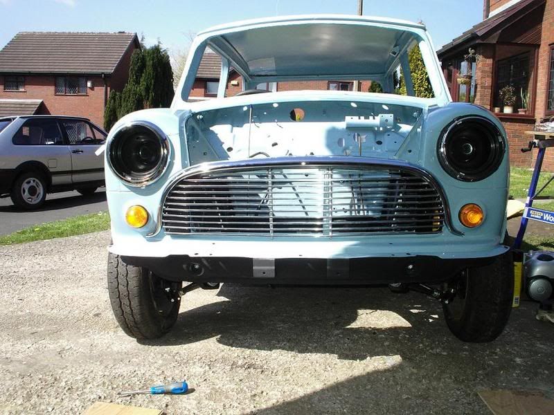

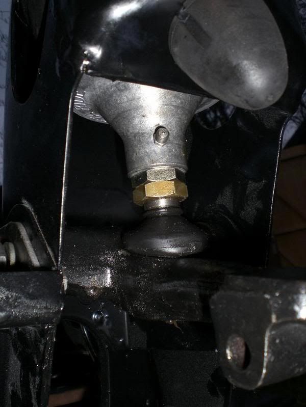

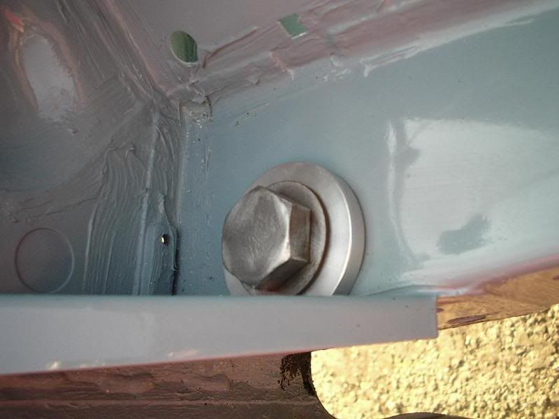

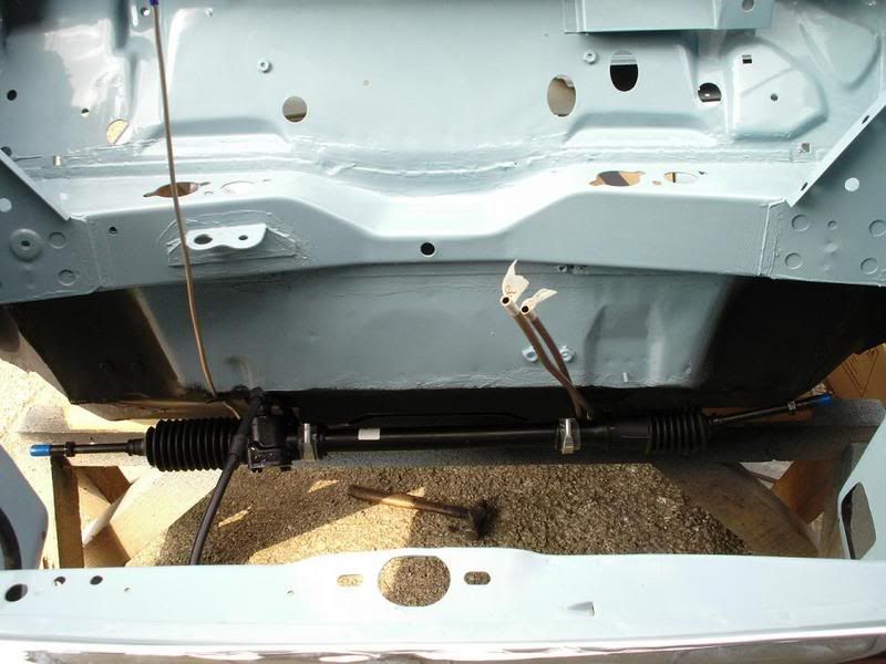

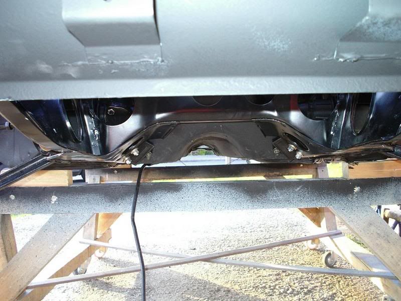

Well the front subframe is now on, went on really well, all be it a bit difficult to pick up and get on.

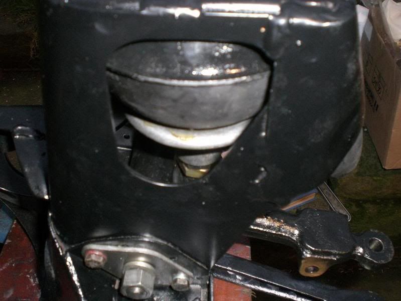

Found my rear mount things, quite glad as they are NLA so the replacement are nuts and bolts....
Cleaned up
In the car
Put the teardrop mounts in place and put the top bolts in place ready.
After a big lift it was on ;)
#14 Jackman
Jackman
  • 4,053 posts
Posted 05 February 2008 - 10:32 AM

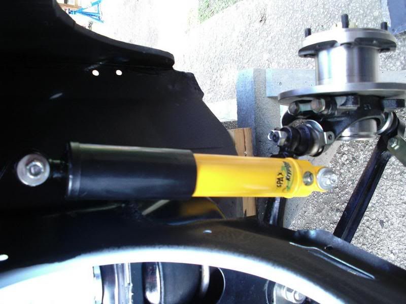

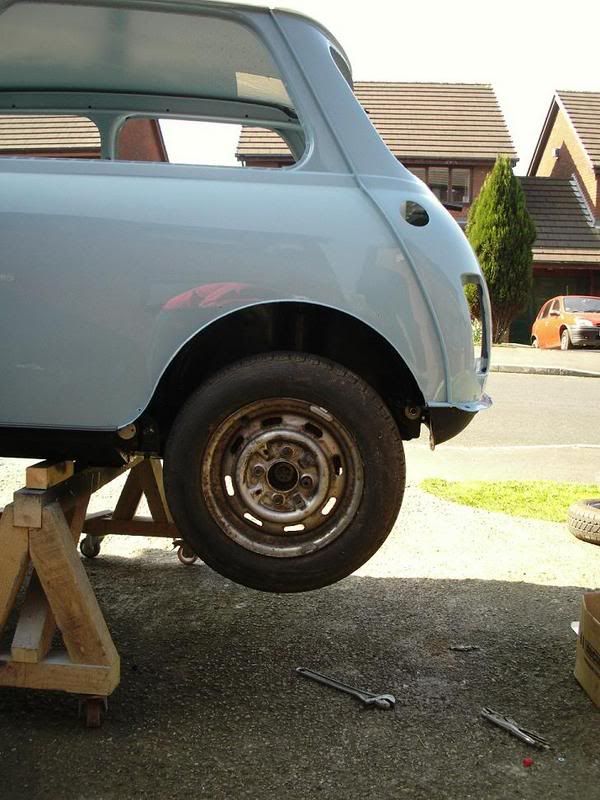

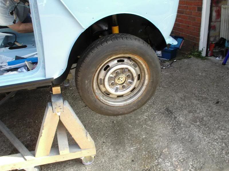

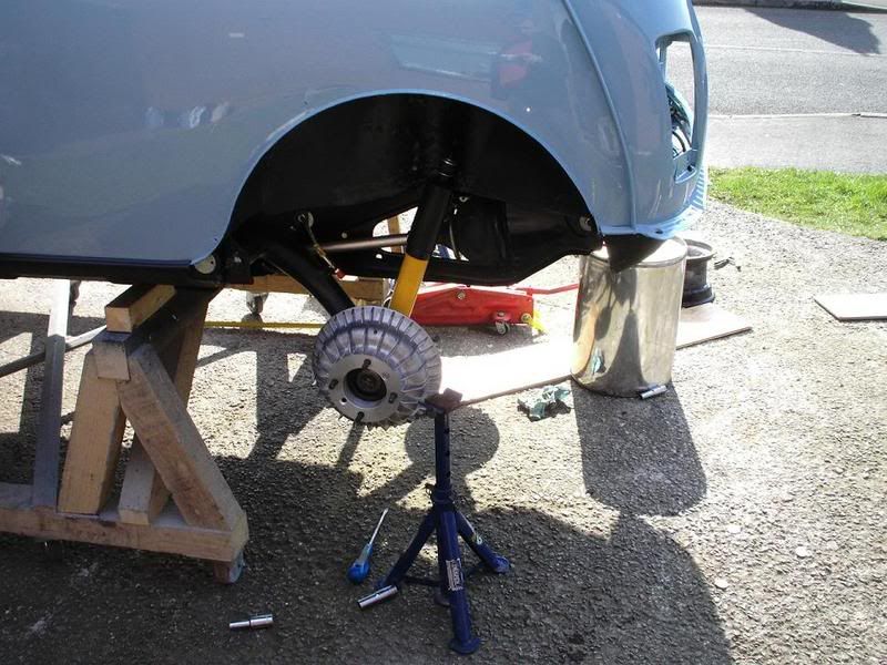

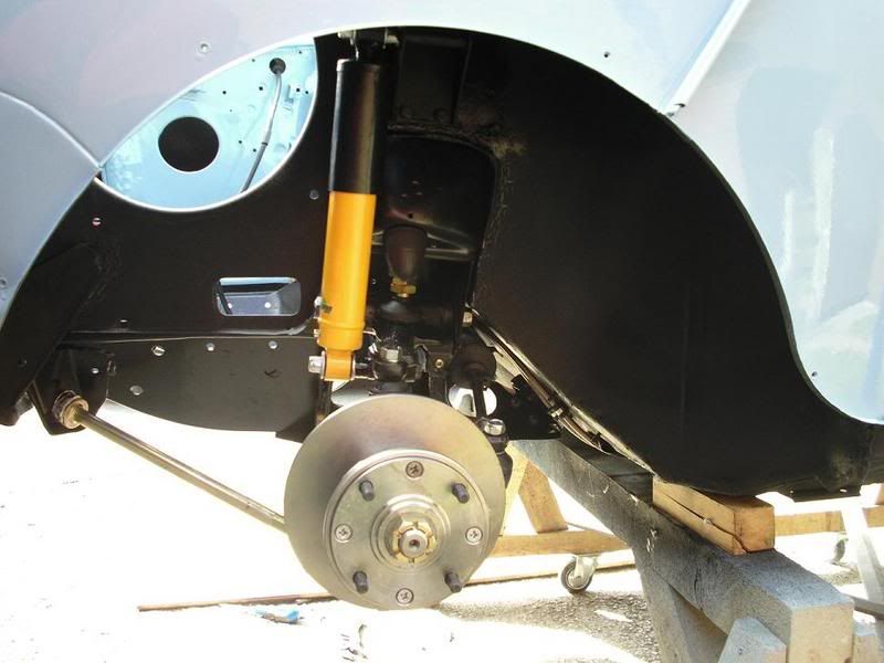

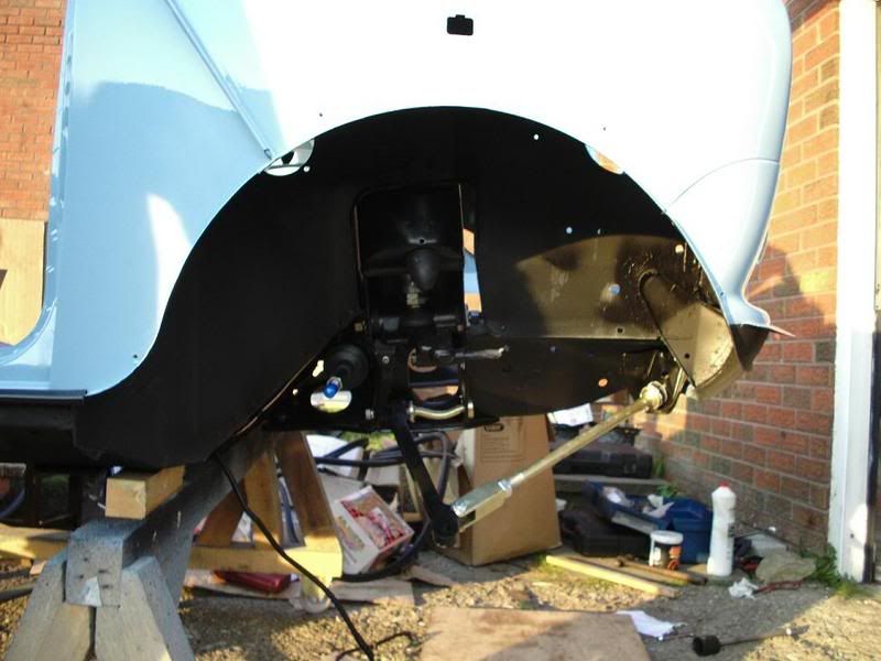

Hub on
Shocks on
Well it was very hard... took alot of work but it was done.
Wheels on ;)

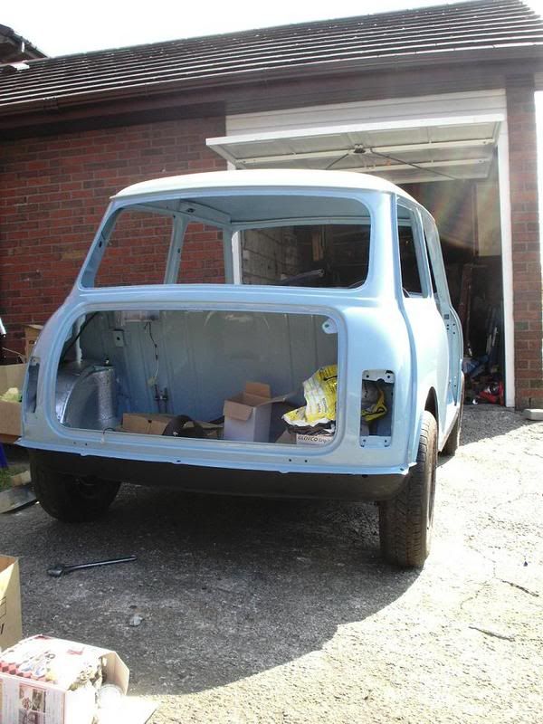

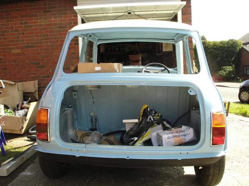

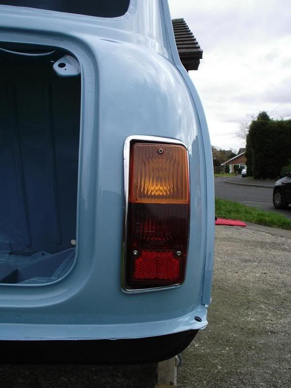

TOUCHDOWN!!! The new shell for the first time is on the floor as a proper mini.
Front lights
Rear Lights
Soundproofing done

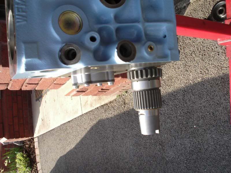

Here are a few pics... well alot.

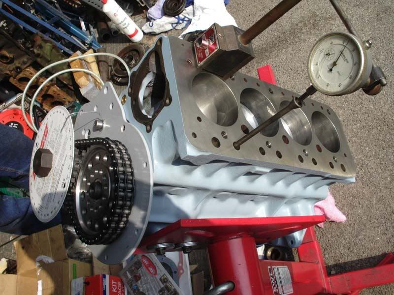

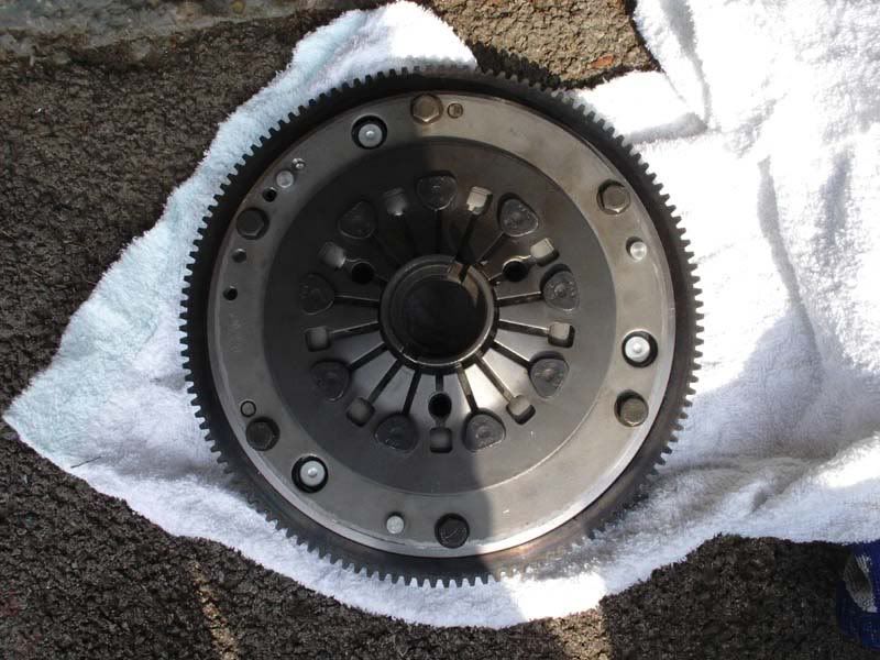

My new balanced flywheel and clutch (the pressure plate is specific to the flywheel as the flywheel couldnt have been drilled, it went through in one place)
Timing plate.

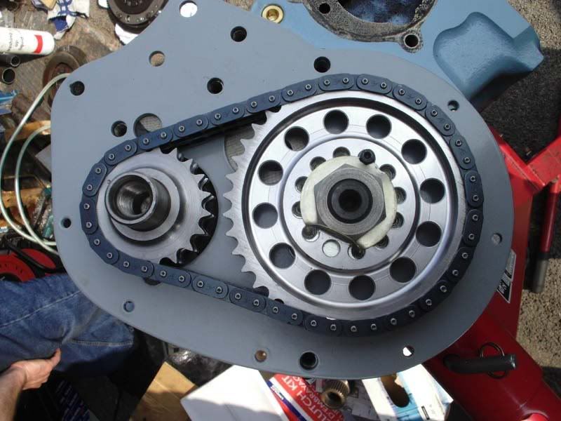

Sprockets on

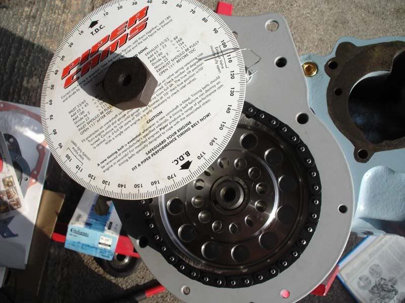

Chain on ready, TDC found
Finding full lift on the inlet for the cam.

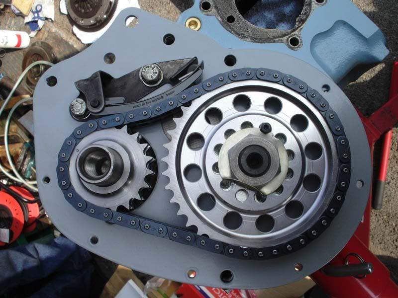

Timed in

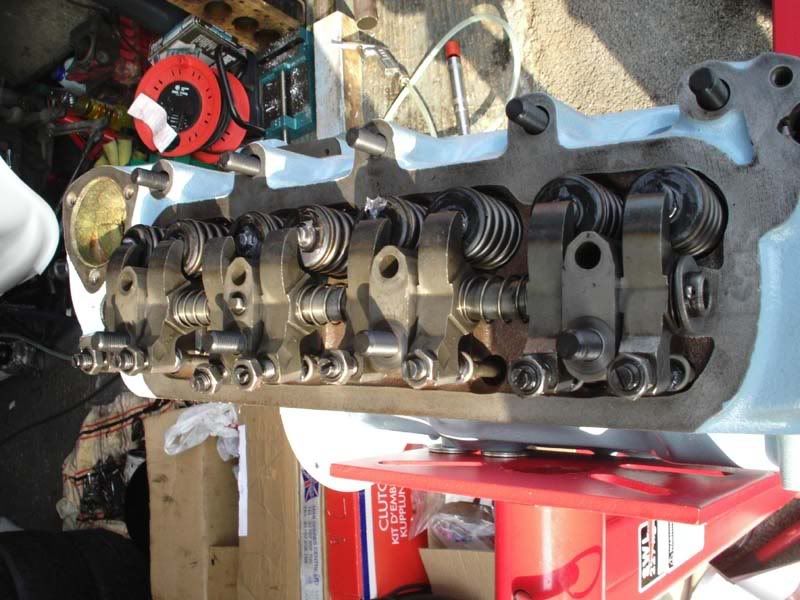

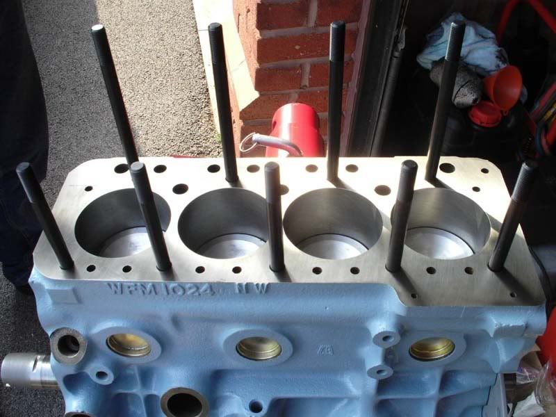

Tensioner on
MMMM primary ;) :D

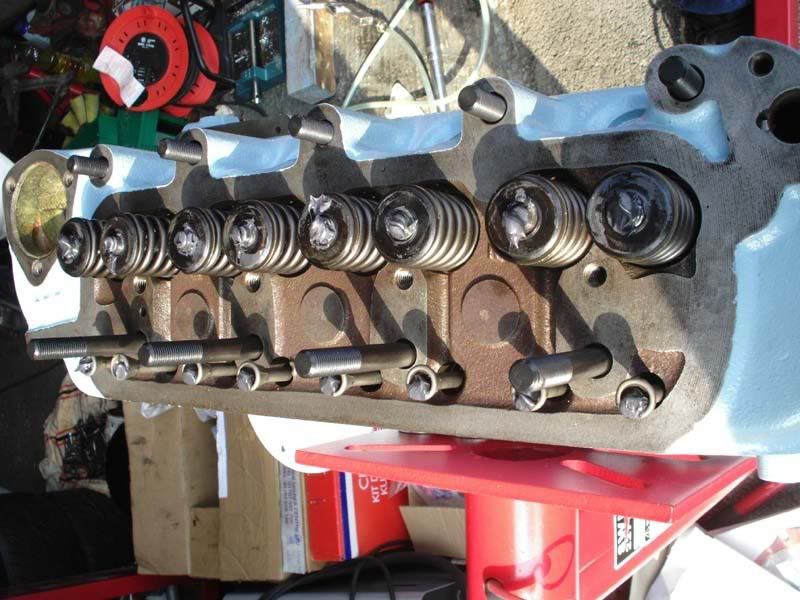

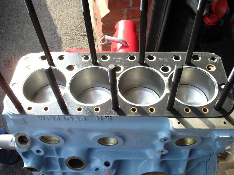

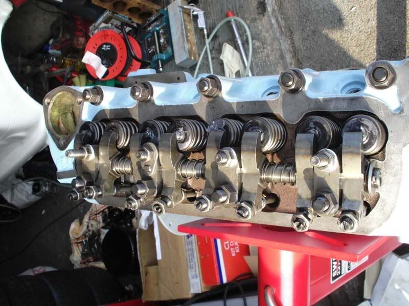

Studs in
Headgasket on
Head on
Rockers on
Fully tourqed up

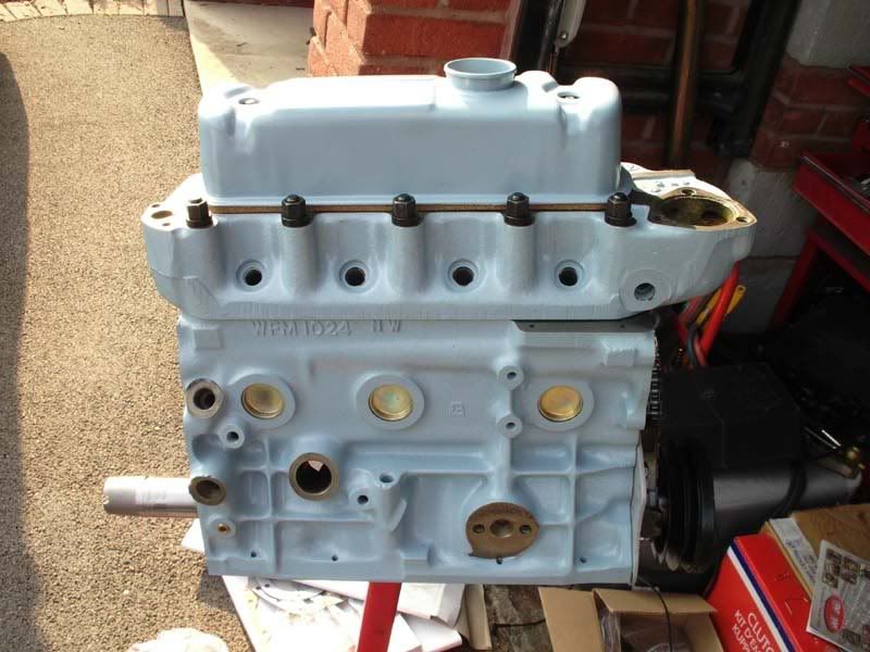

An engine

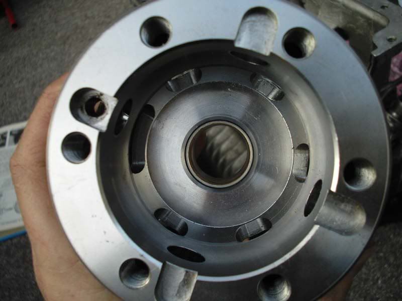

The cam timing is .5 degrees out and we both said thats close enough without keep going to get it that .5 degree right.

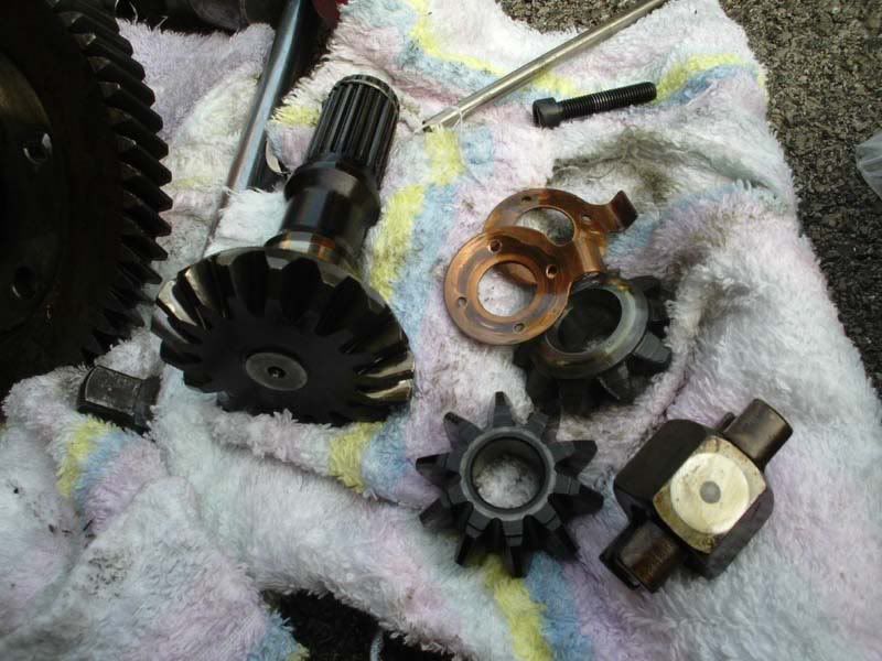

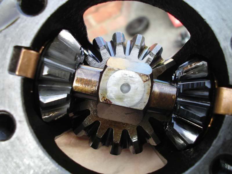

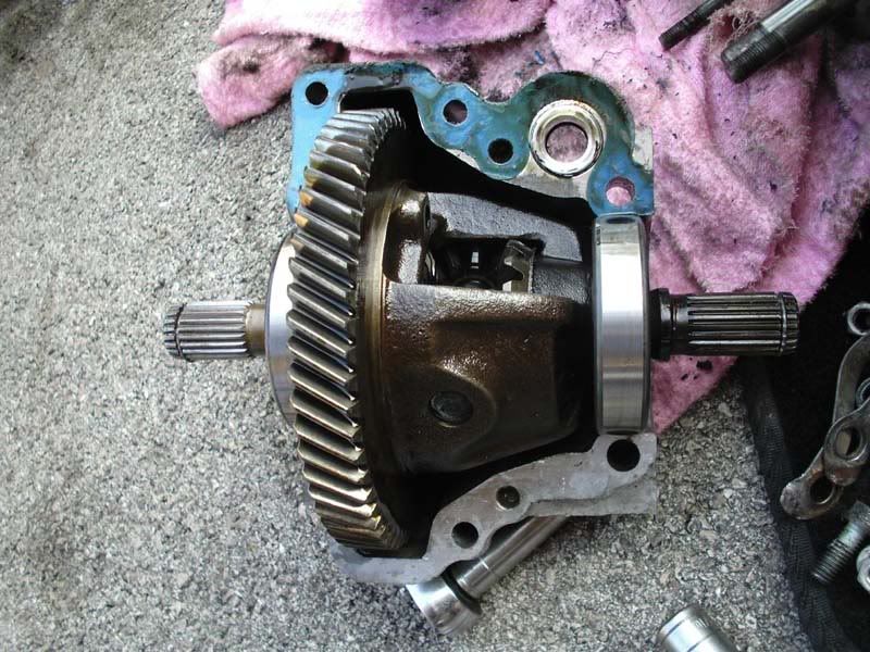

We then started on the gearbox...
The diff bearing
Diff out
Standard diff
Diff Remains

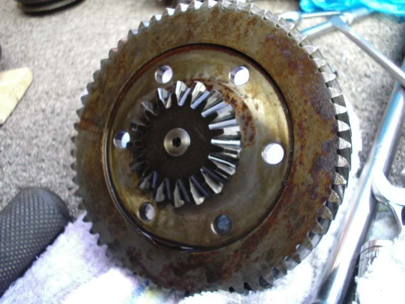

The crownwheel
The new diff
