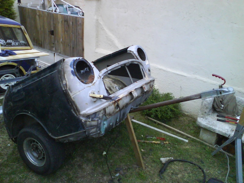

this is mine trailer needs restorin
might help for where to cut it

bean - The front really isn't in good condition, there's nothing left in front of the bulkhead, and even that's rotten, the window frame is corroded through, as are the A-panels and most of the front of the floor, you just can't see it in these pictures.
Emalee - I notice with Trevor you used two roofs, is there insufficient width on a single roof? I can't quite work out the perspective on mine, but do intend to have it curved, they look unfinished when flat on the top.
Danny - I'm going to cut it at the rear edge of the door to get the maximum length, and then I'll drop the roof onto it, and work out where to cut that to match, not this may mean taking a bit more as there's a sunroof aperture to contend with. I'll measure before I start.
I like the A-frame shaped to bar, rather then a single pole, did this come off anything in particular, or is it just angle iron again?
For the front I was thinking of taking the normal cross member and welding it back in at the trailer leading edge, then having two vertical supports to help support the hinges on the angle iron bracing across the front, down through the front of the crossmember. Then a stiff panel on this behind the flat front, with mounting points for a spare wheel to break up the front a bit. I'll also have to add my electrical connector here somewhere.
Dave

i dont no about the A frame i bought it as it looks i think its homemade tho

Danny, I think so too, they all are, though P&L now do fibreglass tubs for them.
