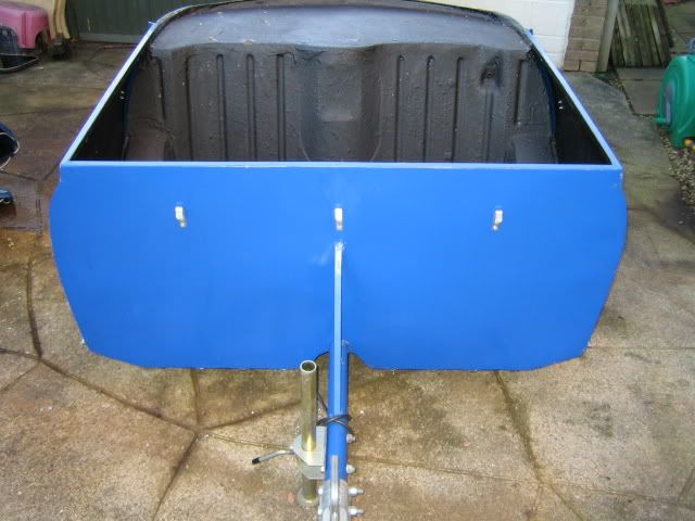

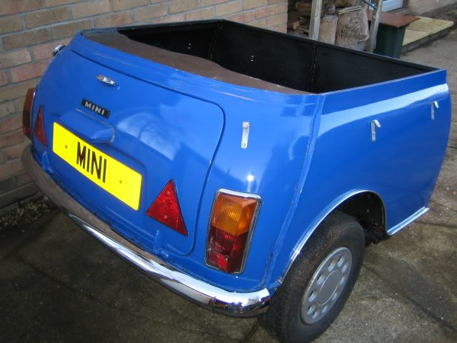

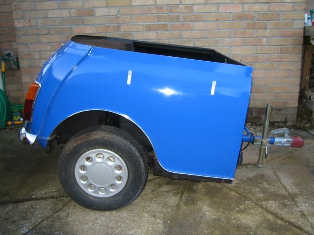

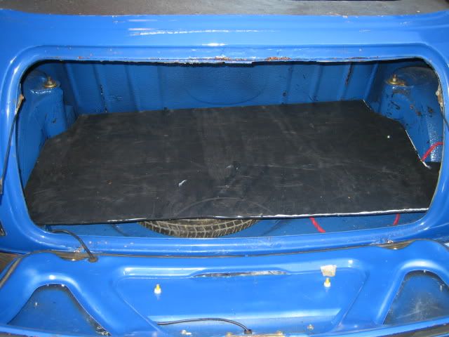

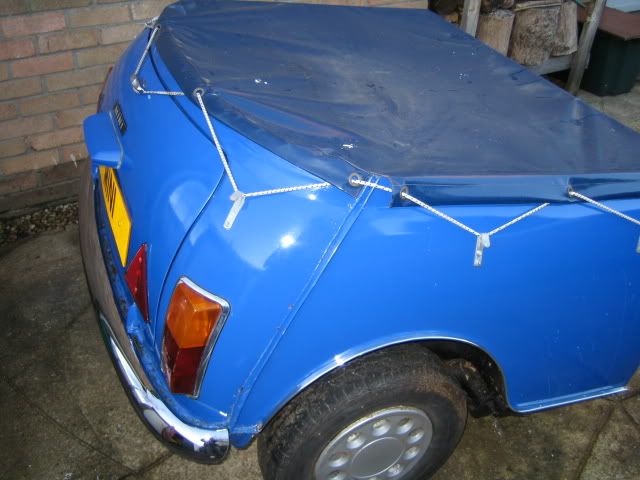

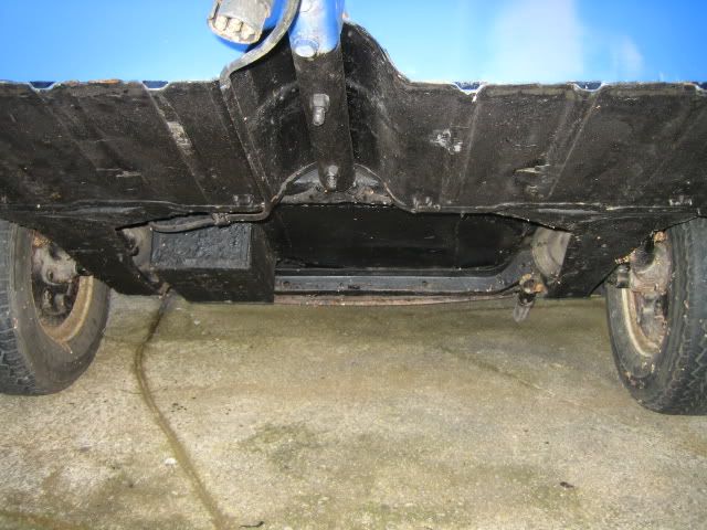

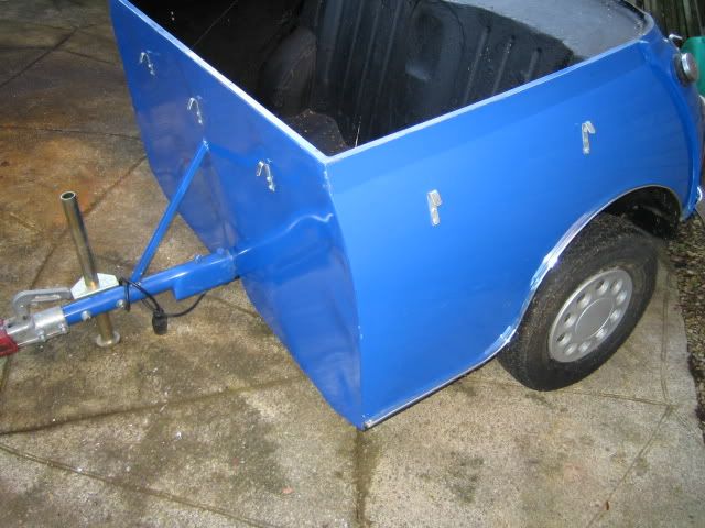

The first on that I made was many, many years ago. That first one cut just behind the crossmember/half way across the doors. Made for a very big useable trailer but was very, very heavy. The nose weight was enourmous, it was a struggle to mive it when it was empty, it was unmovable by hand once there was something in it - not recommended.
The other two I did at the same time, about 8 - 10 years ago I think. One was blue and the other was red. I can't find any of the red pictures at the moment and I have no photos that I know of of the original one - looked the same as the smaller ones, just longer and had no boot.

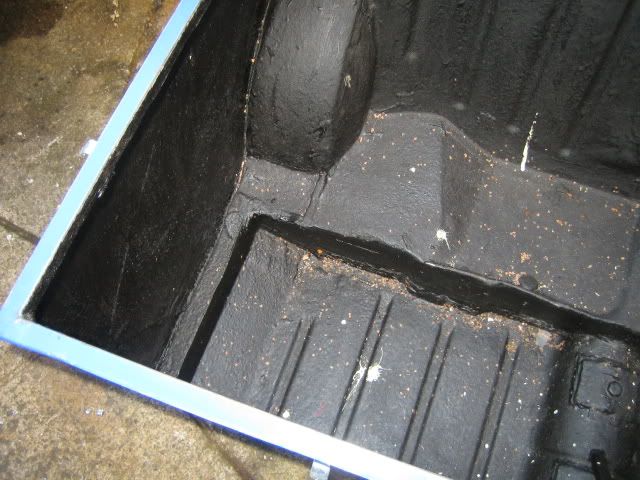

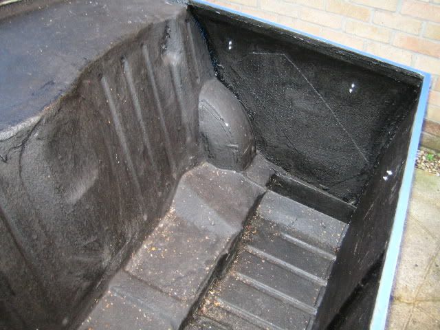

When I put the front on I put a bit of small box section across the front to attach the front section too - this also left some holes at the front where the floor is corrugated - this was done on purpose to allow water to runout of the trailer.
The top of the sides were finished off by running a length of small box section down the sides, the rear window pillars were just plated and filled and the lip/seam at the bottom of the rear window was left intact.
The only really tricky bit is deciding how to sort out the tow bar. For a convetional car, if the towbar is a straight bar from the trailer then the tow hitch is too low - might me OK for mini though. You can see in the picture that I have mounted one bar on top of the other to try and get the tow hitch a bit higher, but even then it was a little low still and could have done with being a couple of inches higher so that it would tow horizontally.
The overhang of the rear seat was cut away and the spotwelded seam was beaten over. Same with top seam/parcel shelf, it was just beaten over.
The boot can be removed, I just liked the idea of a lockable compartment on the trailer.
One thing that I will say for them is that it is almost impossible to reverse with one on. I have no trouble reversing a big trailer very acurately indeed, but those little mini trailers well and truley beat me!
I don't think that I would have done anything differently, except for making the tow hitch at the right height - but that is just a minor niggle.

I was thinking of taking the cross member out of the floor, and rewelding it to make the front lower brace of the trailer, then an angle iron rail accross the top, and a thin gauge steel front. Can you see any issues with such an approach, I figure the cross member will follow the shape of the floor and tunnel.
I was going to use angle iron to stregthen both sides, and across the back over the seat back, then a single flat plate over the parcel shelf to make it a waterproof recess. with drainage onto rear seams.
A matching angle iron square, (but upside down), will be used to brace the lid, made out of a mini roof. When closed the two angle iron squares will sandwich a rubber seal, hopefully making it waterproof.
Solid lid will close and be latched by a locking mechanism controlled within the top of the boot. Making the entire trailer lockable, also a lockable tow hitch to keep it connected to the mini.
Did you build this to tow behind a mini or a different car? I'm trying to work out the tow hitch.
Plan was to put the bar out of the transmission tunnel, (well exhaust tunnel), similar to yours, and see how it aligns with a tow bar height for a mini, adjusting if necessary.

No need for the cross member, just use box or angle across the flat bit and a couple of tags on the tunnel.
I would use some box section (for the sake of the little bit that you need you could probably get it from B&Q) down the sides and across the front. This creates a box that rests around the top of the trailer giving it some rigidity with the sheet of steel on the front holding it all together and rigid.
It will be difficult to do this neatly with angle.
