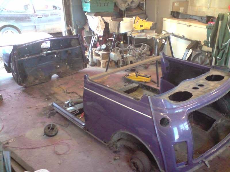

So I collected the shell on Sunday (thanks Mark) and put it in the garage, then tuesday I started and here is what I have done so far: -

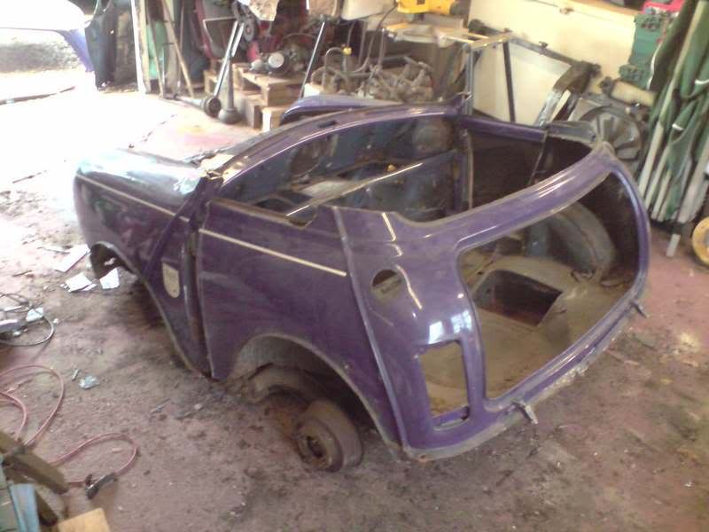

The Shell: - Posted Image

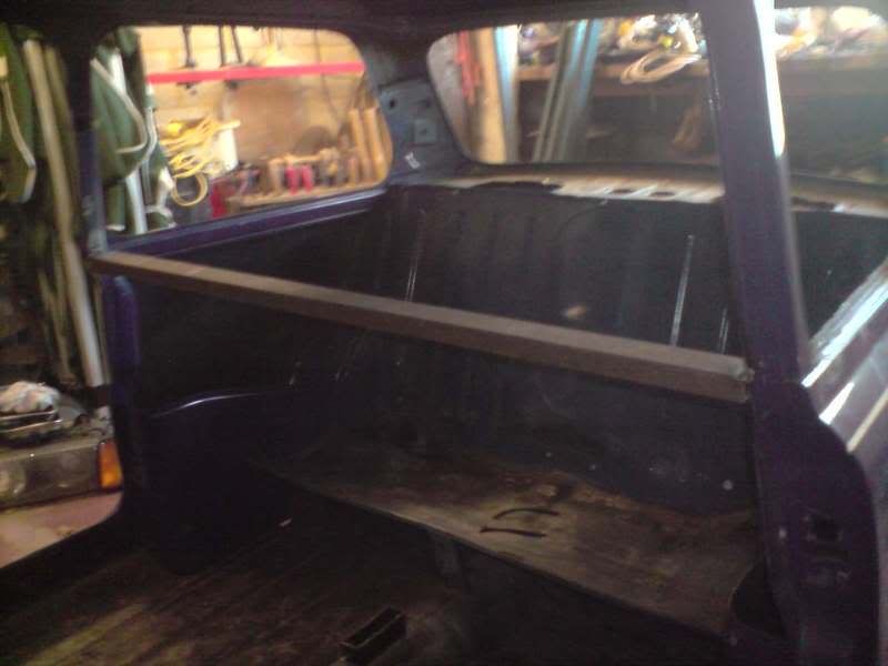

I welded a bar in before cutting the roof off so that the sides didnt collapsePosted Image
Roof off Posted Image

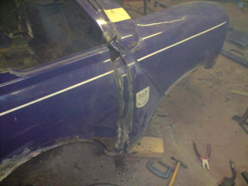

Front cut off Posted Image

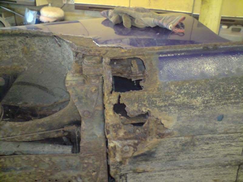

At this point i rolled it onto its side to make a nice straight cut, and found quite a lot of rust! Glad im making this into a trailer! Posted Image

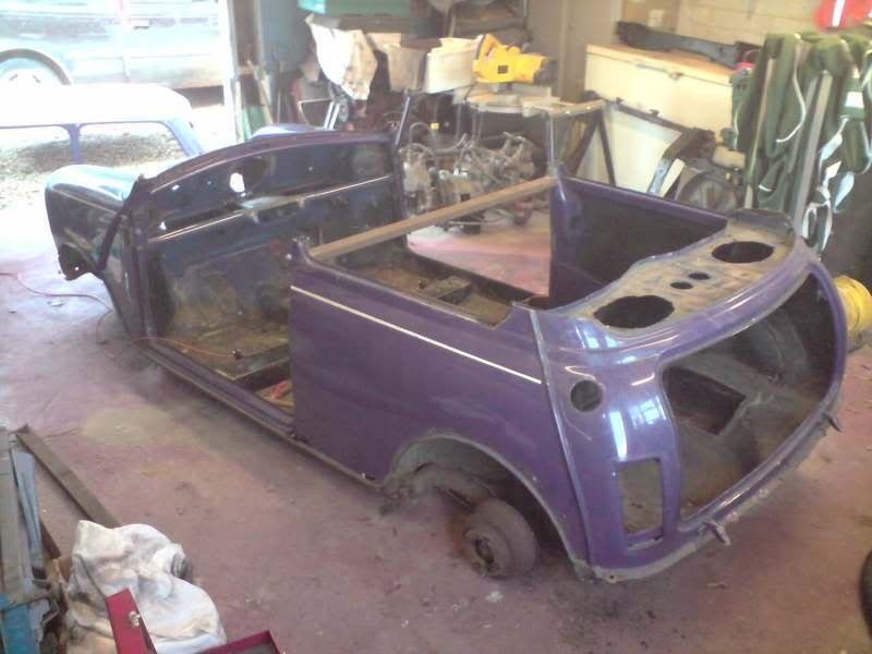

Here it is pushed together so you can get an idea of the final shape, notice the bar i welded in has gone, this is because I welded it too far forward in the car and when i put the two halves together the rear tub was far too big for my needs so i chopped it down.
Il keep on with it tommorow, plan is to start welding the holes in the rear half ready to re-mount the subframe, which is suprisingly solid! The best bit about this being a trailer is that i dont have to bother welding in new panels, fibreglass is fine :P So once iv done the bit of welding which i have to do i can get on with cutting a straight line on the front half in preperation to join it to the rear...

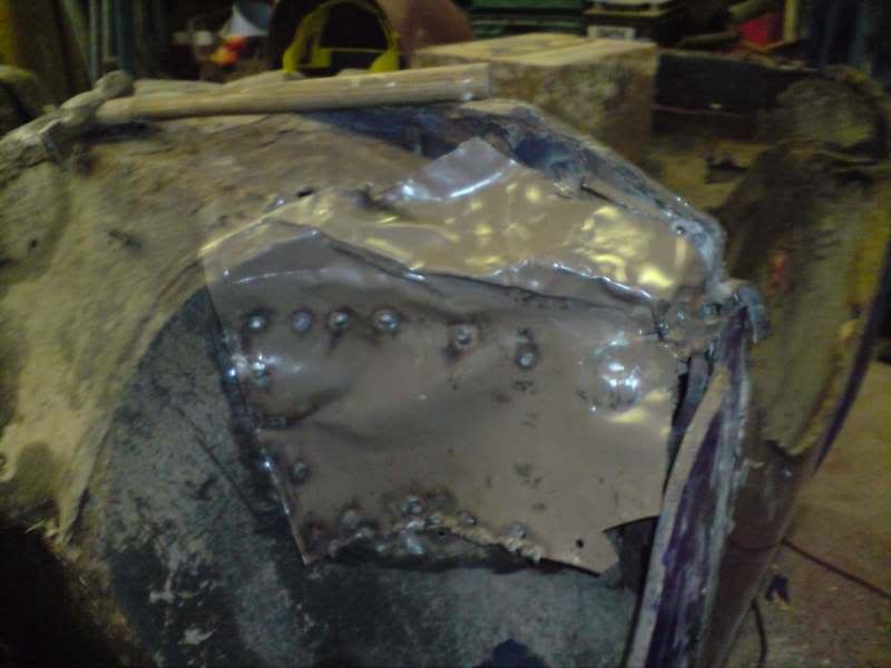

welded up the subframe mounting point areas for all four corners, took a bit longer than planned oweing to all the extra holes I found!
Front mounting points: -
Rear left mounting point before
Rear left mounting point after, much better :P
Rear right mounting point before
Rear right mounting point after, not as happy with this one, there was more hole to cover and I was getting tired of welding by this point!

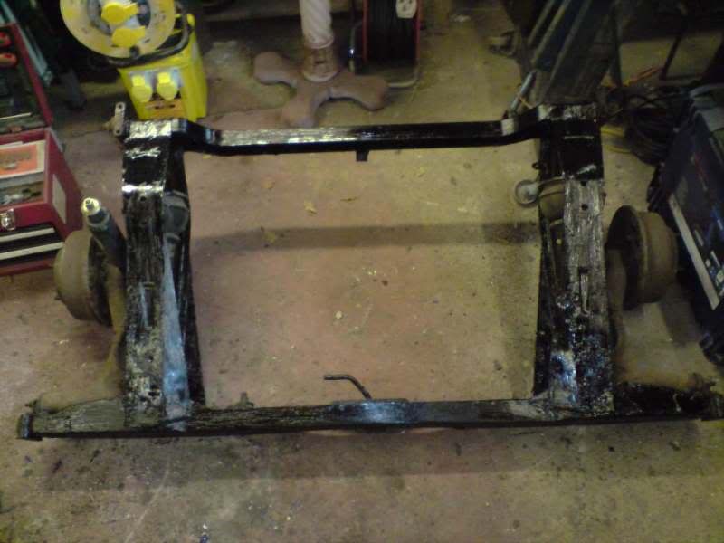

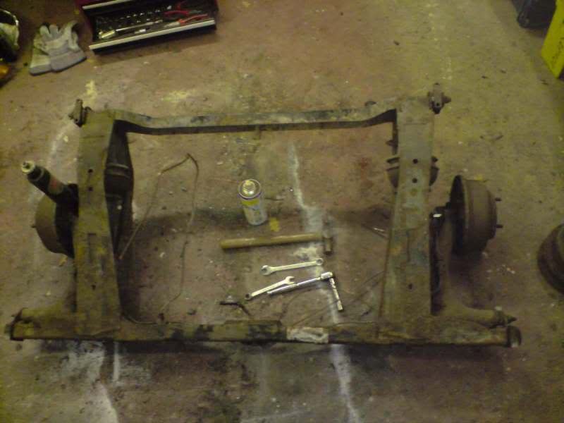

Firstly, after preping I painted the subframe with nice black underseal. Much better..
I haven't painted the radius arms yet, I plan to get the subby back on and then remove the radius arms, brakes etc.

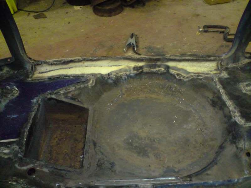

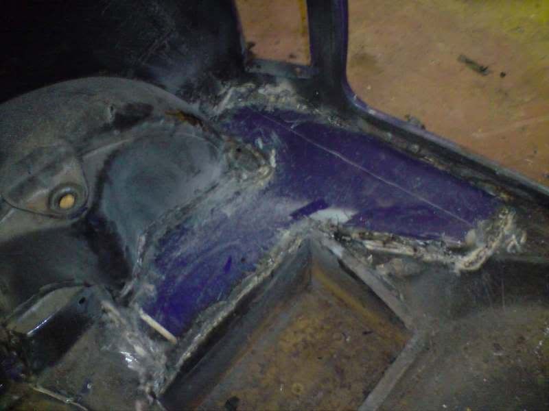

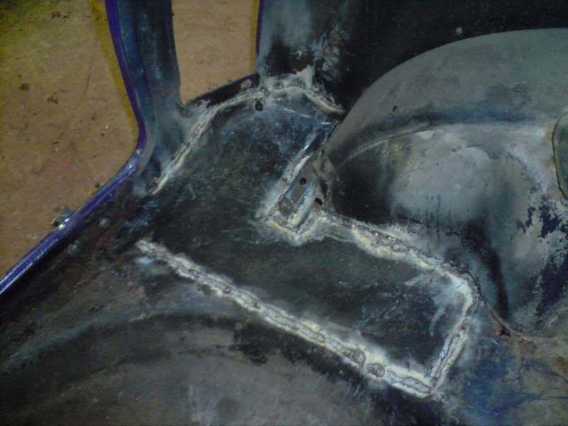

Next I welded the boot floor back to the shell
Before : -
After : -

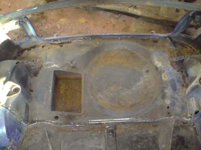

Thats all the welding on the rear half done, the remaining holes will be fibre glassed over, that the beauty of trailers - no rules! The rear half is now strong in all the important places. Im not going to bother grinding down any of the welds as I plan to fit a ice flat plywood floor so all the welding will be hidden. However I am filling all the holes as I dont want to be towing a puddle around!

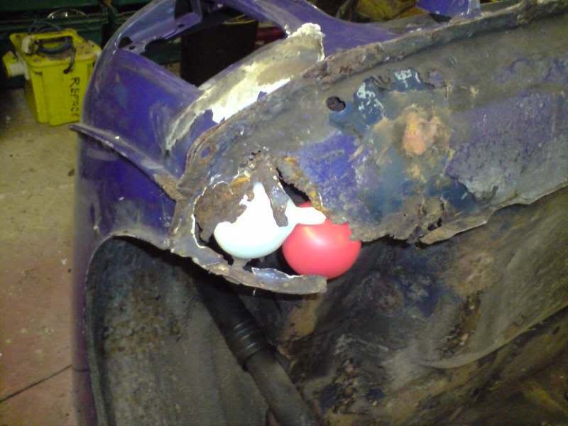

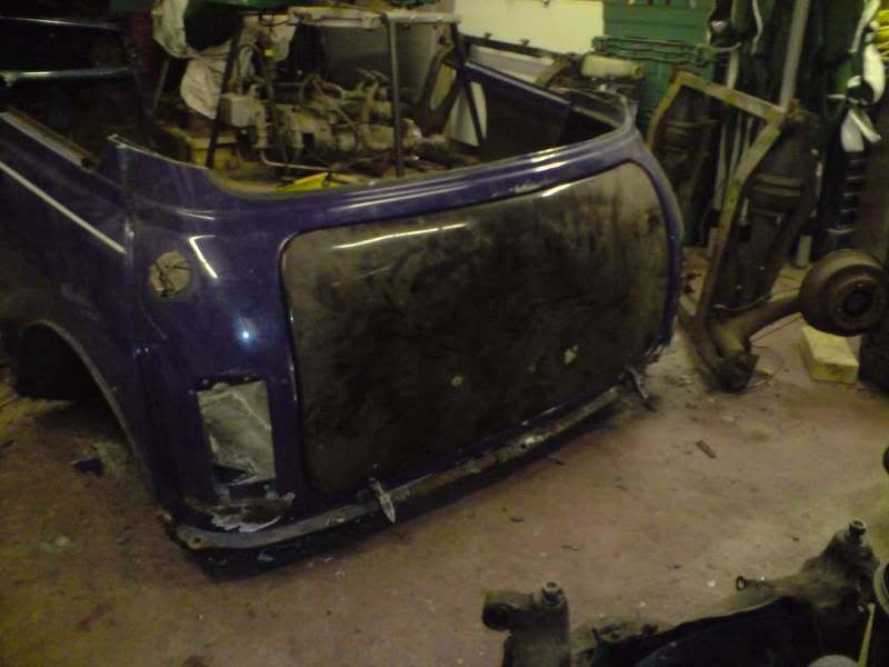

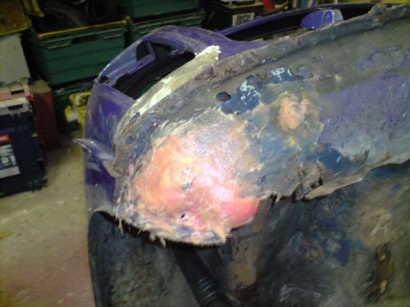

So on with some fibre glassing - The rear valence is shot, but I don't want to replace it for two reasons, a) can't afford it what with it being xmas b) There's not alot to weld it to! One side was particularly bad, no way to bridge the gap so I used two balloons to fill the gap and fibre glassed over them, like paper mache, and suprisingly it worked although obviously will have to do further filling and sanding to get the right shape.
So for now thats the rear half done, I will finish it off later.

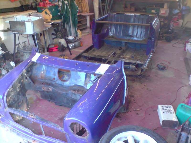

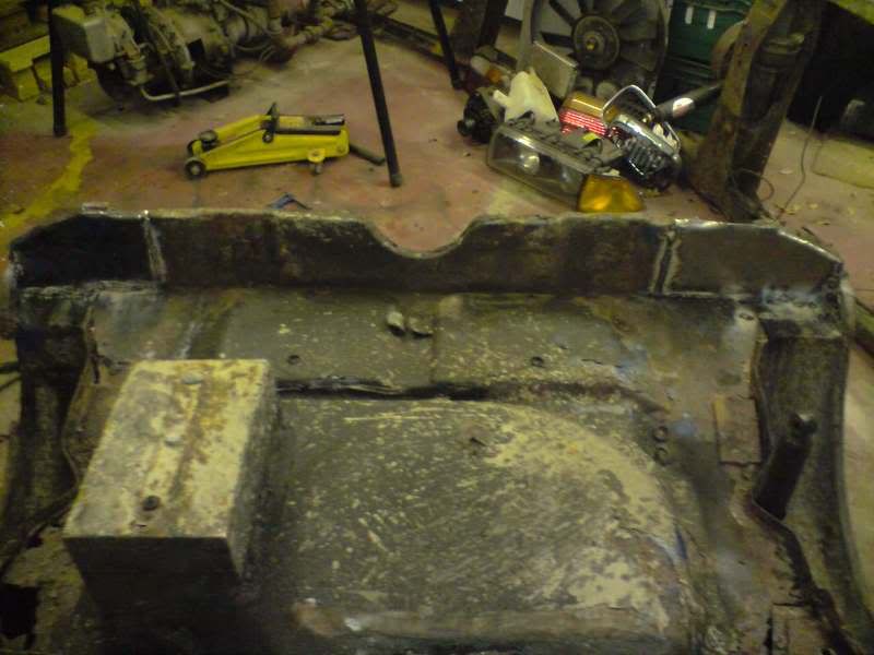

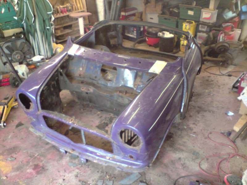

Next I made a good straight cut on the front half. Then I pushed the two halves together and found a problem, the front is wider then the rear. So I had to weld a plate in to attach them and later I will have to do some more filling to make it nice and smooth, hopefully it won't be too obvious. If people can do it for a shorty im sure I can! Anyway the good news is that the front is now attached to the back and it starting to take shape!

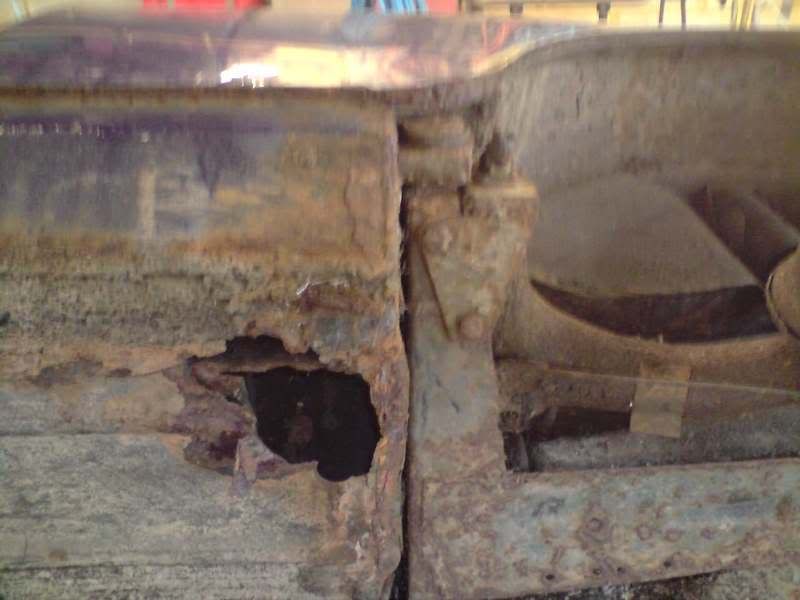

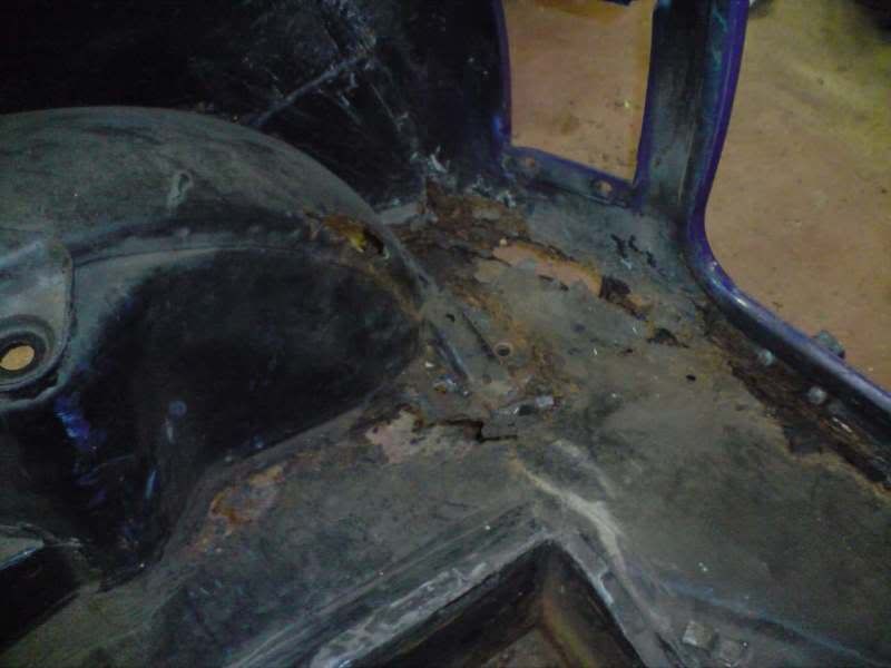

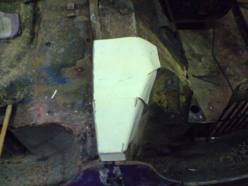

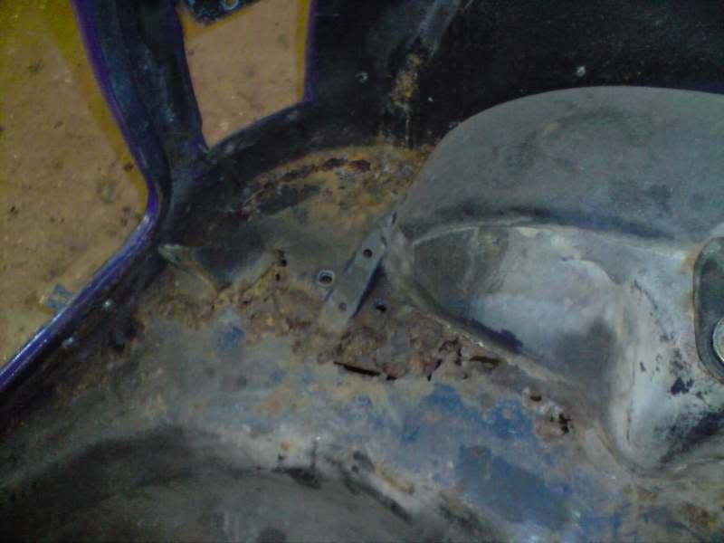

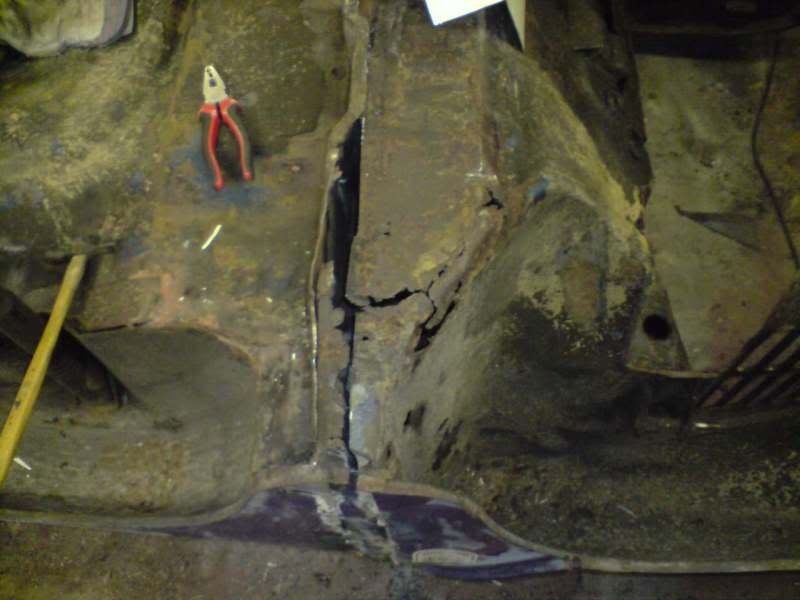

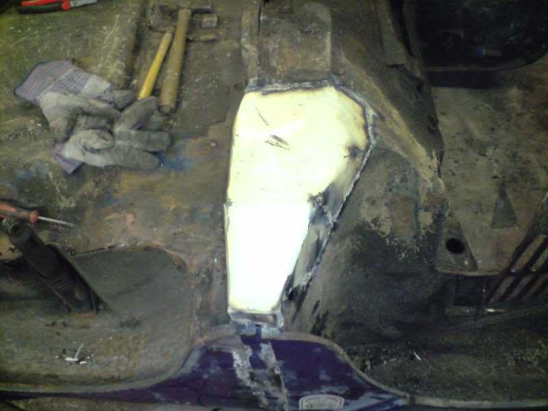

Next I rolled it onto its (lack of) roof and set about welding the floor pans together. Unfortunately there was yet more rust in the footwells so I have made panels to fit both sides and will make a panel to go over the middle section from whats left of the floor pan. Then it should be solid and not fall in half when im towing!
Passenger side before -
During -
and after -

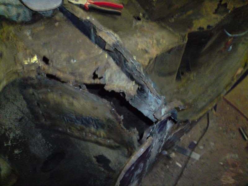

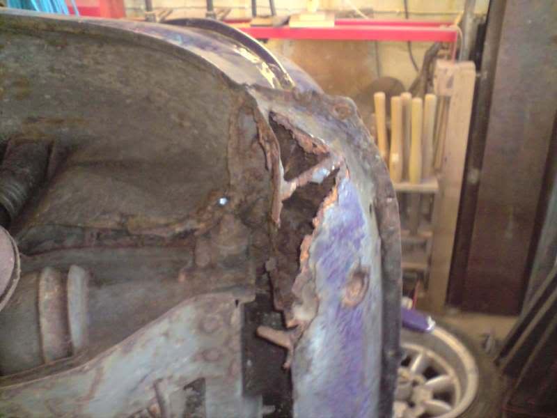

The driver side was alot worse, and somewher in its life someone has tried to badly repair it
Once removed I was left with -
And thats how it now sits, on saturday I hope to finish off welding the floor together followed by either re-attaching the subframe or starting on the fillering or both.

Looks like an interesting project,... regarding the valance though... did you cut all the rot out before fibreglassing?
