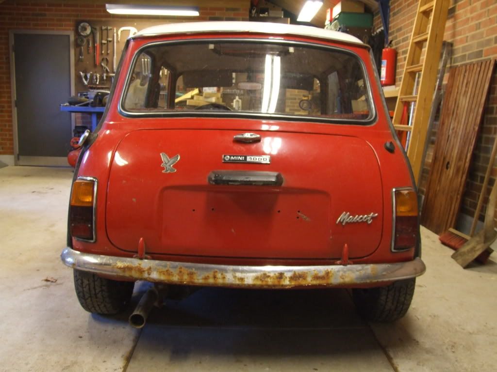

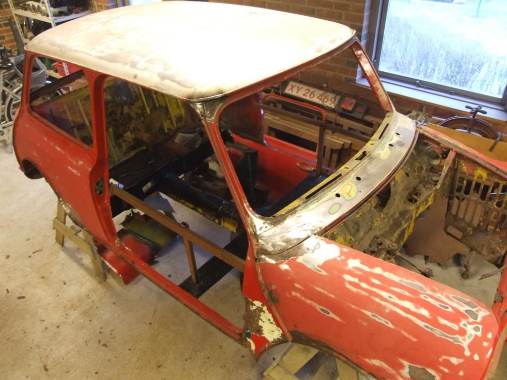

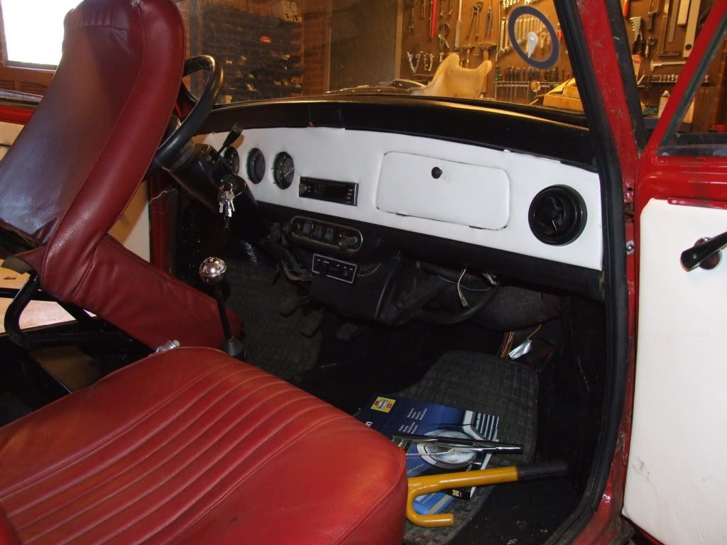

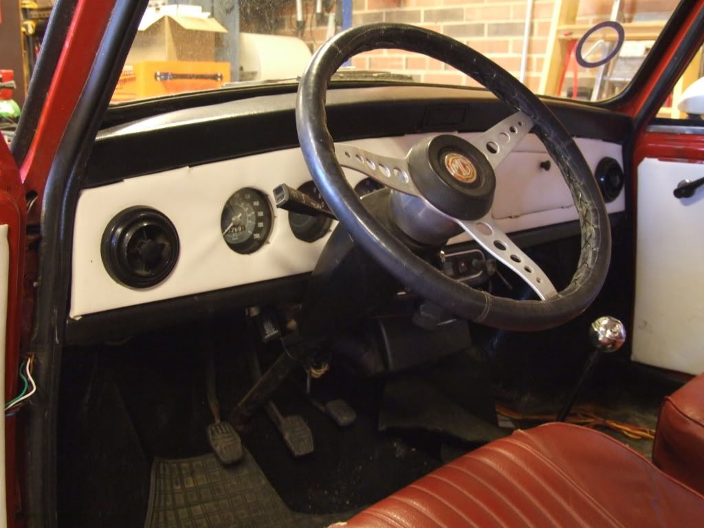

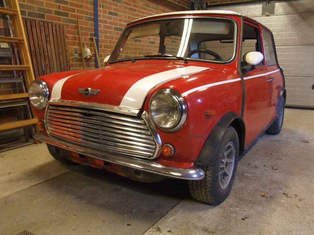

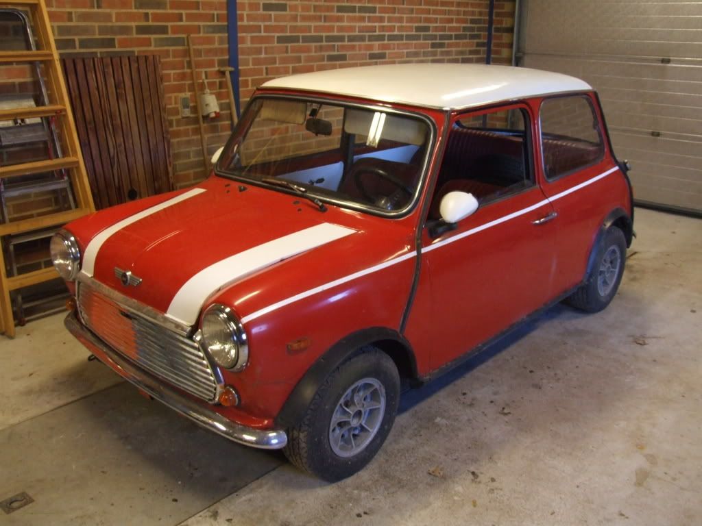

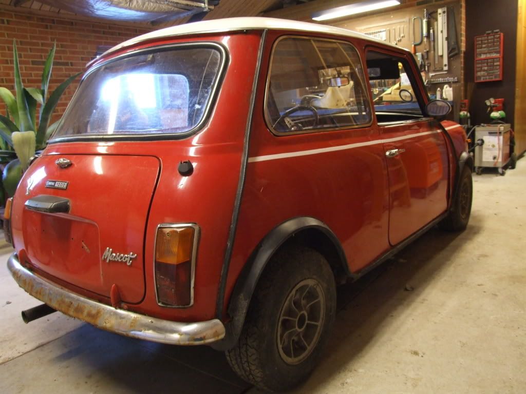

So, this is my first rebuild, first mini and first car.
Thought it would be a qiuck restore. The plan was simple: fix the small rust spots so it could be on the road for 3-5 years while I study. Thats not how it went :teehee:
Went to see this Mini knowing it would need a mild restore, but with no idea of what sort of condition it ought to be in. Next morning i called the local BMH dealer to hear his oppinion. He just laughed and said i should find another car, but anyways 10 hours later it was on a trailer and heading home. :proud: Such a nice car shouldn't end up at a breaker ;)
The plan with the car is to have all the rusty bits replaced, and build it up after the specs I like. I'm thinking of a British Racing Green body with Wood & Picketts arches and 12" minilights, a stage 2/3 988 engine and spotless interior.
Not really looking that bad at this point, but it gets worse.
The morning after we tried to start the engine, but with no luck. Found out the cylinders kept flooding with coolant and the oil ran onto the floor via the clutch. More pics to come later
Edited by Rasmus Holst, 26 April 2009 - 08:38 PM.

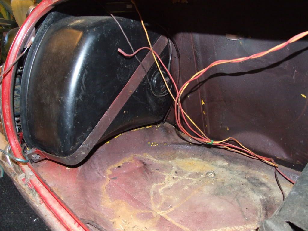

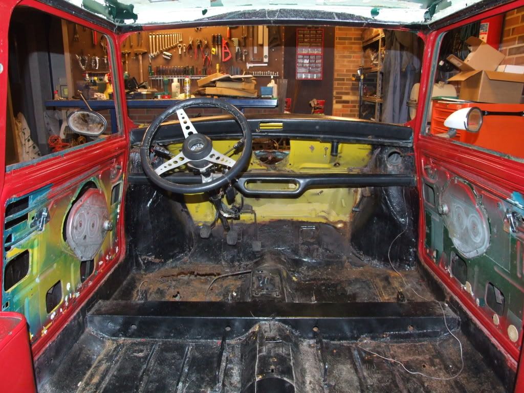

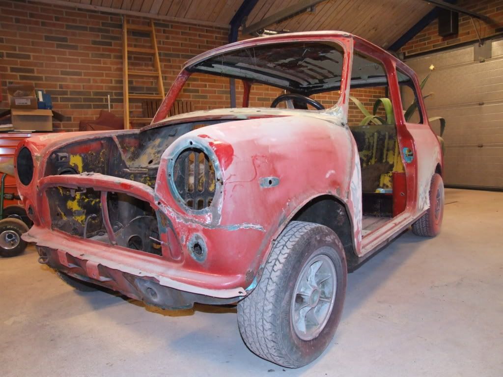

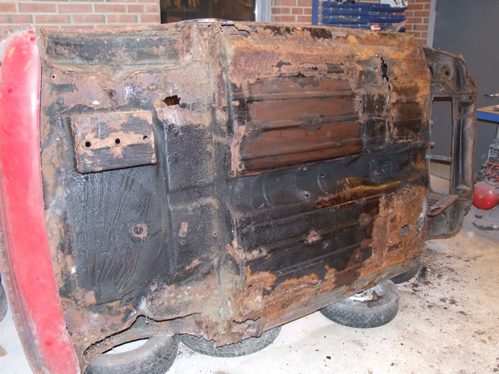

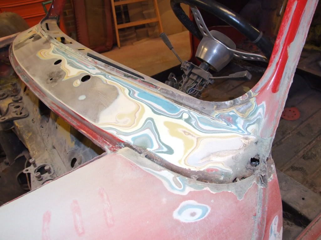

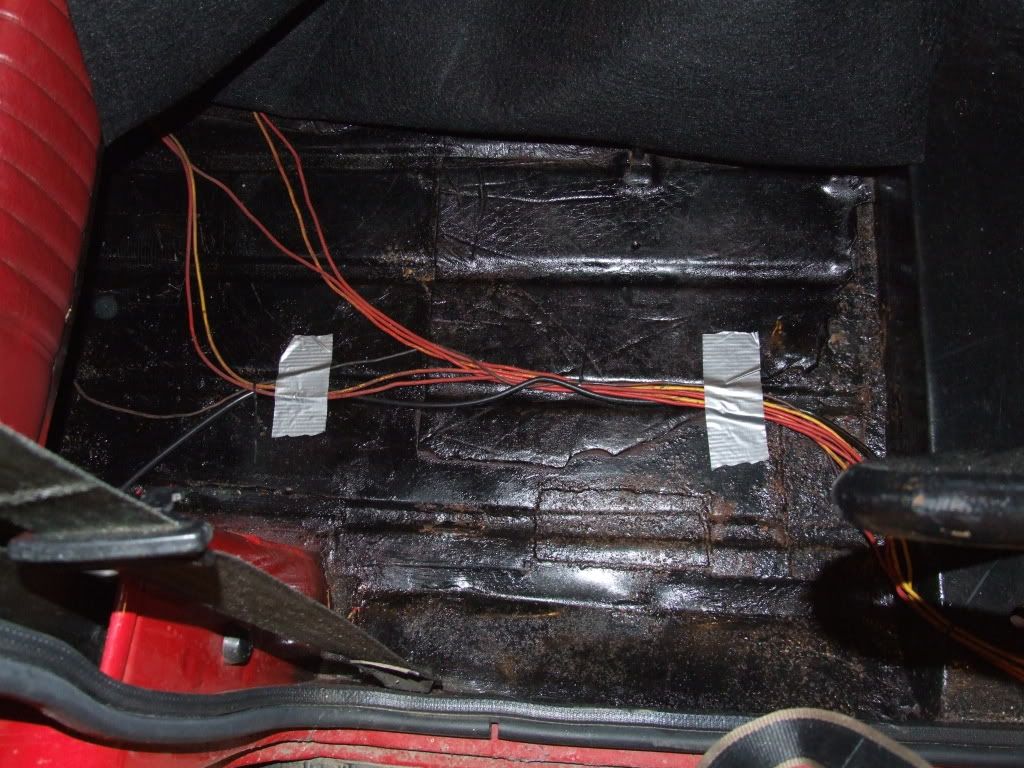

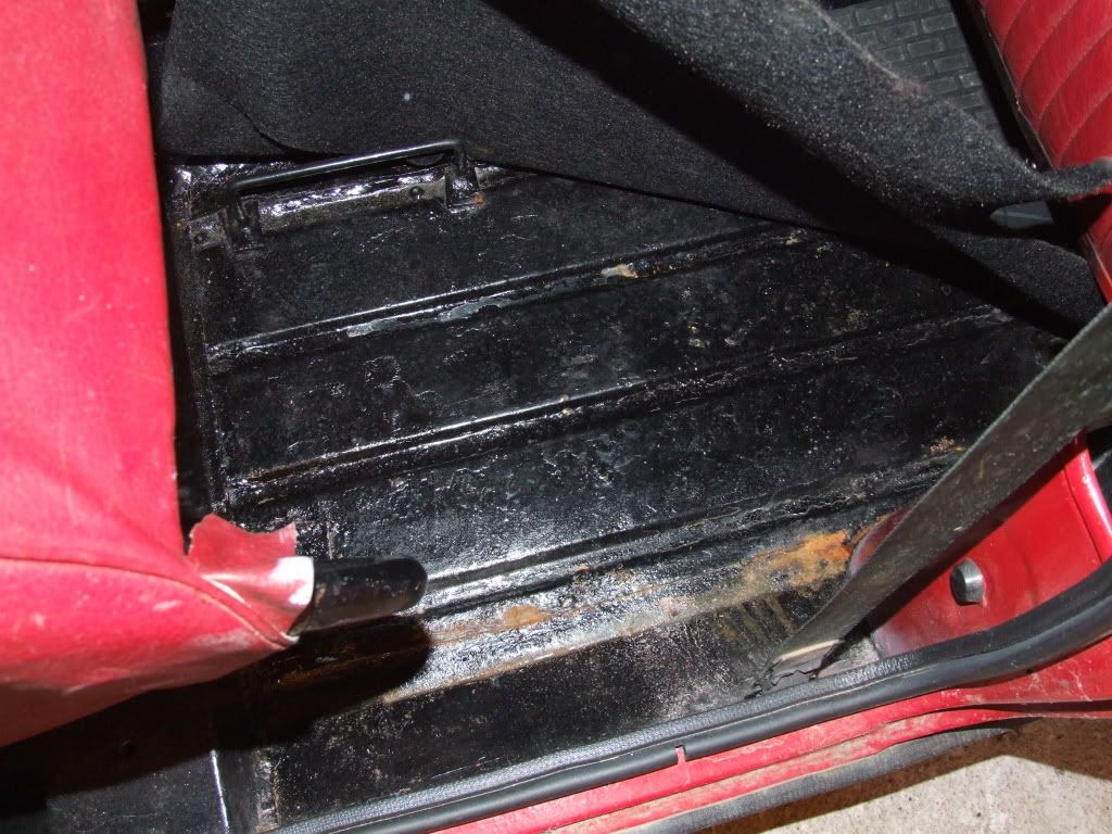

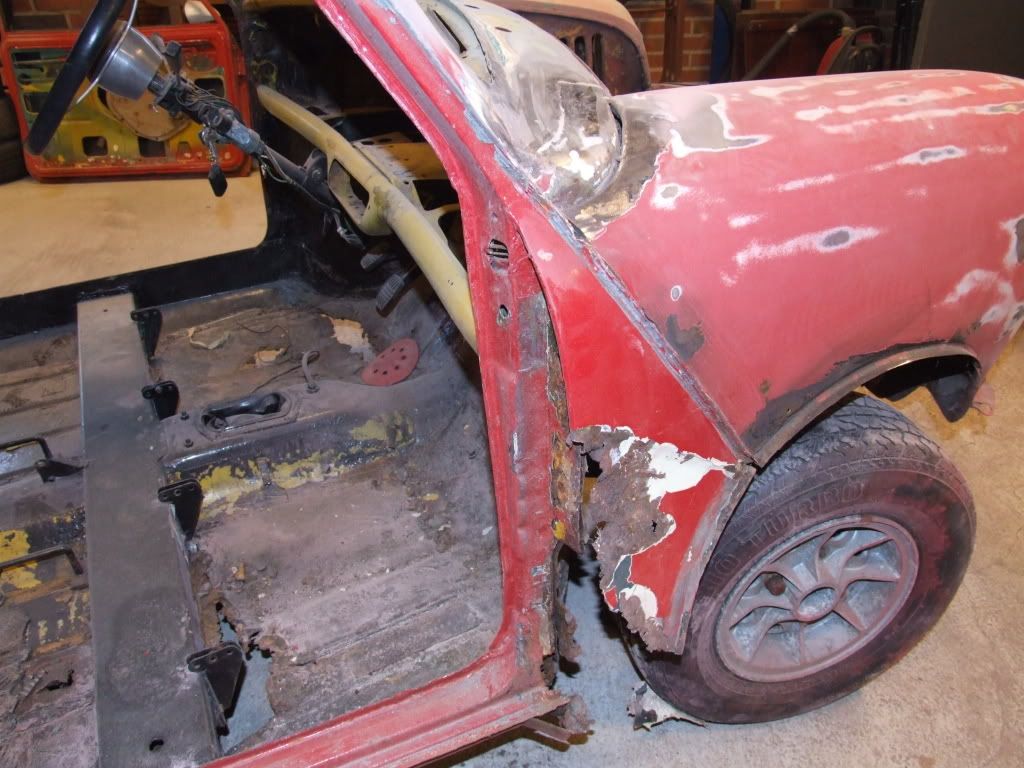

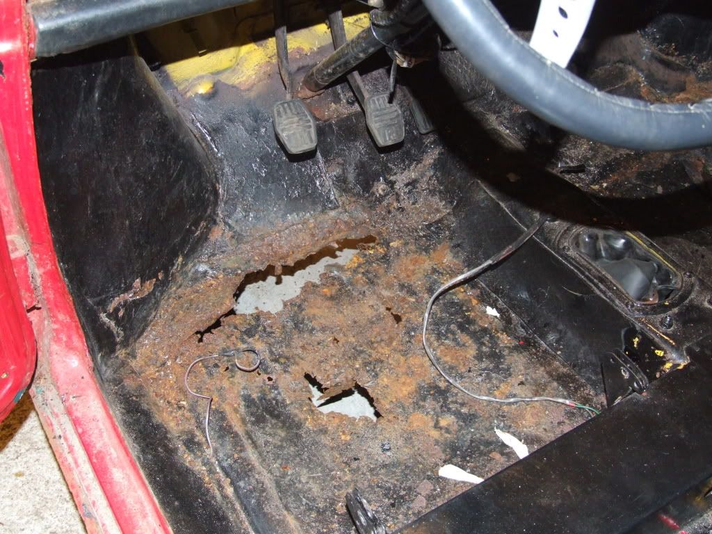

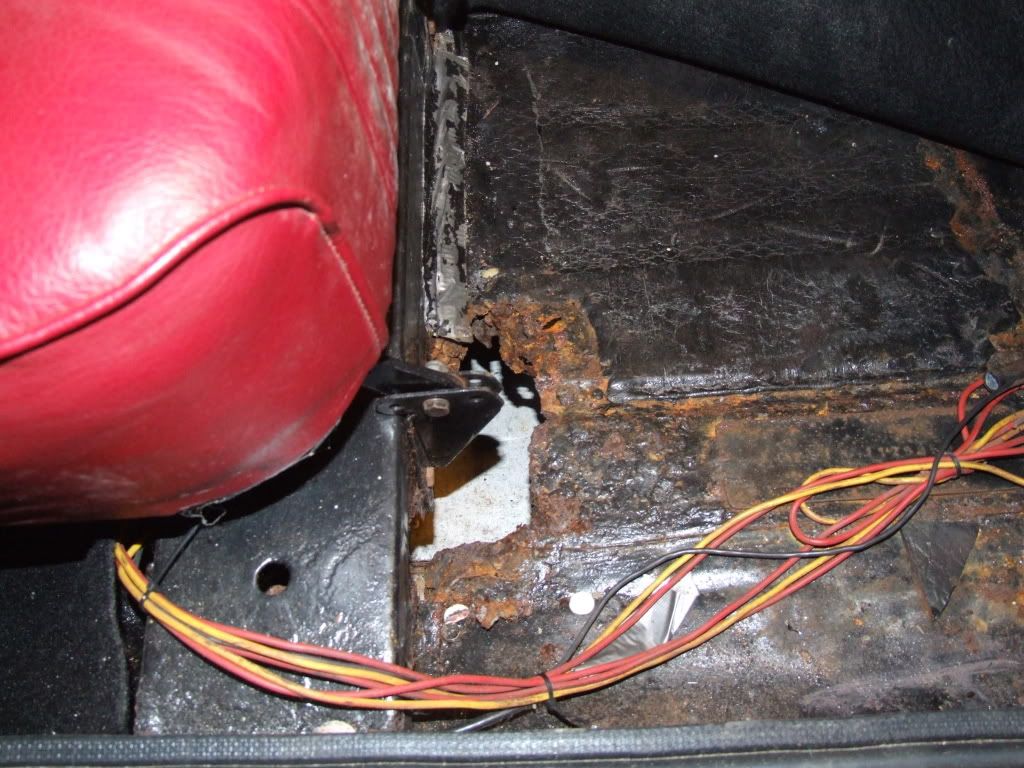

Stripped the car totally and began to sand it down. One of the privious owners had done a crappy job with a earlier restore. The panels didn't align, the welding seams wasn't grinded down, metal patches had been welded in whitout any concerns, and it had all been covered with filler. They even covered rust with filler. :proud:
This was one of the places where they just covered holes and rust in filler. it was about 1 inch thick!
It didn't look that bad when carpets and paint covered the whole thing.

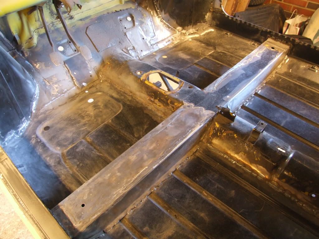

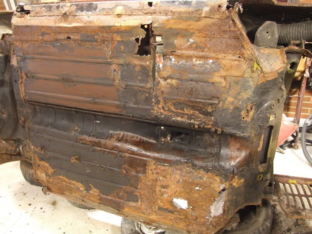

The crossmember wasn't as good as it looks. Once I got the paint off, it allmost fell apart. Only the top of it could be saved, so I made some new sides for it. Got a couple of pics of that to come.

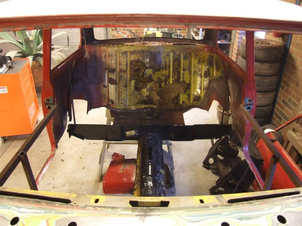

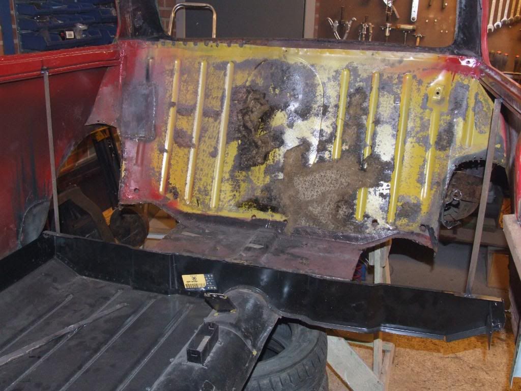

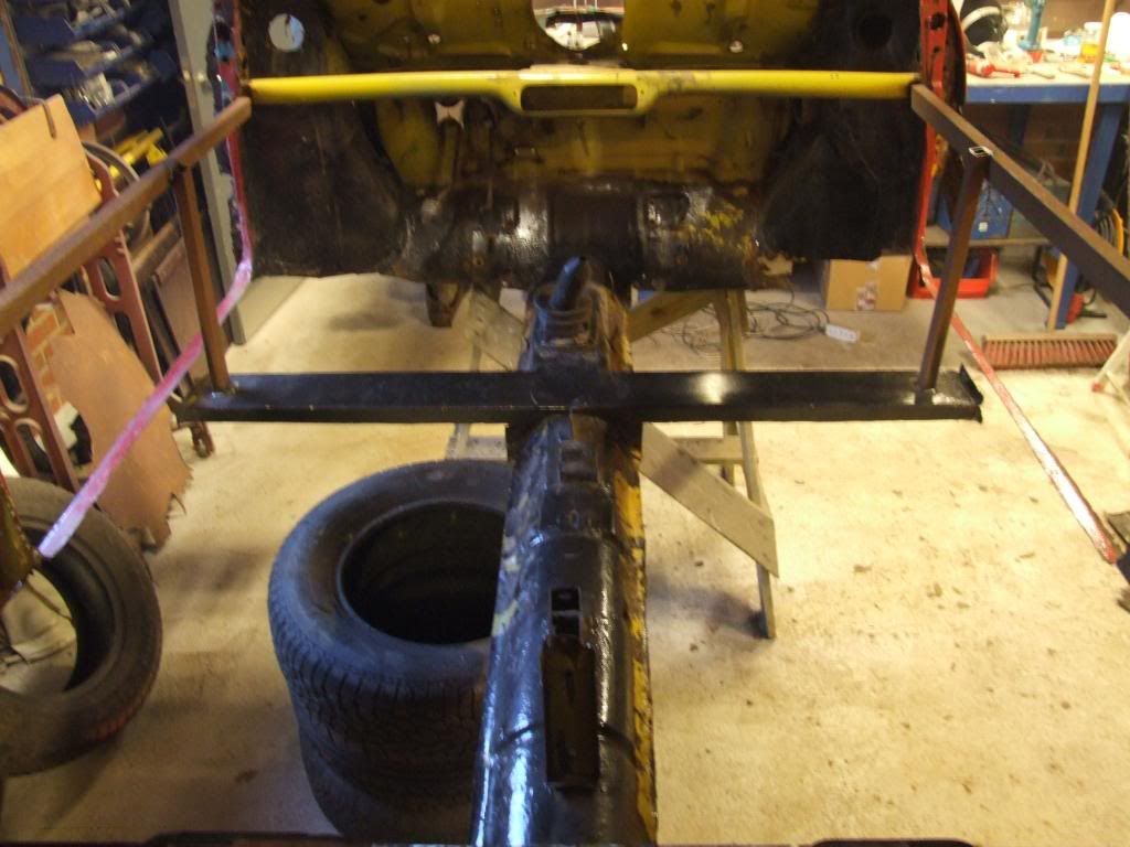

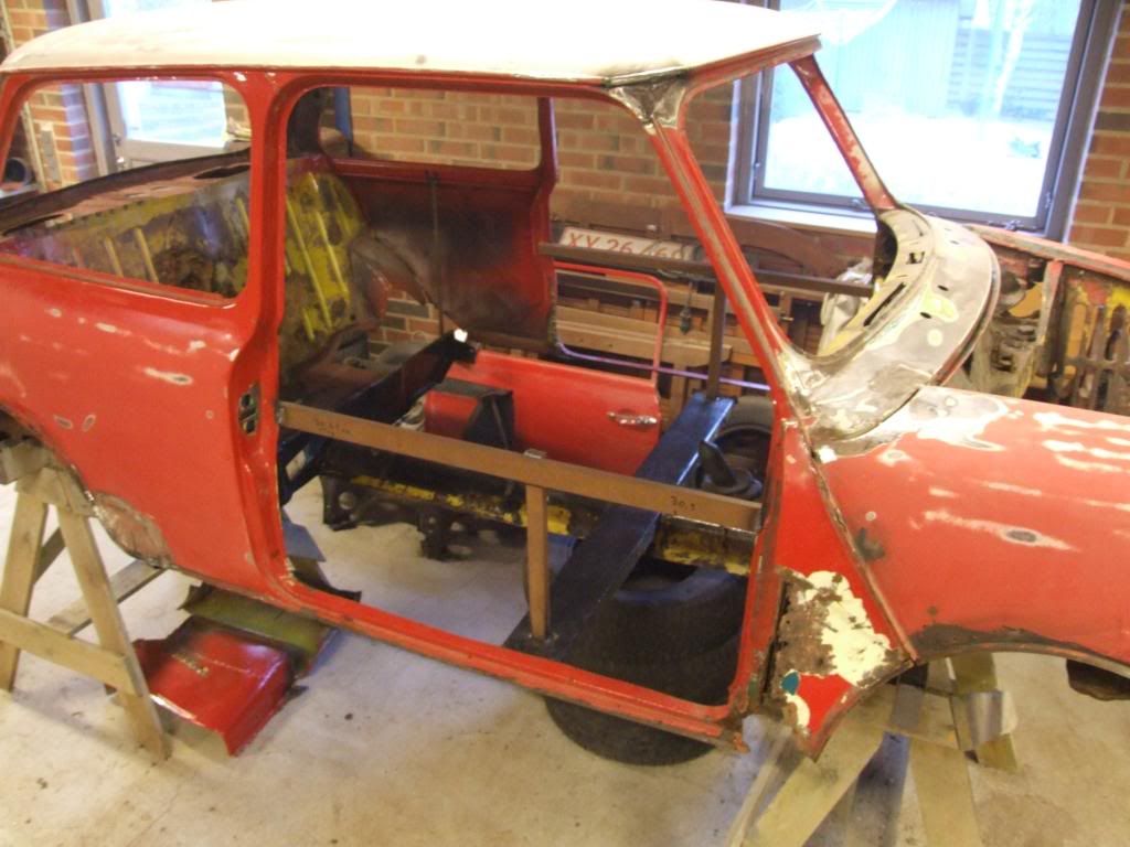

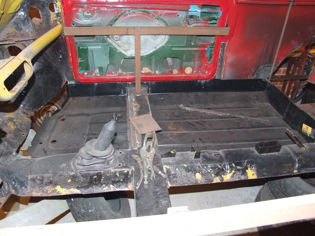

The next thing that had to be done, was to strengthen the body for when the floor came out.
Looked like this:
These pics were taken after the panel to mount the rear subframe on was mounted (don't know what it's called) :)
The crossmember was bad at the bottom, so these where cut off as well.

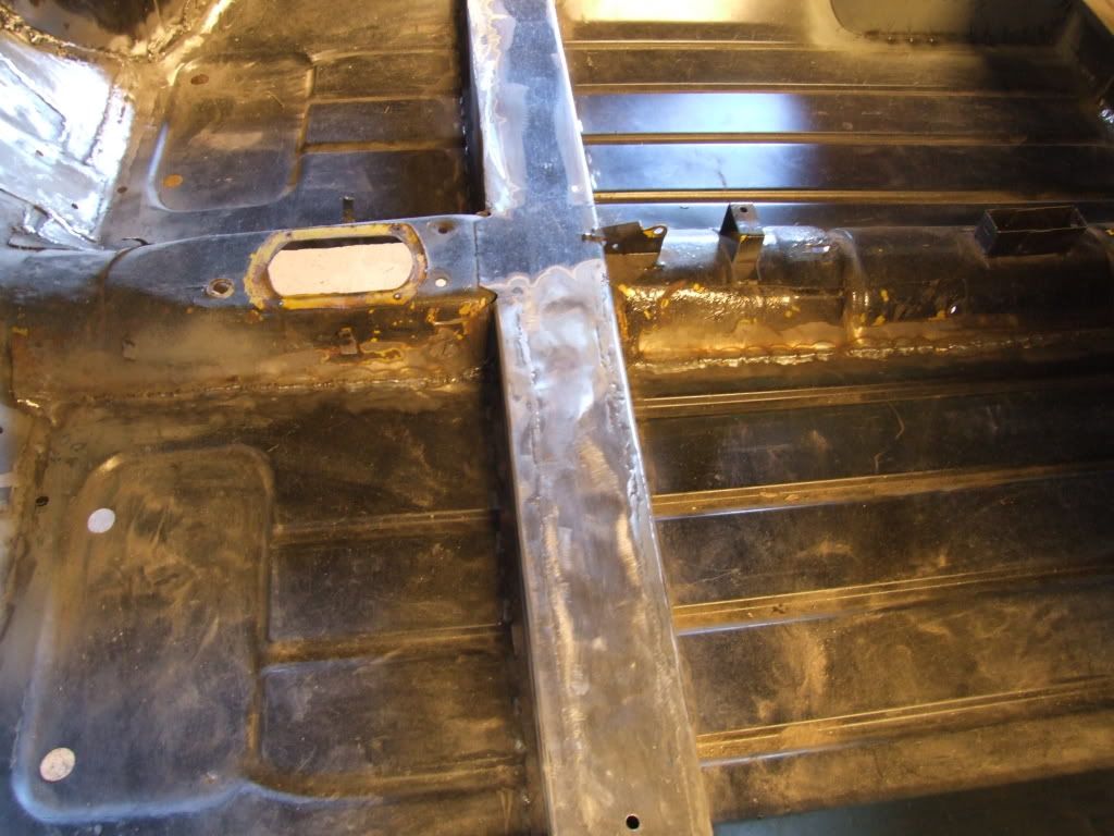

The floor-pan and doorstep installation began:
At the picture above you can see the part of the crossmember that was good enough to save.

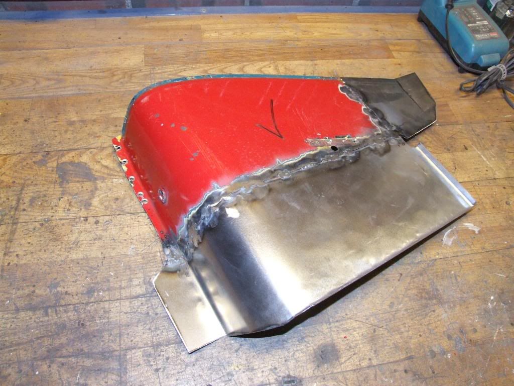

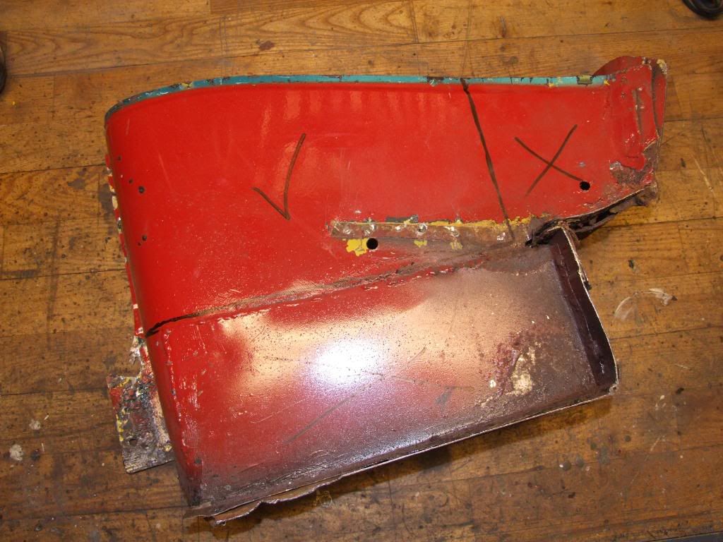

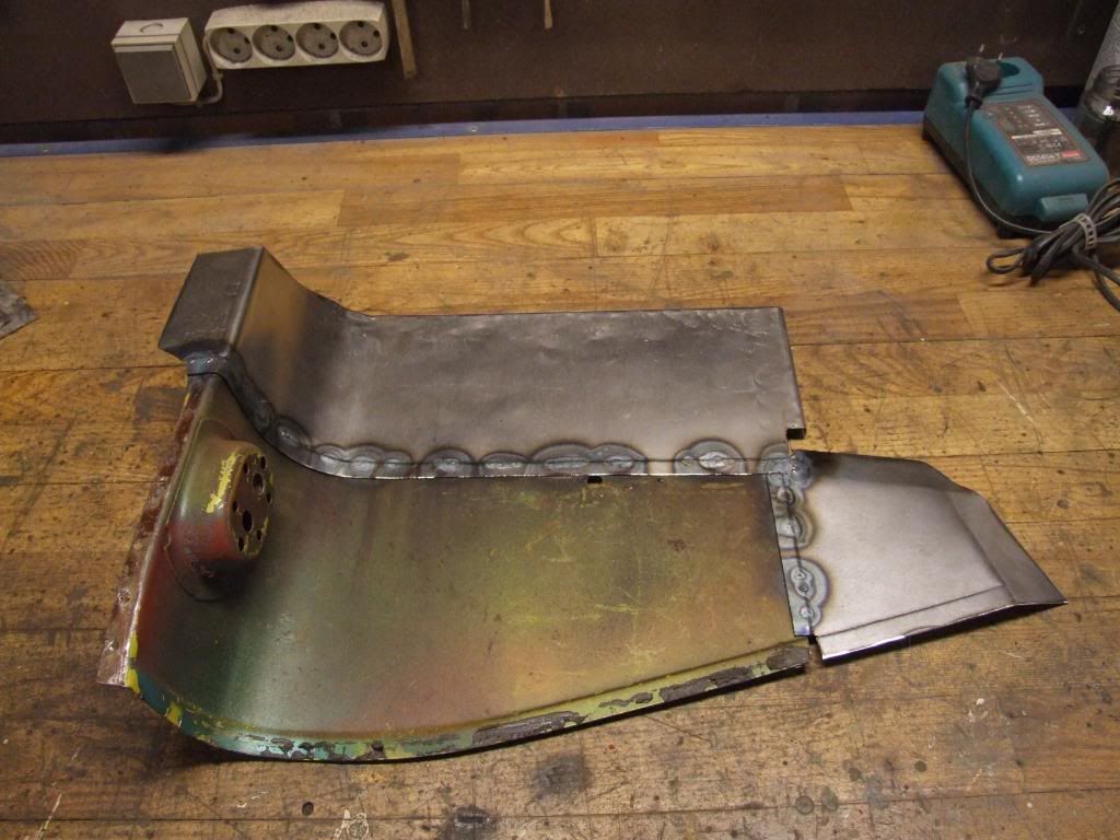

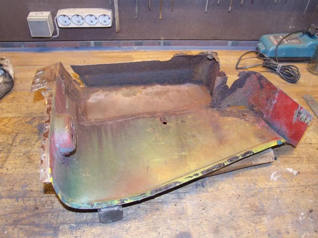

Also had time to do the side bins.
This was what they looked like before:
How to cut it:
And the result:
- very much close to perfect :) only setback was when I forgot to lift it off the table while welding. Made a huge burn in it, guessing dad won't be happy about that :thumbsup:

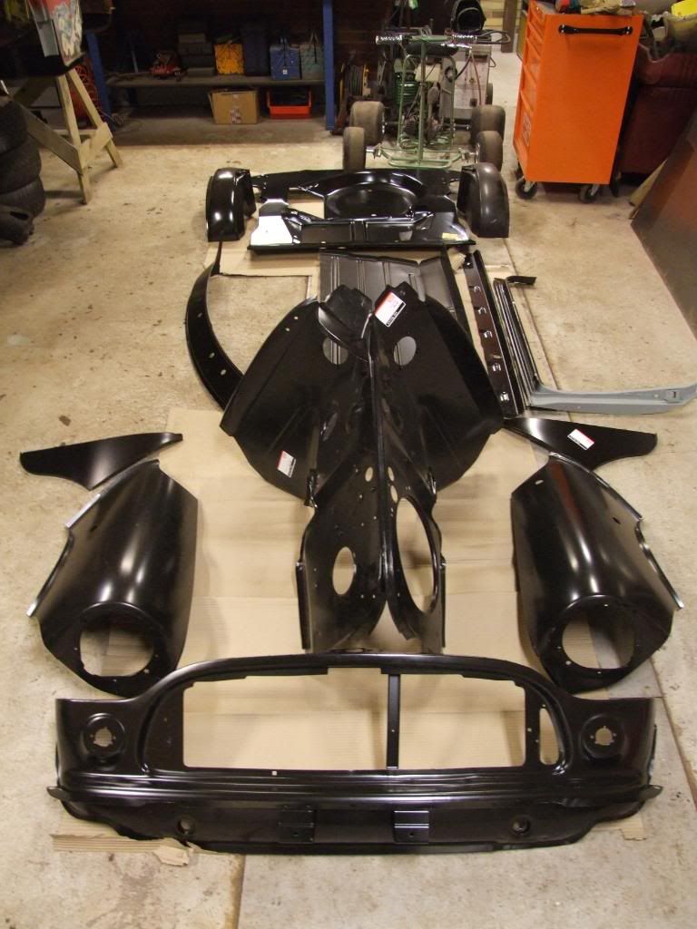

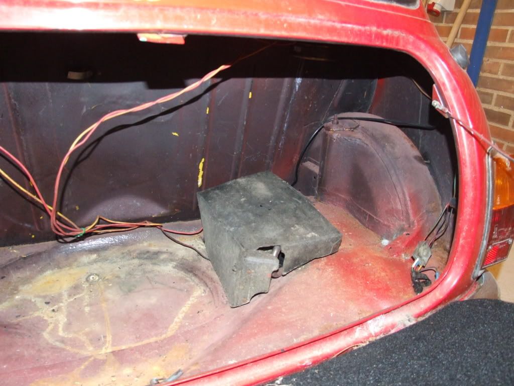

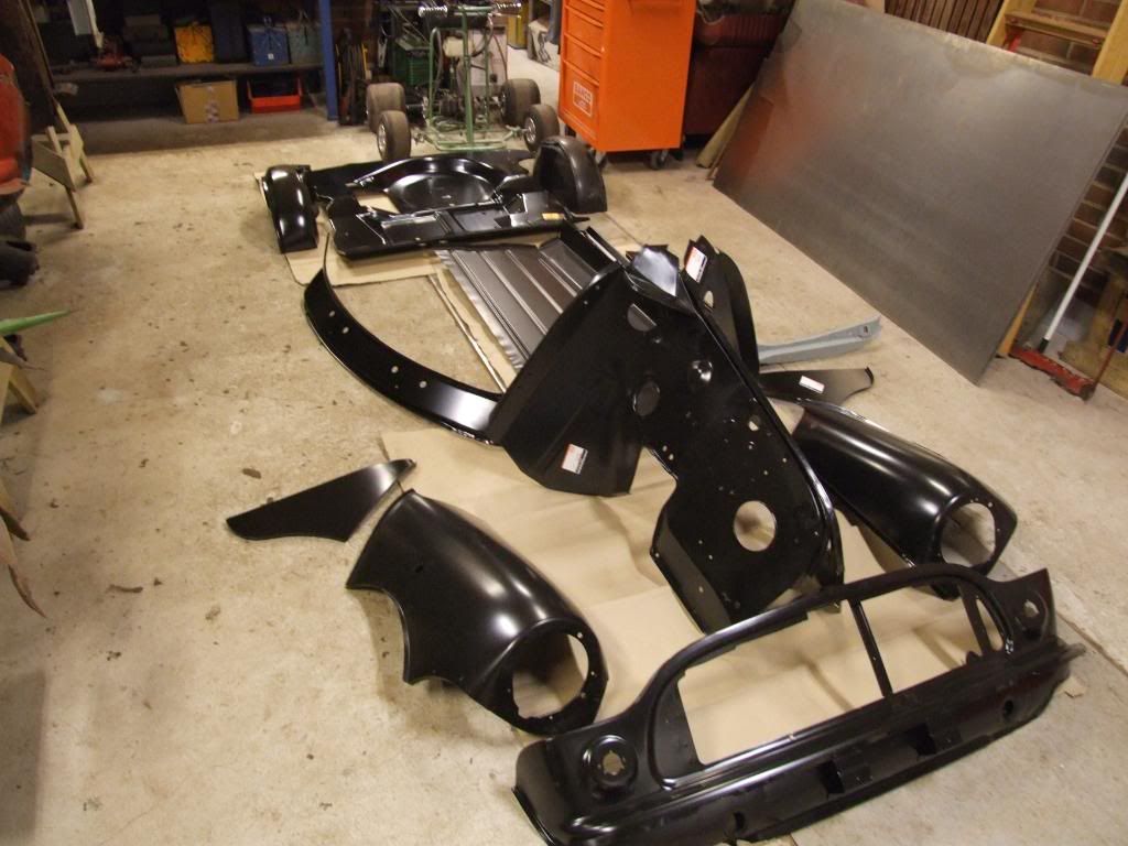

Got a pic of the first shipment of body panels from BMH. Can't say we don't support Britain in these financial crisis :w00t:
This was taken after the first floorpan, outer sill and doorstep was fitted.

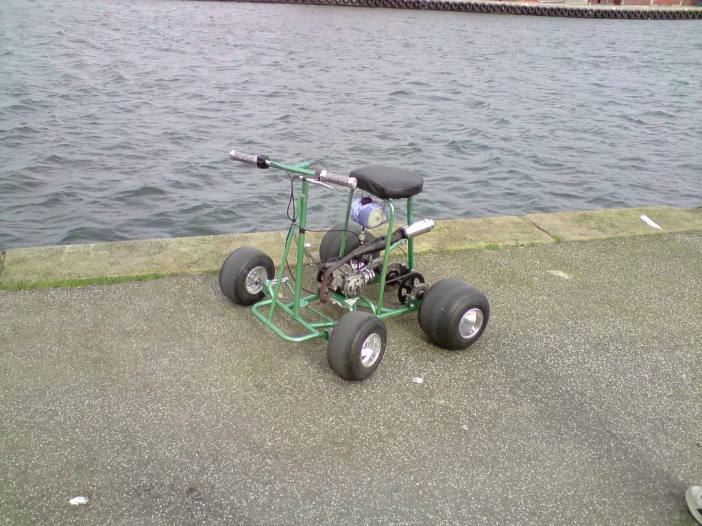

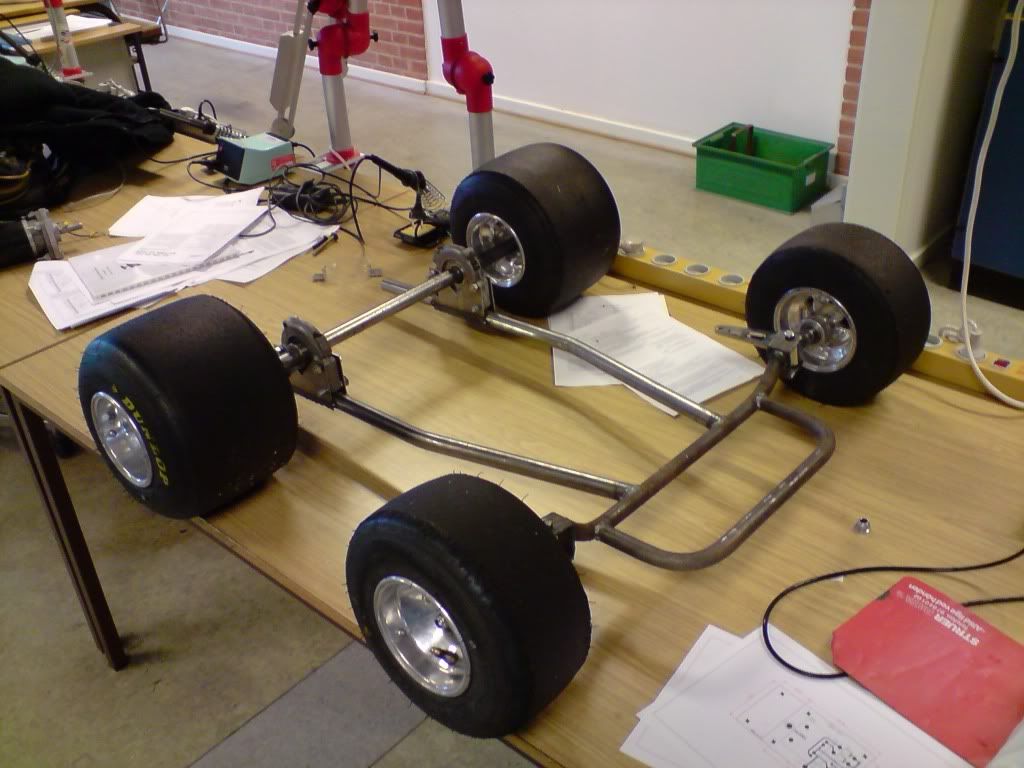

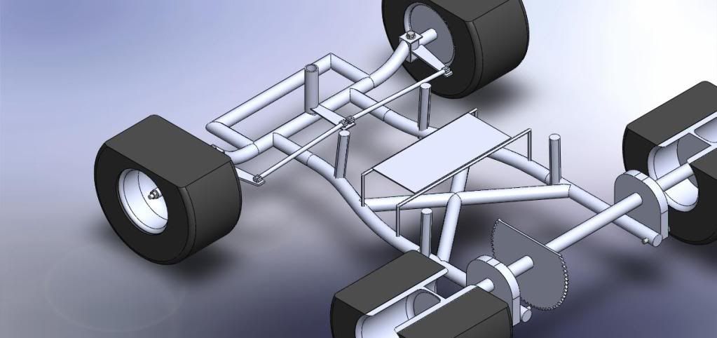

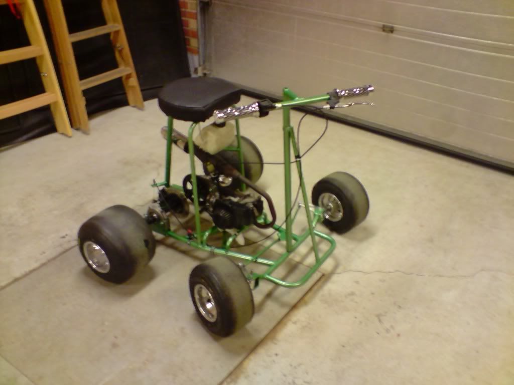

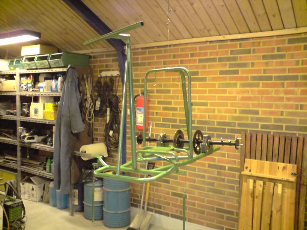

.. to Joe M, yes it certanly is a barstool racer. I made it as a project in "technology" at my gymnasium last year.
Got some pics of it:
First the rendered piccies from Solid Works
The frame after it had been welded up and tested with wheels on it
The frame finished and freshly painted
After assembley
-It's a 20mm frame with 15mm "stool-legs" and a home made 25mm shaft
-Go kart shaft bearings
-79 tooth sprocket at the back welded onto the shaft
- Go kart rims and Dunlop tires
-Drilled brake disk from a scooter
-Brake caliber from a pocket bike
-49ccm pocket bike engine with a race clutch with a 6 tooth sprocket
And of course, a nice imitation leather seat :thumbsup:

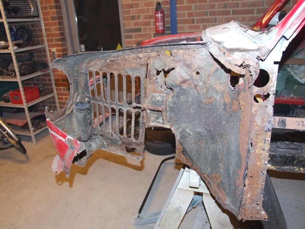

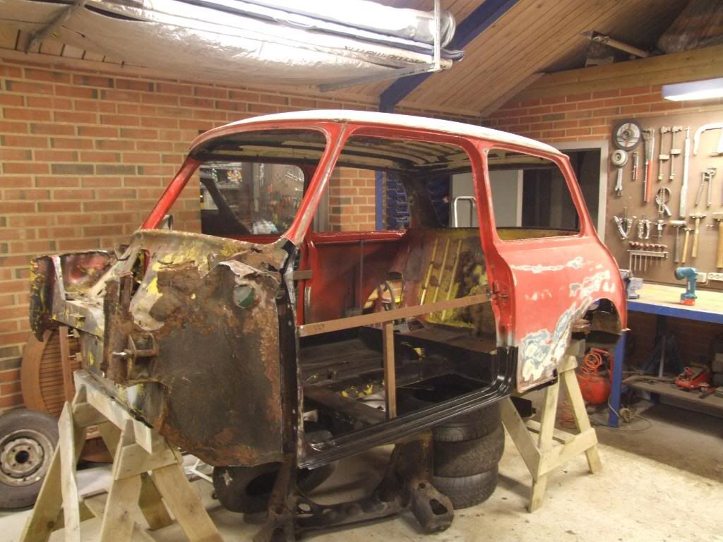

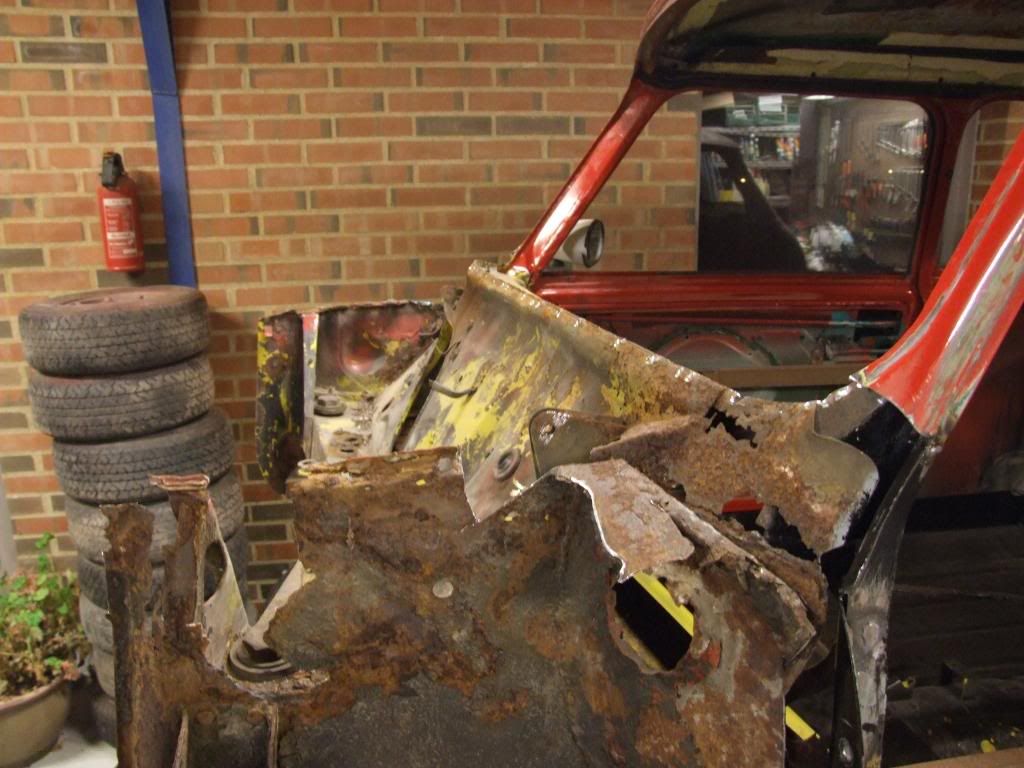

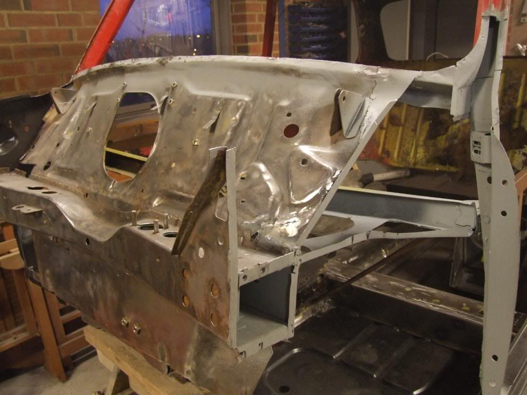

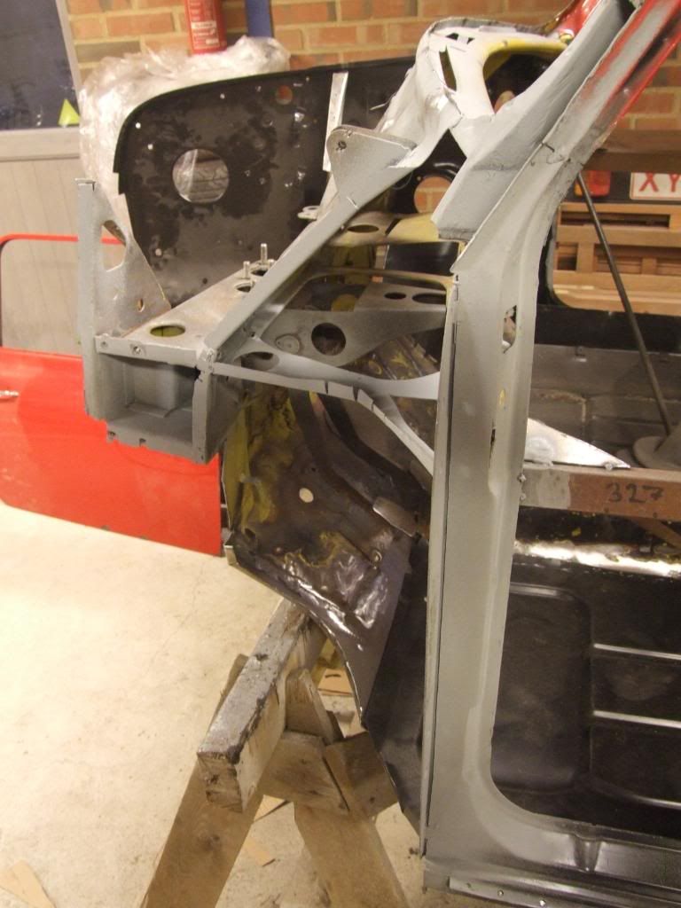

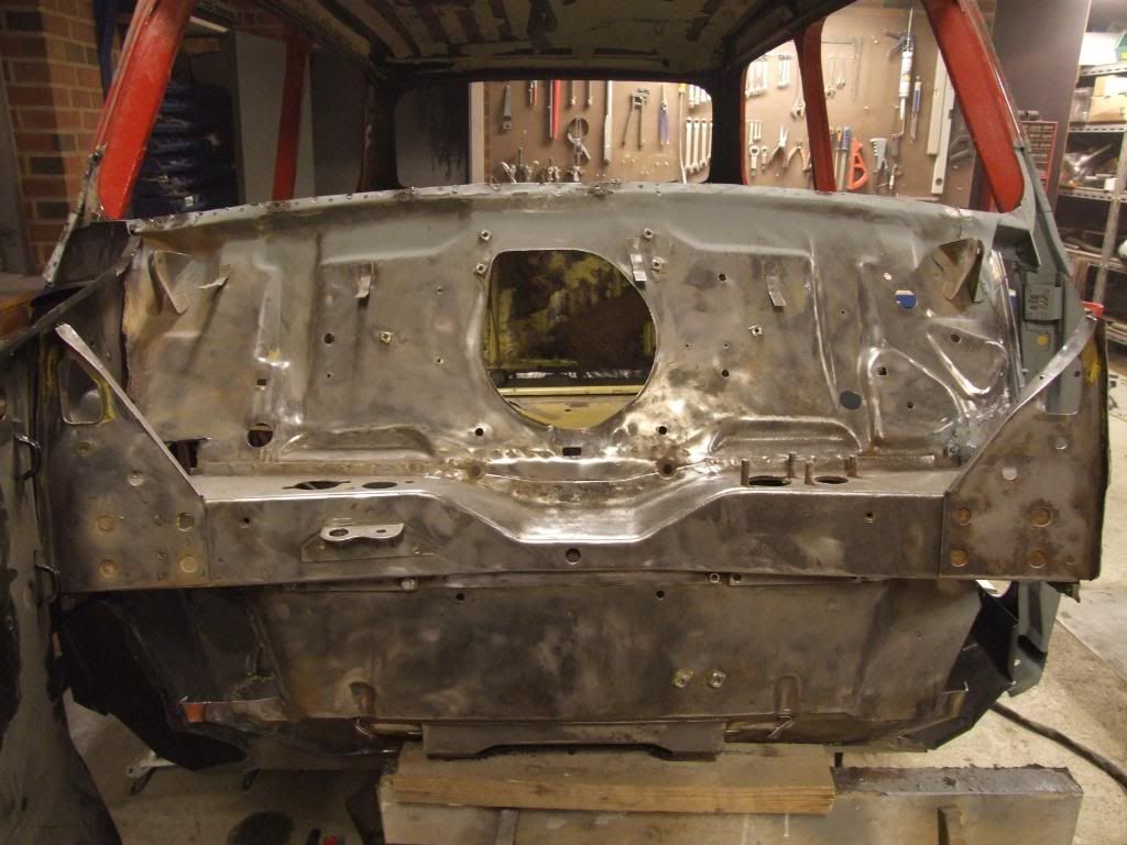

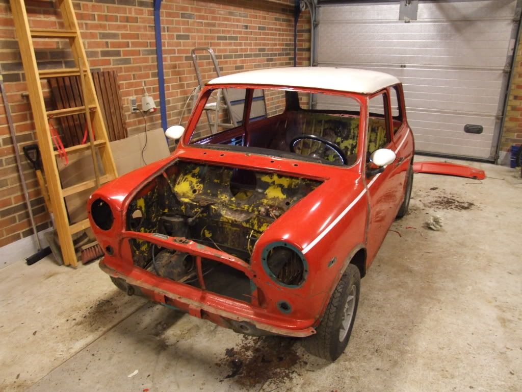

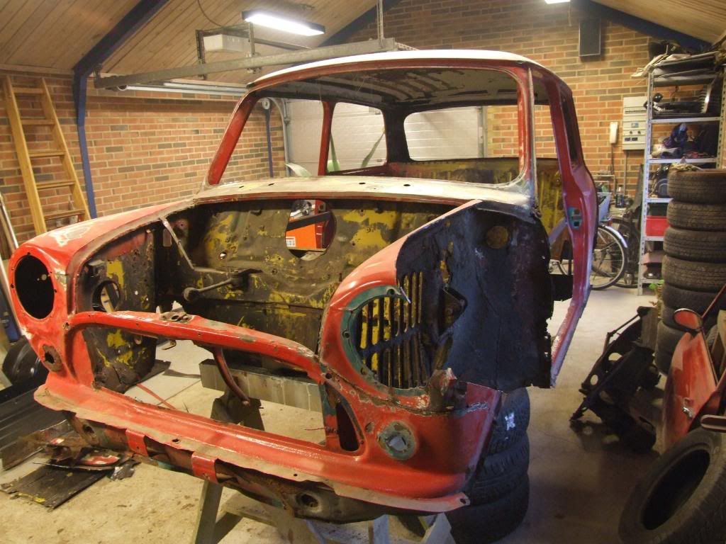

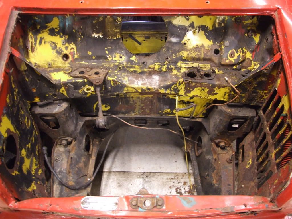

Next up is the front
Started by cutting the bigger pieces off
After this we carefully removed the panels attached to the wall between the engine compartment and the cabin, by drilling the weldings out and seperating it with a chisel. This took a long time and about a metre of plaster :thumbsup:|
Theese were taken after it I've sand blasted and sanded the wall. The right innerwing were only fixed with screws.
The closed sections was primed with zinc and painted with a layer of 2 component paint to prevent rust.
