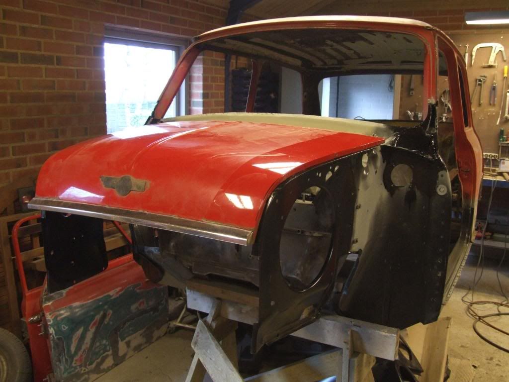

I hope it will be on the road in about a couple of months. It has taken us (me and my dad) 5 months just to get the bodywork done. Right now it's in the filler and sanding process, ready to leave for the painter in a week or two. Got the W&P arches and mirrors home today, just to make sure they fit.

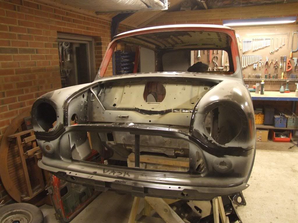

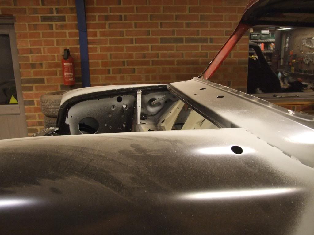

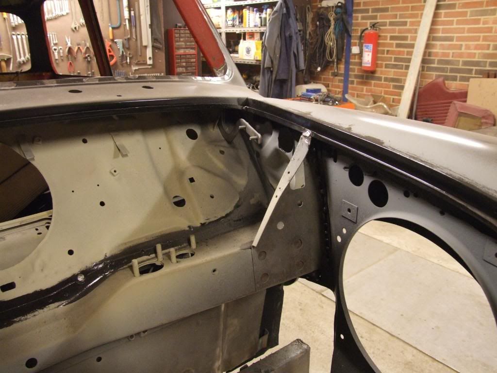

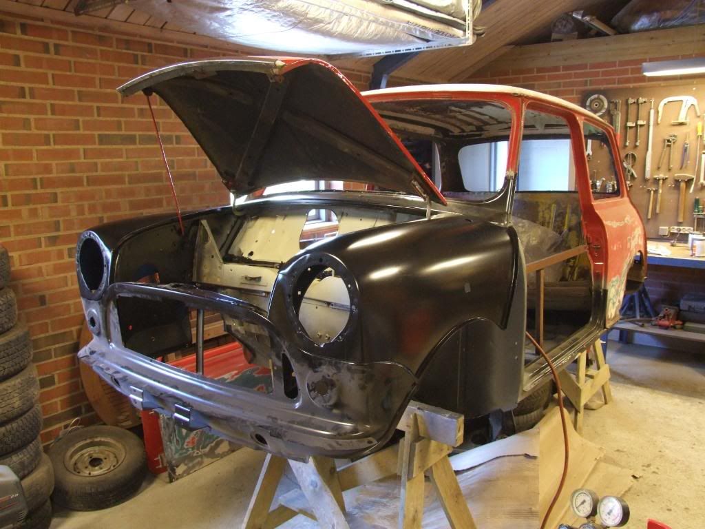

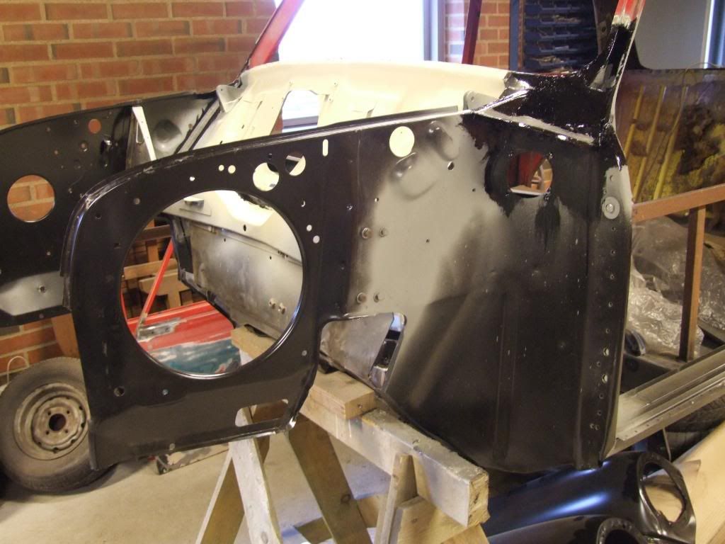

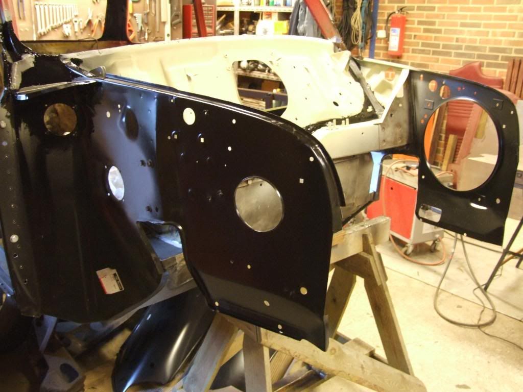

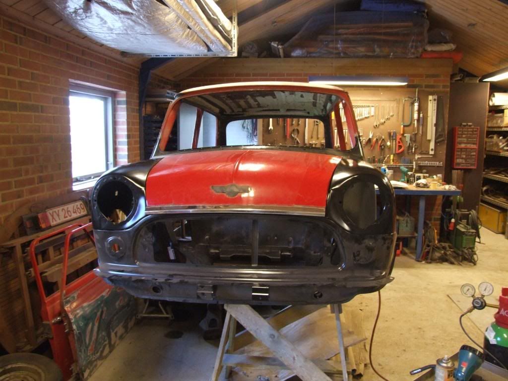

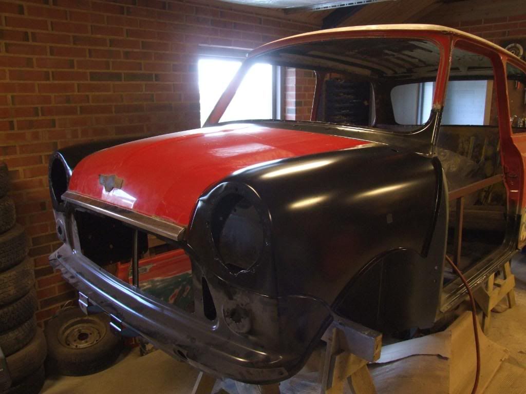

More work done to the front
Put on the two innerwings
Primed the previously sanded wall
Painted the panel joints with two component paint and sealed it
Time to make the hood fit
After this, it was time to put on the outer wings, the front and the panel below the window
All the joints painted, ready to be sealed.
Considering the "before" picture, i'm pretty pleased with the way it turned out :P.

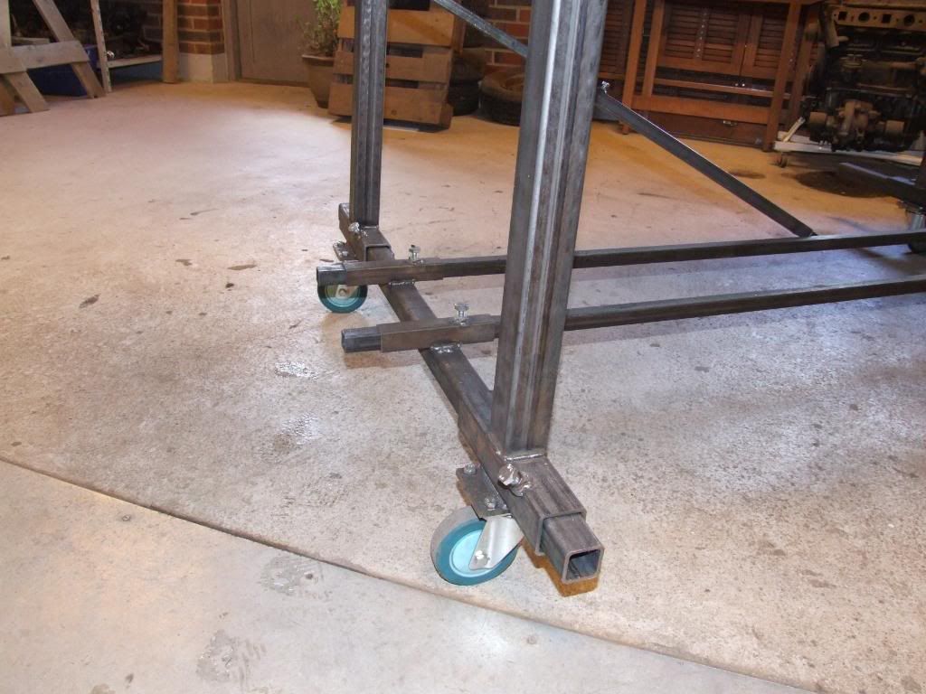

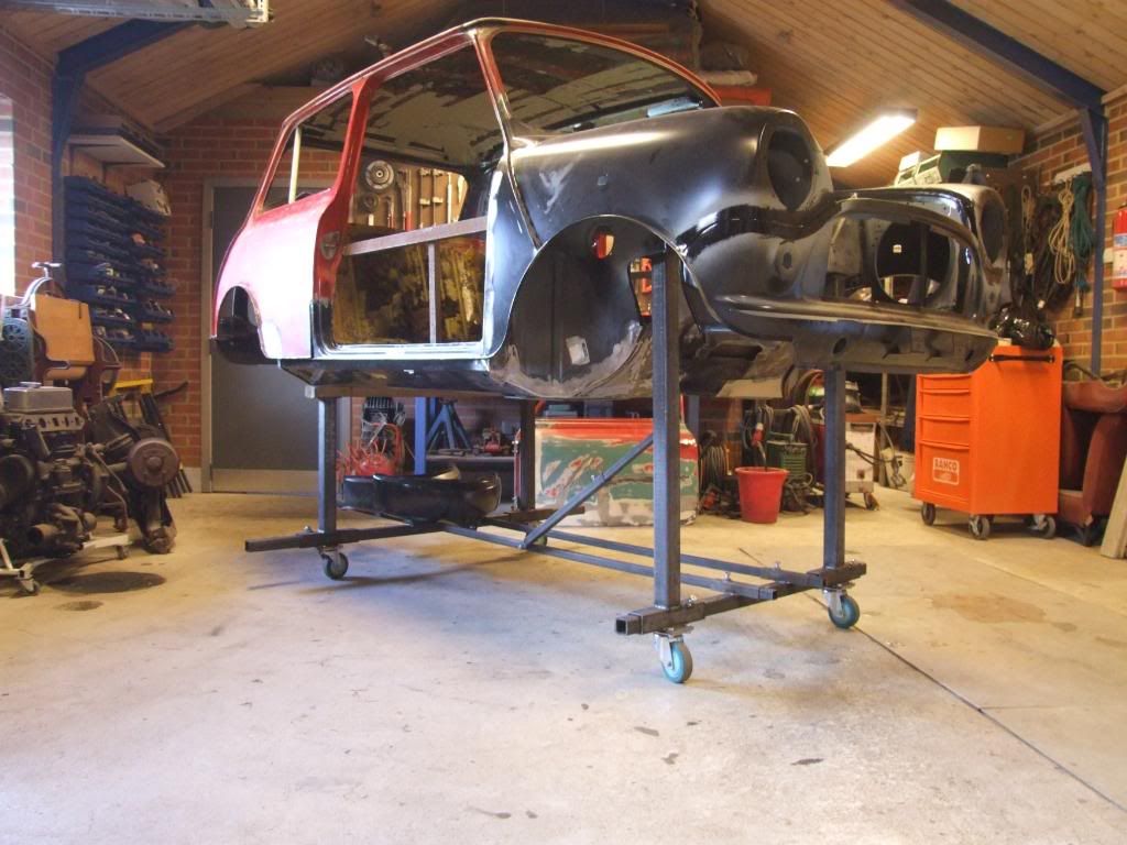

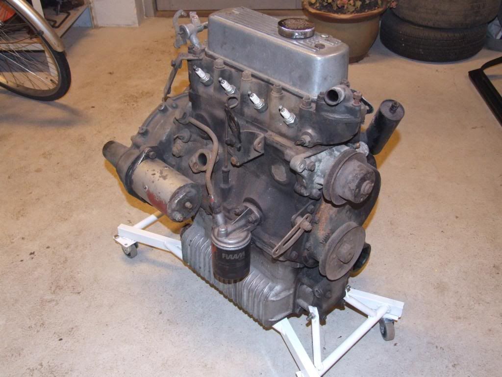

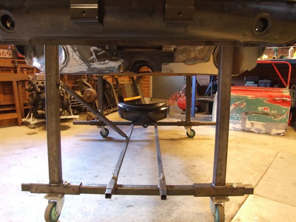

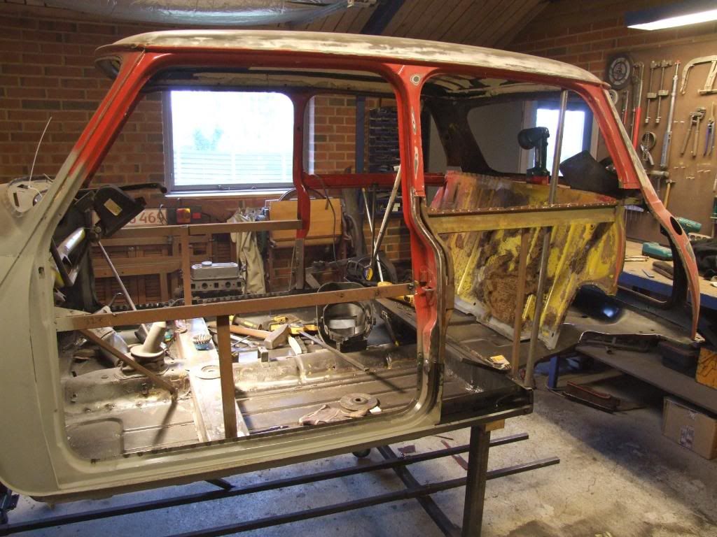

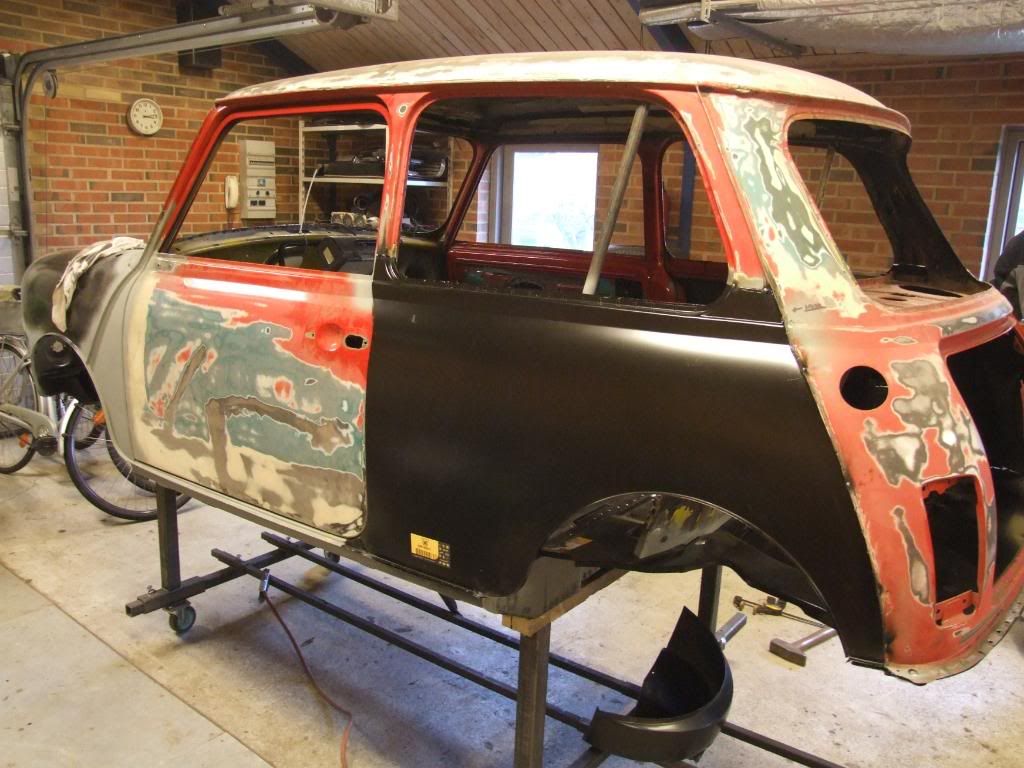

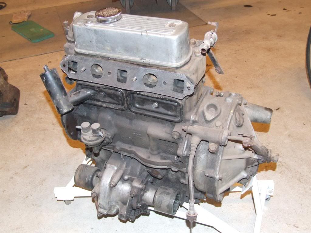

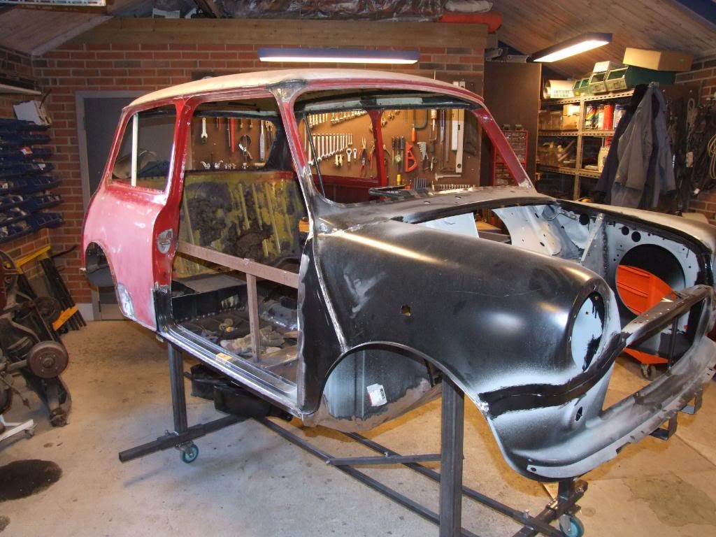

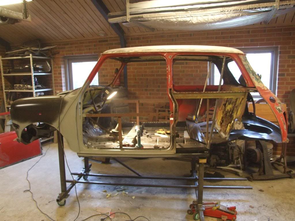

Made a stand for the body. This makes it much more easy to work on it :angel:
Also made one for the motor:
Got the A-panels mounted as well
Edited by Rasmus Holst, 04 May 2009 - 04:03 PM.

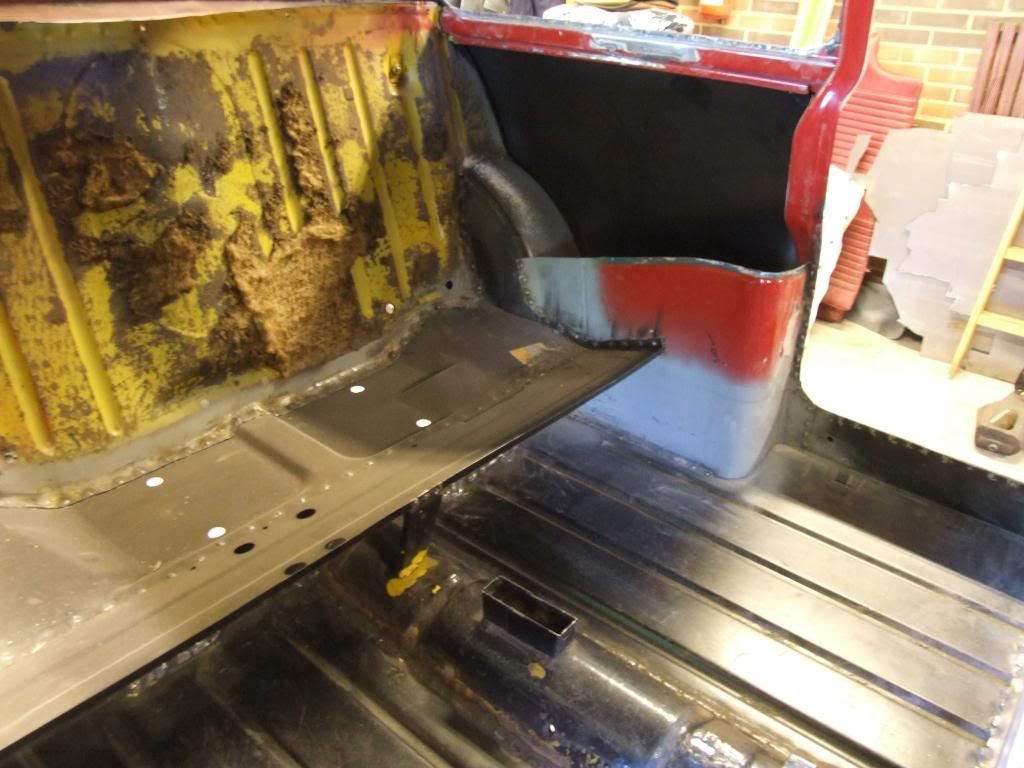

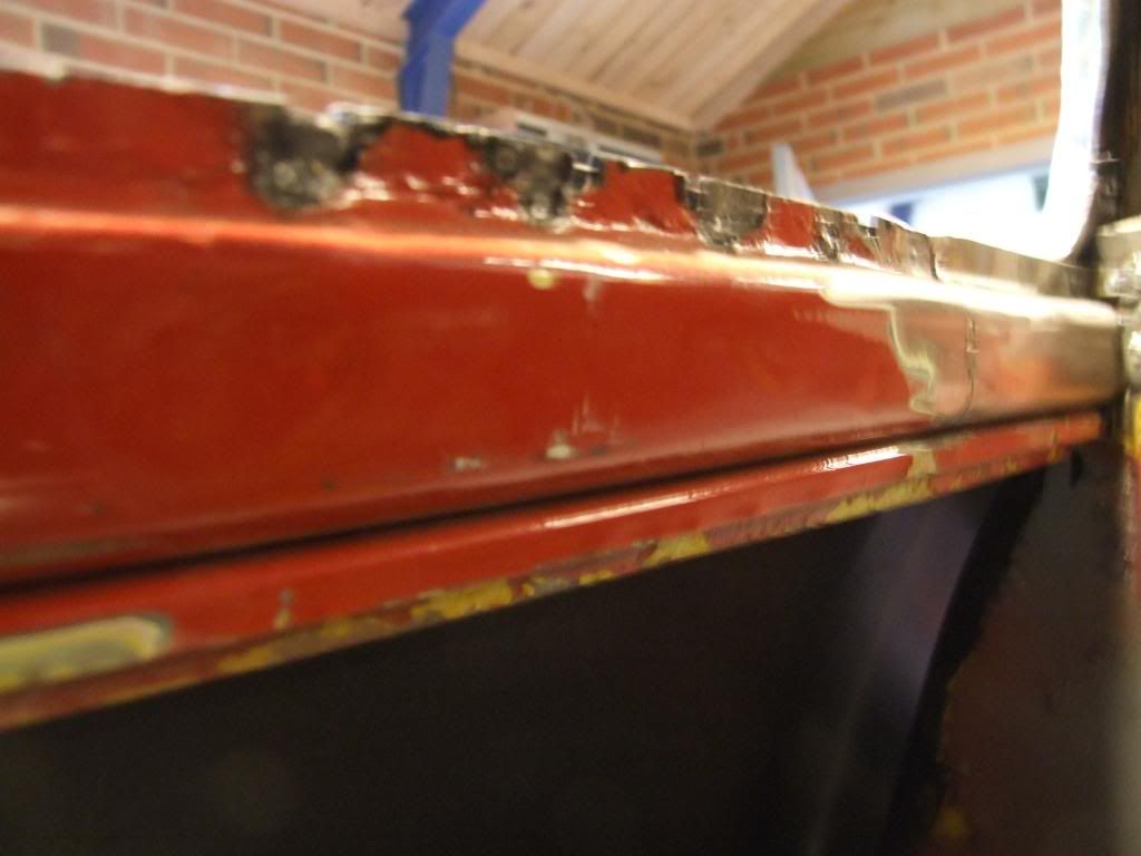

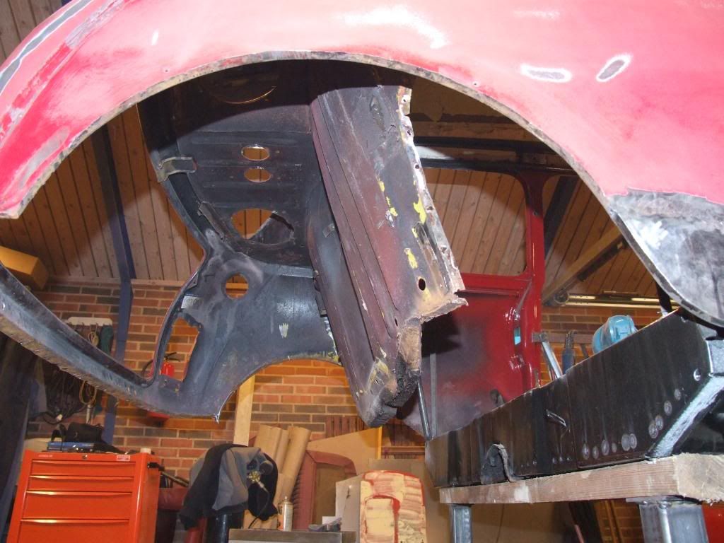

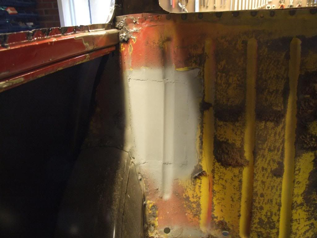

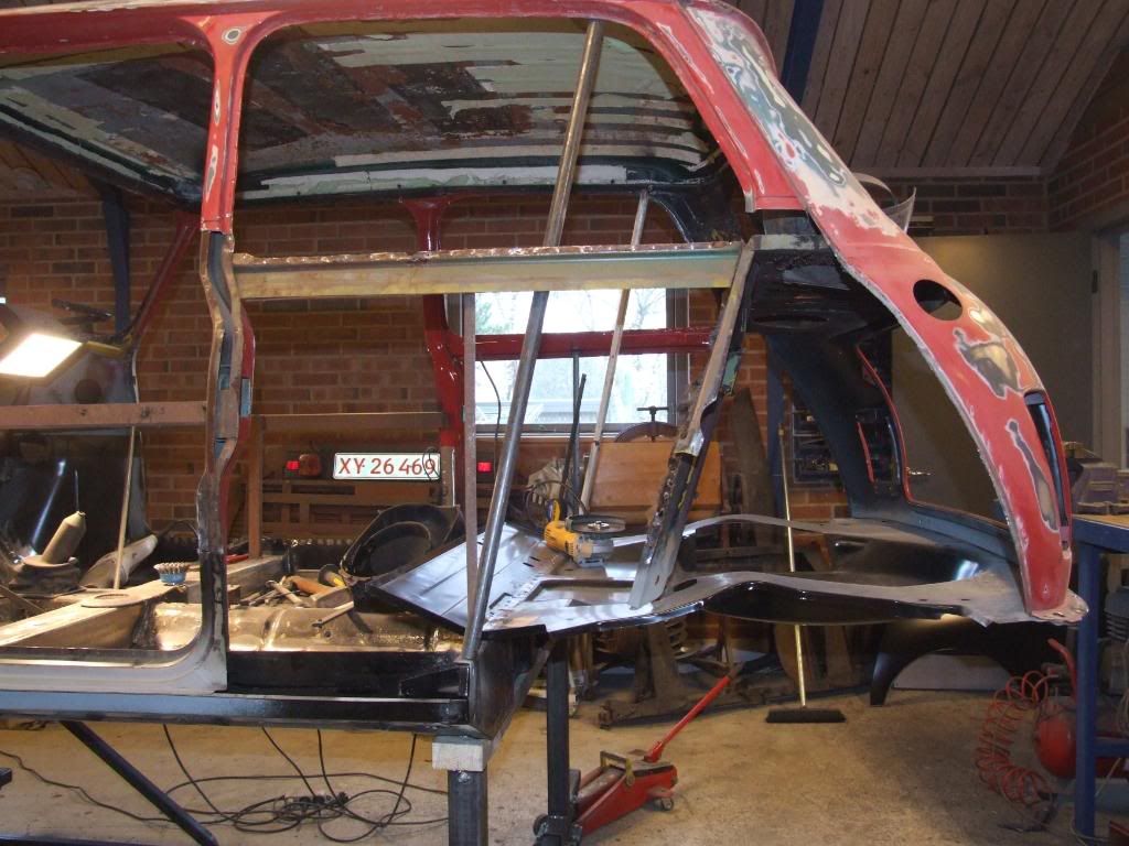

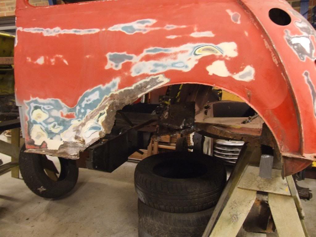

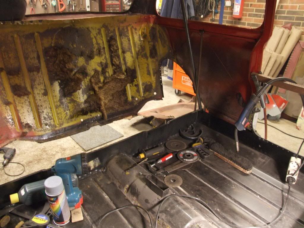

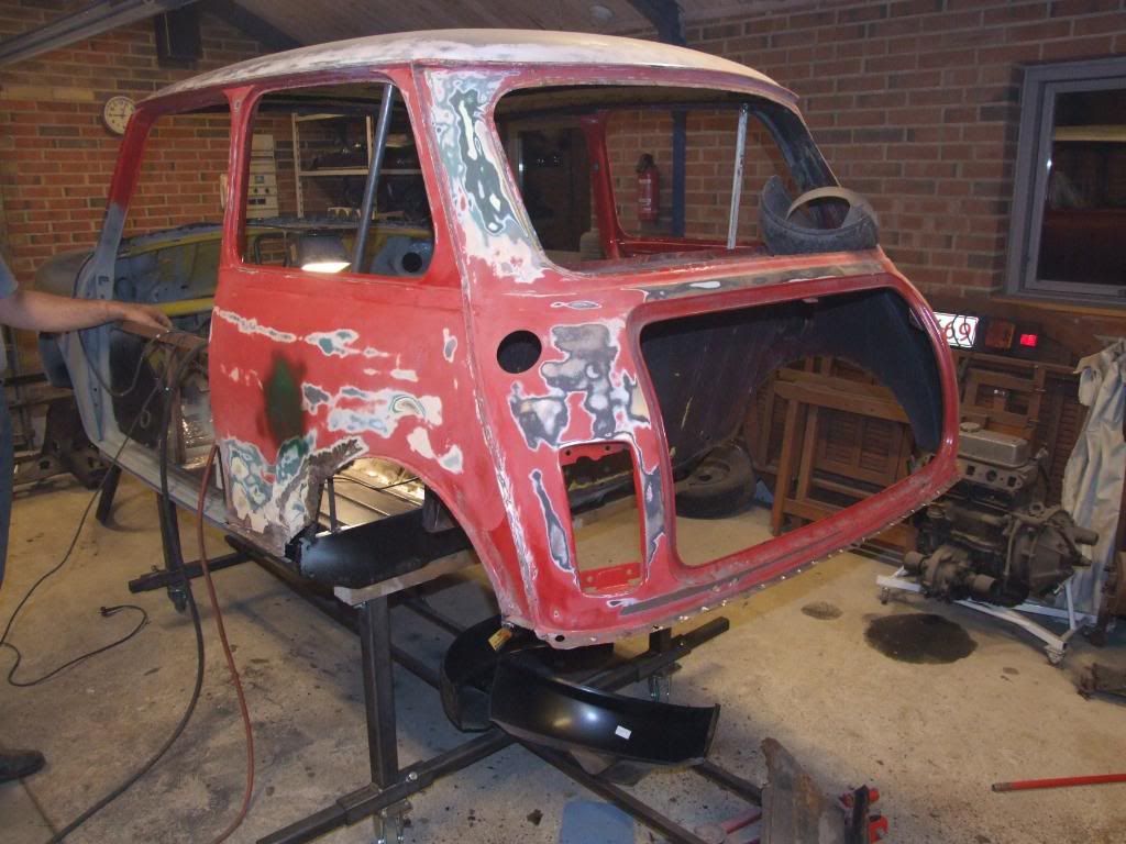

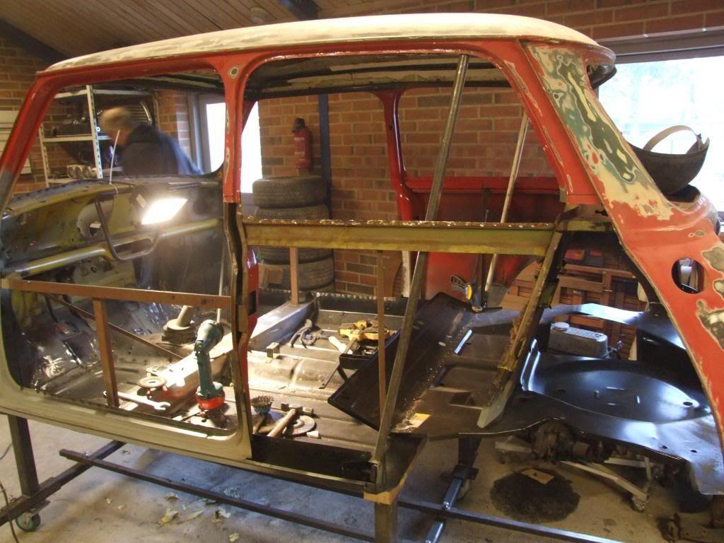

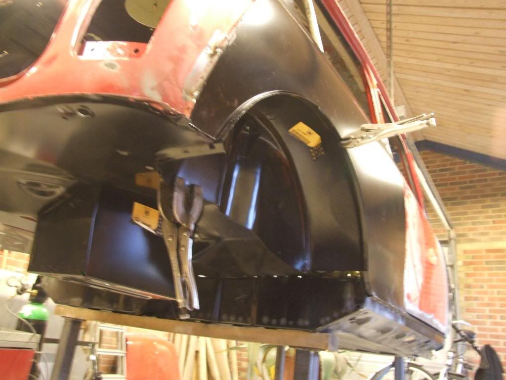

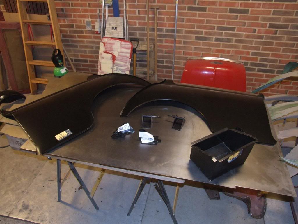

We wasn't really sure of how many of the panels at the back we wanted to replace. We desided to change the lot :P
When so much of the panels allready have been replaced, it would be a shame not to change the rest of the old rusty panels (the roof and the back end were replaced a couple of years ago).
Got more panel parts :P

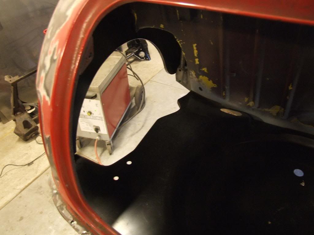

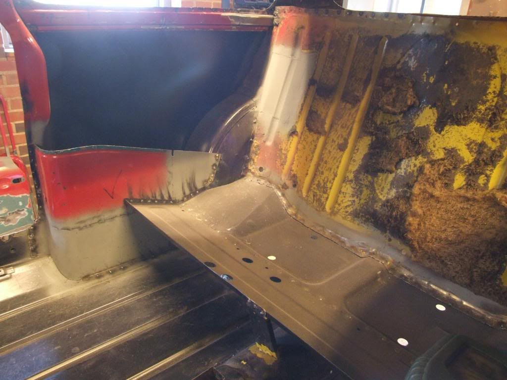

Started on the floor in the boot (and the rear seat bottom).
Removed the old panel
Then we removed the side panels.
Trial fit of the floor.
Trial fit of the side panels.
Trial fit of the rear inner wings.
After the trail fit of the panels, they were all fully welded

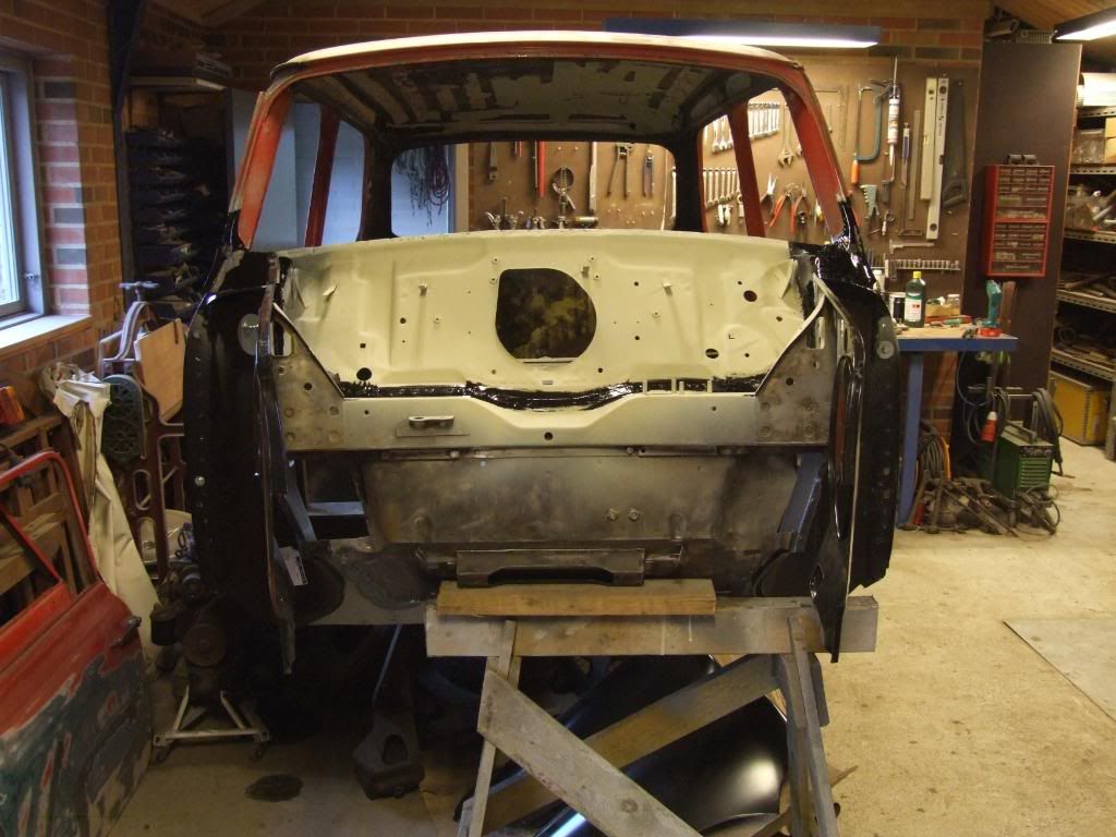

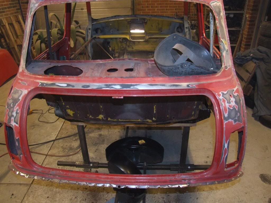

Final chapter to the bodywork rep (I think :( )
Installing the sidebins
Patched an earlier patch in the back seat
Also had to do a bad patch in the "lower-rear window-inner-panel"-thing
Now it's time to make it ready for the painter

Thanks. I've also looked at your project a couple of times. Newer seen a stand like the one you've put on your current one.. but i like it. ;) Certainly must be nicer than lying on your back trying to remove the old paint underneath it, just to get it all in the face :thumbsup:
#30 Guest_ratty_*
Guest_ratty_*
  • Guests
Posted 07 May 2009 - 06:59 AM
The spit does make accessing the underside a whole lot easier and you dont need as much room because the car turns on its own axis
