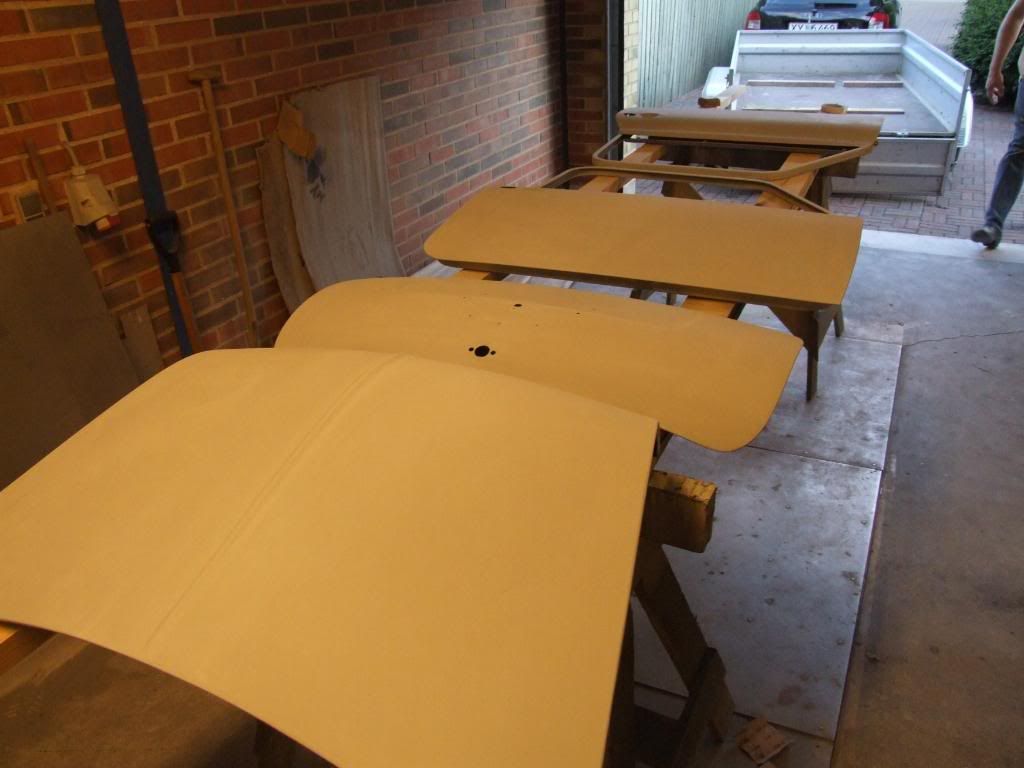

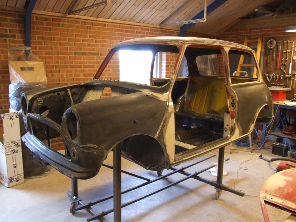

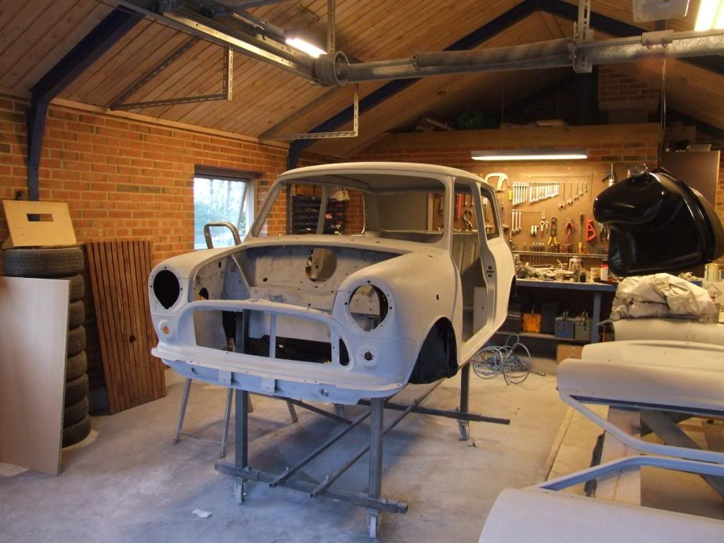

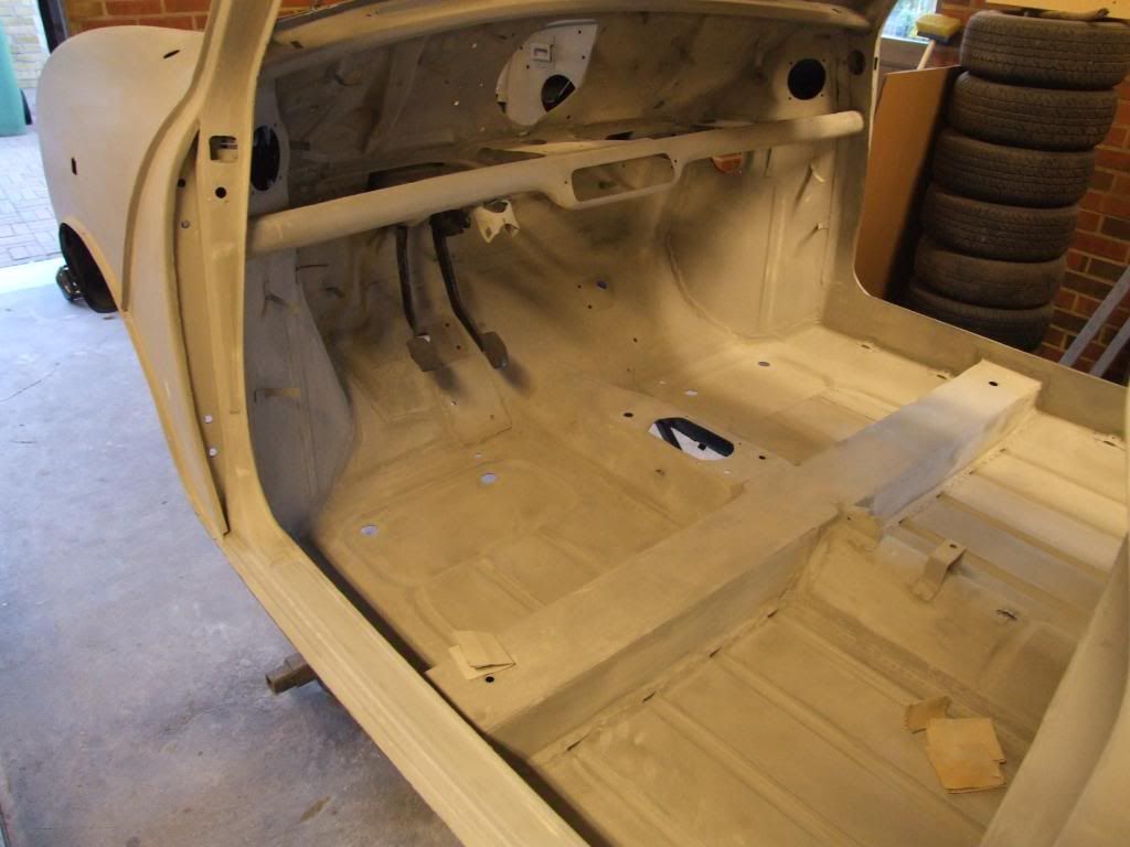

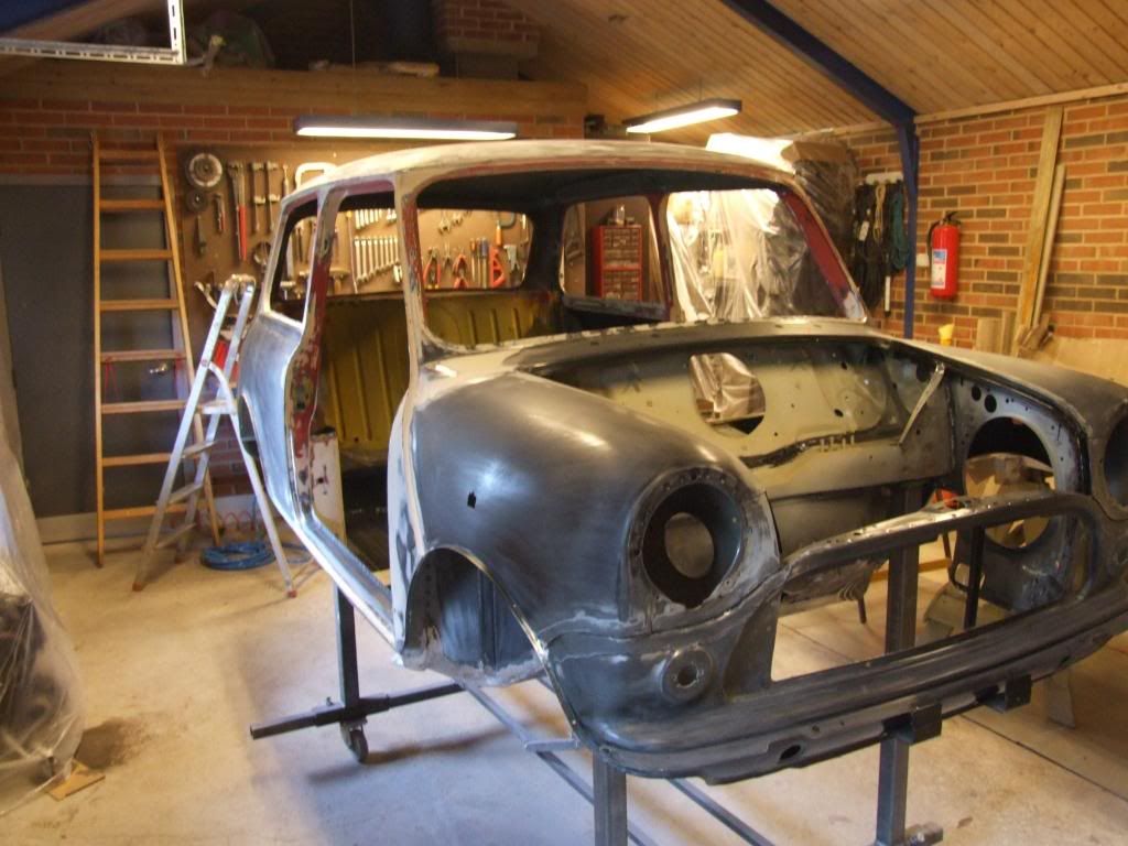

It's been a while since I've posted, but now there is a couple of new chapters :)
Got the filler job done. It took us 4-5 weeks to do the whole car, but then it's also very close to perfect :gimme:
The whole car has been sanded with 4-500 sanding paper, and it's now ready for primer

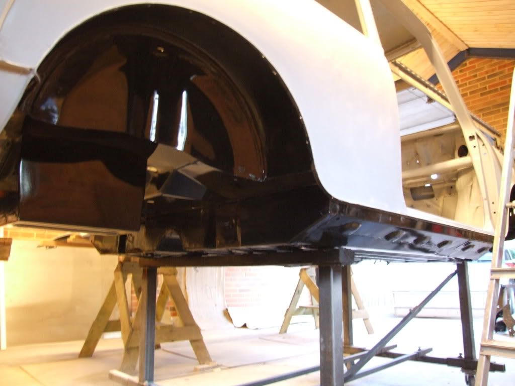

#32 Rasmus Holst
Rasmus Holst
  • 84 posts
Posted 24 June 2009 - 07:34 AM

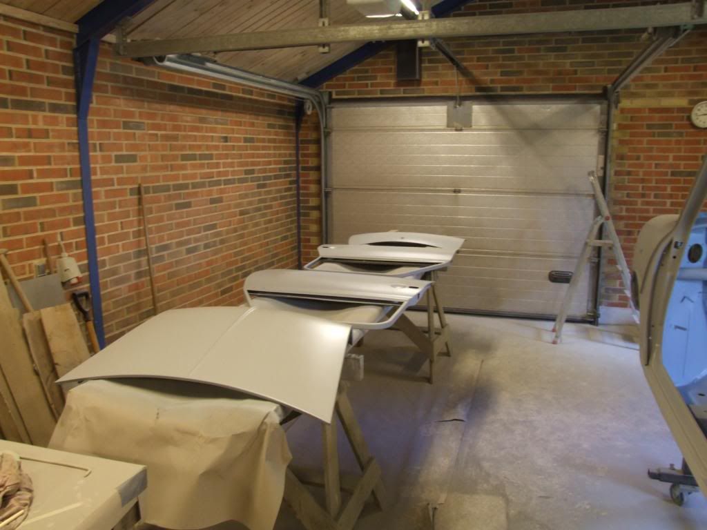

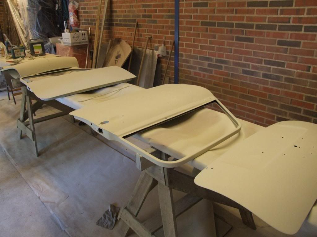

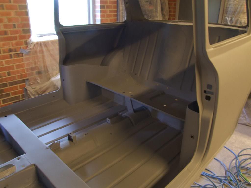

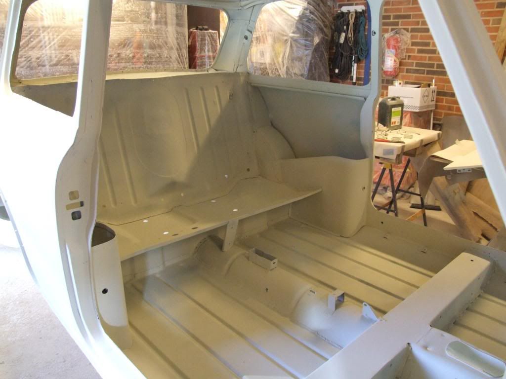

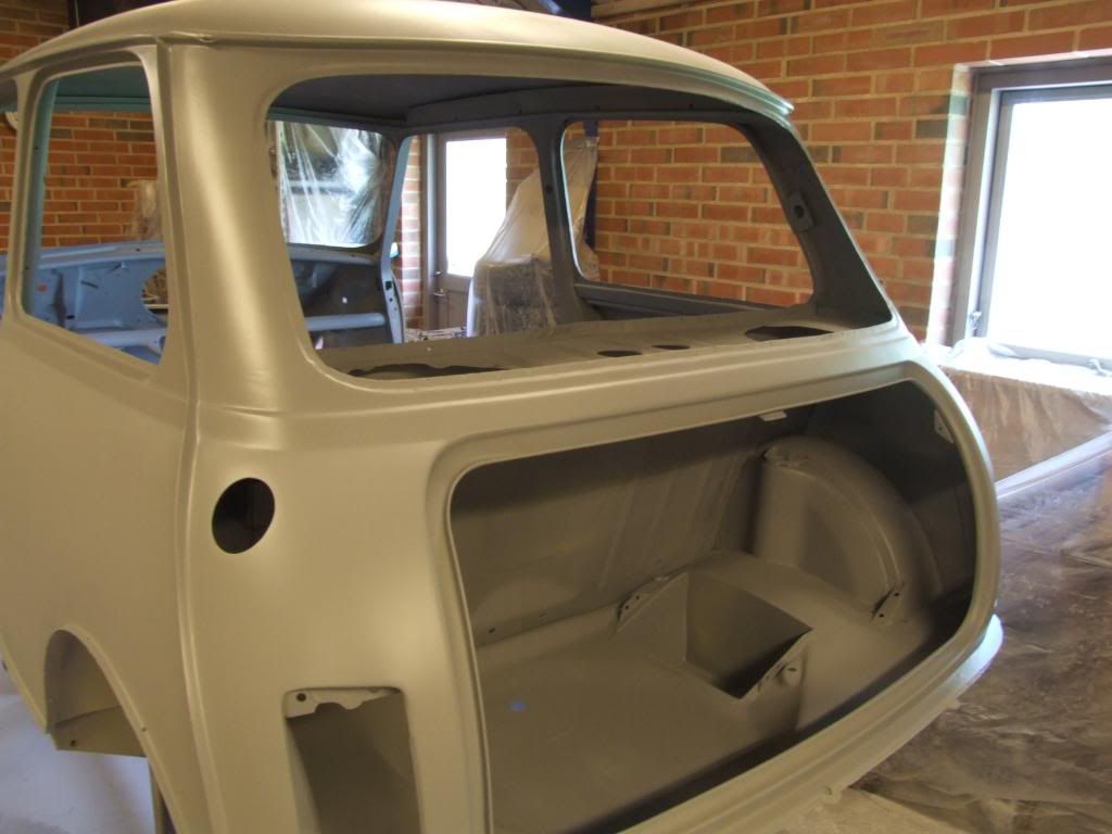

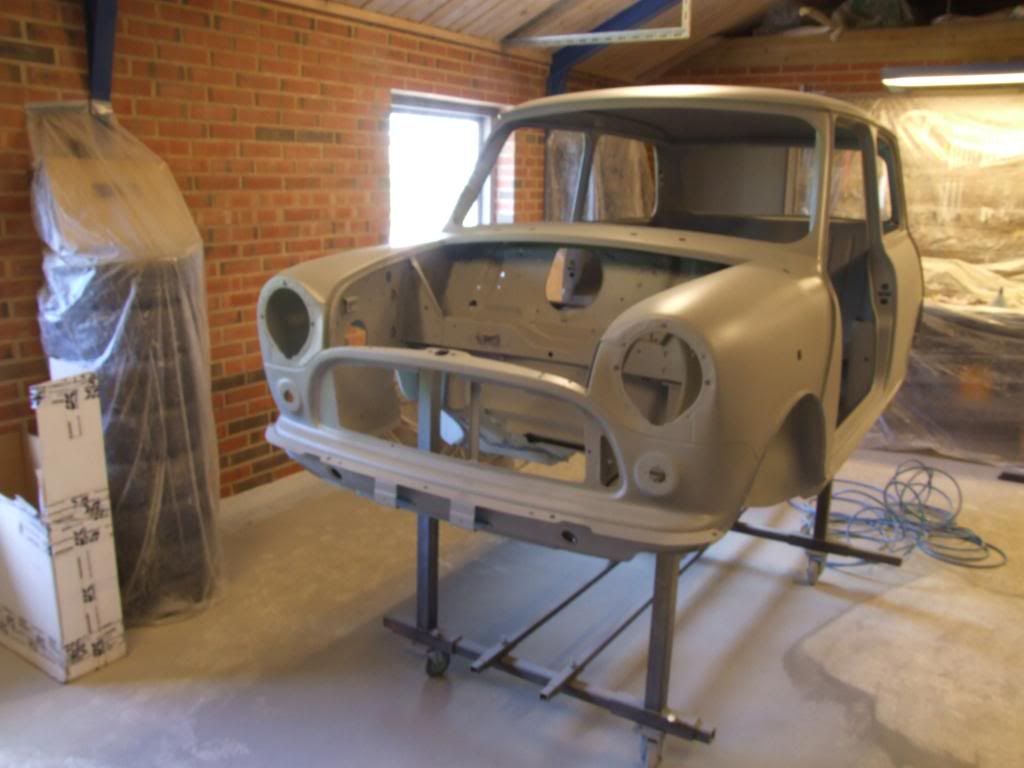

Primer time :gimme:
The garage was covered in plastic, and the car has been cleaned and degreased, then primed:

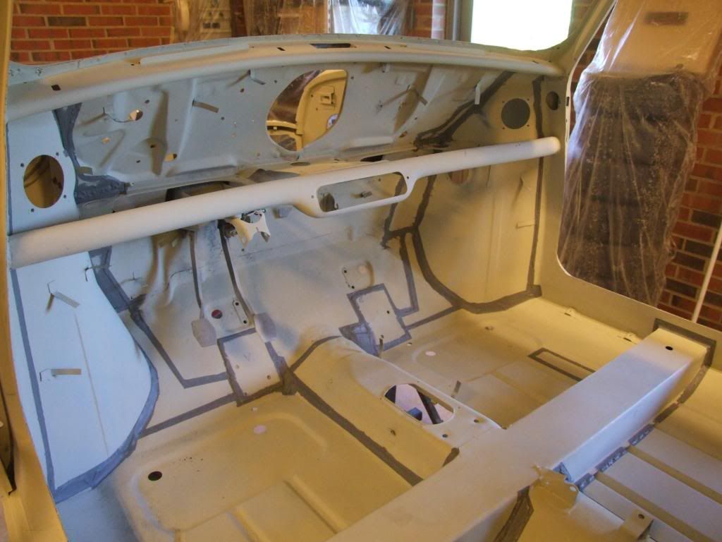

After this, it had to be sealed:
#33 Rasmus Holst
Rasmus Holst
  • 84 posts

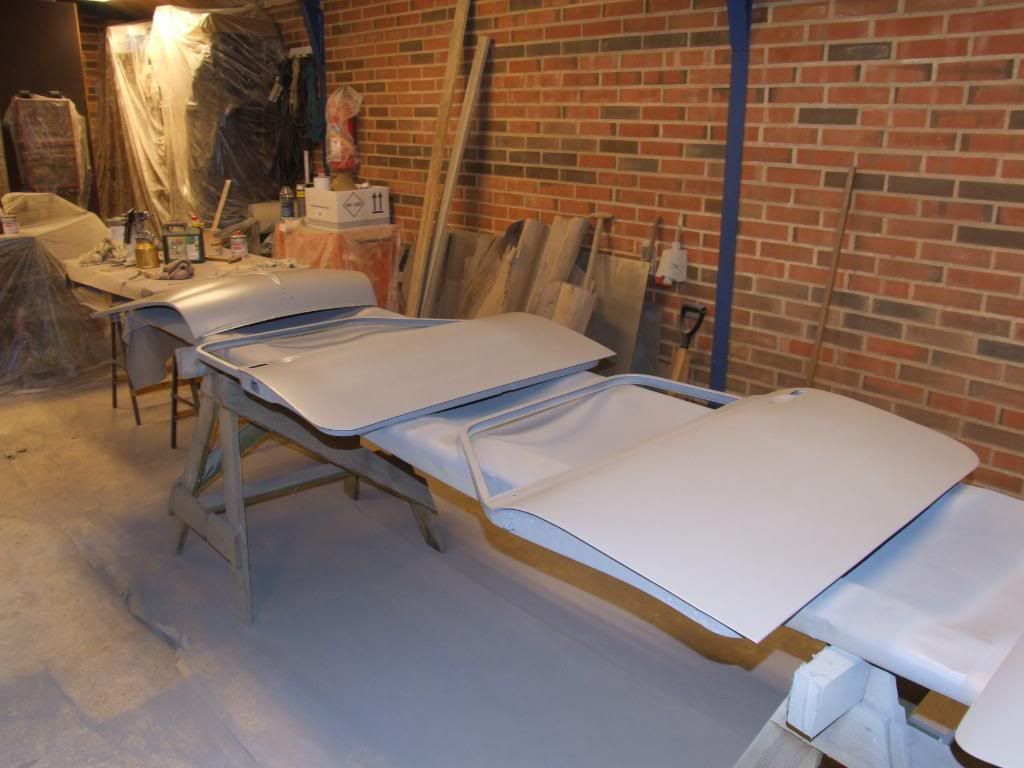

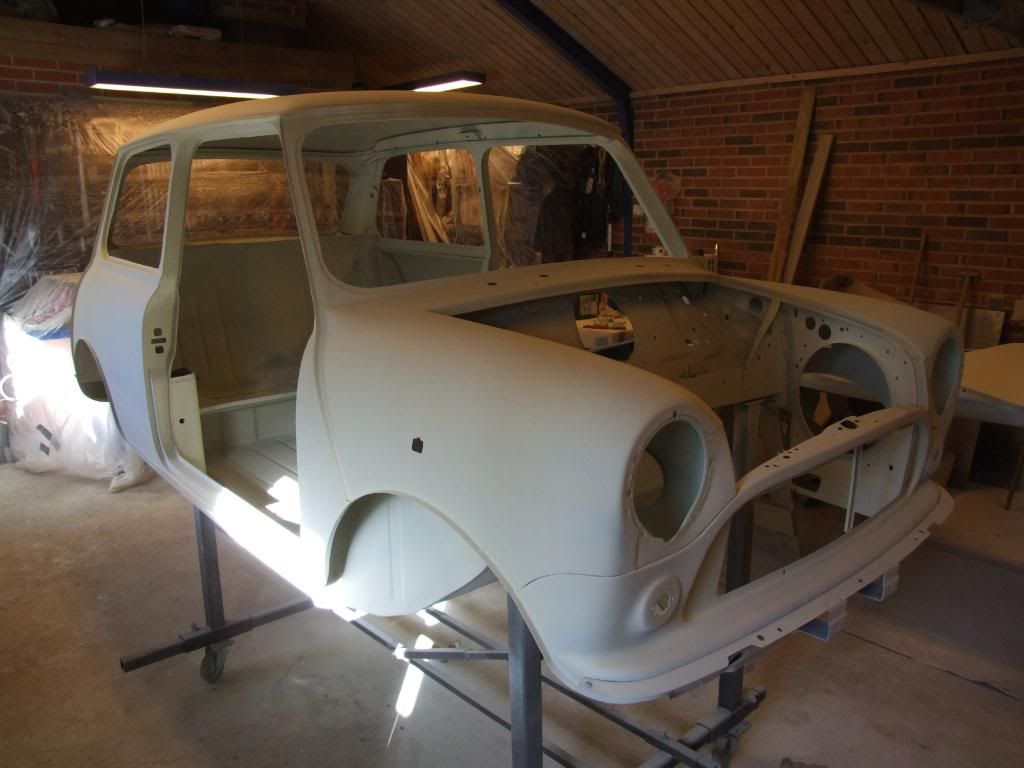

Posted 24 June 2009 - 07:47 AM

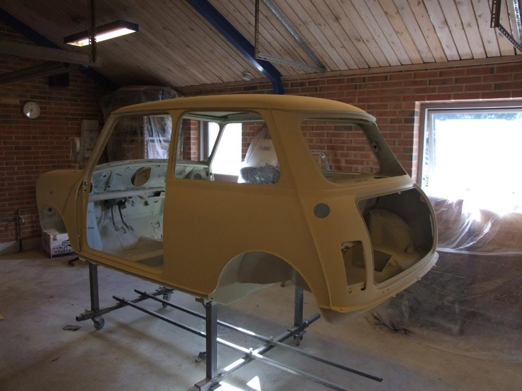

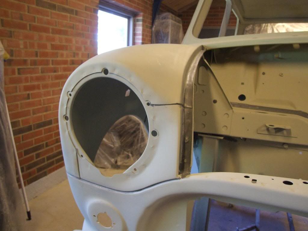

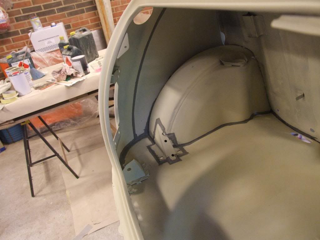

It was degreased again, and then sprayed with sander. Because its going to be BRG, we put some black paint in the white sander to make stonechips less visible.

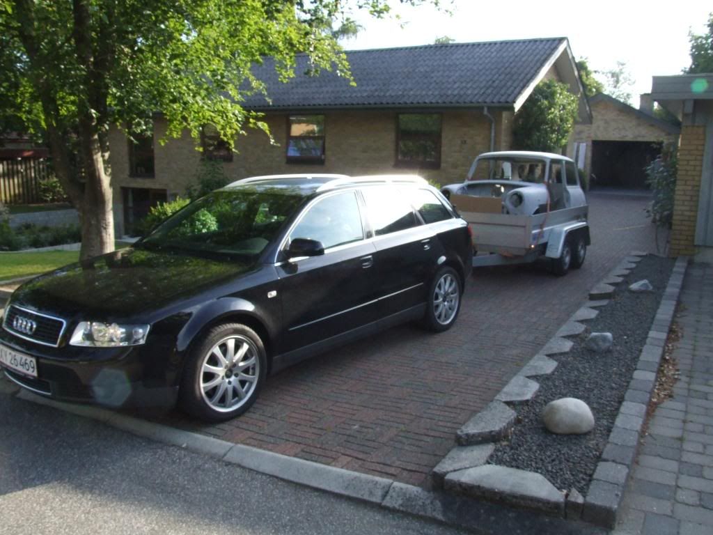

#40 Rasmus Holst
Rasmus Holst
  • 84 posts
Posted 26 June 2009 - 09:40 AM

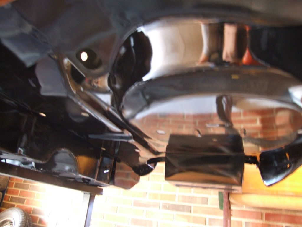

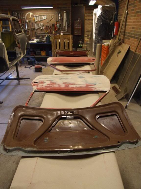

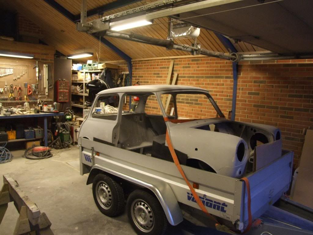

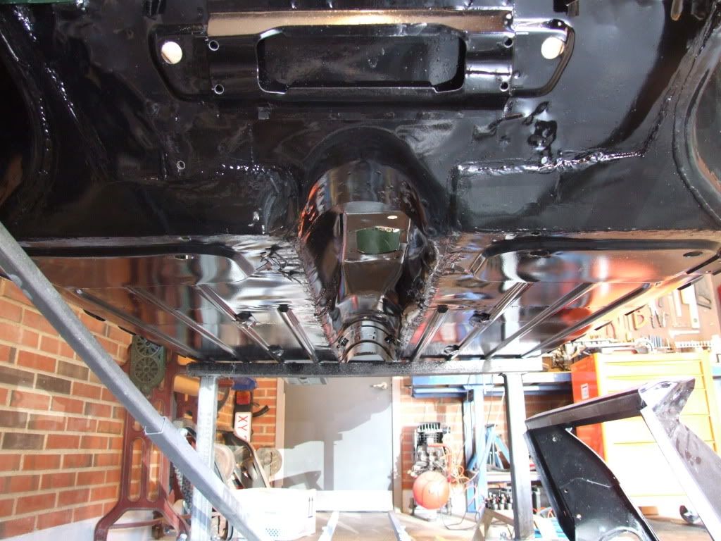

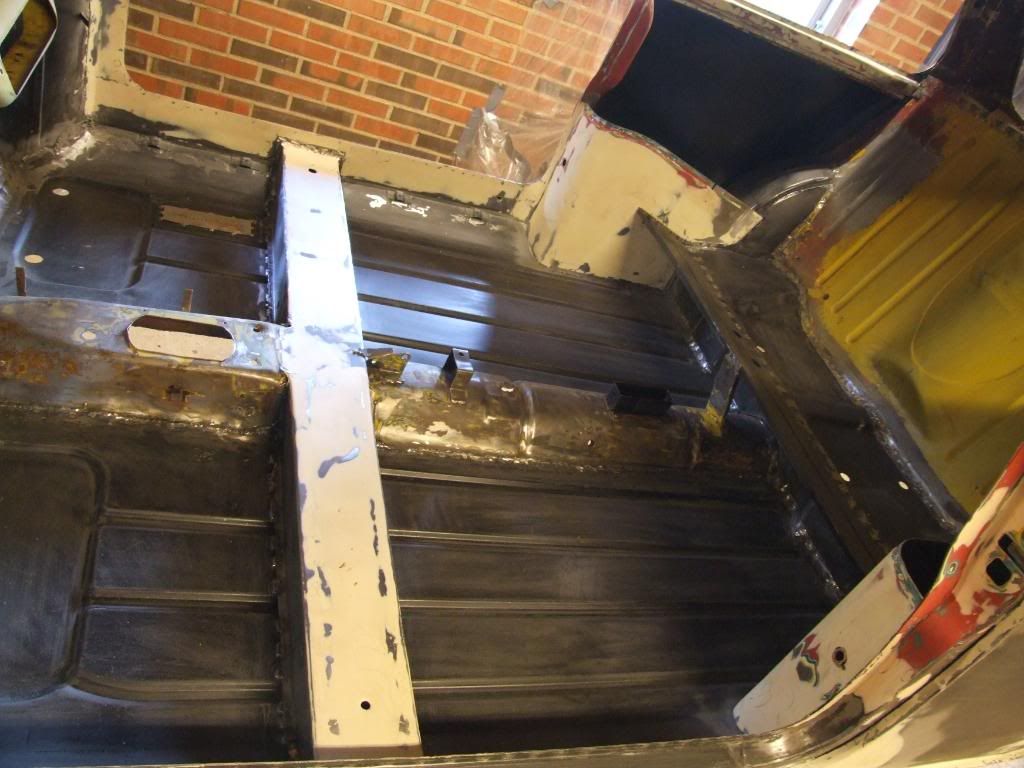

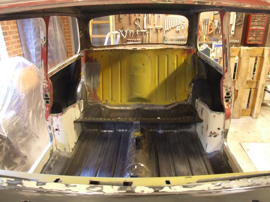

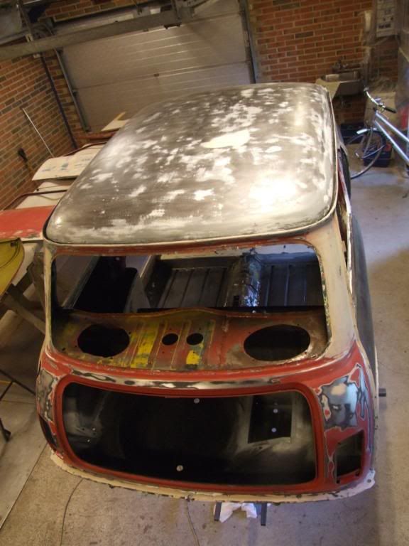

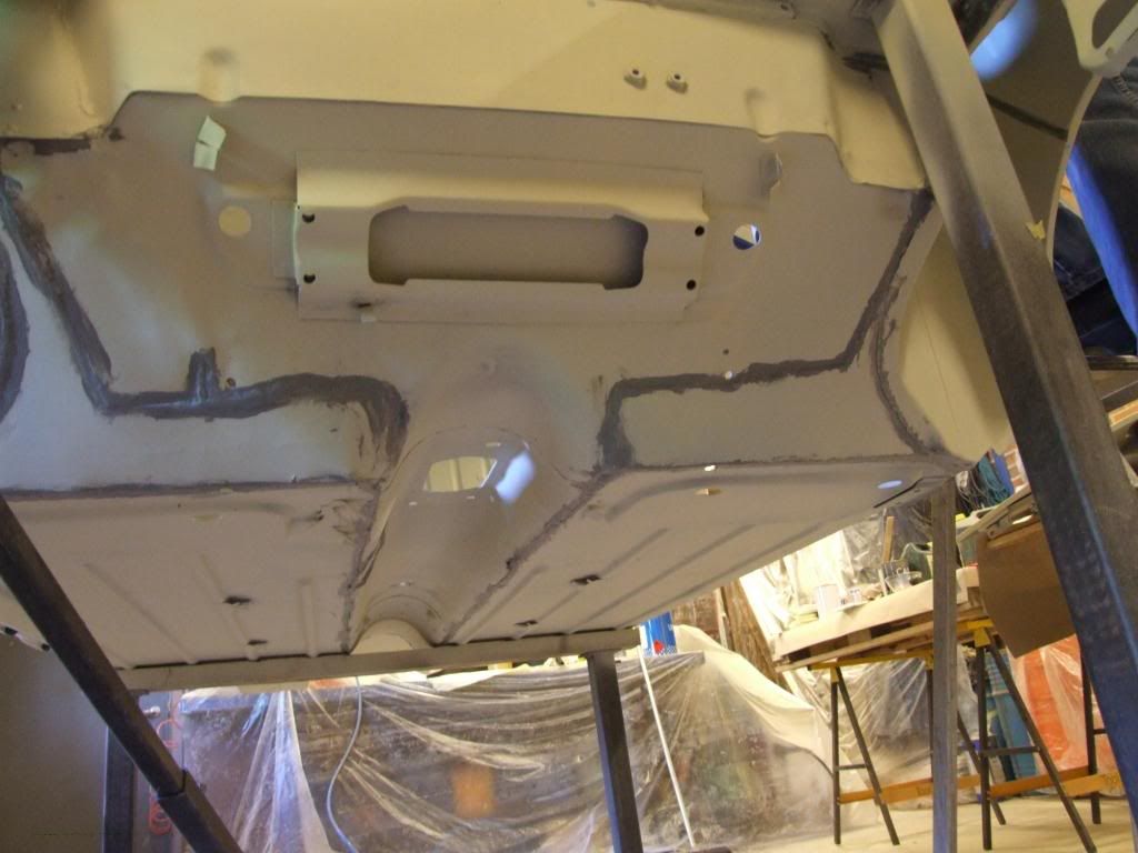

Got some pics of the underside.
Then it was sanded with 4-500 sanding paper. The loaded on a trailer, ready to go to the painter :thumbsup:

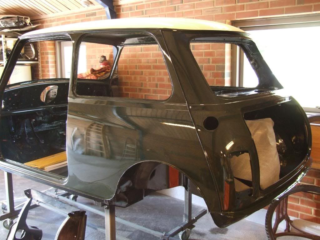

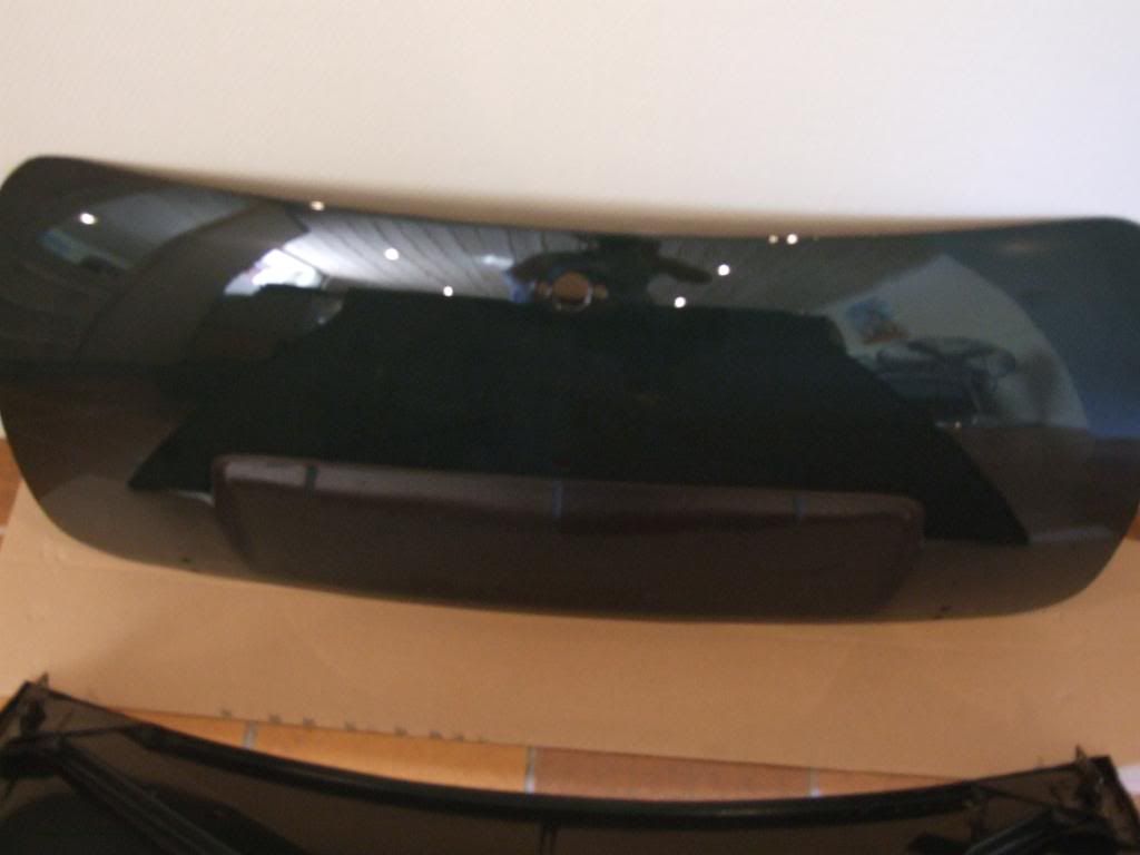

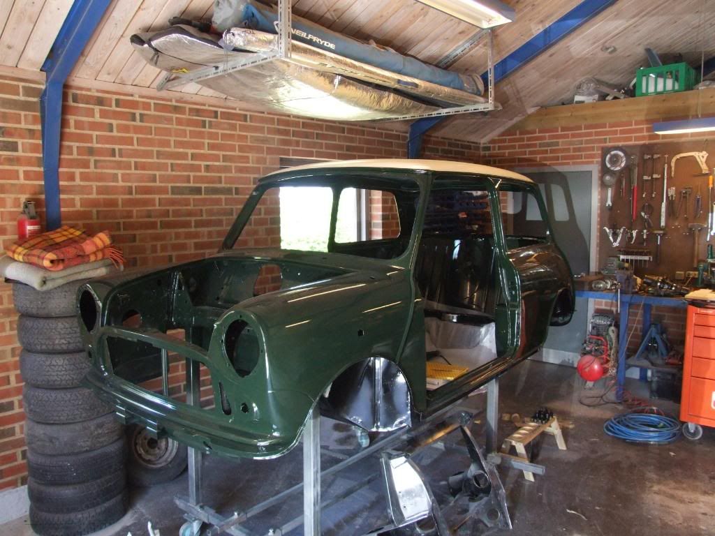

#41 Rasmus Holst
Rasmus Holst
  • 84 posts

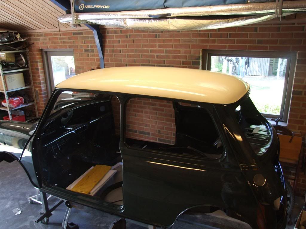

Posted 03 July 2009 - 08:20 AM

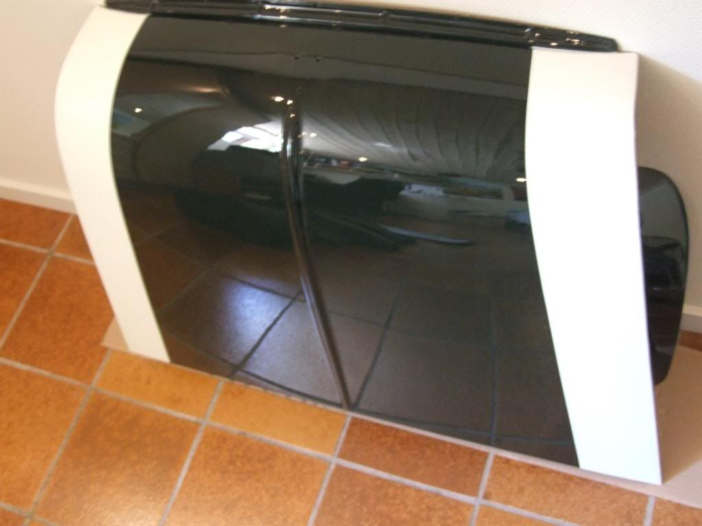

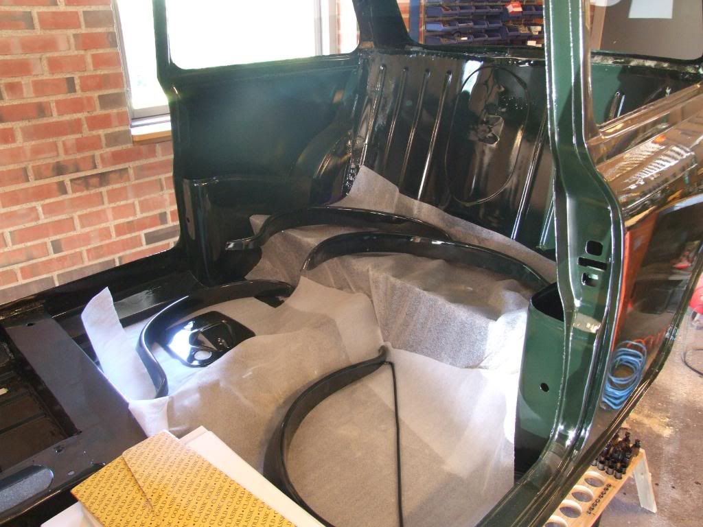

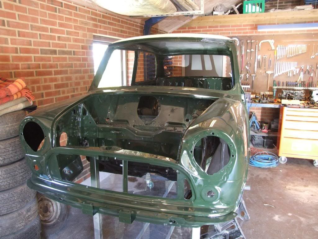

A coulpe of days after returning from Le Mans i got this back :thumbsup:
Theres a few mistakes in the paint, but luckily its all on the inside where it's hidden by the rear seat
What a milestone to pass! Now theres is only the rebuild-part left :w00t:
