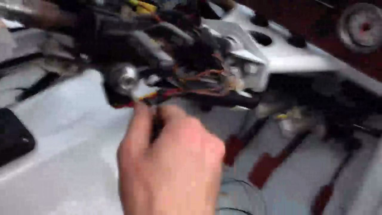

The wiring is done, thanks to maplins for the PC connector that I'm using for a multi plug to aid connection to all my switches and secs monitor.
0A1EBD33-2661-498A-BE27-994F5DF85C59_zps
Fitted:
F1FAB1C4-A214-4C67-B626-9460A936C369_zps
Although I now face more wiring problems, the fuel pumps aren't priming and one no longer works. Swapped it over to the spare one again, using the good seal, only for it to leak petrol.
Need to seal it so if people know any sealant which resists petrol then that would be good as I can only source a gasket from America!
Then I need to sort out this wiring problem... Then in theory it will start.
