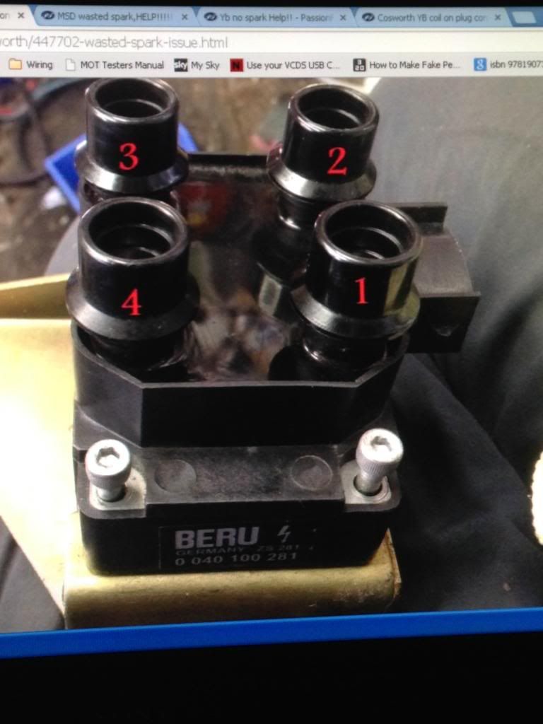

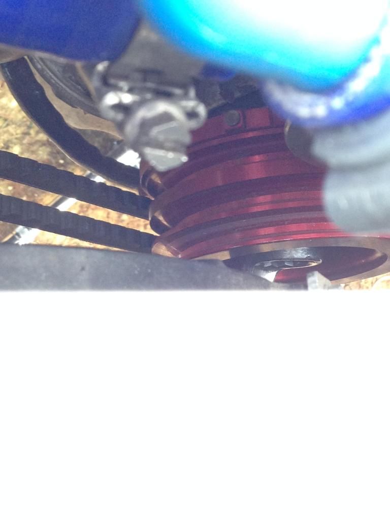

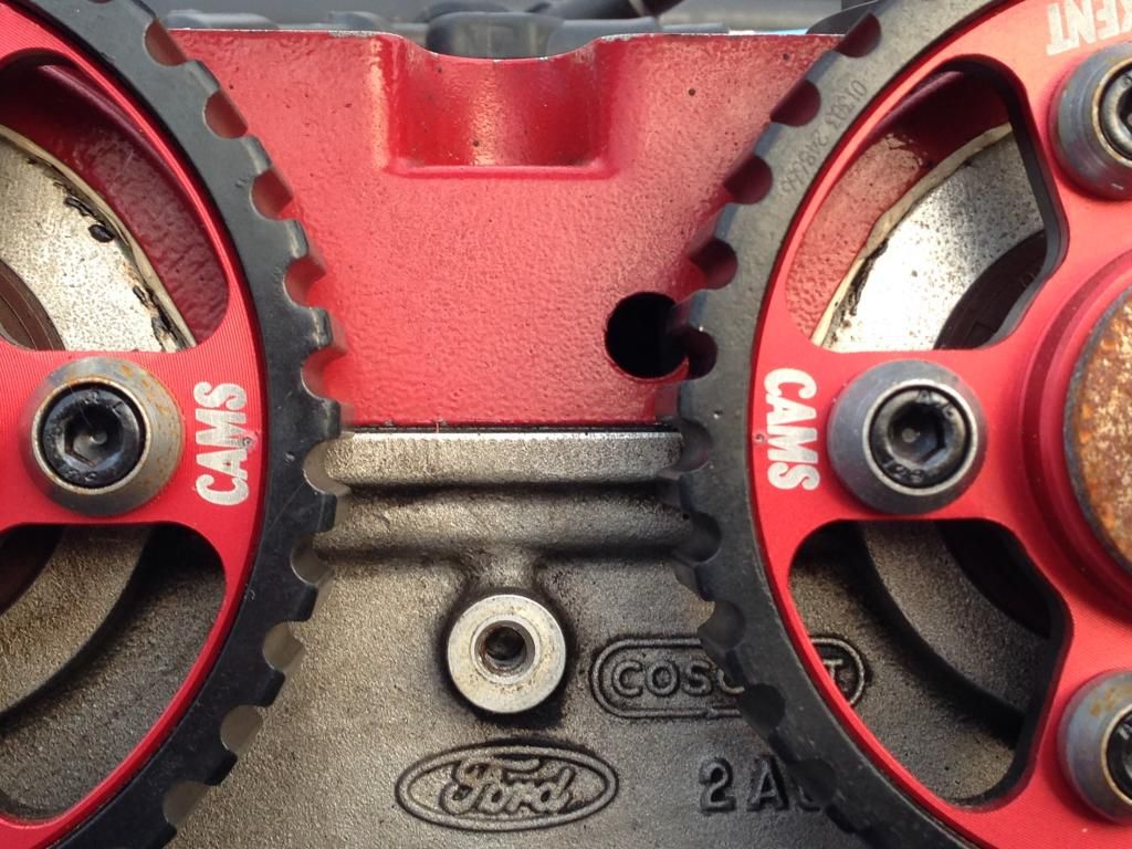

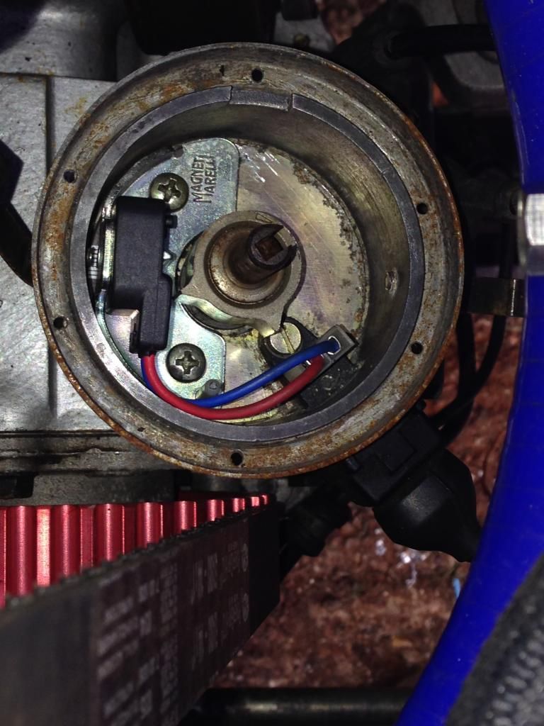

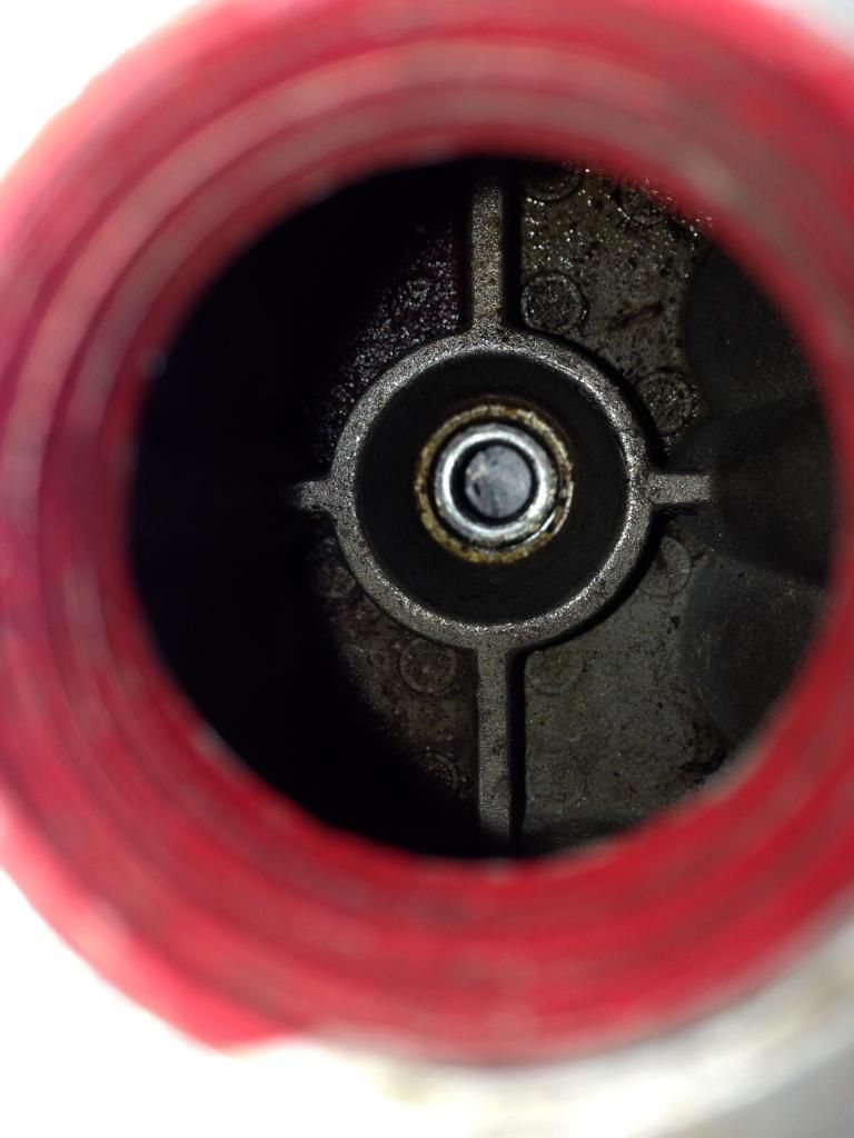

Right so I was reading up on what some of the solutions could be to my problems. I wanted to double check the timing and confirmed that everything was fine
Piston 1 at TDC
Crank marked up with timing mark at TDC
Rota arm pointing to the tiny mark roughly at 2pm on the dizzy casing
Cams facing eachother
So I was reading up on sensors and noticed that my crank positioning sensor was slightly too close to the crank lugs and that the phase sensor in the dizzy was slightly too far away. So I adjusted those and got them to 0.6mm and 0.24mm respectively.
Still it didnt fire but it did start to turn over more freely.
However I was reading up on HT leads and the cosworth fitted with wasted spark and it stated that if it pops and bangs its likely to be the leads 1+4 and 2+3 on the wrong side of the coil pack.
I was also reading up on ignition amplifiers and remembered that I was using a 2nd hand one.
So I thought I would did out the coil pack instructions and sure enough i had connected them the right way round
but because it popping and banging i thought i would swap them the other way around so instead of 1+4 and 2+3, they would be 2+3 and 1+4
Low and behold this is what happens...........
SHES ALIVE
