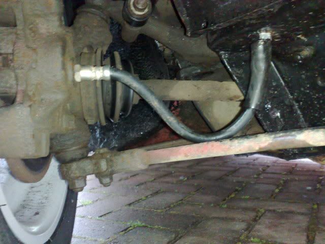

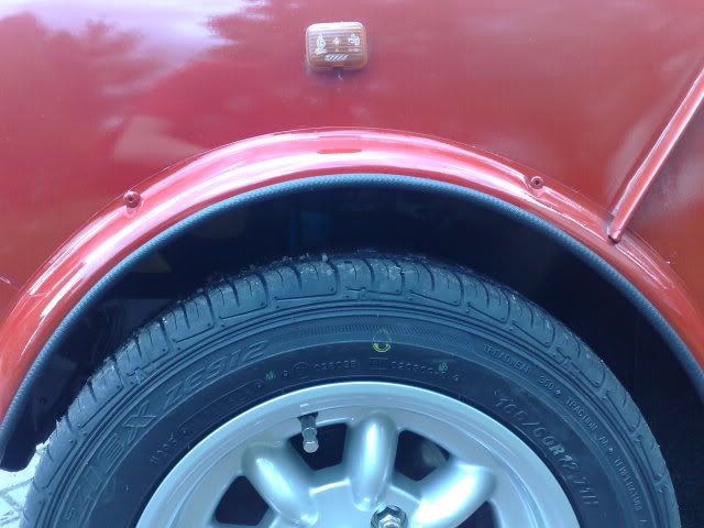

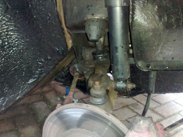

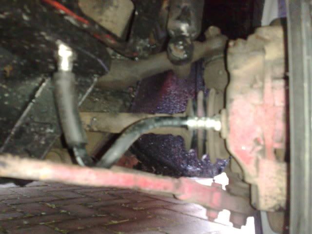

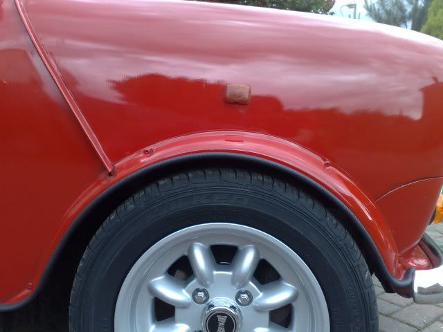

Here are some pictures:
Drivers side
passenger side
no wheel
underneath passenger
underneath drivers
Cheers guys dont know if these are any help.

Looking at your nowheel1.jpg photo, it looks like your knuckle joint rubber is shot.

#13 gonzoavfc
gonzoavfc
  • 271 posts
Posted 10 June 2009 - 09:20 PM
i'd just lifted it up so you could see the joint a bit better, its really bugging me now because i dont have a clue what it could be.
