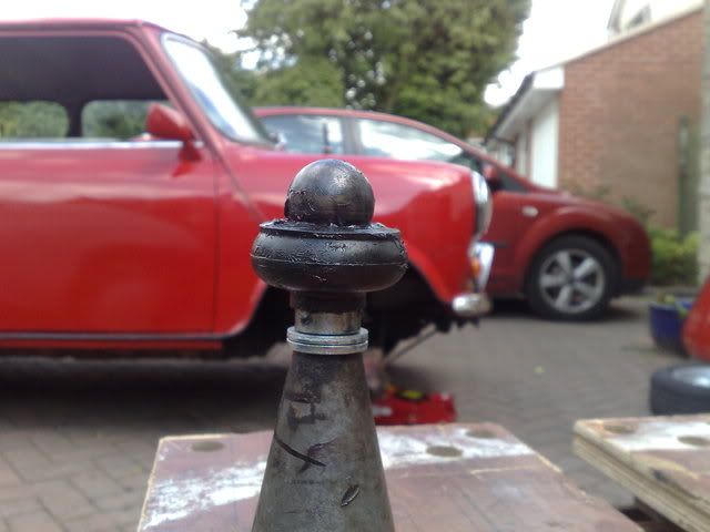

right after speaking to guy at my local car shop, he told me that maybe the new knuckle joint had gone into the trumpet further than before so i took it all out and put two washers on compressed couldnt get it to fit compressed some more BANG compression tool stapped in half, manage to repair the compression tool, tried again with one washer fitted it drove up my road, it dropped right down but not as much as before >_<, might try and get the other one on at a later date, but i need to drive it mroe first to see if its ok.
here it is with two washers

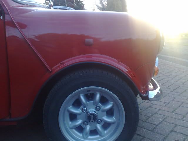

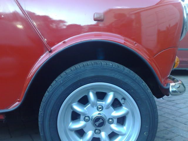

the thing that gets me is once i have jacked the car up and let it down it looks like this:
but once i drive it a little bit it looks like this:
since i added the washer its alot higher than it was.

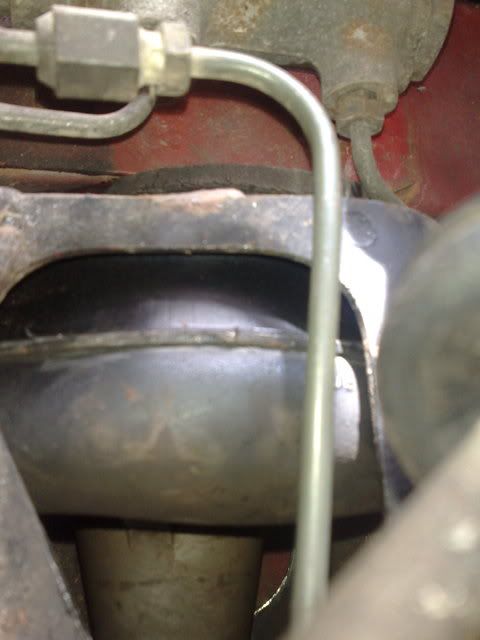

I've been working on my Mini this weekend replacing the brake limiter valve under the servo, and what I realised is that you can see the cone pretty good in the top of the tower with the water bottle removed.
So could you maybe take two photos of the cone through the engine bay when you first lower the car, and then after driving it? It might show you if the cone is collapsing.
Here's mine:

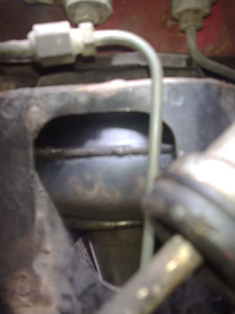

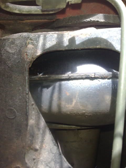

right after taking pics it loks like my cone has something up with it, although it does look slightly out of posistion but i have had the trumpet out loads of times and the other side is fine so i can get it into posistion ok so unless its the cone not letting it sit in place but here are the pics
Jacked up
Just let down
Driven round for about 30 mins

That trumpet+cone doesn't look right. I'm not sure if it's your cone that isn't seated right and is therefore angled wrong against the trimpet, or if it's just caving in completely.
I've just nipped out to my Mini and took a closer photo of mine, forgive the slightly out of focus image, but it looks like my trumpet is sat straight on into the cone.
What you want is to be able to draw a virtual line from the top of the subframe tower, through your cone, down through the middle of your trumpet into your knuckle joint. Your's looks like the cone and trumpet angle is offset somehow.
