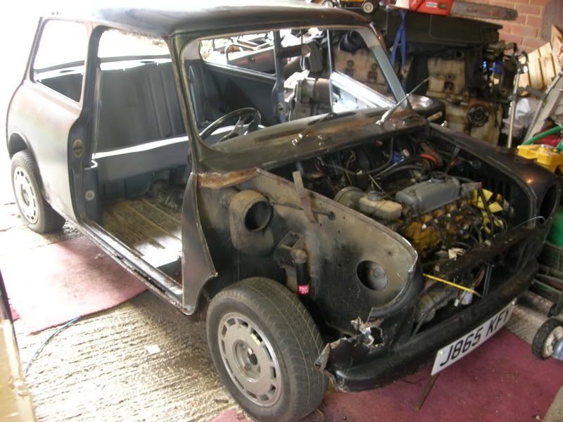

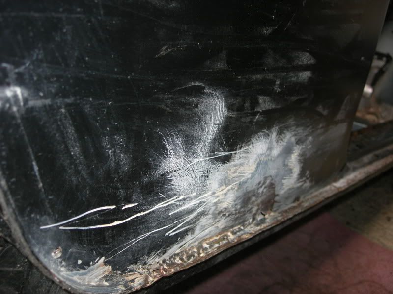

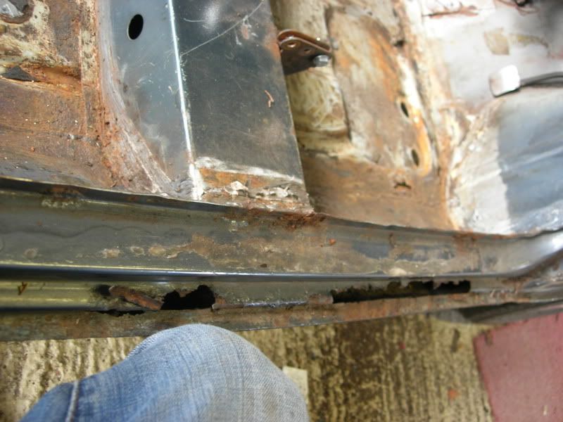

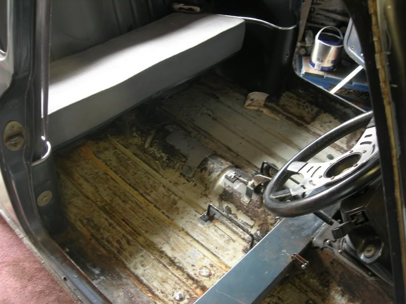

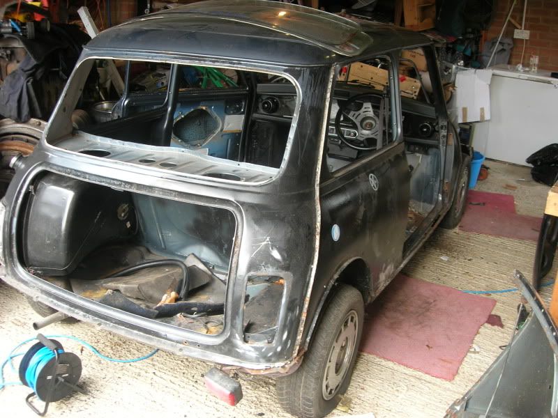

well guys havent updated for a while ive fully stripped it back and ive rubbed back and primed the radiator and rocker cover aswell as removing the underseal of the floors ive found aload more hole thought so the welding bill is on the rise heres some pics my dad also cut the wing of
a few problem areas
what do you reckon thanks ross

This wee car really deserves some serious attention - it is obviously intended to fit a whole new front end, judging by the way the wing has been taken off, so it is logical to do everything else needed as it's going to have to be resprayed. Those scuttle corners need replacing, which means the closing panels beneath as well. Also, inevitably it will need attention where the fresh air vents enter through the flitch panel. The door steps are another obvious replacement and this undoubtedly will involve the inner & outer sills. The rear valence is a foregone conclusion as will be the splash panels associated with them. Floors can be repaired by welding as usual. All in all a bit of a job if it is do be done to last. On the other hand the car could be 'patched' to a standard that would pass it's next MOT with a lot less immediate work but it would NOT last, and the respray will have been wasted. The choice is yours. It ultimately depends on how long you wish to keep the car/how much you want to spend/how much you can do yourself/how long you are prepared to wait before getting the car back on the road.......
I'll be interested to hear what others have to say and what you decide to do. Keep the posts coming!

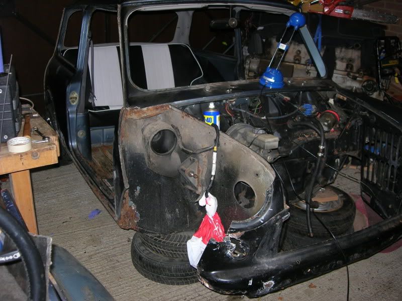

well an update the engine is finally out with the subframe the shell and engine have parted so now i need to get a few bits of the shell and the shell will be picked up by the welders by the end of the week hopefully thanks ross

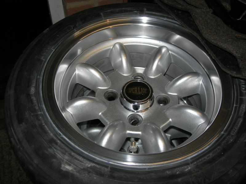

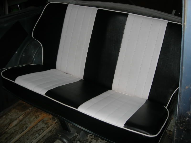

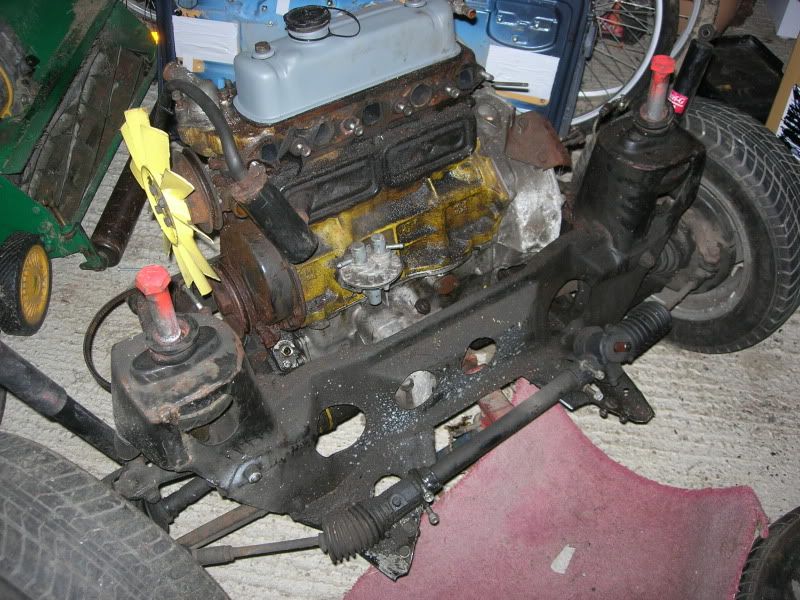

well guys update here is a pic of the engine and car seperated decided to replace both wings now also reconered my rear seats and sat them in there to see what they look like then there be back safe in my room what do you reckon you can see the old grey interior in the pics above also carried on refurbing my wheels
what do you reckon the new panels are arriving tommorow
