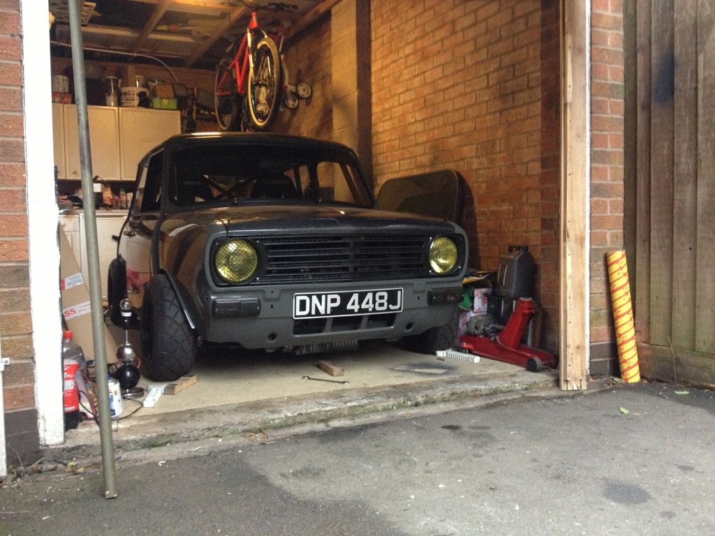

Is this legal then... Always been a bit of a debate
Putting the film over lights as far as I'm aware is Illegal, however the Lucas Light covers are genuine items with the beam pattern attached so I don't think they are illegal.

Gah.. I was thinking more for the low'n'slow
You'll get away with as long as you dont aggravate the police, you can always just pull it off..

Lucas ones deflect the beam the opposite way for uk roads, i run mine when I feel like it in the summer, but they're pretty rubbish at nighttime though!
Saying that I've got a set for the Midas too, only held on by clips to can be fitted in minutes. :)

I've wrapped all my minis lights in transparent vinyl, never had a problem with the law or at MOTs.. You could peel it off on the roadside if you ever did have problems, but it's not illegal as its yellow so I don't see why you would ever have to.

Yellow is legal mot wise providing the sidelight is incorporated in the headlight. Ie roundnose are ok but clubbys unless got wrong headlights in are mot fail

From a police officer 'Headlight/sidelight bulbs are allowed too be white or Yellow/Amber) I have yellow headlights and yellow side lights in the red mini I am Buliding and got my friend who is a police officer to check. The beam patten is the main thing to be carful of. If you paint the lights it may ruin the beam pattern which would then make them illigal. Using tinting film should be ok. Yellow bulbs would be best though.

Just use yellow bulbs, I did and it passed MOT :)

I used lamin-x yellow tint, no mot problems and not been pulled over by the man for them yet
