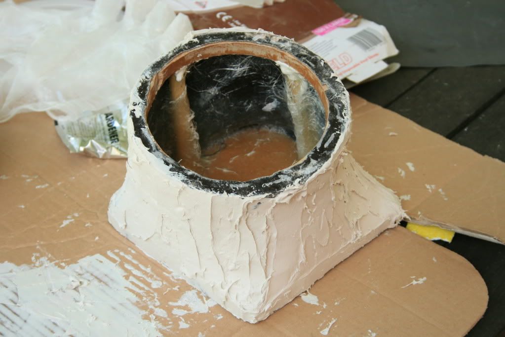

Make some baffles from MDF, space these from the door card or whatever, even a shape of MDF. then staple the t shirt into place and slap some resin into it.
Wait for this to dry, slap some fiberglass inside. to reinforce it all. let it all dry or cure as its called, then add filler to the outside. then its smoothing it down and finishing from there on really.
Wrote this in a hurry! iv`e got some piccys of a set of pods i made (My first ever go with fiberglass)

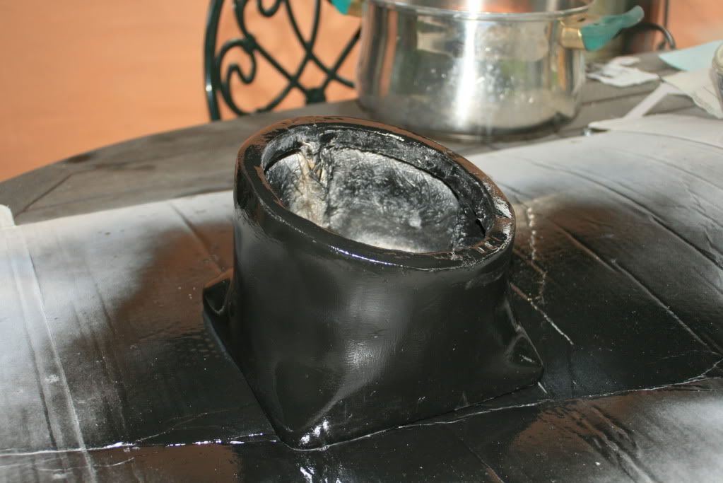

Now for a bit of poor paint work!

Why bother?
by the way, made up the mold part of the sub box, will have piccys up over the week end of the process and perhaps finished but not final finish if you get me?

A little tip brams, use a plastic tape as opposed to masking tape being the normal
It releases better, and actually sticks!
by the way, should have the core of the work done on this fiberglass sub box.
using fiberglass is weird, gives you a high, then you mellow out, then comes the worst hang over ever!

#14 Sam Walters
Sam Walters
  • 2,765 posts
Posted 18 October 2009 - 07:03 PM
well its not quite insulating tape, but that sort of stuff yeh.
I like to use a dark colour, but work don`t stock 4 inch wide tape in dark colours LOL!
The reason for this is its easier to see how your wetting out >_<
Shall i pop up some piccys or where you should be looking to go next now you have your "mold" ?
Dont worry it will come off. the masking take adhesive will give.
