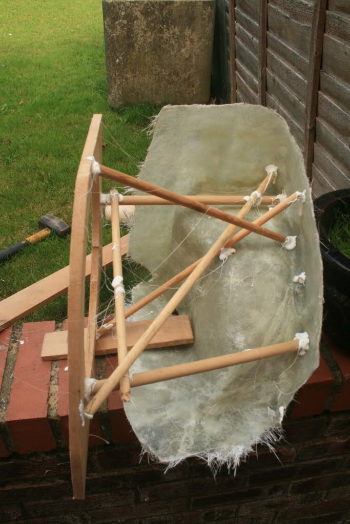

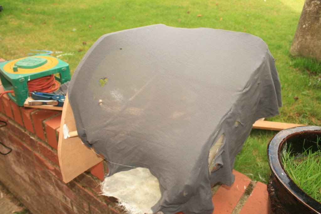

Also
Some bracing!
Some t shirt abuse
It does "fit" but is some what of a faf to get it in and out!
