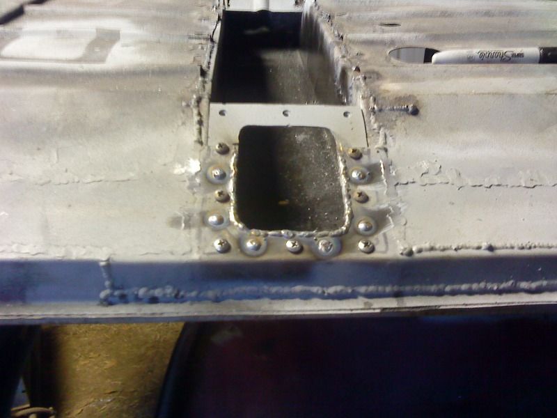

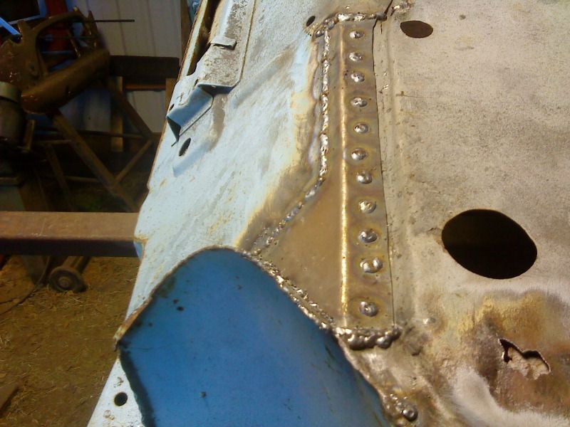

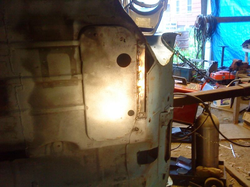

I cut some thicker sheet to double up the end of the sill so I could attach a lid and be able to maintain the seat crossmember over time.
And cut a section of the cooper floor scrap I had to fill in the the floor on that side, the tunnel is being left for later.
Following that I repaired the front edge of the rh floor and toeboard.
My work plans on this shell may be going to be rethought as this morning the person I was repairing it for decided he wanted to just sell the wagon outright to me instead of trading for the shells.
Whith this I am seriously thinking I am going to have m-machine make me up a set of full length floor/sill repairs and jacking points and make the removeable section in the middle at the tunnel instead.. It's different modifying from original for someone as opposed to trying to sell it.

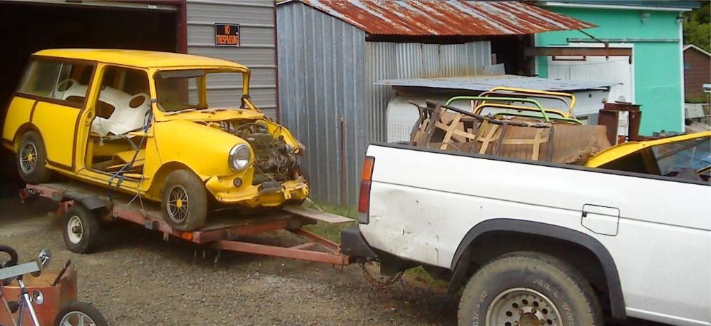

I drug the 1961 woody home today, I thought you would enjoy photos from its good side.
I started stripping the interior when I got it to my friend's shop, It will sit outside so I need to remove any thing that water might damage.
The under side seems to be in good shape however.. so we will see. I need to strip it down so it is easier to move first. I do know that I won't be working on it's body untill some other bodies are finished.

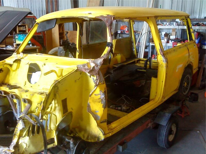

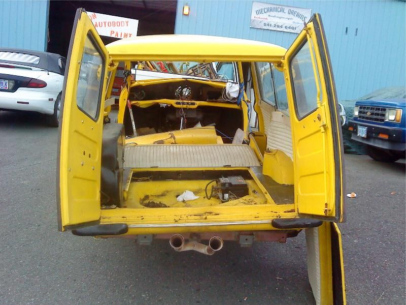

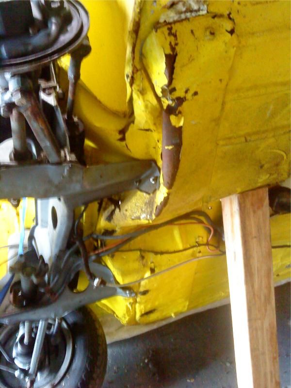

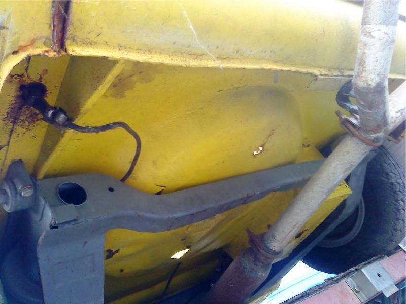

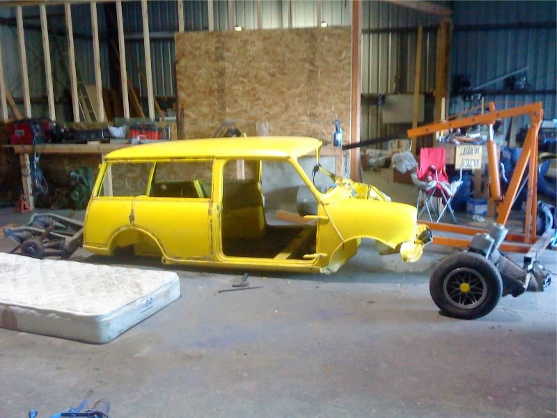

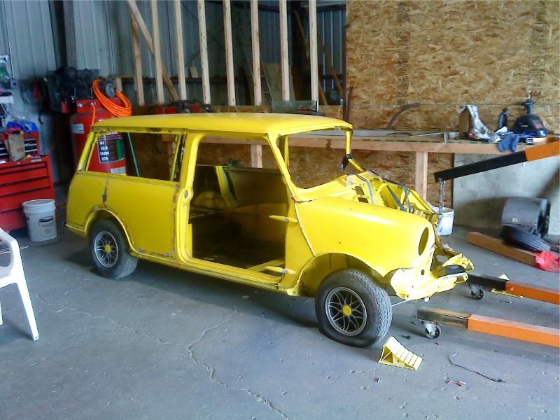

Hey all, I have spent the past couple of days stripping the wagon to assess it's condition. Prior to collecting it I had made certain plans as I didn't know how the wagon was constructed. I had assumed it was built with external sills like later LWB minis, however it is very much like a LWB version of my 60 saloon shell.
While the wagon was on the trailer I removed the engine interior and exterior bit, but none of the underside bits were removed until It was pulled from the trailer.

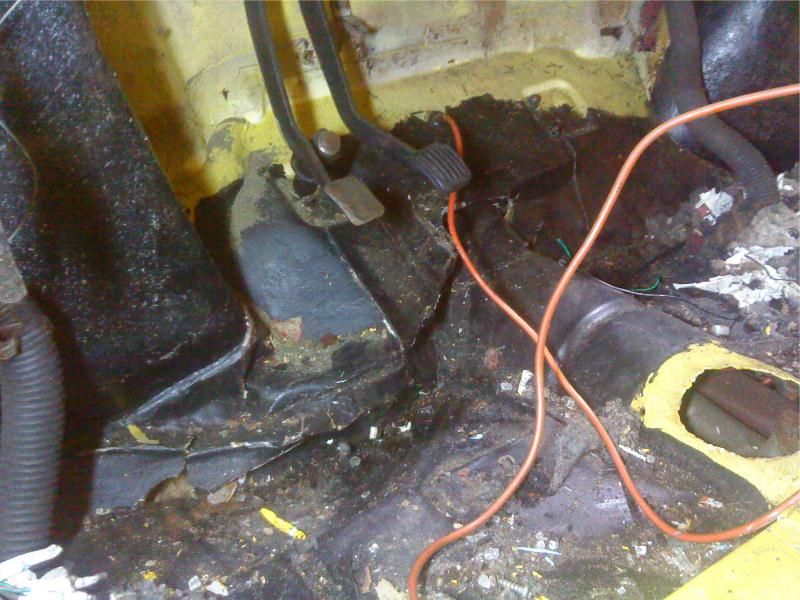

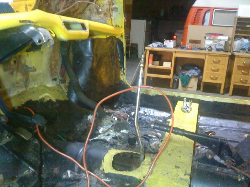

Once it was off the trailer I used an engine lift to lift up the front end so I could get the exhaust and the shift lever out. That shift lever is seriously bent, and it's bent above the floor. Either the original builder bent it before building, or the driver had it bent against him in the crash!
The original toeboard is seriously toast and I don't think it is in any way repairable.
Once the exhaust and shifter was removed I decided laying on the ground disconnecting things was not acceptable so I got a hand leaning it over on it's side on a mattress which gave me a good view of the bottom...
...and the top :)
The roof doesn't seem to have any bents ripples. At least something is straight... The ends of the subframe is fairly thrashed, and once I pulled it out it is definitely twisted. I may be able to fix it.

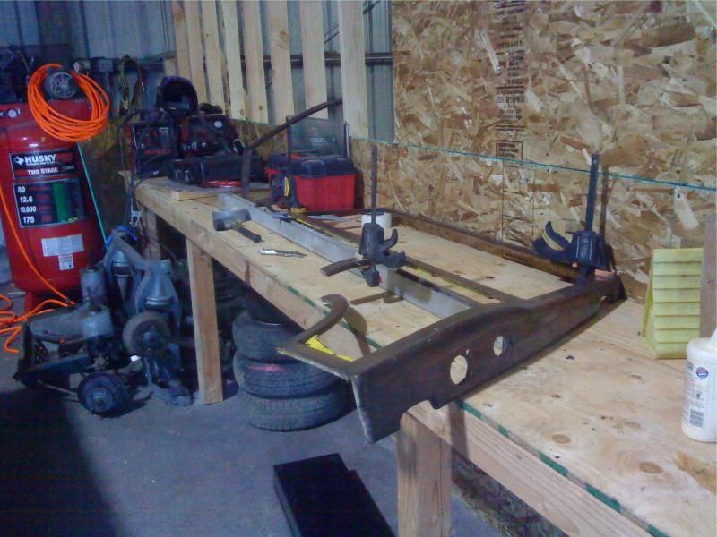

Once I got all of the brake lines hand brake cables and other sundry items removed, I was able to remove the subframes and drop it on the floor so I could start cleaning up the work area.

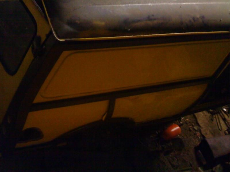

Before going home for the night I glued and clamped up the broken left hand wood frame so it would have overnight to dry.
And then went home... for the hell of it once I got home I plopped the wood side on the van for the hell of it...
For your Enjoyment,
