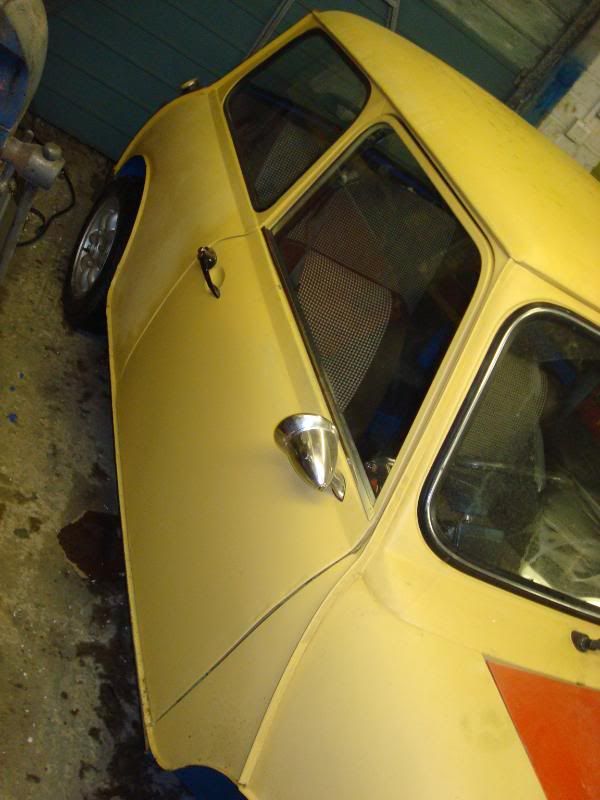

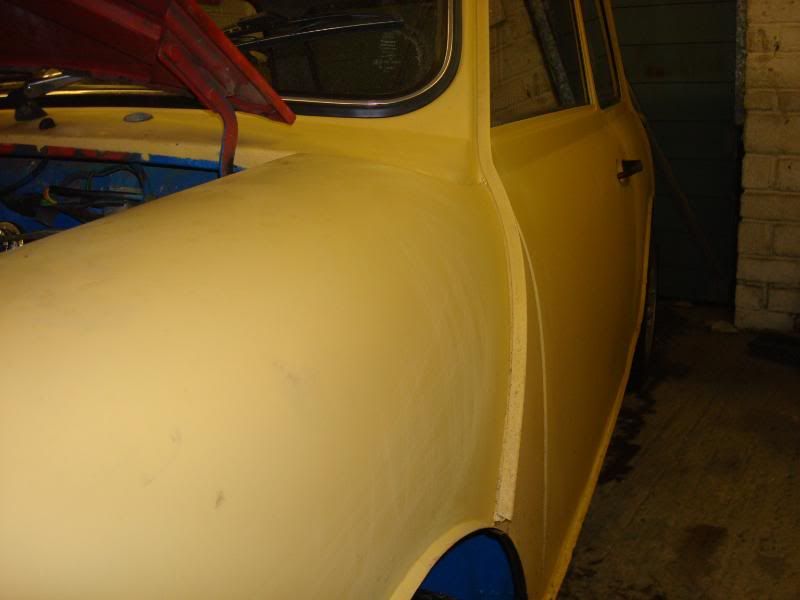

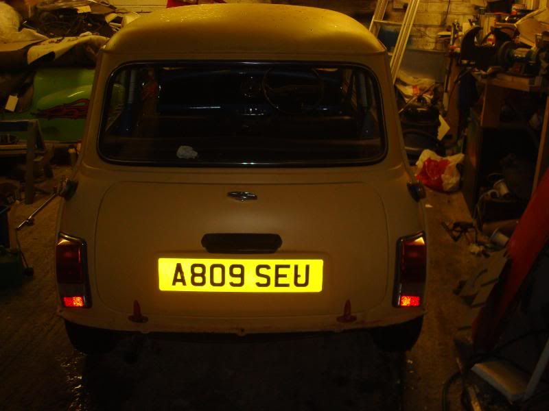

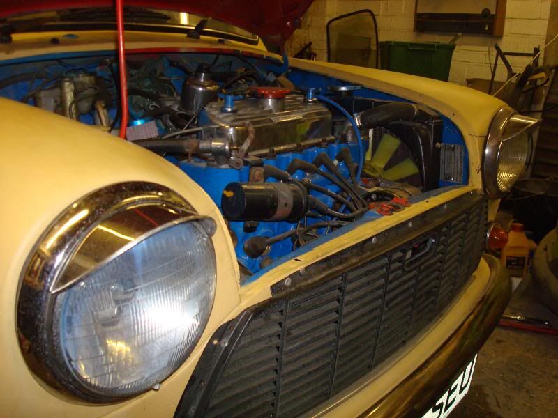

Now that the car has got its M.O.T, tax and insurance it is time to start using the car and getting some fun from it. She is still in primer at the moment but she will get a coat or two of paint before she goes out on the road and come the summer she will be taken to a bodyshop to get a proper full body spray to complete here the way she deserves. Here she is, some fo works in progress and some as a complete car once again.
The pics show here still having a red bonnet, this is the origional one which has had the lip cut of to help make the MK1 look. I have however got a new one on order but sadley it didnt get to me in time for christmas and the mot so ill have to wait a little longer for that. I now also have the over riders for front and rear and just need the corner bars before fitting them. The twin tank is fitted and i now also have the MK2 rear light (thanks Santa). The bonnet and boot badges are also here but the boot lid now need changing to complete the look. More pics will follow shortley.

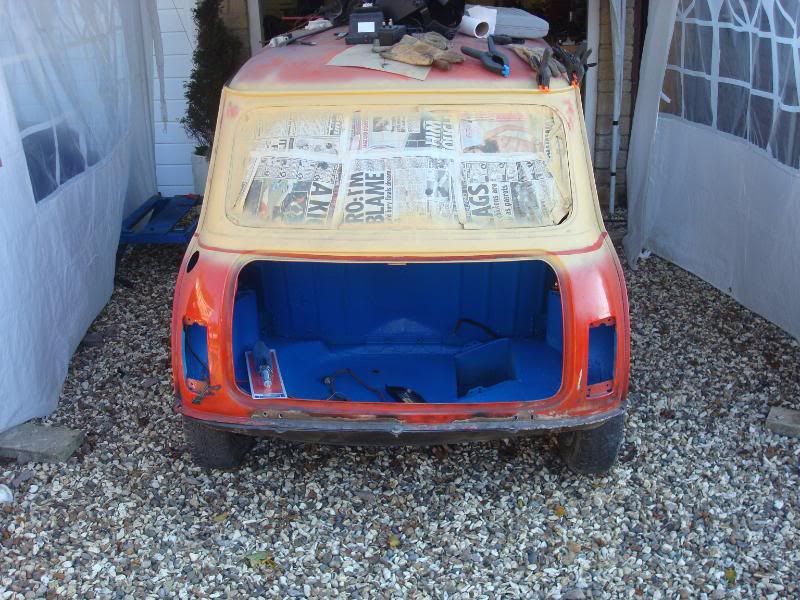

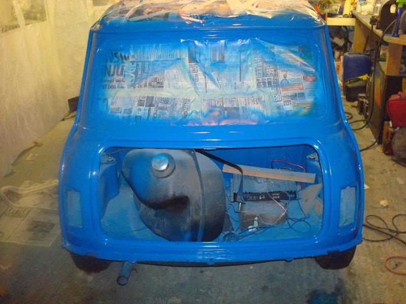

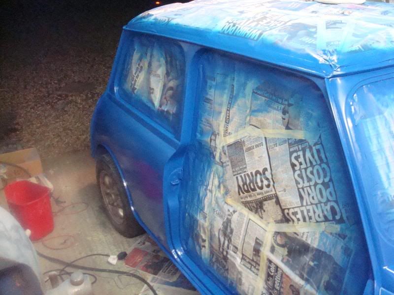

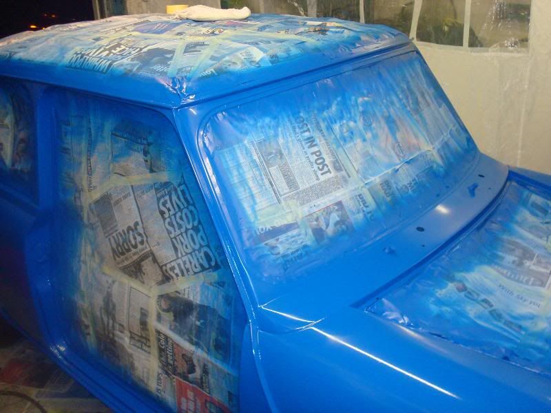

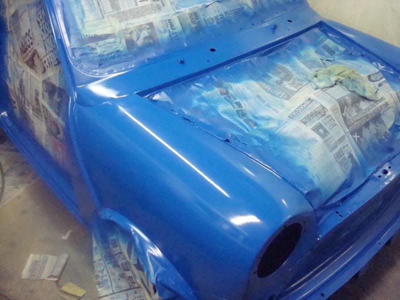

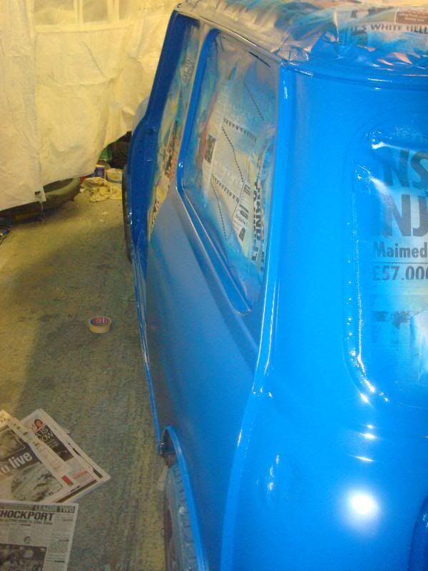

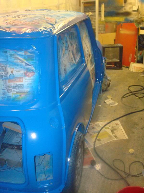

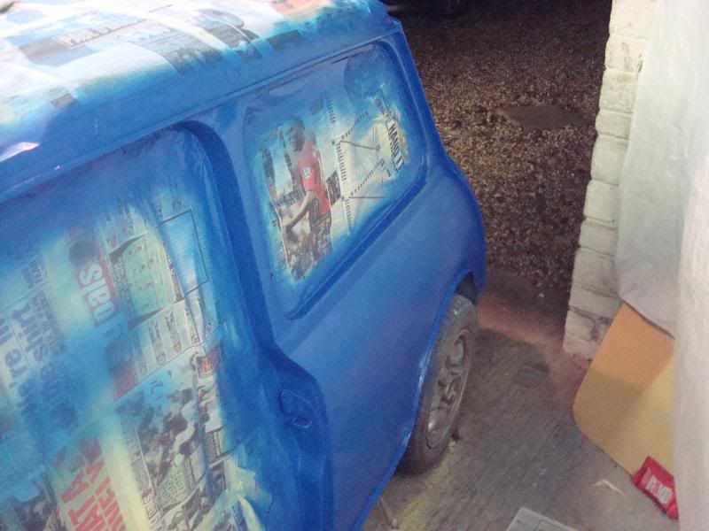

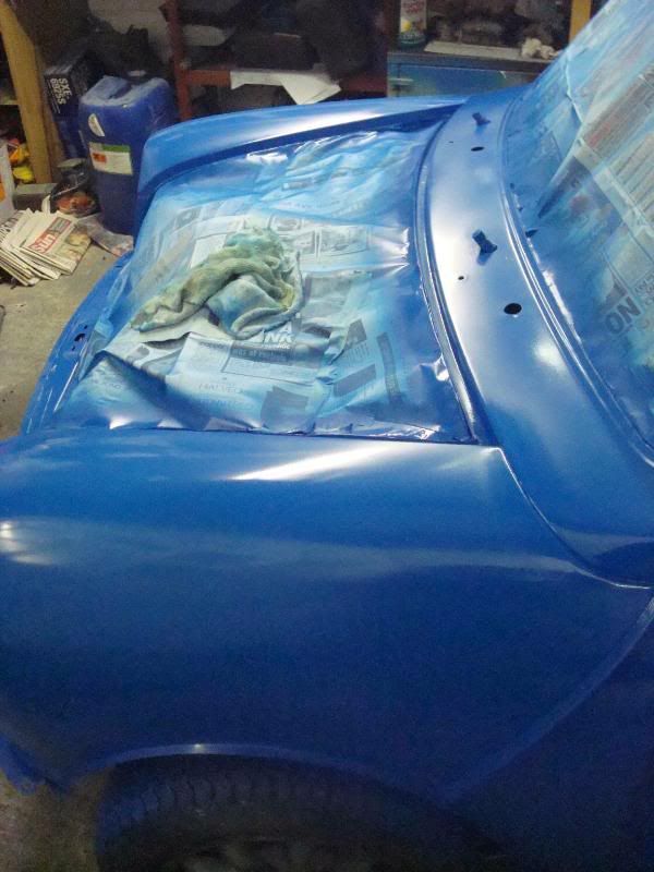

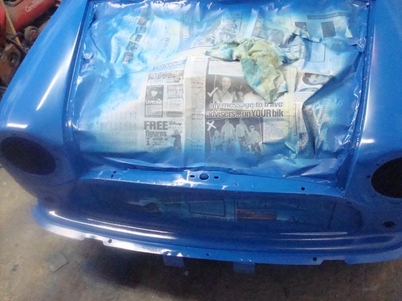

Just an update of whats been going on over the last couple of days. Yesterday saw eight hours of flatting back, today saw more hours with the 1500 grit and water flatting back and cleaning. After all this was done, it was time to get some paint in the gun and start shooting. With the car all masked up the white hit the roof. Two coats of white went on the car before more flatting folowed by a further two coats. This left me with nothing to do for a few hours while the heat of the garage let the paint harden. It was then back to a light flatting to take the shine off and work out all the horrid little dust and overspray marks before the buffer came out. A couple of hours later i was happy. Then came care masking, this time it was on the roof to protect the new paint from that which came next.
With the roof safely covered it was time to reload the gun and get back to it. This time round i was shooting the blue. Oh and boy its blue. Now that the two coats have hit the car, its time to let it all sit overnight before the action starts again. I will be going back out to flatten todays effort before shooting more blue. So here we have a couple of pics of whats been going on. Sorry the roof is still masked out but this is what she is looking like so far from todays mamouth paint-athon.
I think you will all agree, its come along way since;
I will keep the picys coming tomorrow. Hope you all enjoy......
