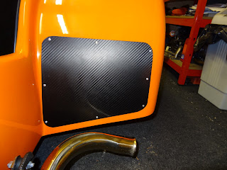

#804 domdee
domdee
    Formally known as dominicdee
  • 1,183 posts
  • Location: hull
Posted 14 August 2013 - 05:52 AM
id definately opt for the panel protection plate things! pop riveted on they look pretty sexy!
perhaps carbon fibre wrapped ones might look good?!
#805 domdee
domdee
  • 1,183 posts
  • Location: hull
Posted 14 August 2013 - 05:57 AM
http://4.bp.blogspot... protectors.JPG
http://teamwoodspeed...1___Medium_.jpg
Go for it matey!
#806 jagman.2003
jagman.2003
  • 1,307 posts
  • Location: In the shed.
  • Local Club: Owner of my own club of Minis
Posted 14 August 2013 - 07:44 AM
Looks good to me, thanks for the links. definitely an idea there.
#807 domdee
domdee
  • 1,183 posts
  • Location: hull
Posted 14 August 2013 - 08:07 AM
yeah it would look mint!
