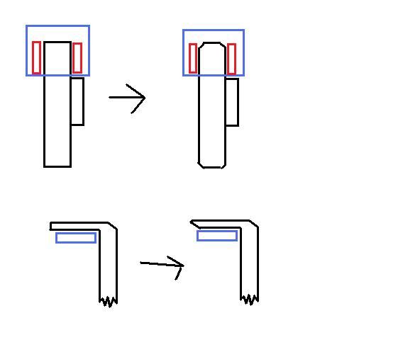

I agree with making an angled edge on drums and rotors. Maybe the following should be done? the pads/linings dont go past the outer edges and yet the drums and rotors are easy to remove :thumbsup:
ps the blue bits are the calipers and drum linings. red is brake pads and black is the drum/disk :teehee:

Thanks tuf998,
that is exactly what I was suggesting - a picture is worth a thousand words. This thread proves to me that we often accept things the way they are, rather than questioning the reason - 'we've always done it that way'. I will accept some of the criticism of my proposal, but not just speculation or hearsay - as an Engineer I only want hard, tried and researched facts - that's how we progess.

well said orcadian. Being a general motor mechanic I hate removing lipped drums and pads off lipped rotors. The answer is right there as Ive shown but I would assume that it would be the manufacturing cost that stops it. customers want to pay minimum prices even though there are benifets to be had in some cases.

the problem i can see with it is how long the chamfer would have to be. quick drawing....
same as above black- drum, blue - shoes but the grey is how the drum would wear
if the chamfer starts at the end of the shoe then it will still create a lip (just a narrower one). if you wanted to create a chamfer that stopped a lip forming then it would need to be much wider meaning that a section of the pad would not be in contact with the drum (when new)

good points, the second diagram is the ideal one. the trick is to use mathematical stunts to work out where the maximum runout would be and make the chamfer adjusted to that. And so minimising the bit of low contact with new pads as best as can.
