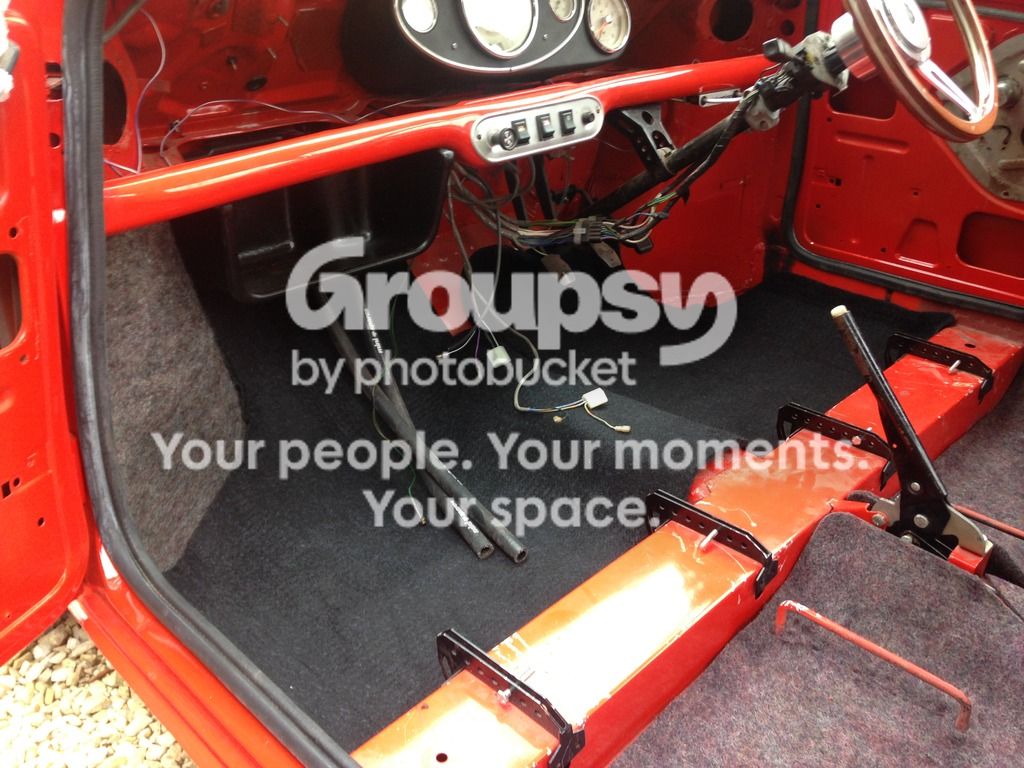

Had ago at fitting the chrome down the side last night, Forgot how much of a paint that job is haha. I have got some of it done but could do with a heat gun to finish it off.
I also got some of the soundproofing for the carpet fitted.

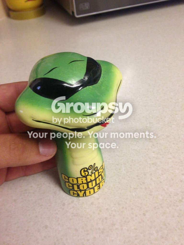

My Rattle Cyder bar tap I want to make in to a gear knob. Want sure what the best thing to fill it with would be but Rusty suggest potting compound and also managed to get hold of some for me.
Anyway I mixed it up poored it in and left it over night.
Its now gone rock solid which is a result! Now hopefully I'll be able to drill and tap that. Thats a task for the weekend.

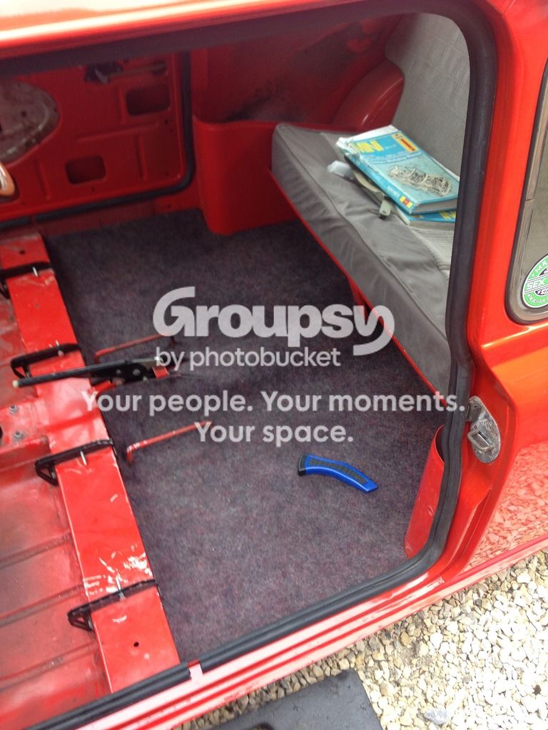

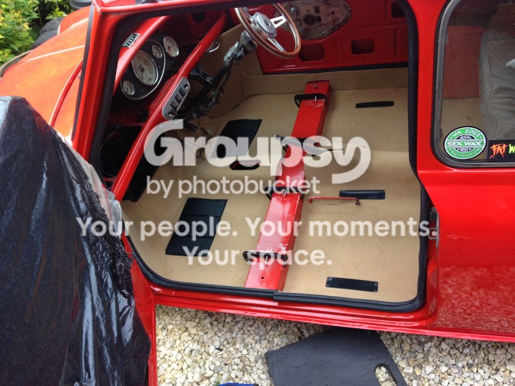

Got more of the underlay and carpet in today.
and the carpet.
Still got a bit over the cross member to fit and the bit that sits on the flitch panel on the driver side needs trimming round the fresh air intake but those couple of bits shouldn't take long. Popped the carpet back out for now just so it doesn't get dirty.
