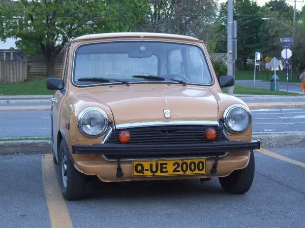

As above screen wash won't freeze if you mix it right, mine hasn't frozen and I'm in the coldest part of the country atm. If you're not sure on the ratio, buy the ready mixed stuff.
I don't really see the need for a grille muff, mini's made for colder countries had the same grille setup as over here, see this Canadian mini, and yes that bumper was standard fitment :)
If you really wanted to, you might as well cover the entire grille, there is no area that has to be left open, it's purpose to cool the engine, and in this weather it hardly needs it.
