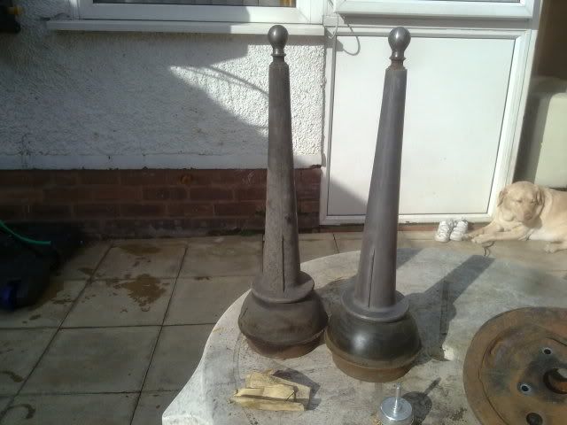

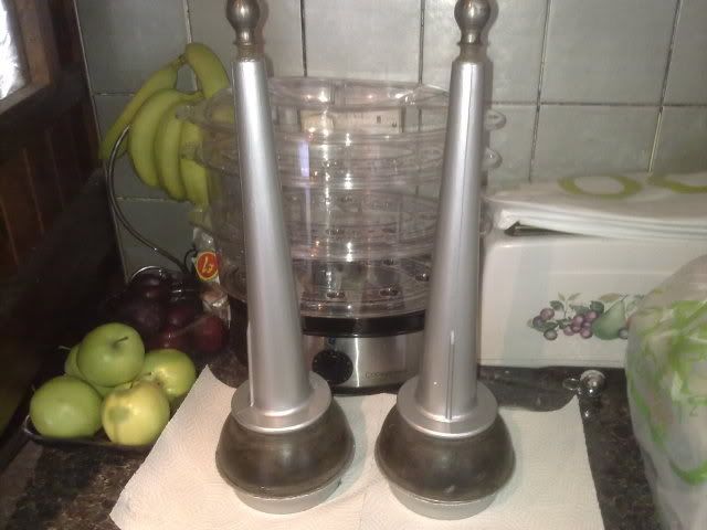

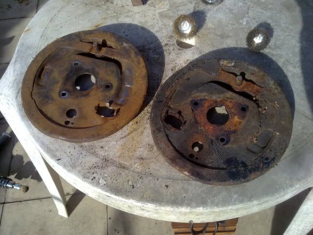

not to get to down hartend today i got sum of the out standing bits finnished off for the rear subby today with my wire bush drill and paint away i went lol , not to bad for a spray can but the wife was p***ed off with me when i put them in the house to dry lmfaf .

that washing line is buggered now!!!! hope you cleaned it with paint remover!!Honestly the trumpets really wont fit the steamer. Granf job by the way!! :proud:
haha don't tell the wife but i put them in the steamer to clean them lol

Steamer for cleaning, awesome, that's beaten me and the oven for drying the engine hands down, lol. Nice shiny parts to put back on though!!
