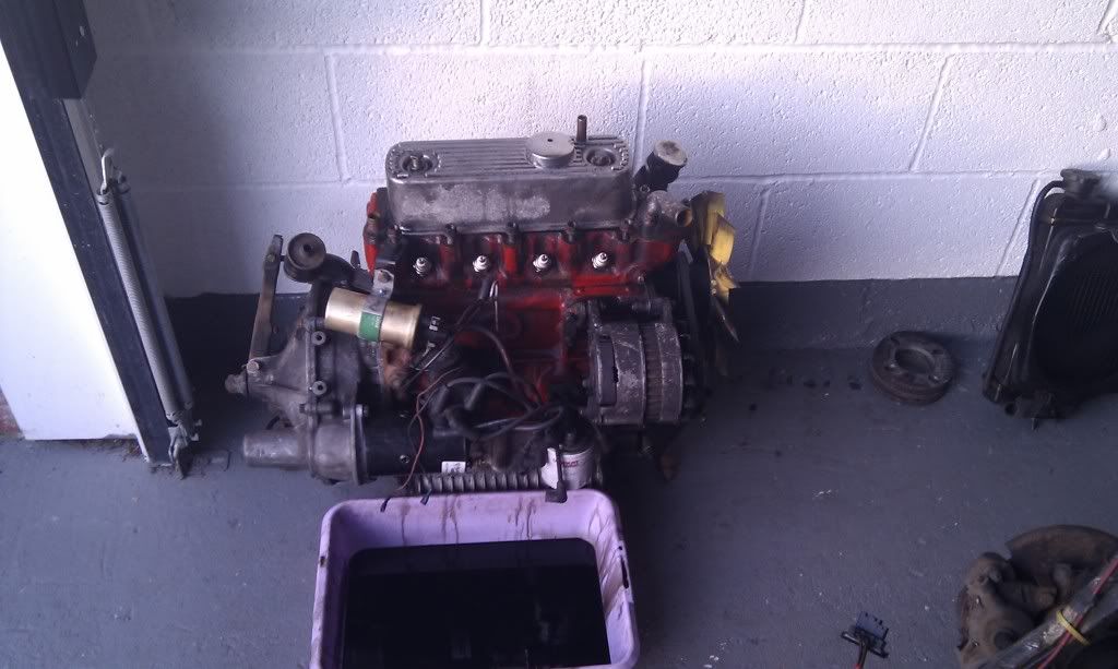

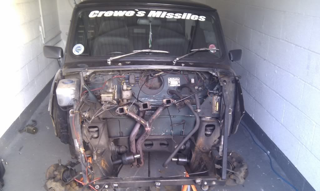

Busy day today, decided to get the engine out ready for dropping the subframe and painting the bulkhead. First started off by removing the dreaded gear selector roll pin, turned out to be an easy job. Just stuck it in to reverse, squirted a bit of wd40 around the pin and then gave it a good wack with the flat chuck end of a 5mm drill bit. Even the pot joints were no hassle, just used a screwdriver between the pot and the diff case and they popped straight off! All in all not a bad couple of hours work.
998 lump on the garage floor awaiting a re-paint. Thinking black with chrome goodies to compliment the gun metal bulkhead?
Also removed one of the tappet chest covers and placed one of the cam followers back in its hole after it popped out whilst removing one of the pushrods. Thank god for 998 tappet chest covers lol.

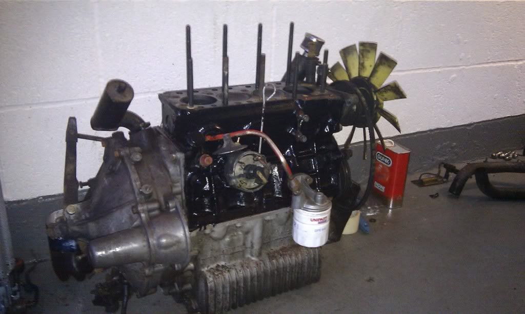

Just finished putting the first coat of gloss black on my 998 engine today actually, should luck the nuts when its done with all the chrome and alloy goodies im planning for it. I'll get some more pictures up tomorrow.

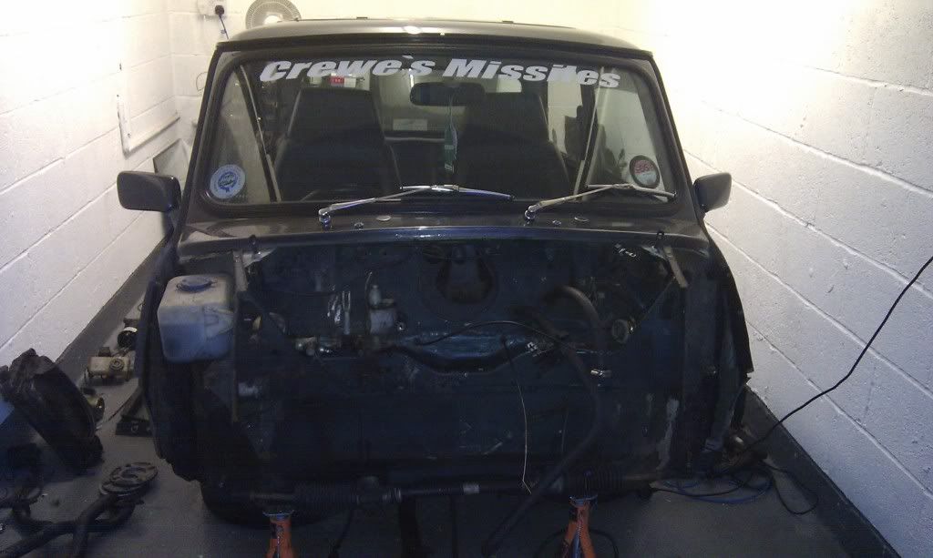

Well labelled up all my wiring, got it all disconnected, unwrapped it all and then pushed it through the bulkhead ready for being re-wrapped.

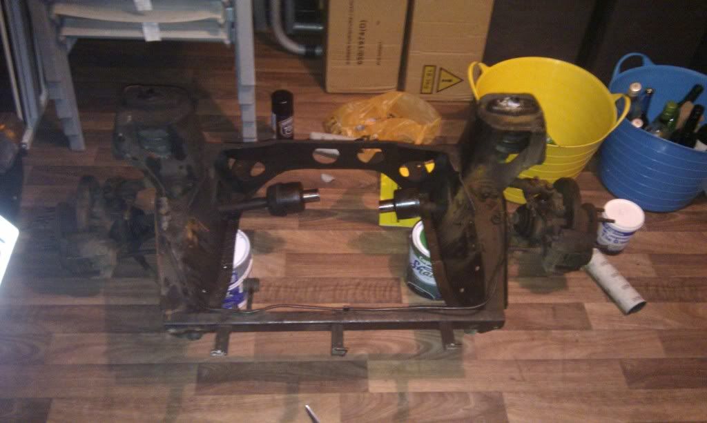

Also dropped the front subframe so now thats ready for re-conditioning. I was thinking paint the swivel hubs, fit new ball joints and wheel bearings, new outer cv's, adjustable bottom arms and tie rods, already got minitastic coil springs and hi lo's so dont need to get those.
Im going to paint the subframe in black POR15 rust preventative paint, also just bought some metal ready from frost so ill probably get cracking stripping the subframe this weekend ready for painting next week.
A picture of my 998 with its first coat of gloss black (the oil filter pipe will be painted silver)
The gearbox and flywheel casing needs degreasing. Ill see how it comes up but if it still looks scruffy then I will spray them silver.
