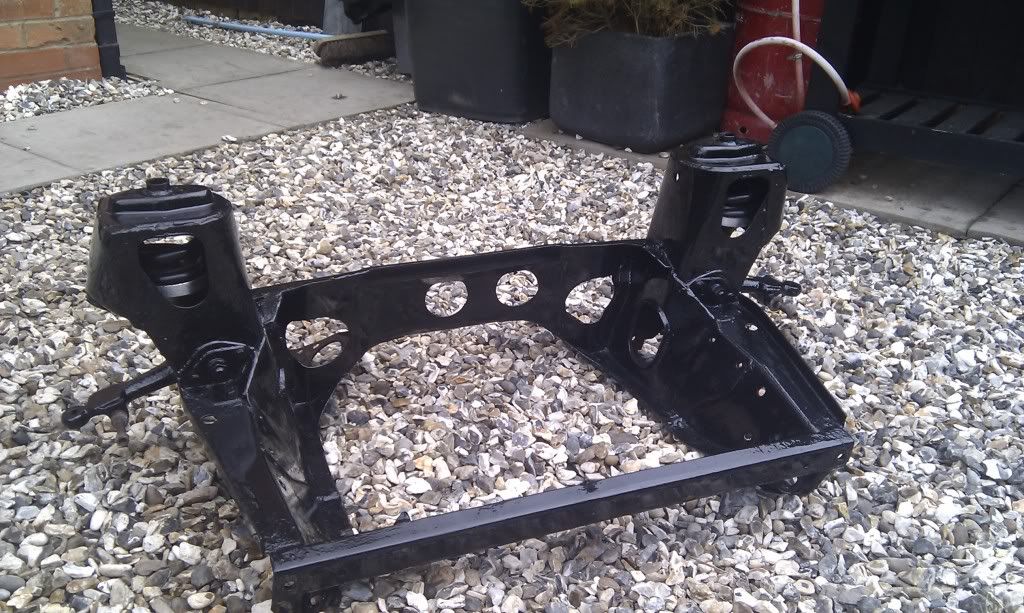

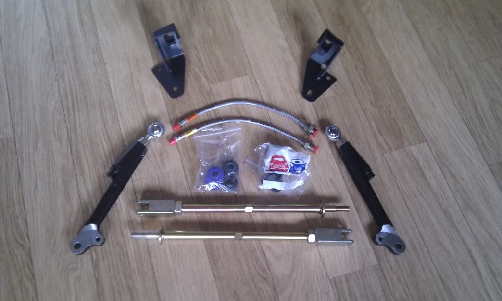

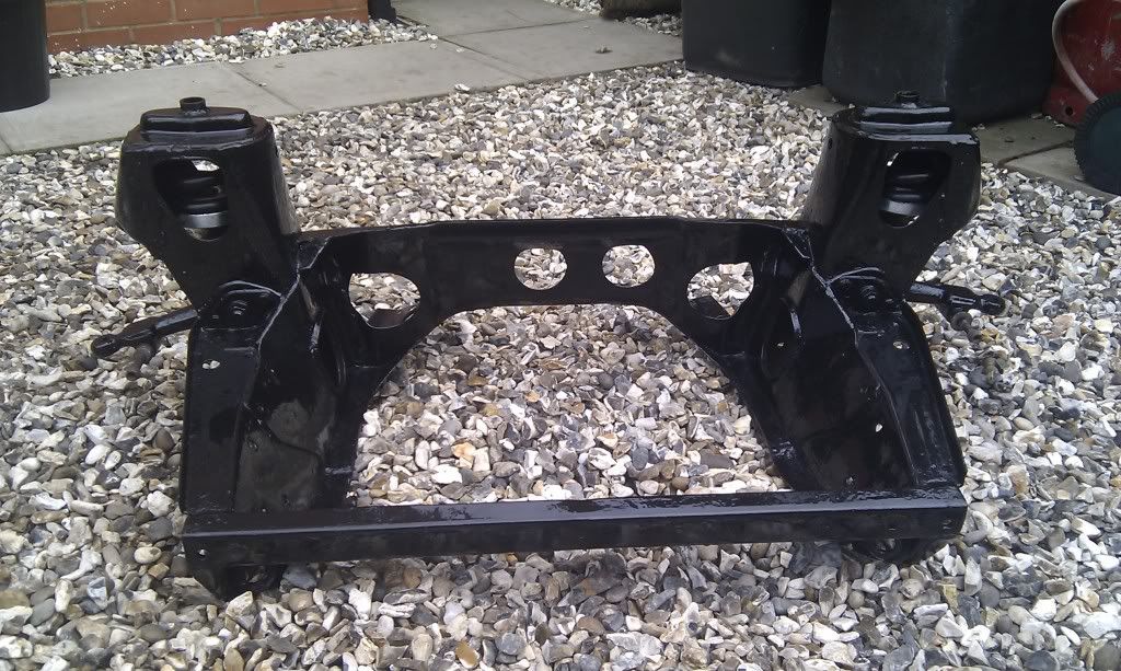

Sorry I havent updated in a while, Ive been getting assesments out of the way at uni and after today im off for 4 weeks over easter so should be able to get a lot more done.
Since my last post the subframe is now all painted and ready to be built back up:
Also recieved my order from minispares the other day, things such as rose jointed bottom arms, heavy duty tie bars and bushes, rear adjustable tracking brackets , kieth Calver bump stops, goodridge hoses, ball joints, wheel bearings etc.
Also started re-conditioning my swivel hubs with the new ball joints and wheel bearings. Up to now ive stripped them down, painted them and fitted the wheel bearings. I should have finished fitting the ball joints by the weekend and then I can start building the subby back up.
