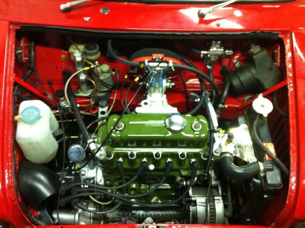

It was not an install article, it was just an add. I did some research on the web and someone on minifinity had a picture. Here is the thread with SC replying:
http://efiminis.olic...php?topic=702.0
"Looking at the position of injectors first - we've placed them back so that they fire at the "plenum" in the front of the manifold. We have done this to provide the best fuel density to the incoming air - see the video on our front page for impressive "fogging" effect, they fire 4 times per cycle and effectively make an electronic carb with massive flow potential - as shown by matching the top end on a race engine with a Weber - what a Weber won't do though is pull what under dyno laod at 1500rpm on this race spec engine - or produce the torque at part throttle/mpg/efficiency etc. We picked this engine as the toughest to match anything less than this spec will produce even more spectacular results at the bottom/mid range. What we didn't set out to do was "fix" the 5 port - that why we have the 7 port and 16v! what we did aim to do was offer massive benefits over a carb be it an sU or Weber in terms of torque/efficiency/power with all the niceties of FI.
Price £959 +vat inc
Typhoon ecu + software and CAN interface
Bespoke wiring loom
Trigger kit
Sensors
inlet manifold
Fuel inejctors - new Bosch 440cc
Stainless fuel rail
50mm shaftless body + injector housing (we have developed a fast idle mechanism for cold starting inc also)
Ram pipe
Throttle cable
ignition coil/billet bracket/fixings
bespoke ign wires
All you need to do is supply fuel at 3.5bar (we will have options on this as well)
air filter will be an option also
The wiring loom will come already for Turbo use with MAP and boost solenoid connectors ready - the MAP and boost solenoid are available as an add on any other queries pls ping us an email on [email protected]
Regards JK"

Posted 26 March 2011 - 09:23 PM
Seriously are there only two of these in the UK? there must be more knocking around...
I have one, as dose apbellamy and one has gone to Japan (who knows what could have happened to that now) mine is the one pictured in the red mini.
it's currently running but needs taking to get set up.
