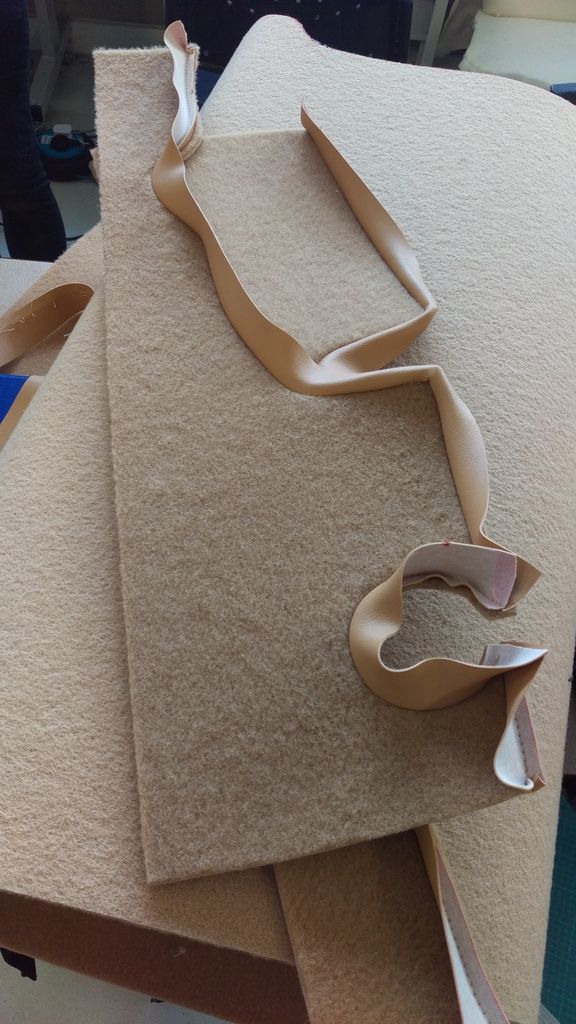

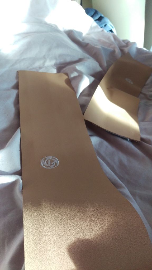

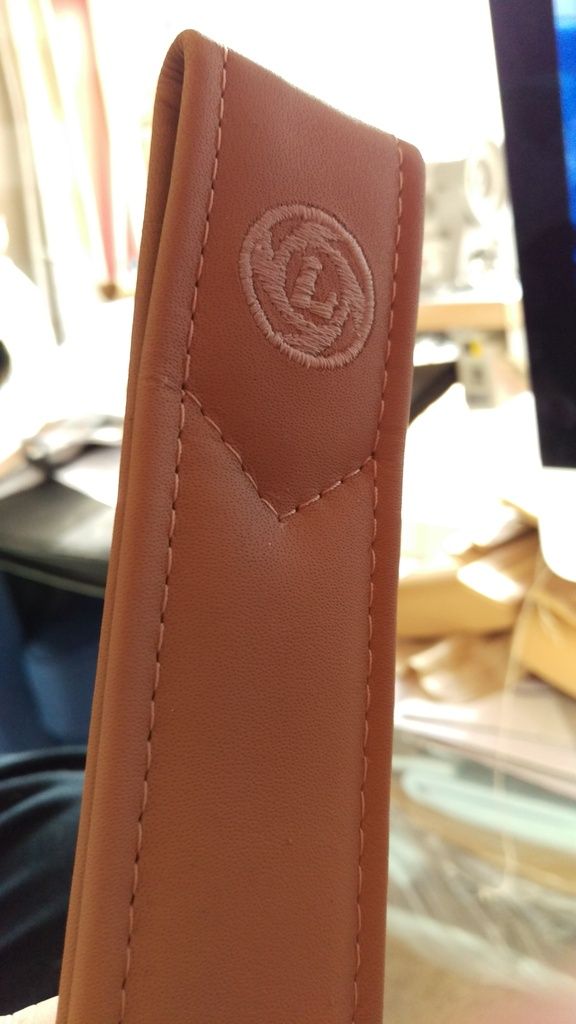

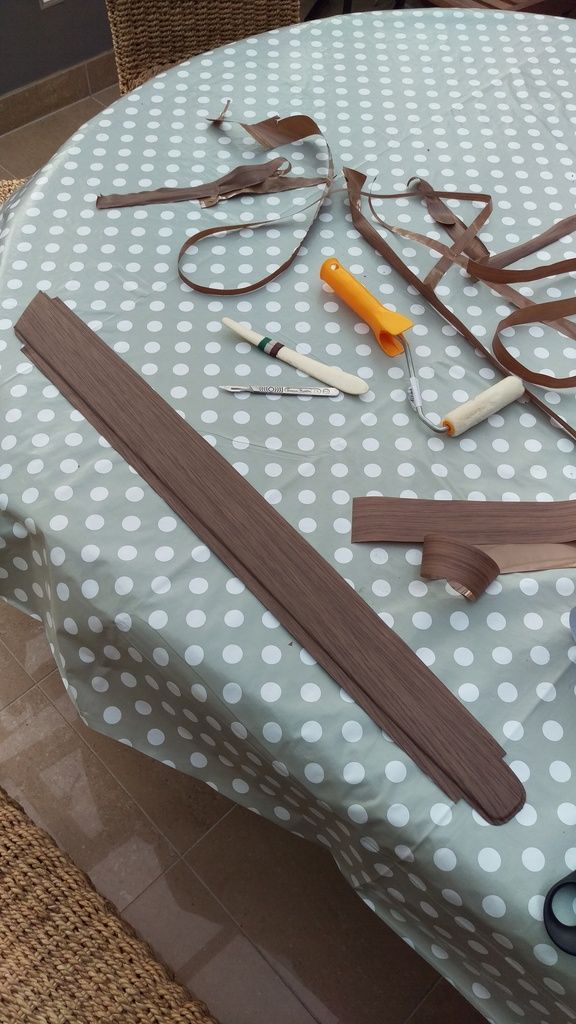

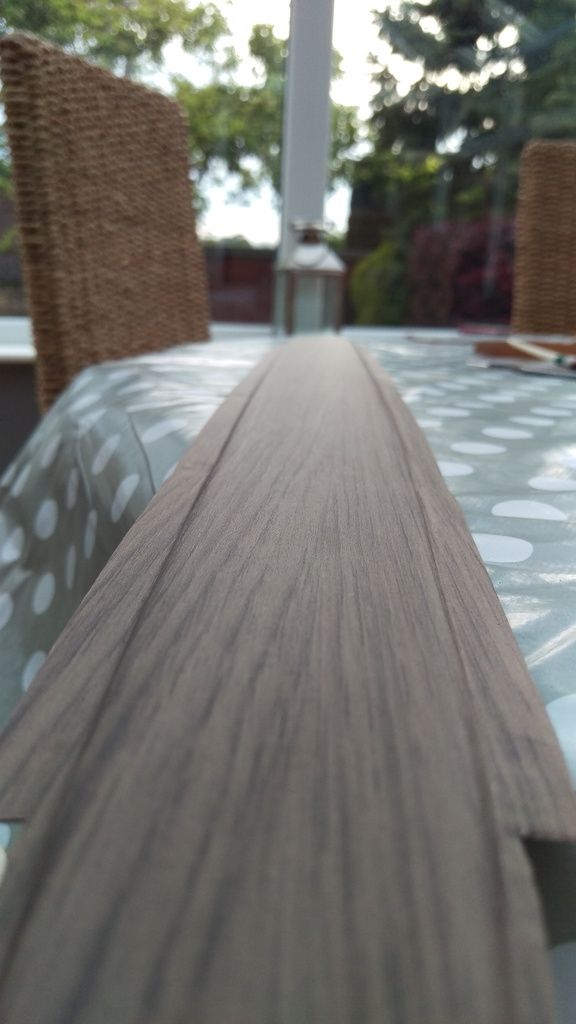

Adding binding to give that finished look.
Re-doing the fake wood trim, as the original stuff was totally shot. It was also a pain to get off.
The vinyl came from America as I couldn't find what I was looking for here. This stuff unlike Fablon has a texture to it like the original.
Also had a friend do some embroidery for me.
#259 woodenman23

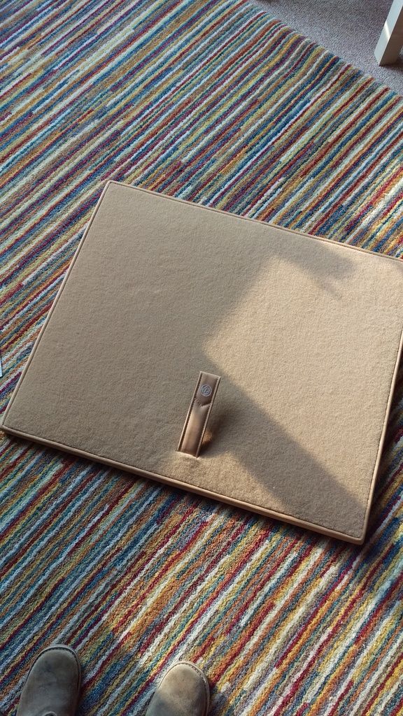

And this is where I intend to use one, as a handle to lift the false floor in the boot.

These are the people I got the vinyl from, pretty sure this is the same colour but not 100%. They do 5 or 6 colours in the textured stuff I think and a lot more colours/grains non-textured. This listing is only for 10cm x 20cm, you are going to need a lot more. If you want to do one side in one strip of material to make sure the wood grain stays constant and matches down the length of the car (which I have done) you are going to need roughly 120" in length.
As for fixing the strips to the car I'm going to use the original method of the rivets with the cups that the chrome trim clips onto. I'll be coating the back side of the trim in a lot of dynax UB to protect from rust.

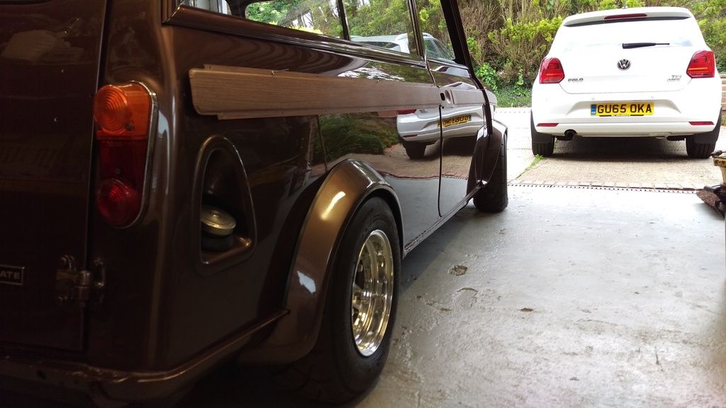

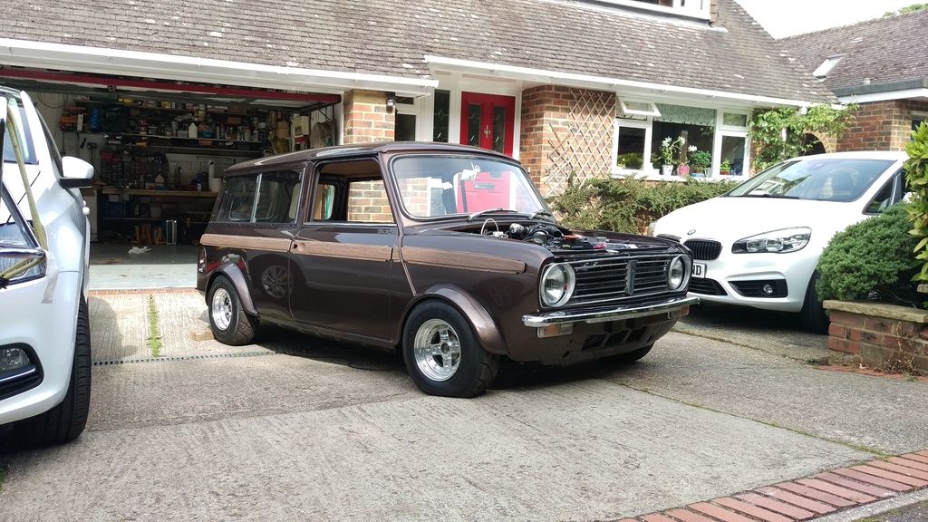

I have now got the side windows and frames in and bolted on the wheel arches.
The chap that painted the car came by last weekend and sorted out a couple of marks it had picked up during the rebuild he also polished and waxed it.
Just hung the side trims on to see what it's going to look like. We think we have found a solution for the fixings now. Hopefully they will arrive tomorrow so I can get them on properly.

It looking good man! That wood trim will really finish it off!
