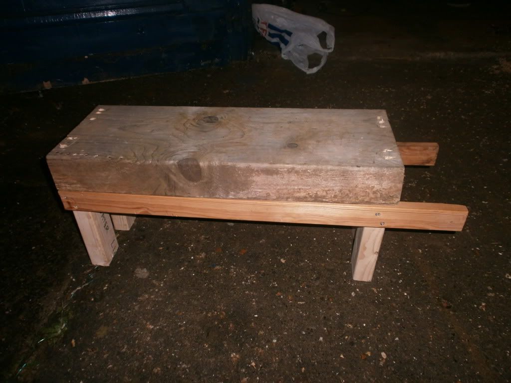

Small update... After kneeling on several screws/bolts/sharp bits of metal while welding i thought enough is enough and knocked up a small stool to sit on out of bits i had laying round the garage..
the over hang bits on the 1 end will soon become a little tray for cup of tea/tool tray for mole grips etc :D

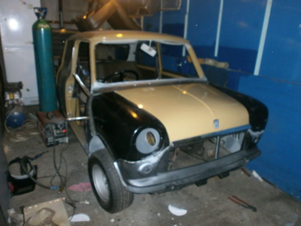

also did a little more welding to, got the scuttle welded on fully now and the closing panels welded to it, after this i re-fitted the front end to check the gaps on the wings/scuttle join to make sure they were still ok, passenger side was spot on, drivers side though was about 3-4mm out, so i had to slice the extended bit, trim it down a little and re-weld it so the wing now sits nicely against the scuttle, clamped and bolted the front end back in place and bolted on the bonnet to check the panel gaps and all is well! means i can finish the prep under the front end, get it all stone chipped etc and then weld it all up ready for prep and paint

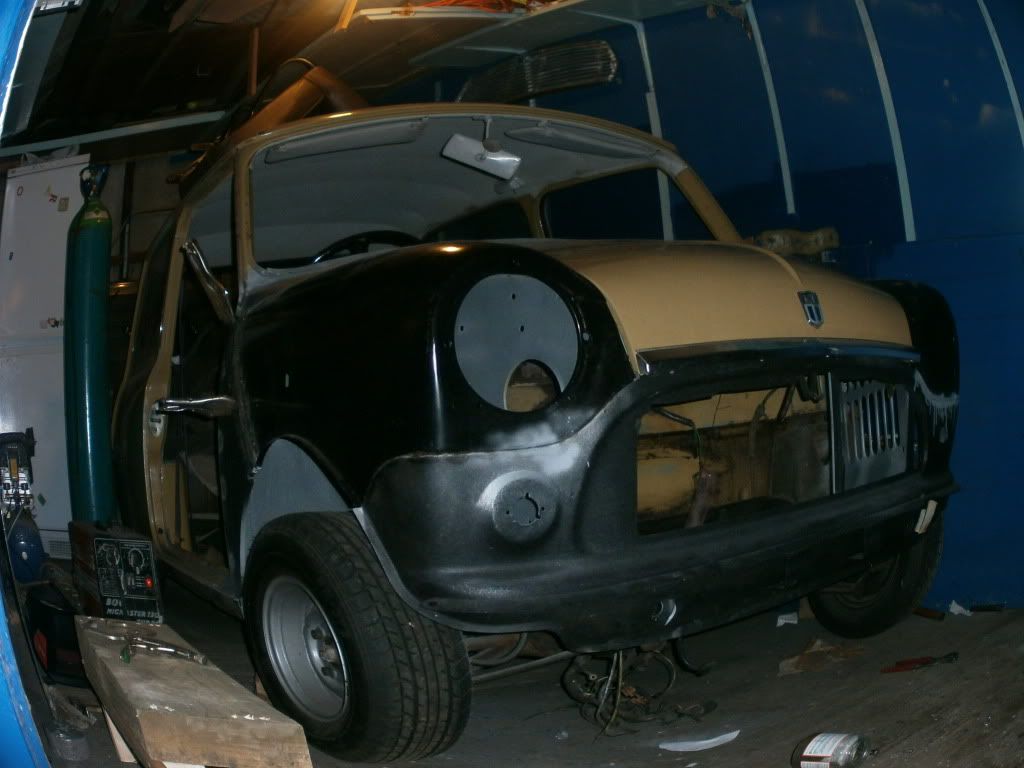

also had a play around with my camera with fish eye mode..

great project mate :-) i got the same front end from old skool minis aswell, everything fitted fine for me except the join for the wing to the scuttle panel, it was got as good as possible but its not very good :( i love those banded steels by the way, they just look awesome :-)

Nice stool...it can double as a chopping block if things go wrong...lol..How does anyone know thats what things look like if your a fish??

Lewis you make it look so easy. Post 1 its a car, post 2 its chopped up, post 3 it looks like a car again! Those wings were miles off, good work getting them fitted nicely!
Oh and nice stool :D

lol glad eveyone approves of the stool! my little girl loves it, she thinks its her bench haha!

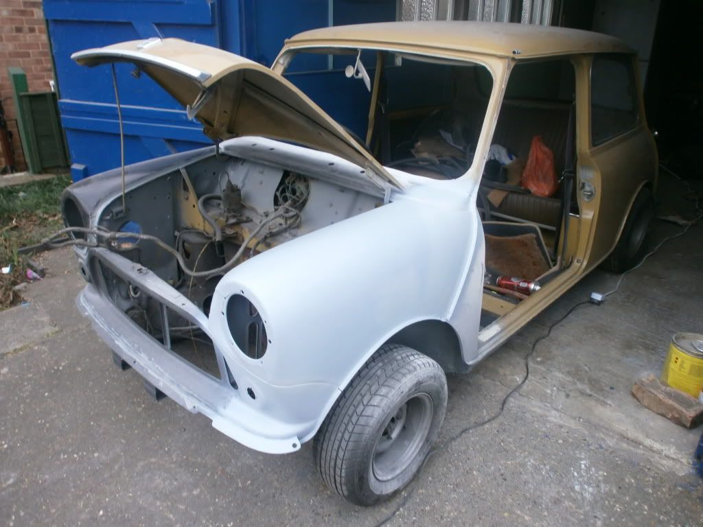

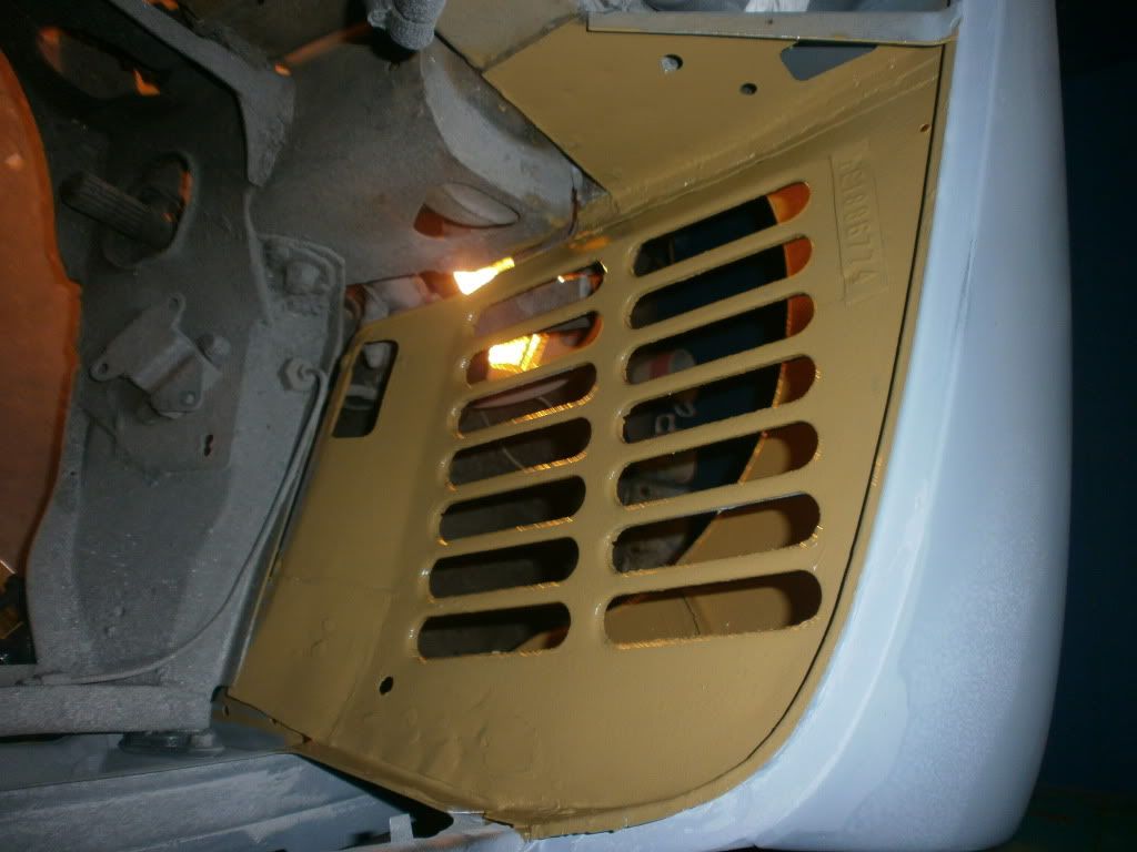

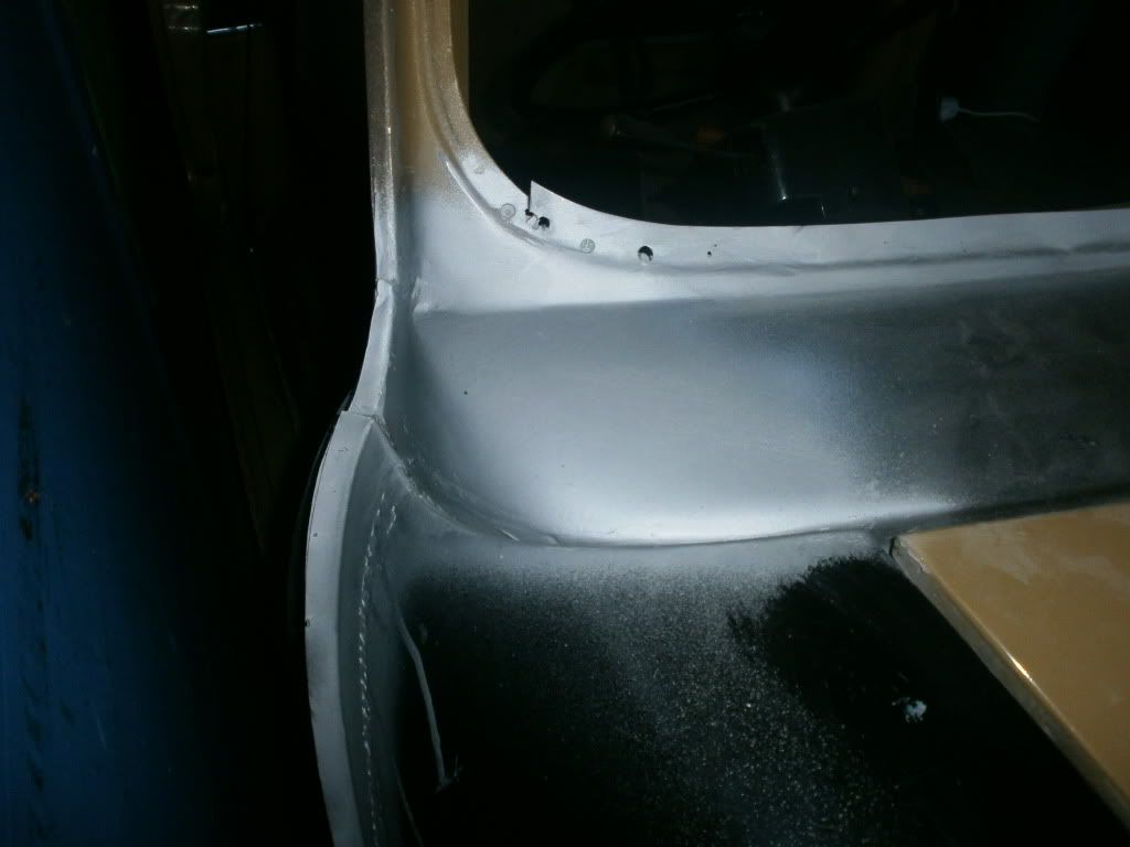

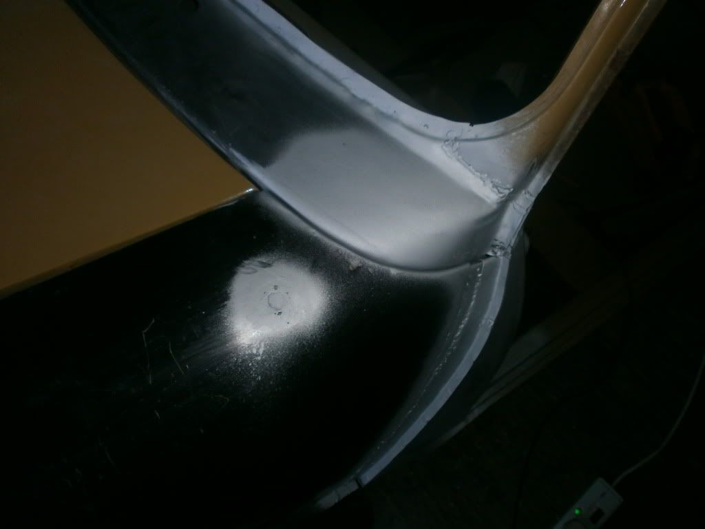

another update... the pics dont really look any different, but i can asure you the car has come along some what, the front end is fully welded on now, seam sealed, inner wings stone chipped (just need to stone chip under the wings/behind the front panel/a-panels) i ran seam sealer around the back of the head lamp securing rings on the wings to aid rust proofing (i hope!)
anyways a few pics...

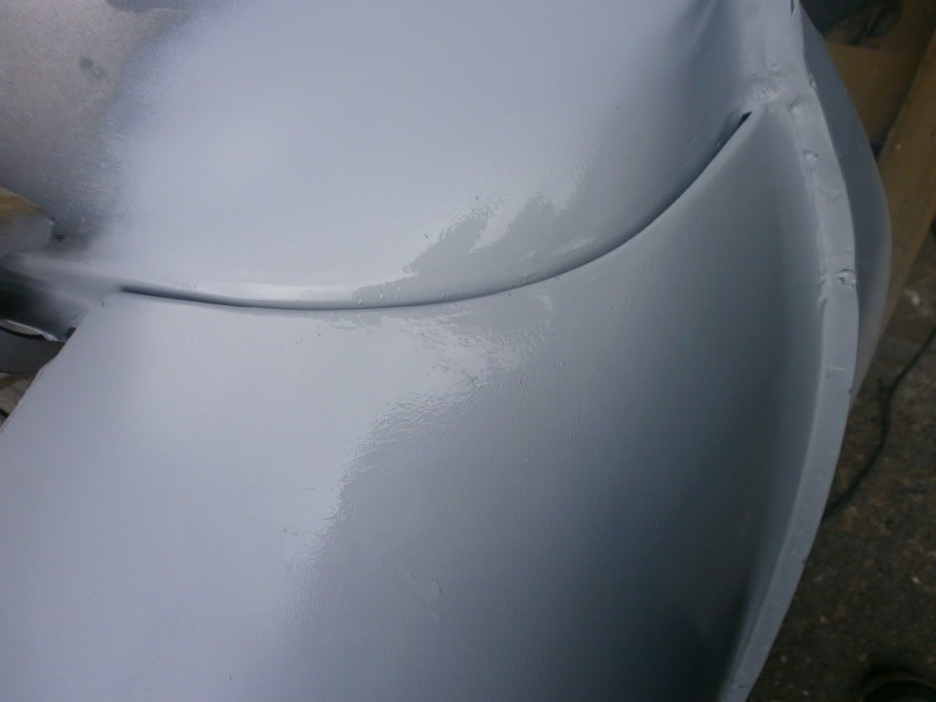

top wing seams (they weres well out, you can see where i split the wing and added 1" strip of steel to extend the wings, had to do both sides!)
as you can see, plenty of zinc primer to hopefully hold back any corrosion!
welded on...

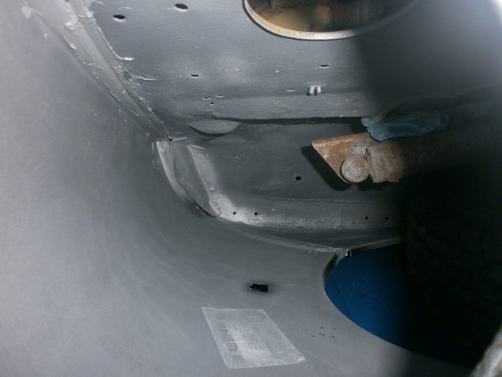

inner wing shot (still need to peal the sticker off lol but all prepped and zinc primed)

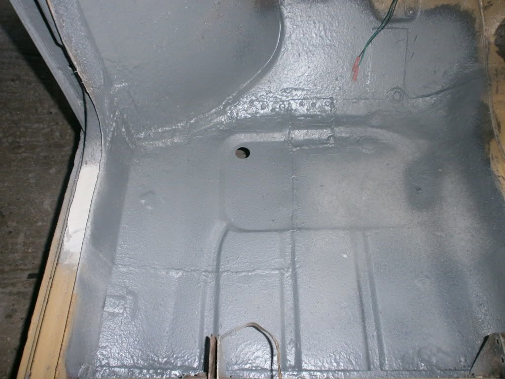

repaired the passenger footwell yesterday, it had a plate ontop of the old floor panel, and a plate underneath, effectively sandwhiching the old floor in between, i could of left it as it was pretty solid, but i wasnt happy so chopped it out and let in a new piece of floor section which tidied things up some what... heres a pic, i didnt get a before or during, i was to busy lol

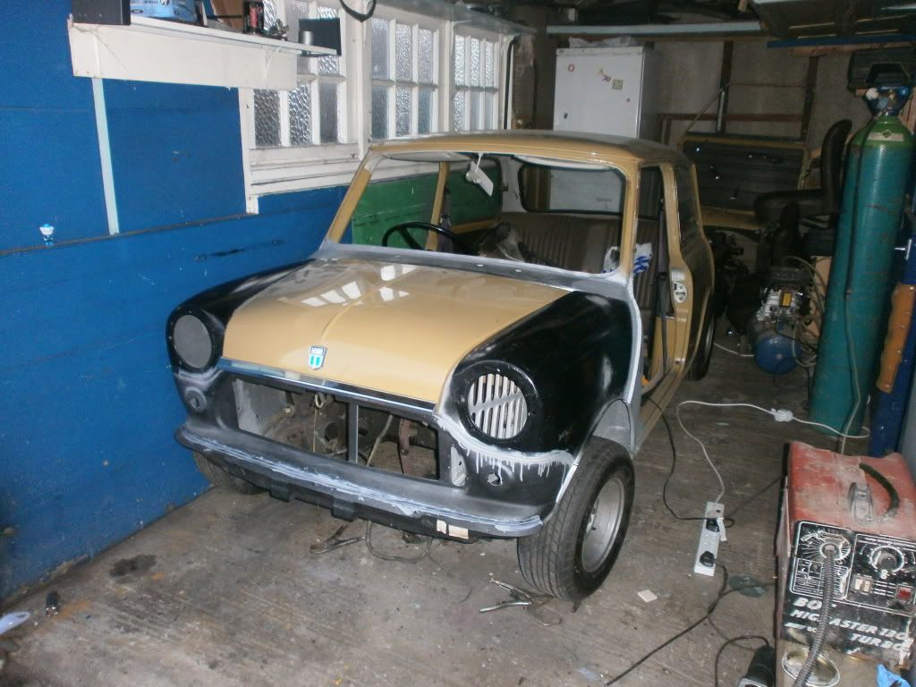

few pics of todays progress, nearly finished the filling and prep work on the passenger front wing where i had to split and weld in an extra 1" of steel, i completely bare metalled the wing/front panel before any filling was done, looking good so far, but still need to do the final prep
few pics, given that the front end is made of non-genuine panels, ive got it to fit pretty nicely!...

not much of an update, but got the underneath of the passenger wing painted, and the inner wing in the engine bay, having a small garage and very little room to work around the mini let alond spray it, i decided to brush paint under the wings etc its only the 1st coat but its gone on smooth, and looks well, although in the pics it looks more sandglow than harvest gold! but trust me, its harvest gold lol
