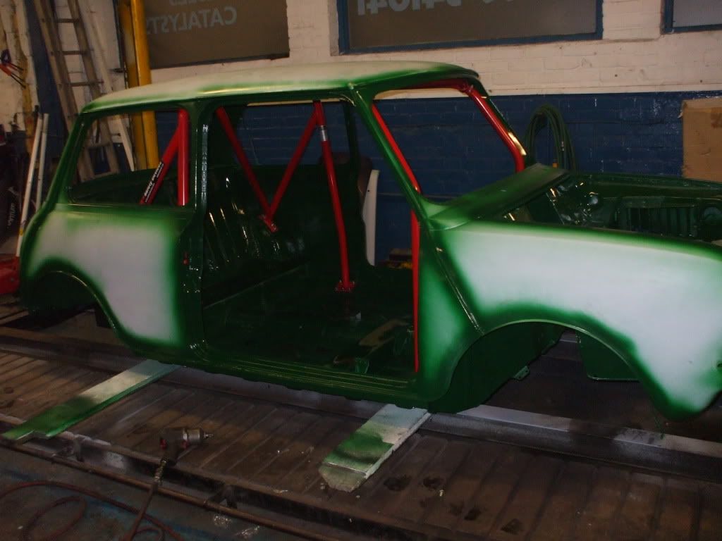

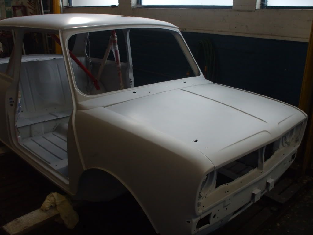

so i have finally got round to building my engine, this is just pre warning, its not gonna be a quick build. im funding it myself and for a `16 year old, a engine is going to be a big hitter on my walet, so if im not building it, im working for it :P bear with me:D

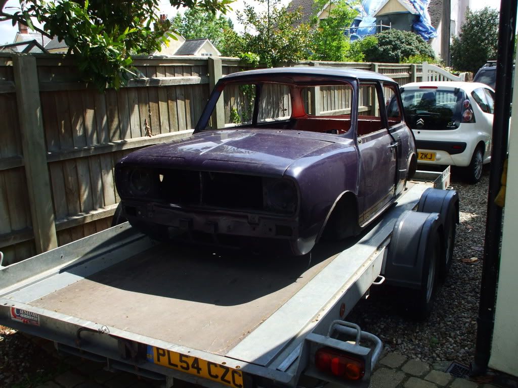

so its all started with my nans 1275 GT.
and then the dirty engine.... ran lovely though!!
it was brought by my nan in 1972 and my dad has serviced it its whole life ( including one re build) so we knew the score on most of the bits XD always handy
and then i got it apart and a bit of this happened....
and this....
and then this...
then....
and now!!!
:D love it

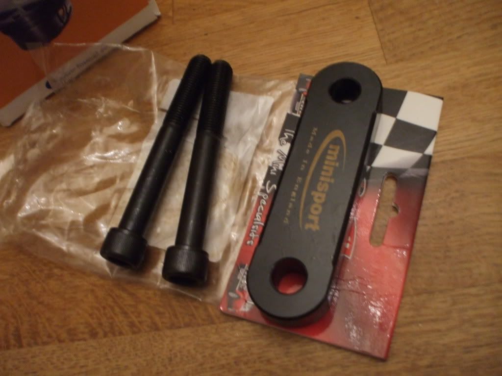

center main strap by minisport

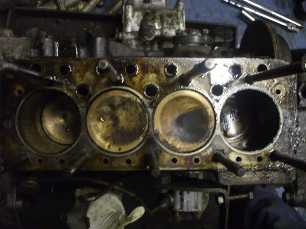

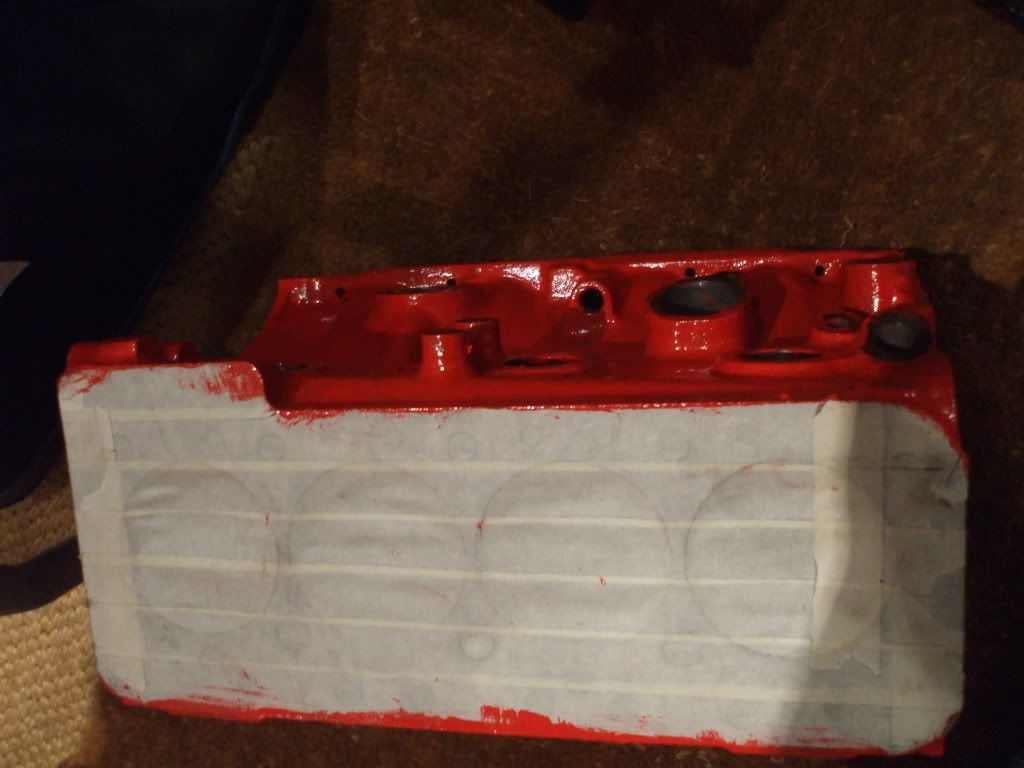

so current affairs are. block been honed, crank ground and new pistons brought. i have painted the block and will be giving the last coat tomorrow. then will be building the short block in a weeks time:)
pictures!
.. head off. near 100000 miles Posted Image

pre- pulling apart
honed and painted!

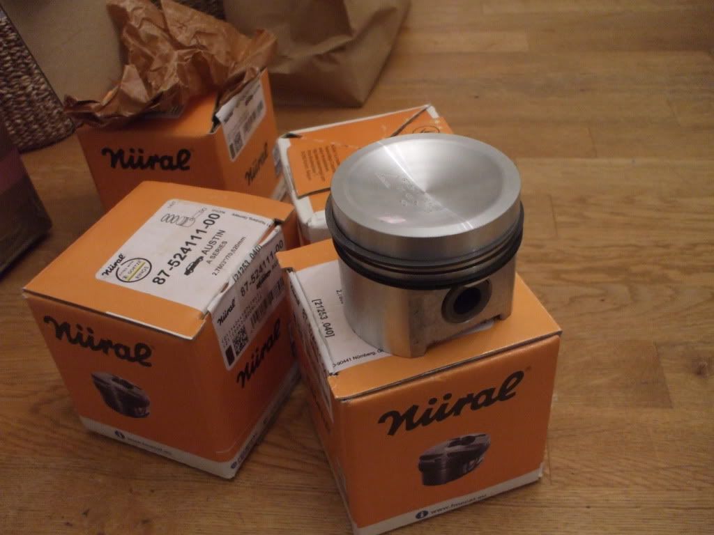

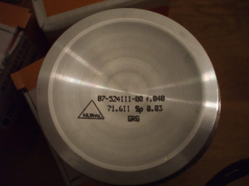

the new high comp pistons ( minisport)
i didnt know muriel made pistons!!! what a lady! :D

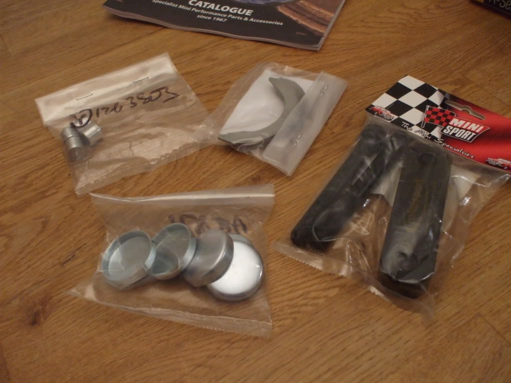

bits with them Posted Image

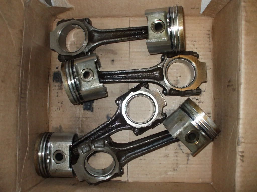

oh.... and old pistons for sale.
not con rods. + 40 thou. PM me if interested :D

looks great :D thou i think if it was painted and ended up looking like
that it would be so much cooler ;)

hahaha ultimate rat look :) noo full colour is the only way :P

Very nice colour and that garage window is awesome!

Are the arches "bullet" arches ?
If so what rubber trim did you use, they look very neat!
Oh and the garage, I would love that!

and no they are group 5 arches from minisport. but i think they are very similar. and the rubber strip you can buy off them, couple of quid job done, does the whole car and any other little bits of edge left bare paint :D done me well

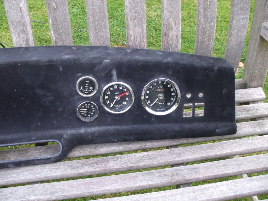

i finished cutting holes in a piece of glass fibre!!!!
new minisport flocked dash i have, modified to hold old dials instead of the electronic dials as put in bogus 2.
white markings is just the glassfibre, it can be hoovered off :P but the problem now is... IM ALL ITCHY!!!!!!! shoulda worn a jumper... oh well man up i guess

like the dash :D thou having a speedo that went up to 120 in my mini would be optimistic :lol:

hopefully it wont be in this ;P i think that the top end isnt going to get too many cobwebs on it ;D
