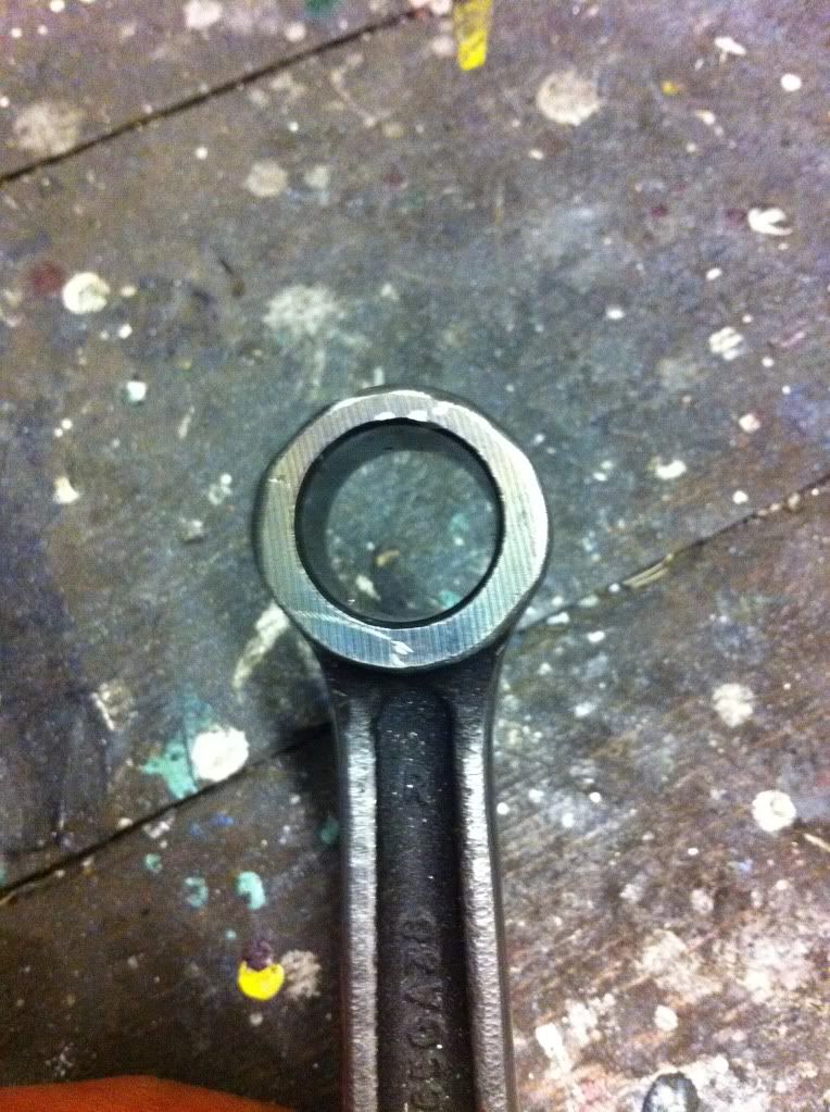

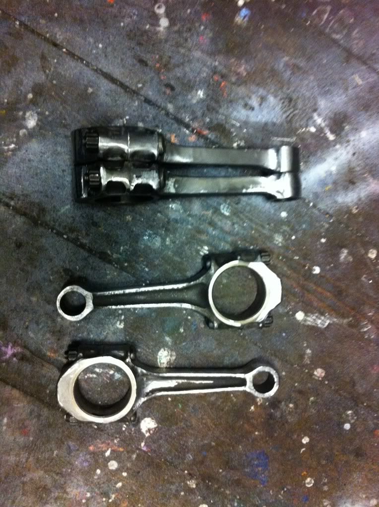

anyway. today i got the grinder out and stuck a sanding disk on, i decided to lighten all of my con rods,
i have removed the seam running along the stem ( ?) of the rod either side, making them nearly flat and radius'd all of the edges. im going to get a mill on the caps next weel to get rid of the big chunky bit of metal sticking in the way. then radius and smooth that,
in the end it will look something like the lightened 1300 conrod int he 3rd edition david vizard book:)

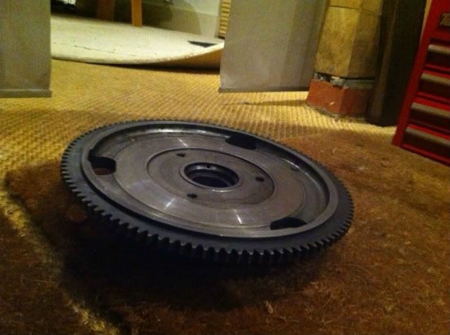

flywheel is still not back :( oh well.

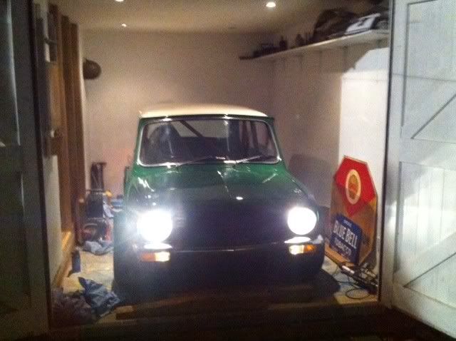

wiring wiring wiring. getting there, lights work under their own power now :D but nothing else XD more sorting out tomorrow and HOPEFULLY be able to get the dash in and see all of my pretty dials light up! yaay!

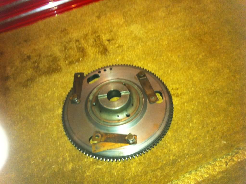

flywheels back!! looks wiked, he has taken 100 thou off the face and removed the back block'y thing. also, with the wiring, i have managed to get a main positive feed through the car and up to my battery cut off switch ect and have now got switches!!! i got main, dip, side lights, indicators and windscreen wipers!! love the tick tock sound with the wipers, i rekon i could make a song out of it :D
anyway, pics of the flywheel and illuminations!

well, here are me con rods! lightened and removed all of the sharp edges.

how did you lighten then con rods? did you just grab a grinder and smooth them out, but obviously not in a aggressive way :lol:
#44 Artful Dodger
Artful Dodger
    " I AM THE SPECIAL ONE"
  • 4,435 posts
Posted 16 November 2011 - 07:13 PM
yup, took off all of the rough and smoothed it all out. in D.V book 8)

but, i got the crank and flywheel assembly together and balanced by iva searle. also started to mark out the markings for an 11 stud head. fun stuff. il be documenting this and taking pictures of all my progress, as i havnt had a real camera to do it with yet!!! damn.
