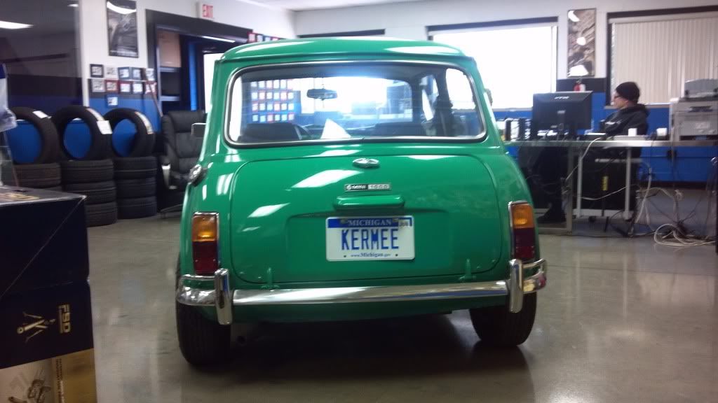

I just noticed My mini doesn't have reverse/back up lights. How hard would it be to fix this?

You should still have the wiring there, check the wires in the boot..and fit whatever reversing light you're allowed to fit in the US, i would go for one like these:

They are Mk3 rear lights, to replace them with later ones is just a bolt on job. You may have to fit a switch to the selector and add some wiring if they are the original lights.
Alternatively you could add an accessory light, a driving lamp to the boot for a bit of retro style, or have a look at Stevede's LED abundant restoration thread. Check your local lighting regulations though.

Thanks, that's kind of what i was thinking. if it didn't have the wiring i was gonna hook a toggle switch and run a rear Spotlight. They are pretty laxed here so I can probably use one from my motorcycle parts bin.
