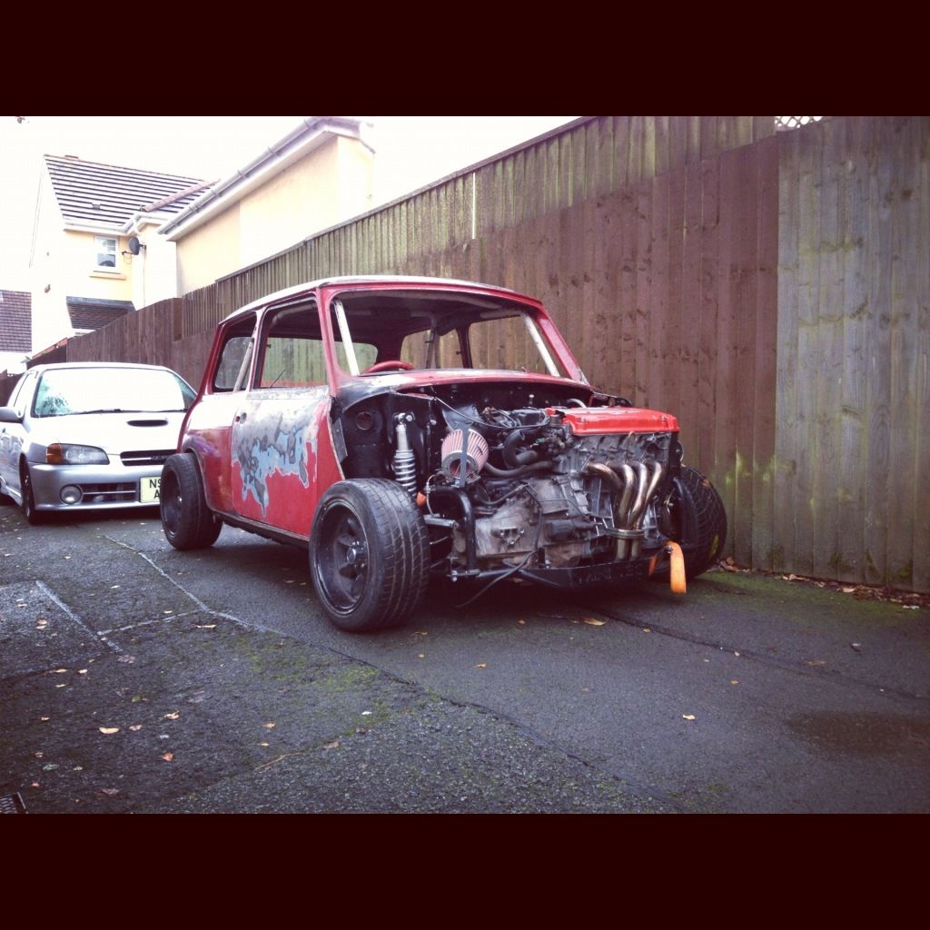

And the pick that Mr kieran B was on about on instergram just the mini and the glanza chilling lol
