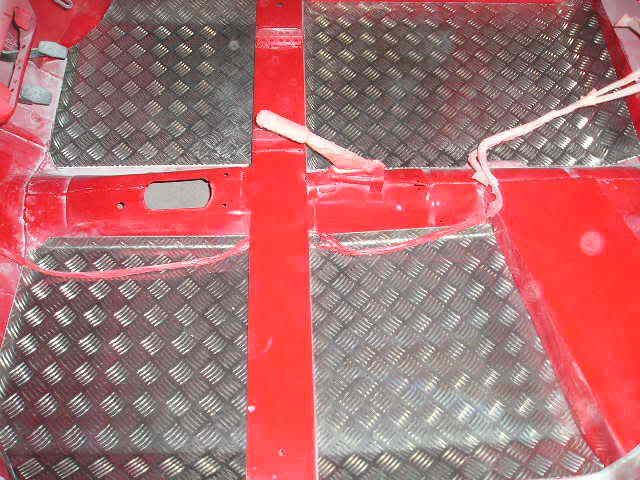

well then re-done the floor pan i'd bent wrong
on Friday, at work today. had to take up the nearside pan
behind the cross member as one of the folds was too
severe, had to reduce using the vice. Bonded in the
replacement floor pan. All done now ;D
Just got to re fit the brake /fuel pipes and battery cable
now.
all the floor pans in situ.

The chequerplate looks fab dude,is it quite thick?What did you use to bond it to the floor?
#795 camp freddy
camp freddy
  • 3,696 posts
Posted 18 July 2008 - 03:31 PM
It's 3mm thick (not including the thickness of the bars), bonded it on with some
polyester adhesive we use at work (carriage builders)
