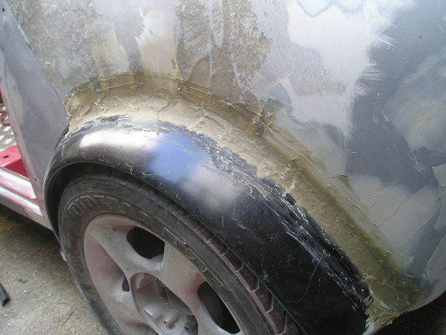

i've used a sander to remove the gell coat and leave a rough surface, i've used
'Wurth' fibre filler (miles better than P40) to fill in the cuts and build up the
sanded area... then i'll fill with polyester filler..

Well been out this afternoon, glassed up the outside of the
wings, shape now pretty good. I then had to swap the tyres on one side
of the min as the tyre hights were slightly different. screwed the
arches in place , then i lifted the front and glassed the arches to the
front end from underneath, tomorrow i'll sand off the gell coat around
the arches and front then glass them together...

#825 camp freddy
camp freddy
  • 3,696 posts
Posted 19 August 2008 - 09:01 PM
couple of pics
arch glassed
wing filled
