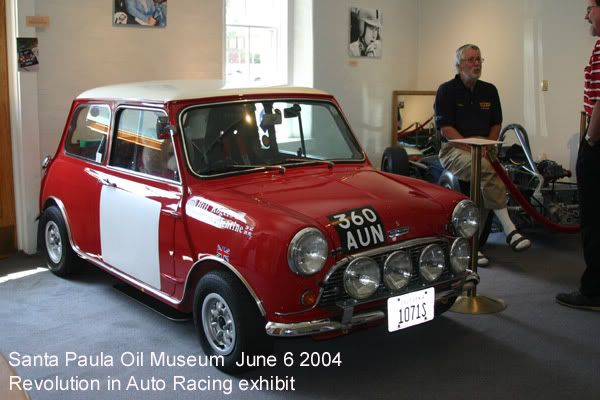

I've built a few 1071 'S' engines. Very smooth compared to the 1275.
The last one I built for a car of mine had a 649 cam, MiniSport race head, LCB, Twin H4 carbs, Aldon dizzy, 11:1 C.R., etc.
It won its class on the Belgian Historic International Rally and got 7th overall. My great buddy Bill who lives in Los Angeles now owns the car. Here it is:
Looks fantastic, reminds me of my Mk1. This is what I am aiming for (but of course it will have wind up windows).
