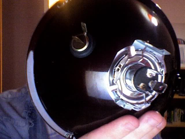

It's fairly simple to do, the kit is basically just a couple of glass bowl units with two holes in the back of each, for a standard H4 headlamp bulb and a separate side lamp bulb. It's a direct replacement, so you should just take the sealed beams out and fit the conversion units in place of them. As I recall, the only real modification needed, is to detach the side lamp wiring from the electrical connectors that fit onto the back of the sealed beam units and crimp a couple of terminals onto the wires. The side lamps on the new conversion lamps are separate to the headlamps (see pic below), whereas they are integral on the sealed beams.
Some people also connect the new lamps via relays, as the halogen lamps tend to draw more power than standard sealed beams do and can therefore melt the switch and wiring. As I understand it though, this shouldn't be an issue so long as you don't fit halogen bulbs with a higher wattage than the original sealed beams had.
