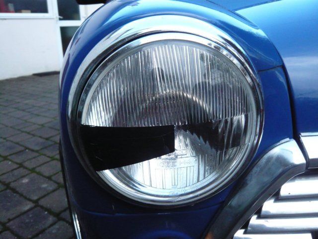

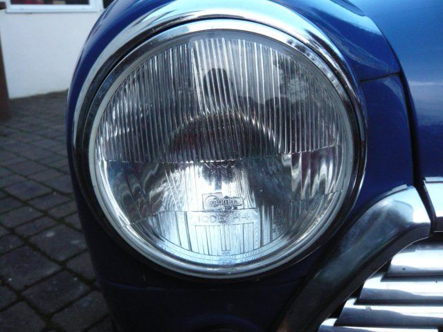

As promised.
Took about 30 seconds with a few pence worth of tape and a blade
NB Like all advice on here, you need to confirm for yourself, on your lights, that this cuts the (nearside in UK) problem bit of dipped beam off. I use a white garage door for this purpose
Minder - those yellow things just change the colour of the beam I think. France did away with yellow headlights 10+ years ago.
Edited by govig, 05 March 2012 - 10:23 AM.
