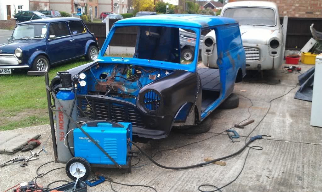

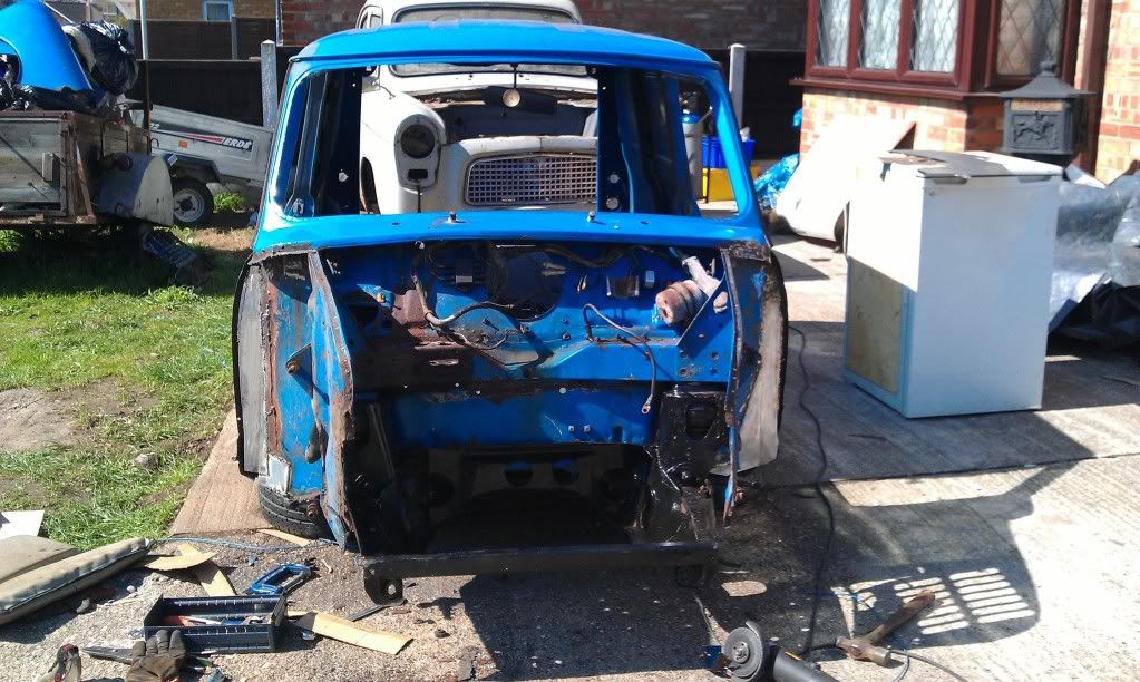

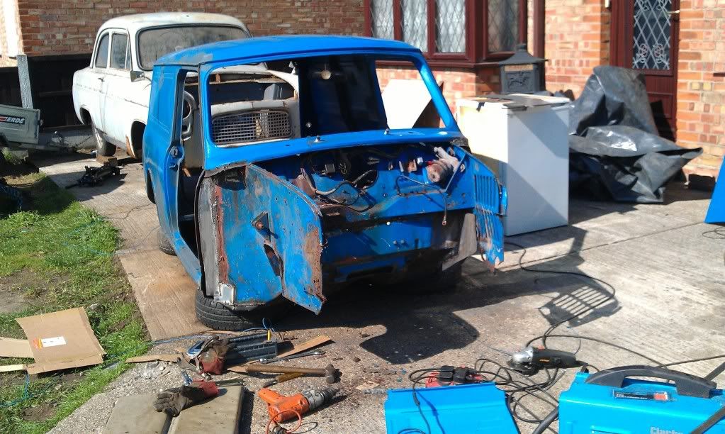

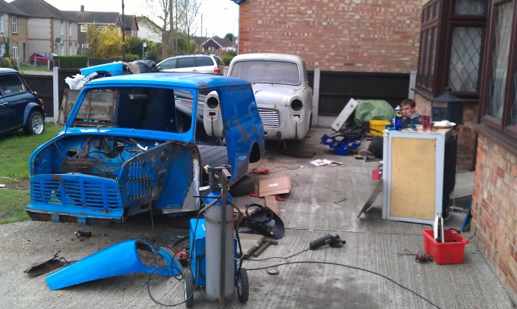

Started off like this:
Going Going
Gone

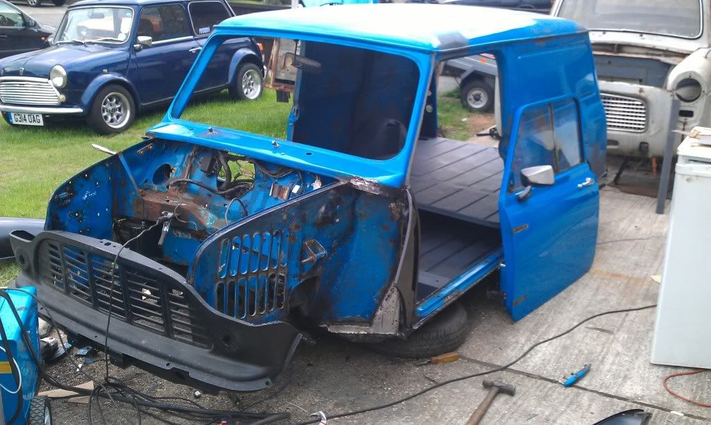

Then bolted subframe on for a guide
And then end of the day i had both inner a panels on and lined up for the hinges and front panel ready to go once the wings are lined up
Front end should be complete by end of tomorrow. As long as i don't run out of gas :s

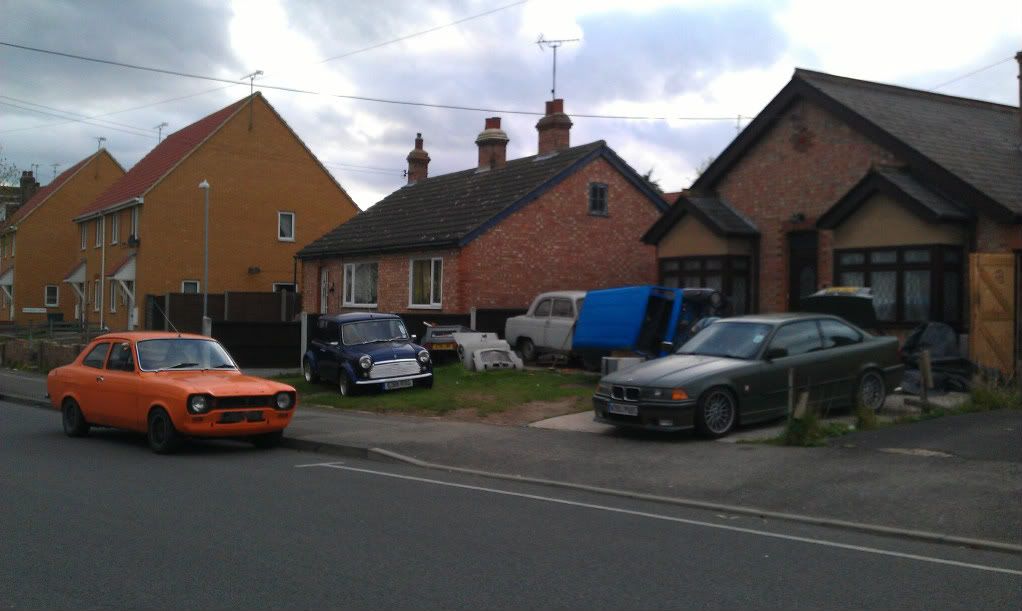

Lined up the bonnet to but no pic of that although i took this. My mate came over in the afternoon and i ended up helping him with a few bits but i love how our drive has evolved. I slightly surprised none of the neighbours have said anything yet.

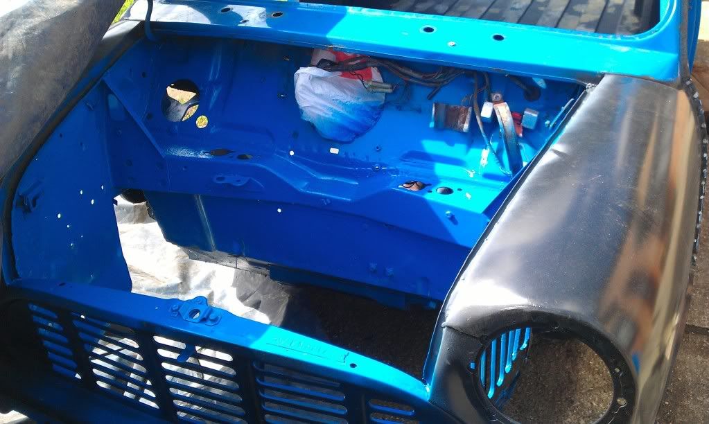

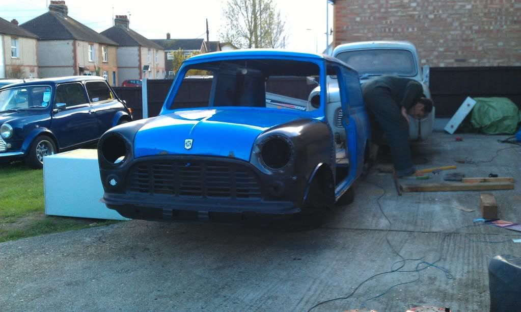

Found the picture of the bonnet line. Given me a massive boost today seeing this. The finish is in site now :).

Brilliant garden ornaments by the way. Love it.
#44
Posted 10 April 2012 - 04:14 PM
Your flying along!
Looking good, mini vans are so cool.
What the old freezer?
Painted to just behind the subframe bolts. You won't see this anyway when the carpets in :)
I do really like the fresh paint its a good match but the old stuff does look 32 years old.

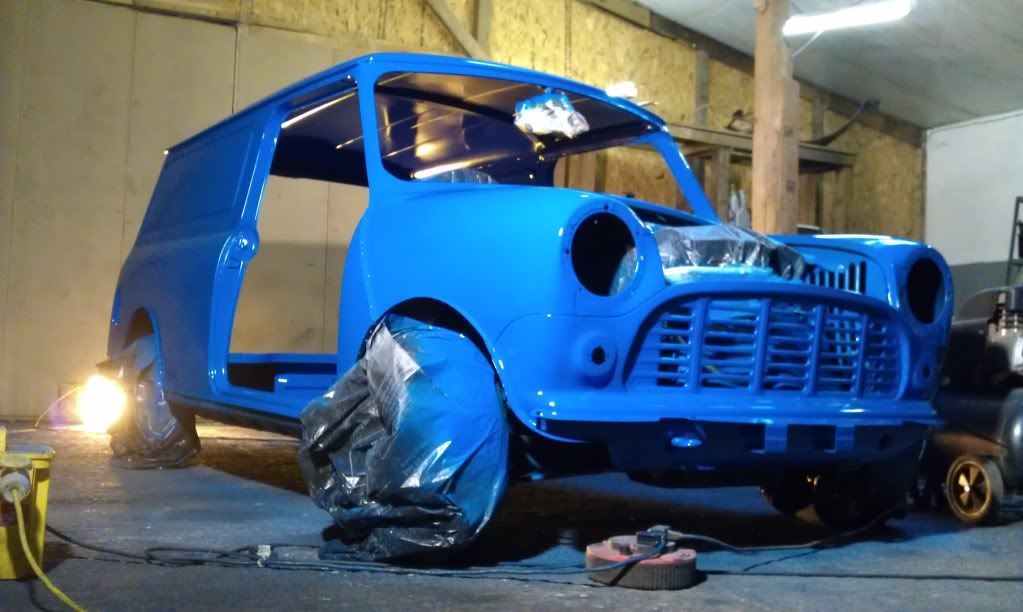

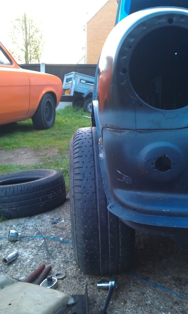

I've made a boo boo with the brakes and underestimated the amount the standard wheels would stick out. Basically the discs add an extra 2" on the track i.e. 1" each side which is too much to get away without arches. So Bolted my spare 10x6 on and am now getting some group 2's which should just cover.
This is how much the 10x6 stick out
So all brakes and suspension components are in, just need a master and i can bleed them.

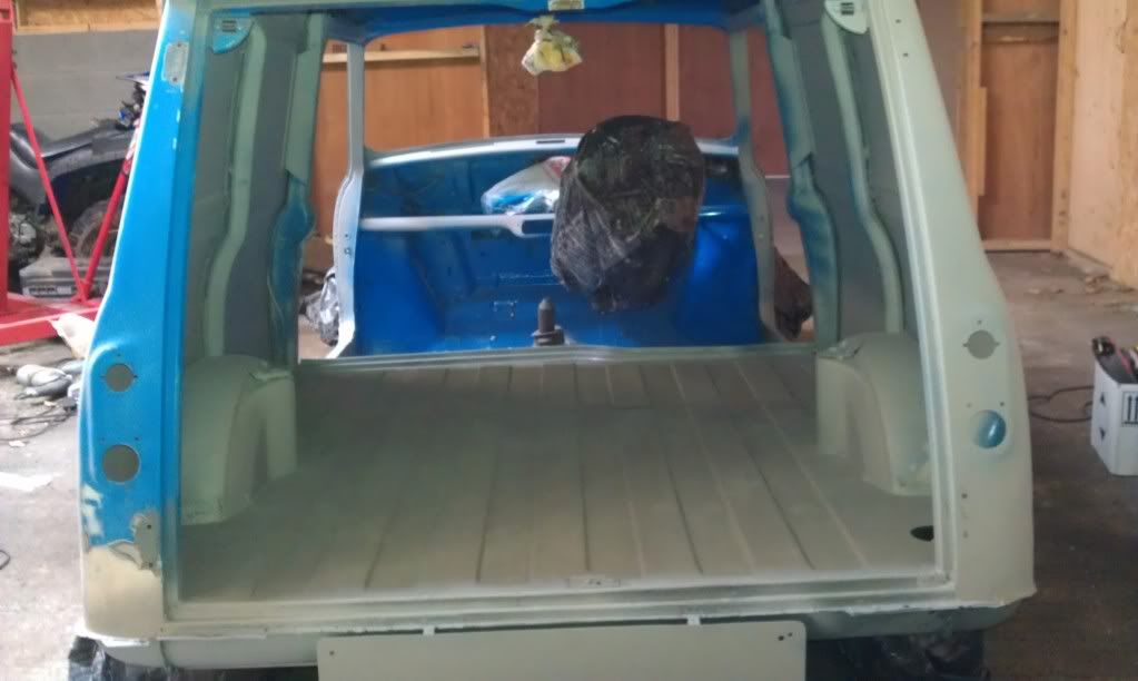

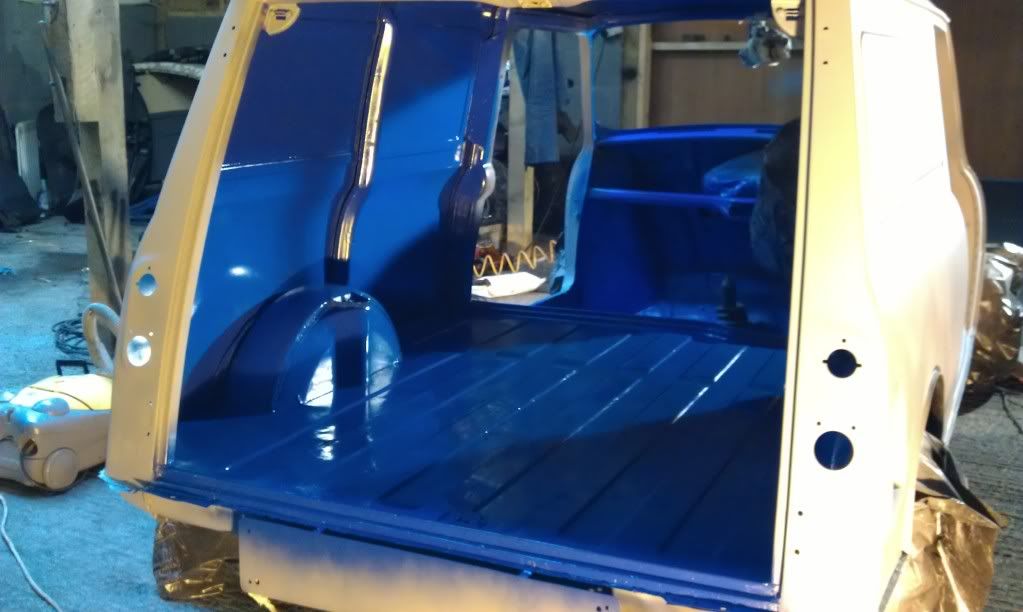

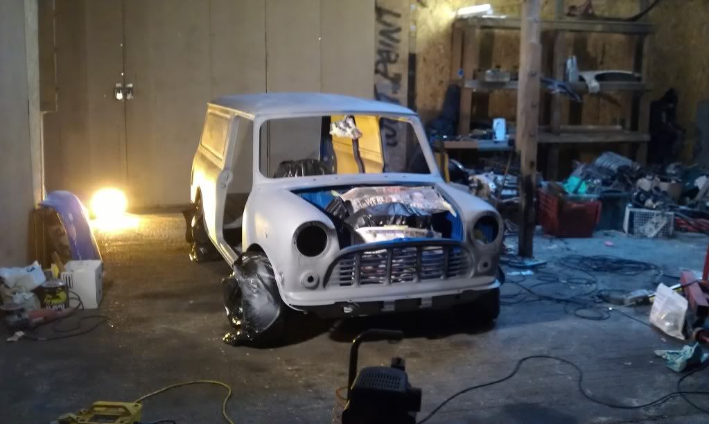

I then moved SMEGie down my mates lockup and prepped for paint and banged some primer on.

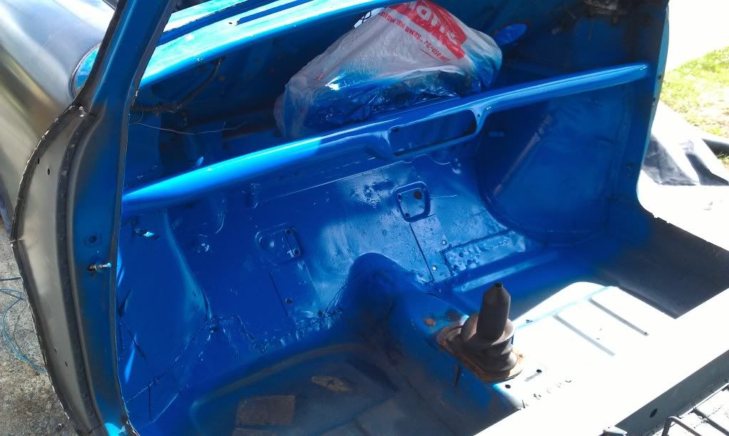

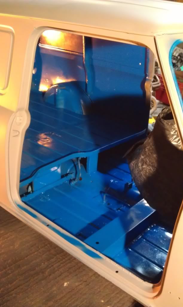

Alittle bit more fettling and painted the inside Pagent Blue
Which came out mint so on with the colour
This is with 6 coats. The plan is now to fine sand that (a few runs and dust), prep and spray the doors then bolt them on and go over the whole thing again to finish it off.
Then its just the simple task of bolting the whole thing together, MOT and taxing it in 3 weeks. Sound possible
