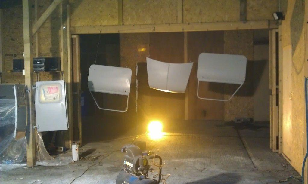

With the inside though how did you go about it I ask.
Did you sand it all down with differing grades of paper or just spray the primer over the old paint then put the top coat on?

Thanks for the offer of help. Its still touch and go whether or not i'll make it. I'm still doing everything properly i'm just making sure i'm as organised as possible. This is the first complete rebuild, i have done a partial rebuild inc. sills, a panels and floor pans on my old clubman. I've also rebuild my mk1 escort which had its fair share of rot but having the right tools makes everything alot easier. A mig welder with a big bottle of gas, spot weld drill, i've also got 2 grinders one for cutting the other set with flap discs all make the job that much easier.
Also with regards to the inside, i've borrowed a really good orbit sander and just rubbed the whole lot down with 240 grit, filled all the little holes in the load bed with filler, flatted that back with 120grit then 240. Primed it all used stopper in the little holes and then just blew it over with a few coats. I'm definately one of those if you can't see it when its built then don't bother getting it perfect kinda guys. Waste of time in my opinion :).

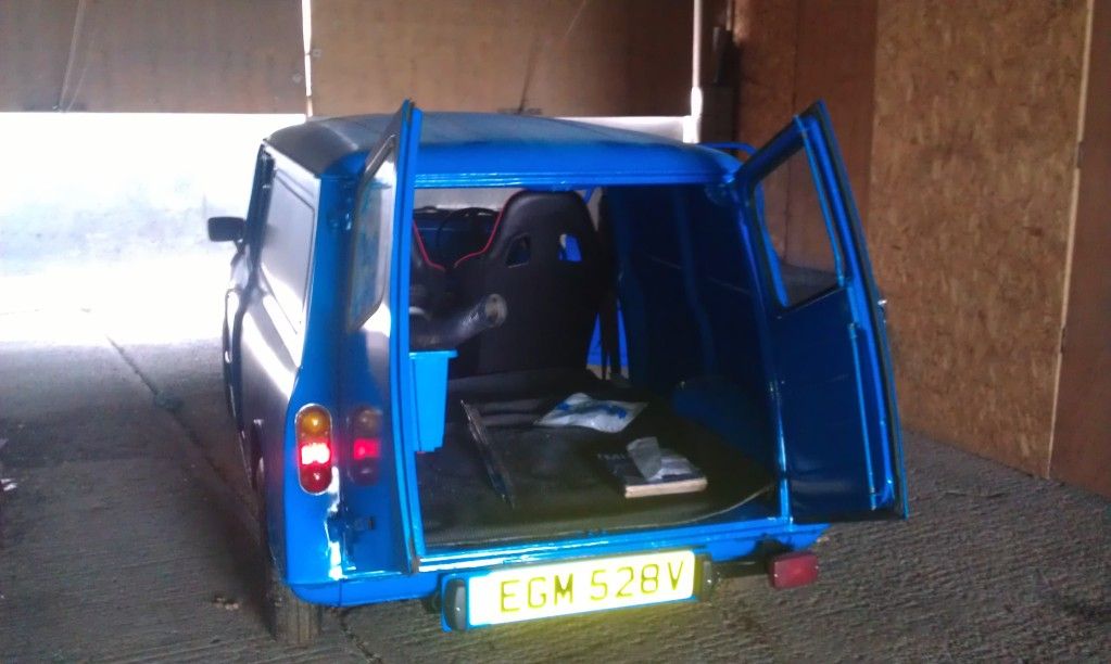

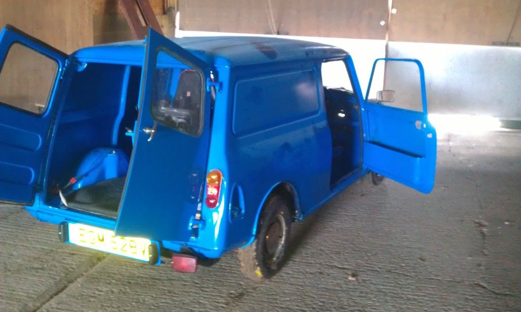

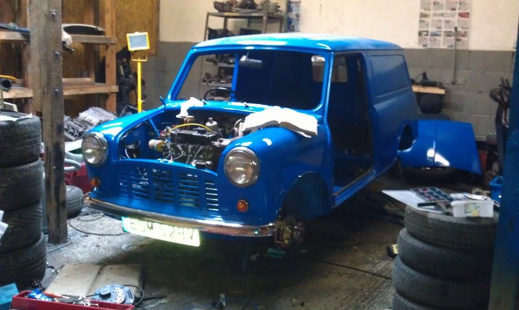

Right been busting my gut over the last couple of weeks and trying to get the van up and running for l2b. Havn't taken many pictures like usual as its the last thing on my mind but you get the idea :)

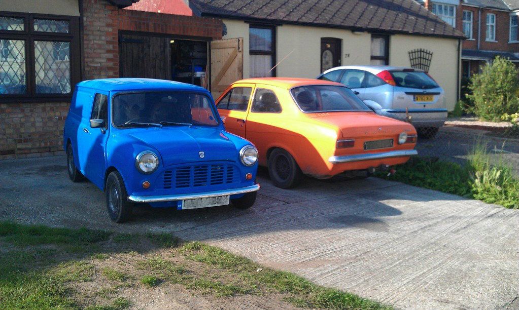

Then finally got the van running on sunday with all electrics working so loaded it up with the lockup stuff and brought it home.
And finally back home with his buddy
Just got to sort out a few small issues like the doors not fitting, headlining and a few leaks but mot some time this week and then tax and i'll be on my way to brighton. Even found a spare ticket so should be all good :).
