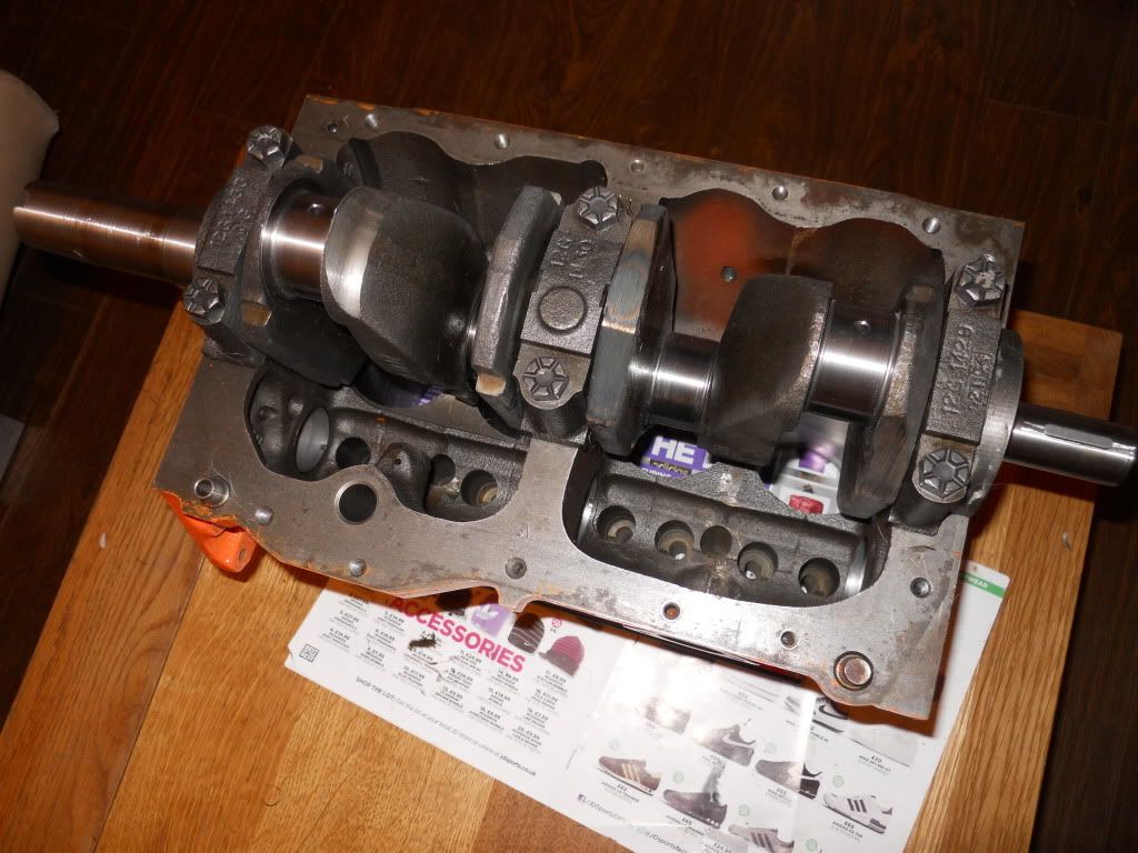

Posted Image crank installed along with new mains and thrust washers, also fitted piston rings to pistons along with new big ends ready to fit to crank and block another night

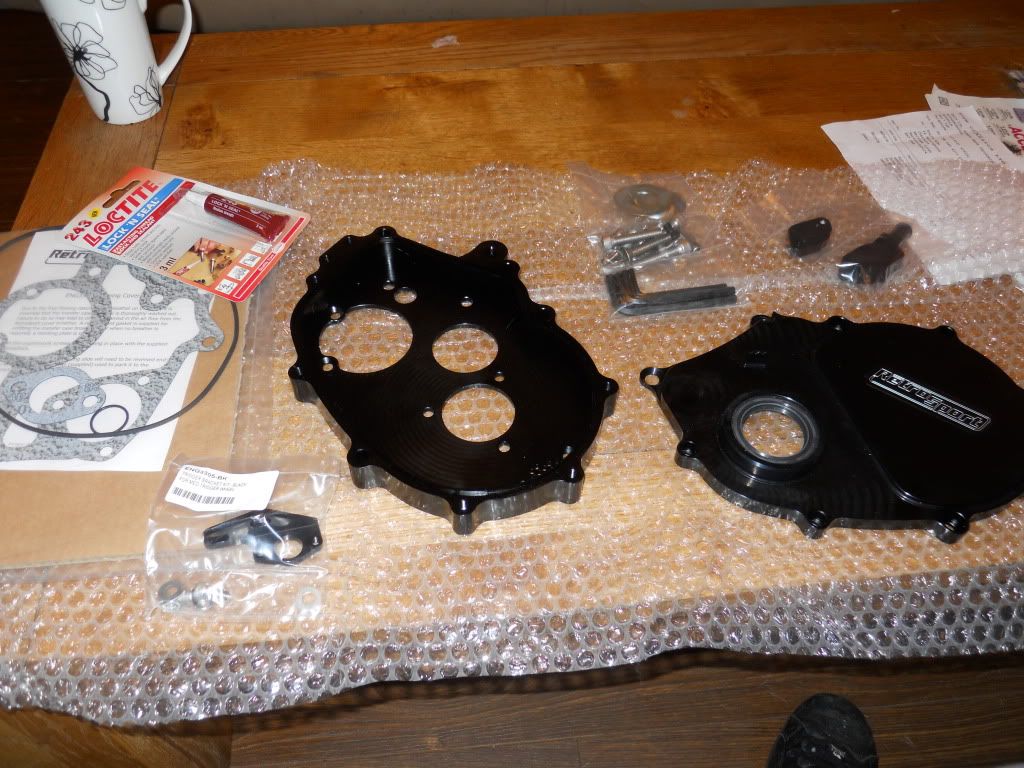

dsn classics timing cover kit with trigger bracket for med setup (which will be ordered soon)

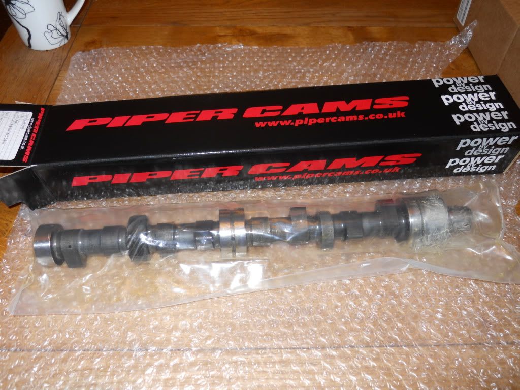

avr classics phase 2 turbo camshaft, only the camshaft was sent out so im still waiting for the rest of the kit, once that turns up i can get this engine together

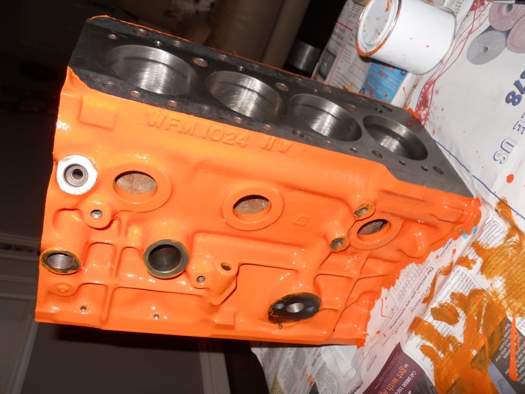

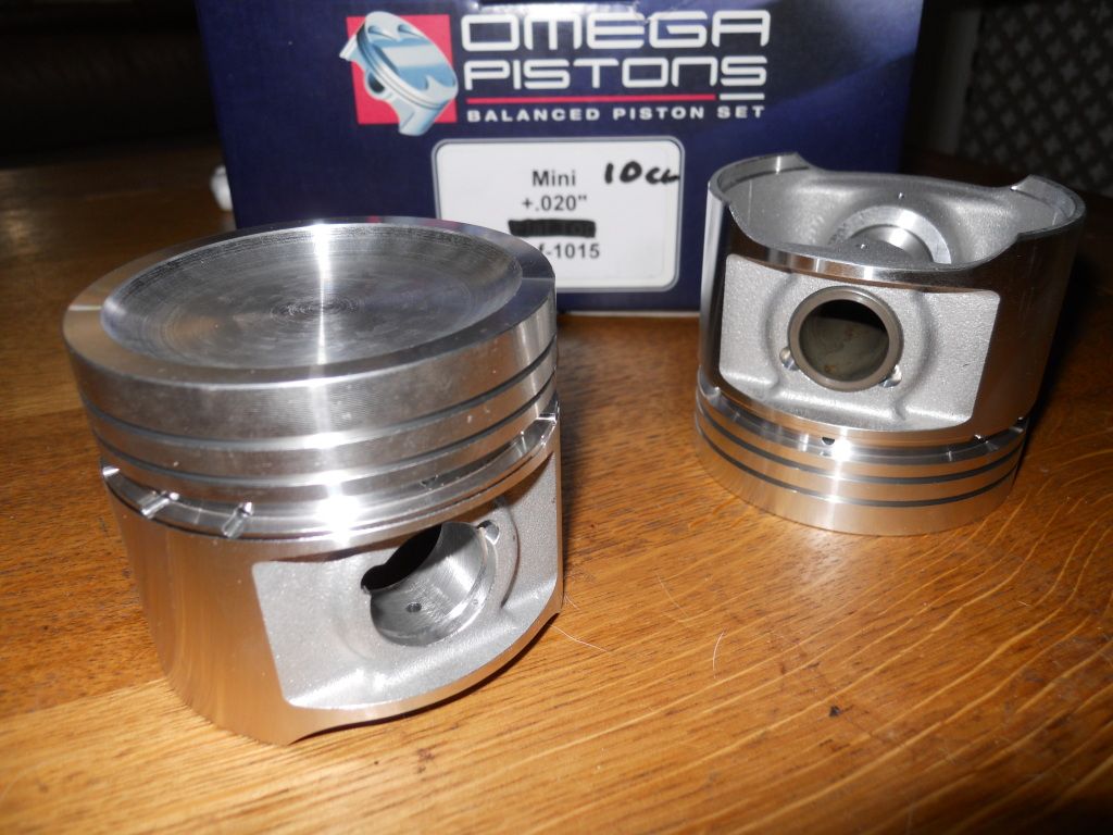

no progress due to a bit of a problem with piston rings
turns out the piston rings supplied were faulty, the oil control ring would not close enough to fit in the bore, the spring being the issue, took them back to minspares and they've been made aware of the issue, and said they will return them to the manufacturer
so i've dicided to get the block bored 20 thou to 1293cc and go down the route of new omega pistons etc, sorting everything in next couple of days and hopefully start getting this engine together next week, this time without issues hopefully

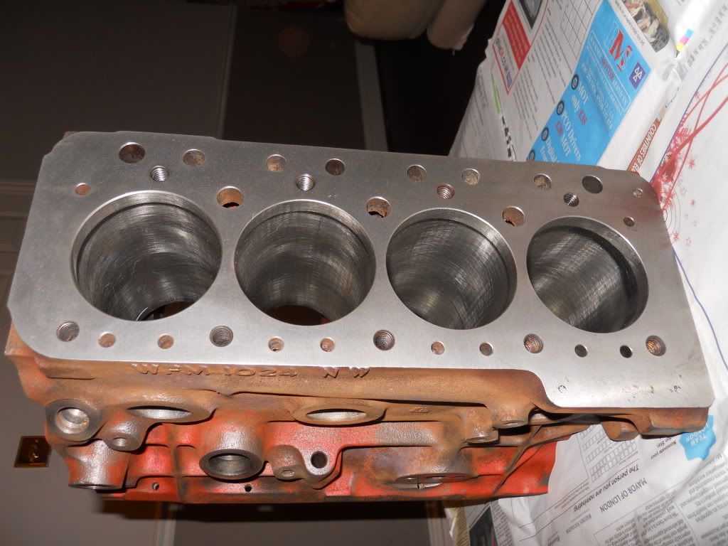

block has now been sent off for boring out, so just got to wait and see how much its gets bored before ordering my pistons

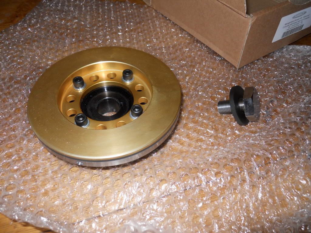

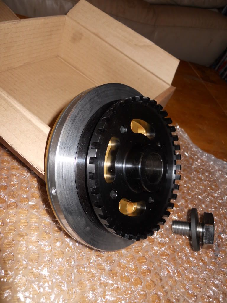

in the mean time my new med pulley with trigger wheel turned up

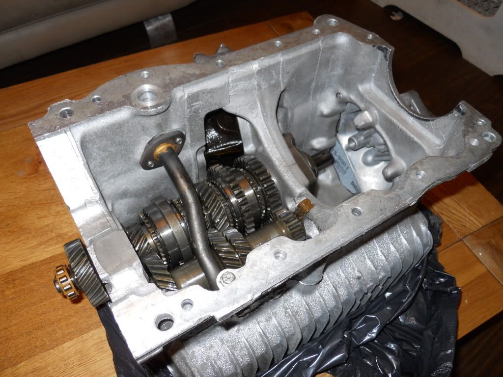

while i had a day free i popped over to ml motorsport and exchanged an old mpi gearbox i had sitting about (was crunching in 2nd) for a nice shiny working one
obviously the mpi box had the 2.7 final drive so i went for a 3.1 final drive instead, my spi has a 3.2 and i find thats nearly perfect for motorway use plus it doesnt feel like it lacking low down so i thought the 3.1 was a safe bet with the turbo engine
i will be swapping the diff out for the minispares cross pin diff i already have, just need to sort out the speedo drive on it to match my needs, and of course central oil pick up will be fitted

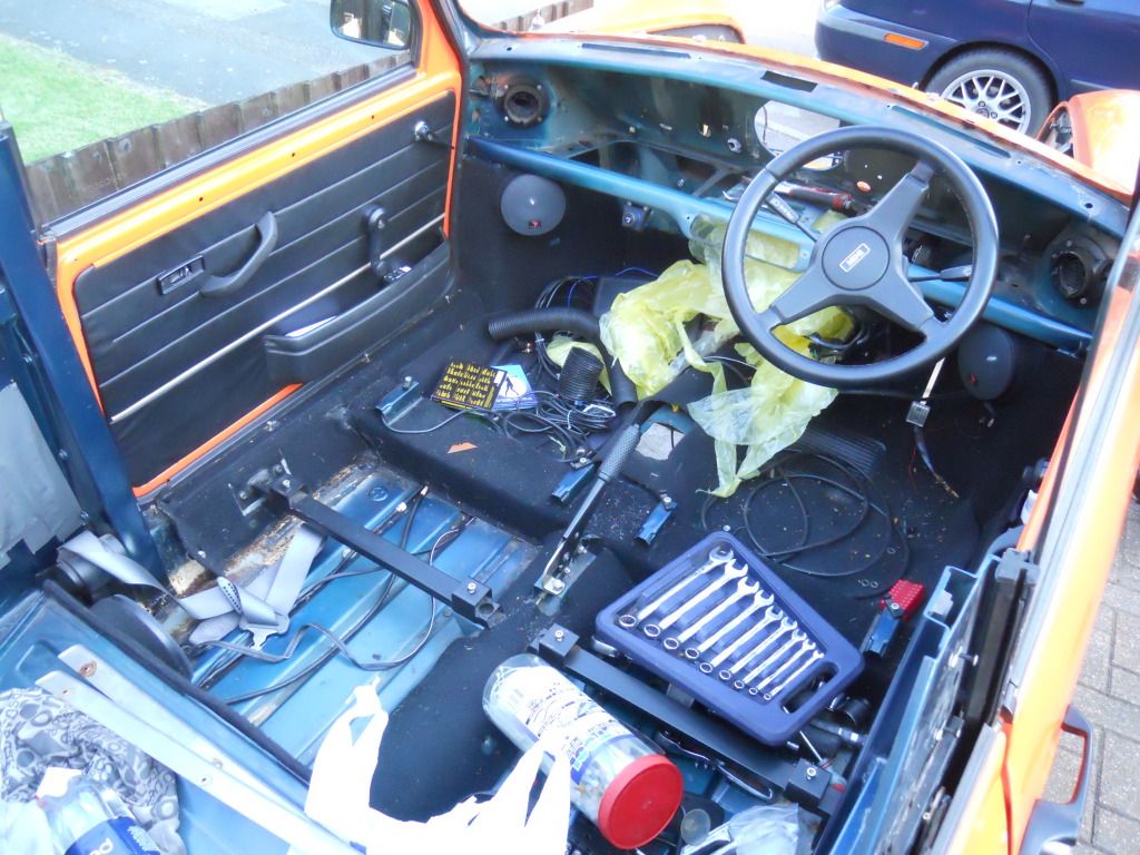

Posted 25 May 2012 - 09:29 PM
well l2b is now out the way, the car performed mechanically perfect, but from crystal palace to brighton my indicators wouldnt work, oh well new loom will be fitted so i can forget about all that

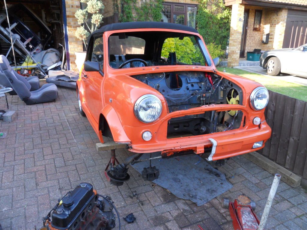

engine is now back from being bored, its been bored 20 thou to 1293cc, also purchased some omega cast pistons with a 10cc dish to suit the application :proud:

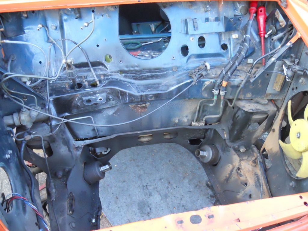

then while the weathers been good i've removed quite a few bits from the car ready for some paintwork to be done in just over a week, gives me time to get the subframe out and prep some bits up

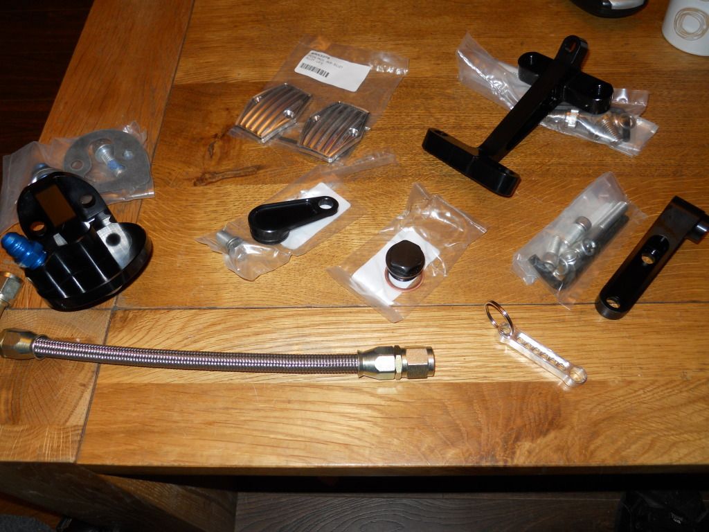

and afew shiny bits i bought from dsn classics while at brighton, including one of their new verto slave cylinder brackets, plus i got a free keyring :D
