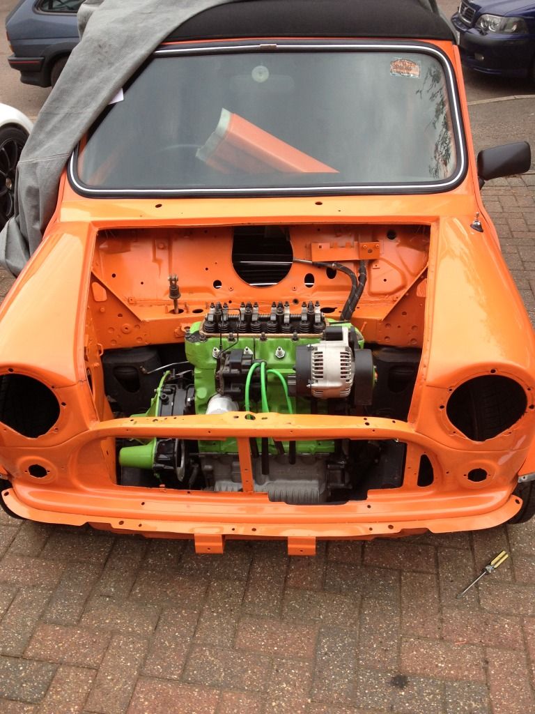

so new windscreen fitted as the laminate on the old one was going milky and the chrome locking strip was turning clear, looks alot better now
also engine in, but not after some trouble with the mounts, the mg rover ones are complete poop, made it impossible to line up the holes and also one actually fell apart, cant imagine how long it would have lasted when actually in road use. so solution......new non gen mounts, engine slipped right in and the rubber was actually better quality, who'd of thought it
also fitted the sideskirts and front arches back in place, all seats and doorcards are back in, next fitting the wiring loom
well heres a quick pic

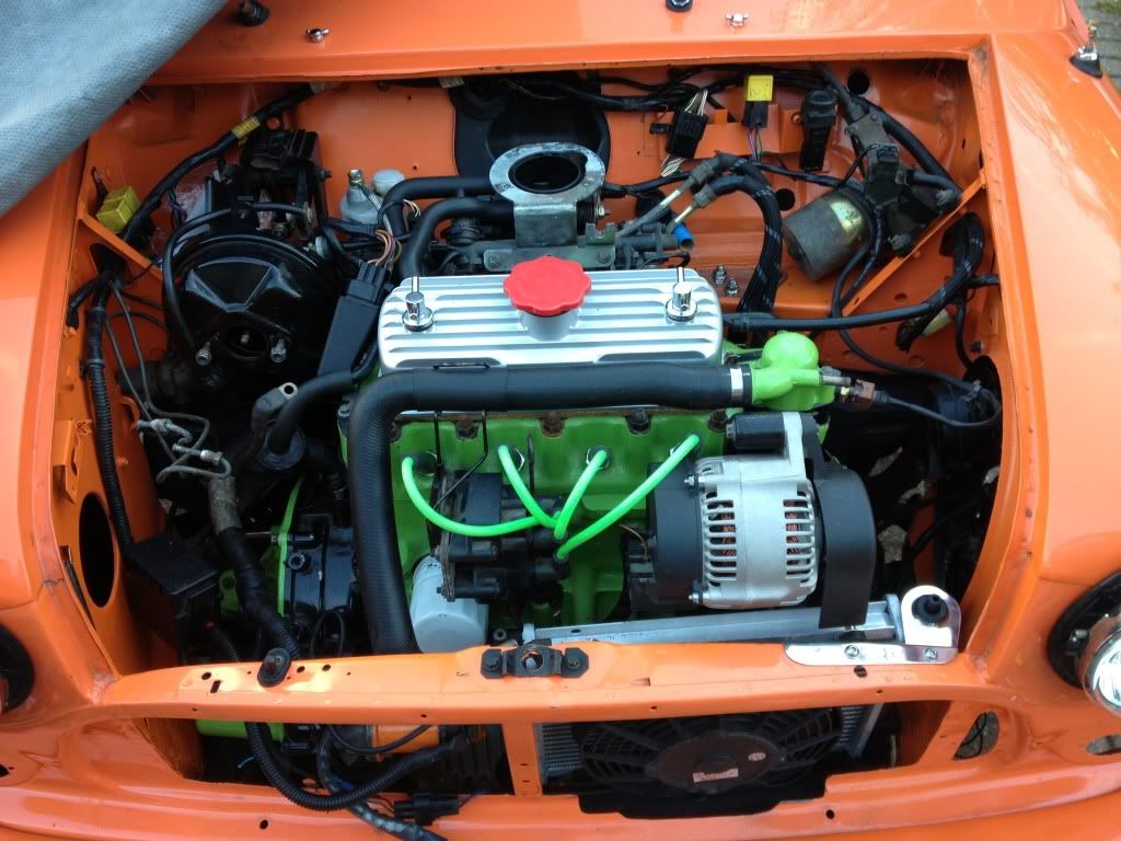

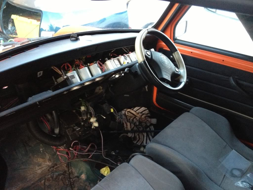

today i went about replacing the inner cv's, was just going to reboot the old ones but on closer inspection replacement of the whole joint is the better option, i only ended up managing the nearside today because i had to do it twice! basically i put it all together and realised i didnt put the oil seal in the output casing >_< losing my mind i think lol
anyway heres a few pics of how the car is at the mo, fitted newly painted caliper along with new pads and a flexi brake hose
full mpi steering wheel and column fitted and dashboard half wired
most of the loom plugged in, all ancillaries fitted just a few little bits and pieces to finish before starting it up for the first time :proud:
