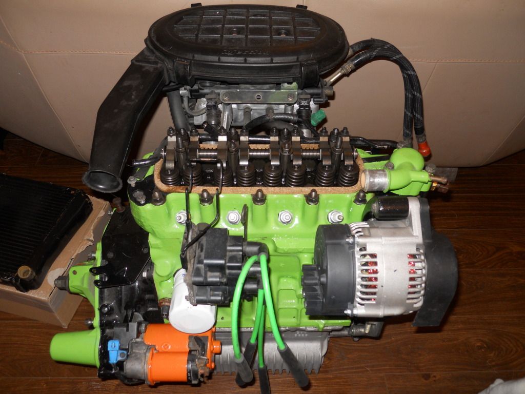

here's the new replacement engine to be fitted for the sale of the car
mpi engine with 37,000 original miles, stripped and checked, anything that needed doing was done, including a rebuilt gearbox and new clutch, plus a bit of go faster paint :D

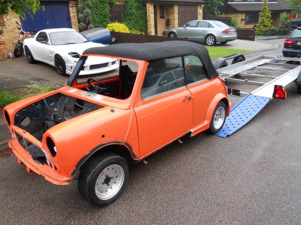

and will post up pics of the car before it goes to paint this week, basically front end and interior stripped, mpi subframe fitted along with all new bushes and mounts, brake calipers all painted up and new pads fitted. also for the mpi conversion the front panel had to be cut to clear the rad fan, also the slam/front panel strengthener had to be moved over
pics to follow shortly

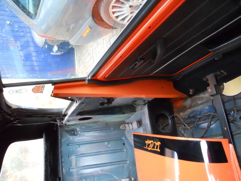

found a little bit of the scuttle that didnt look too good so cut and wleded a new piece in, also blanked off the lhd wiper holes while i was at it

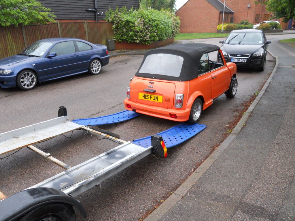

Posted 11 June 2012 - 05:34 PM
car is now at the paintshop :)
couple of pics before the she went, with her new super duper front ride height

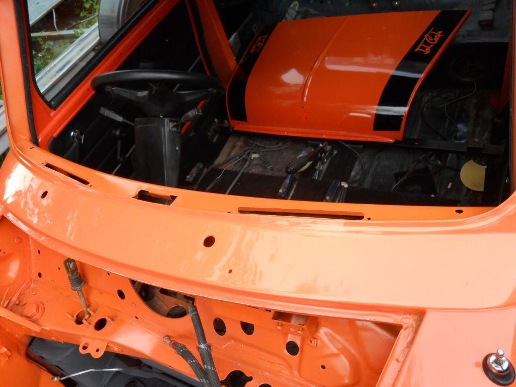

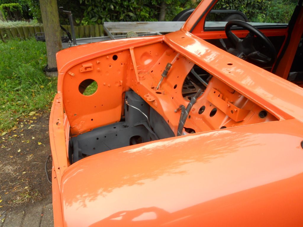

Posted 26 June 2012 - 11:08 PM

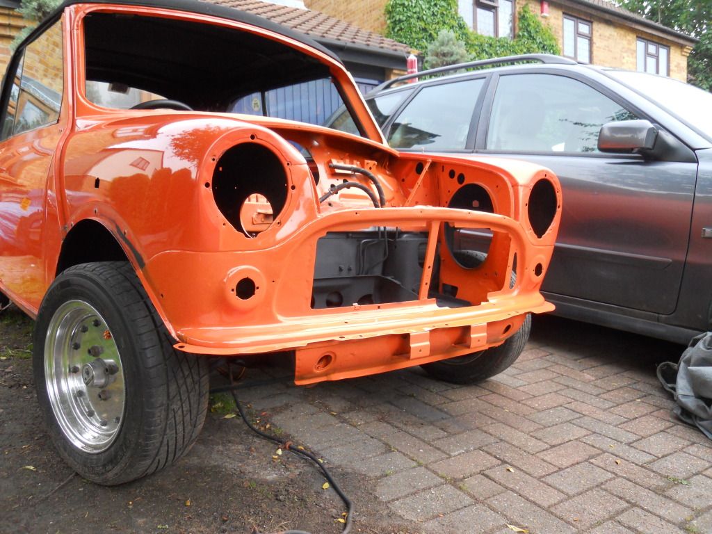

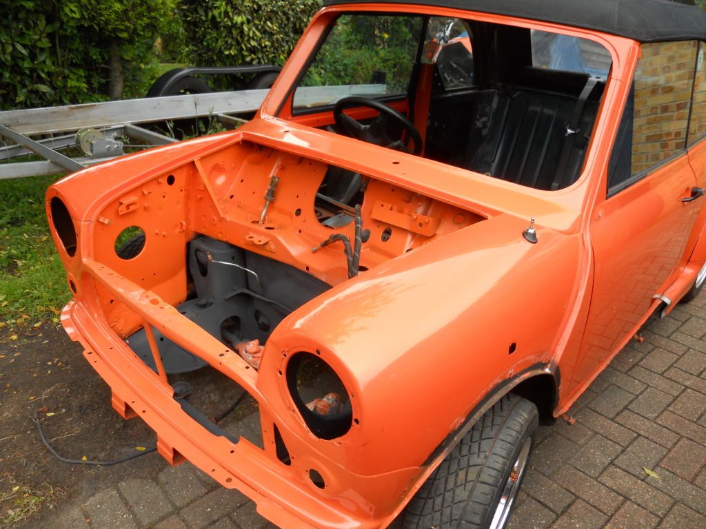

back from paintwork the other day, had the front panel, scuttle, engine bay, inner windscreen surround and b pillars done, came out quite nice apart from some overspray on the subframe but i've since repainted the affected areas, so here's the results
will start re-assembly tomorrow if the rain holds off long enough

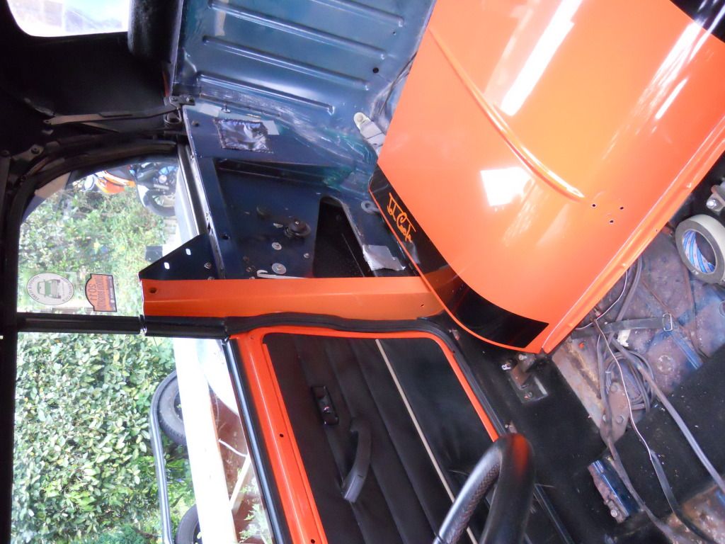

That's really interesting. I've never seen inside a genuine cabriolet shell before... Now I know what kind of reinforcement my Keith's Convertible's job SHOULD have in there! >_<
#30 Miniowner123
Miniowner123
  • 987 posts
  • Location: Brighton
Posted 27 June 2012 - 02:31 PM
lol yeah probably lots more than it actually has, i've not even put pictures up of the parcel shelf re-inforcement or the sills and flitch panels, also the windscreen surround is double skinned at the top and has a bar that goes round the inside then down each pillar and connects to the inner wings, alot of welding has gone into one of these, probably would explain the rediculous price when they was new
