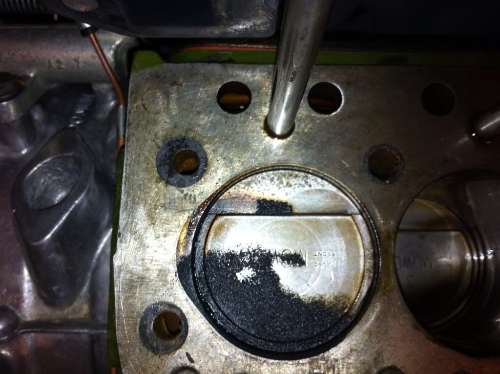

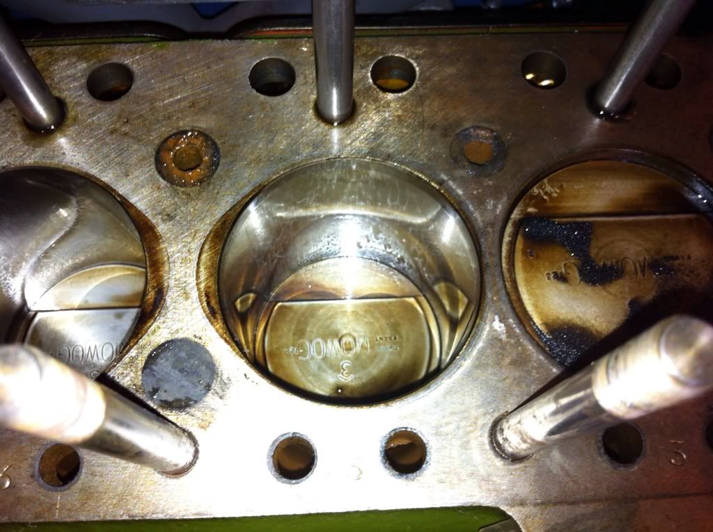

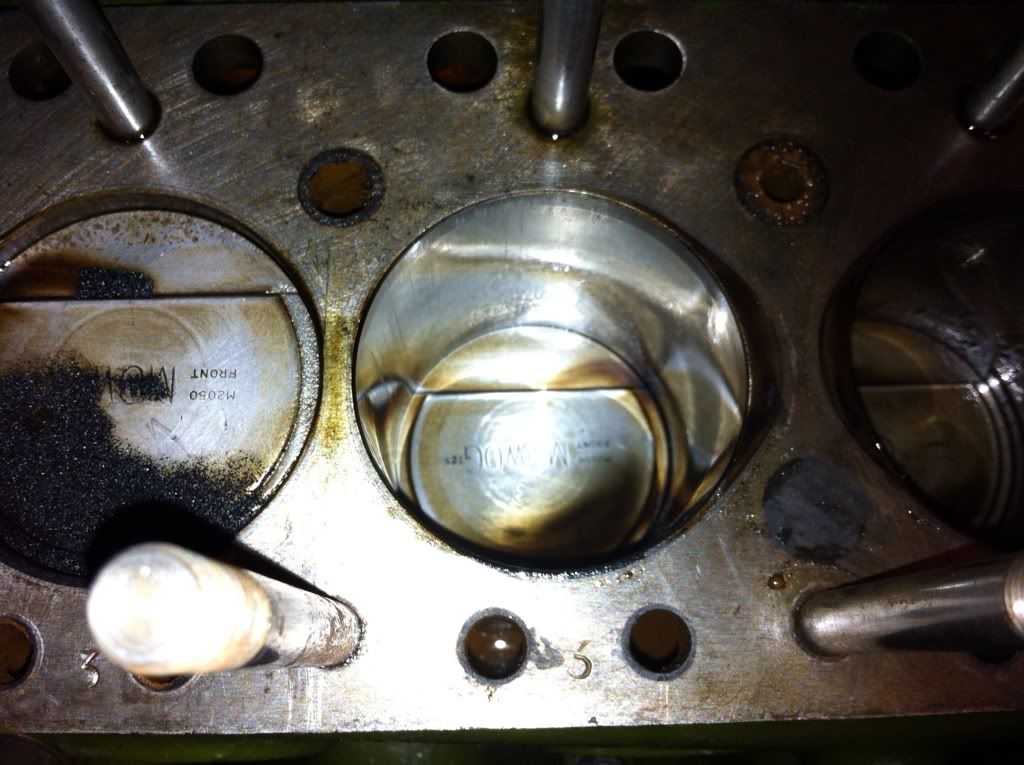

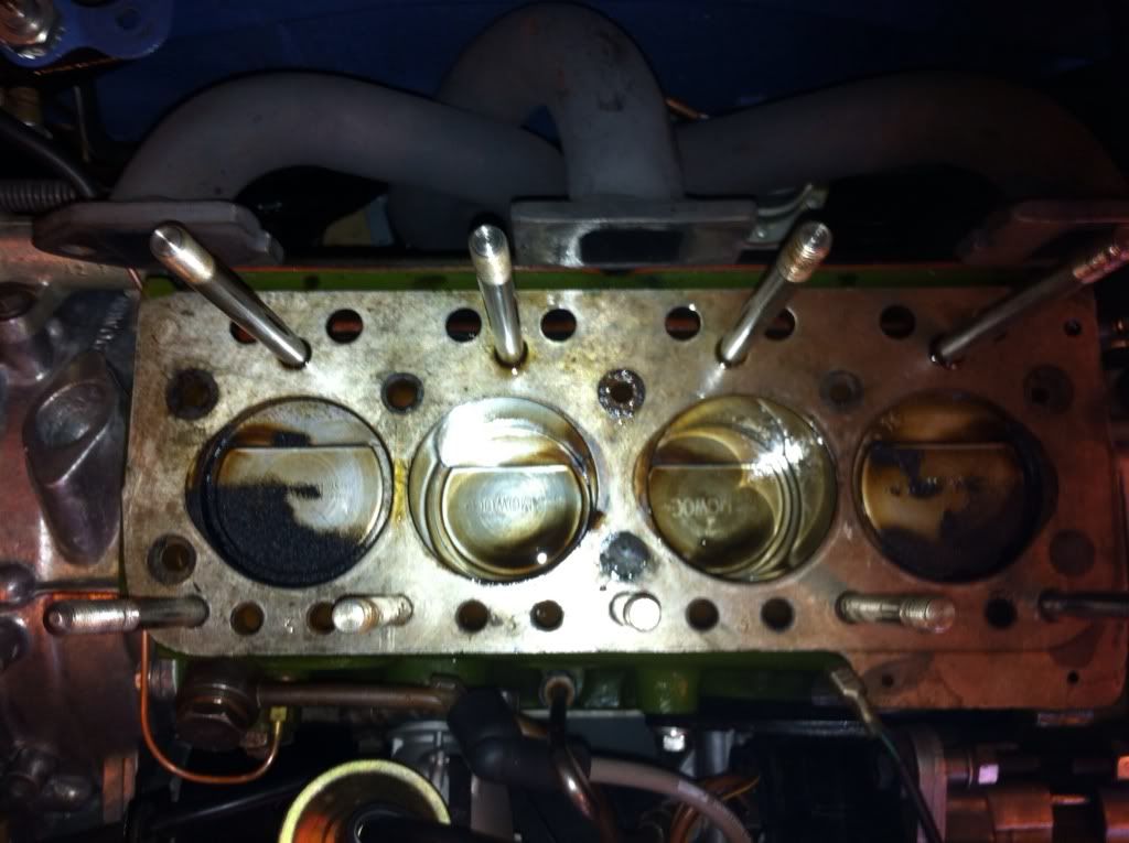

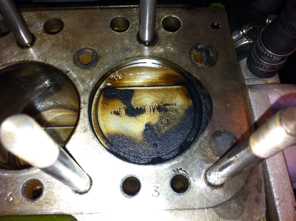

#22 MiniLuke
MiniLuke
  • 1,205 posts
Posted 17 June 2012 - 12:49 PM
Well, it was never going to sort itself...........
#23 oltonlad
oltonlad
  • 2,401 posts
  • Location: west midlands
Posted 17 June 2012 - 12:53 PM
those bores dont look as if they have been honed at all....i'm not surprised that the rings wouldn't seal, looks like a strip down job unfortunately.
#24 coopdog
coopdog
  • 4,506 posts
  • Location: South Wales
Posted 17 June 2012 - 01:13 PM
what would cause that?
#25 Ethel
Ethel
    ..is NOT a girl!
  • TMF Team
  • 26,074 posts
Posted 17 June 2012 - 01:50 PM
Turn it by hand 'n see if it makes any impression on the oil on the cylinders.
#26 minidaves
minidaves
  • 4,933 posts
  • Location: kent
  • Local Club: mine
Posted 17 June 2012 - 02:39 PM
that apears cattle trucked it apears that you have had some ring break up looking at one of those pistons. next to waterpump. the oil useage must have been terrible too

#29 MiniLuke
MiniLuke
  • 1,205 posts
Posted 17 June 2012 - 04:32 PM
Yes, it wasn't good
