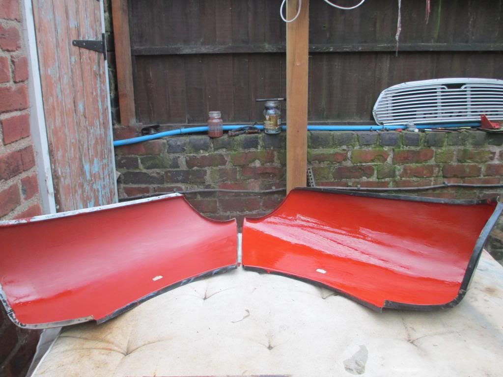

Is the wing flange butting up hard against the inner winner flange at all?? if so trim a little bit of the wing flange off and try again to close the bonnet shut line up.
Hi Sonikk.
Sorry for not replying sooner. I've not done much on the mini. Thanks for the comment. The wing will budge up a bit and I can see that I can shave a bit off the flange round the headlight to give me a better sized gap. Just waiting for this snow to clear as my carport is now like a cave (and its freezing lol) then I'm going to make a proper effort to get her finished.. She WILL be done this year..
Cheers, Joe

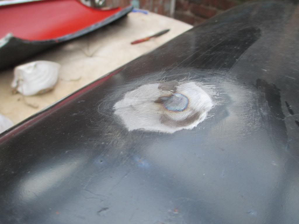

I have welded up the aerial hole on the new wing as I don't like the aerial there. I am going to have an internal aerial I think.
Thanks for looking. Tomorrow I am going to have a look at sorting the inner wing flanges and get them back to the shiny stuff.

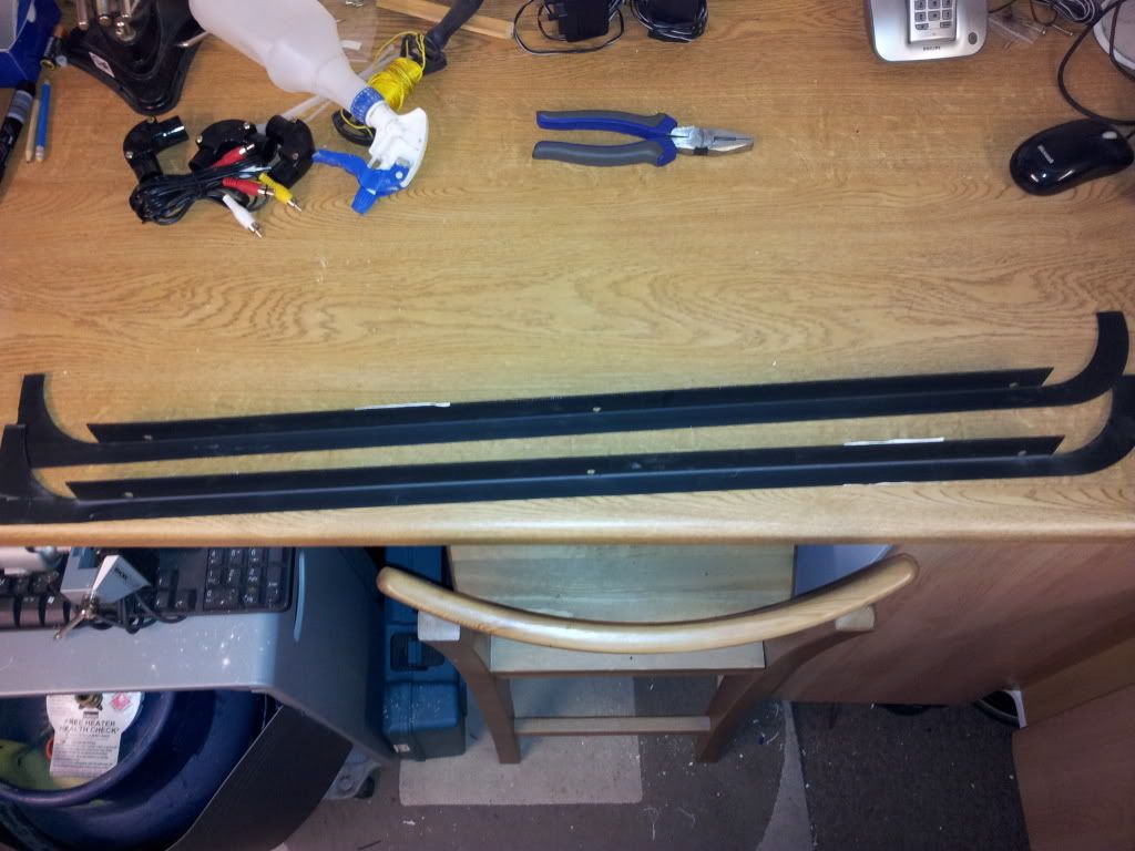

I have also bought some door frame repair panels although I have now realised they're both the same so I'll have to nip back to Nottingham mini bis tomorrow and swap one of them.
Has anyone had experience fitting these panels? Any tips would be greatly appreciated. Haha.

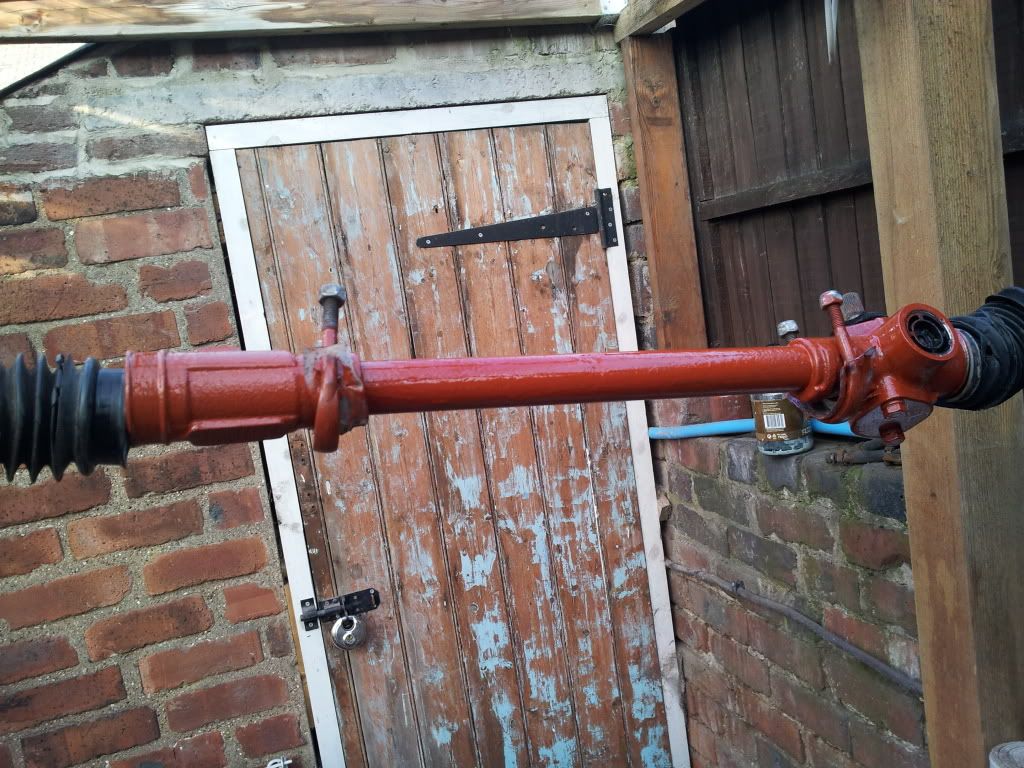

Hi all. Glad we're starting to see the back of this cold weather! I've started to sort of a few outstanding bits that need refurbishing. I started today with the steering rack. I decreased it and gave it a going over with the wire brush as there was a bit of surface rust showing. I then rust treated it. I left the old gators on just to protect the insides etc.
This car actually had an MOT... Lol
Is this a worth while thing to replace? The car drove ok (except the brakes) so I'm unsure if its worth replacing or just painting it up with new gators and track rod ends..
Thanks for looking
Joe

good to see you back at it joe. if there is no slop in the ends i would paint new track rod ends and gaitors plenty of new grease in there too
darren

Mmm not seen those repair panels like that before joe
The ones you normally see are these
Your ones will need a bit of thinking about especially if the rust has worked its way up and around the bottom of the door.
darren"
Hi darren
Thanks for the reply. I think it should be OK. I will investigate further when I have removed the Gators. I just left them on to try and stop any debris etc from getting into the rack etc.
Cheers. Joe
Hi sonikk.
Thanks for the reply. I recently found a guy who will hand you a refurbed door(new skin etc) for £69 and also your old door. I think the repair pieces I got would be OK but I think ill go down the route of a freshly skinned door.. I think £69 is quite reasonable. What do you think? Cheers. Joe
What my idea of a refurbed door is and what another's is is a different story. After doing three very recently and the amount of work involved in getting them totally rust free costs more than £69. I have another three to do yet and there is no way i could even do them for £69.
Sounds blunt i know but there is no point in mincing words.
